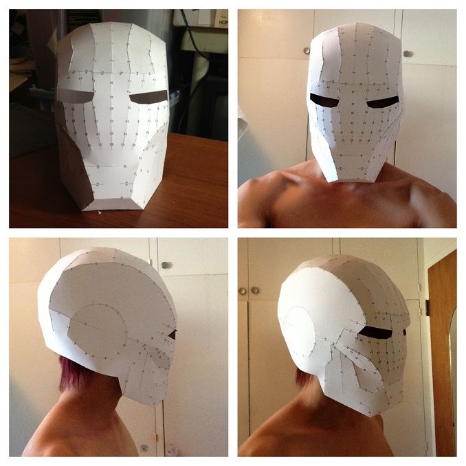

So I just started my MkVII pep build. Started with the tester helmet.
I used .95 and Idk if its too big. I know that the final helmet will be put on by removing the rear, but the tester, Im able to slip it on without having to remove the rear piece. The hole does look much bigger than the final helmet, but just making sure I got the size right, before moving to the actual helmet.
I added 1cm on each side because I will be rondoing then fiberglassing.
What worries me, is that I need to actually pull the tester out a bit to tuck my ears in, idk if that means it will be too small once ridged, but other than that, seems to be the right fit.
Here is a picture

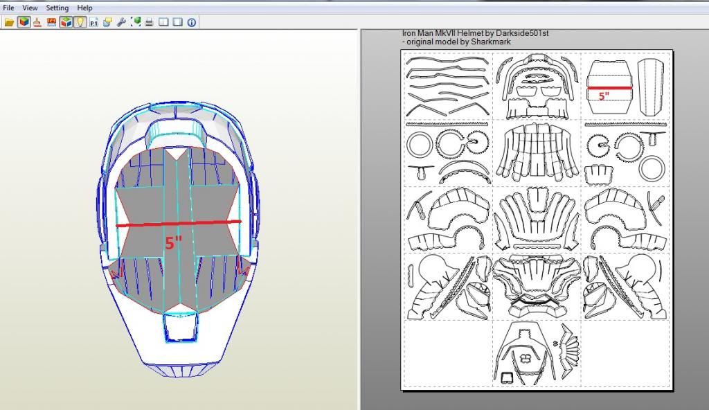

Just as a feared. I measured the final helmet at .95 like the tester. And seems the opening across is only 5" while my measured head is about 6". I would like to not have to cut the bottom, since ill have to change the back also. But seems like if I make it bigger, it will be too big.
Actually, to be exact. it's a bit under 5"
My head measured around the ears is around 22.5"
Here is a picture
What ever happens you wont be able to get your head from the bottom. You will either have to cut the back or the front of the helmet.
Yeah I will be removing the back to get my head in it. But since I cant use the measuring tool for the actual helmet, I have to go by the support on the bottom. Since I know that the support on the bottom is 4.825" and my head is around 7" (including the 2cm extra for rondo and fiberglass) that means the widest part of the helmet (the ear area) has to extend from the bottom of around 1" on both sides. and it doesnt seem like enough in pep viewer, even if I cut hole in the ear area.
But the test helmet seems the right size and any bigger, will be too big on my body.
What do you guys think? I would just build it and see, but if possible, I would just like to build it once. haha
[edit]
Ohhh I see what I typed was confusing! sorry! when I said, I dont want to cut the bottom, I meant the part that goes inwards towards the neck. the part that the bottom support I marked is attached to. But I will be cutting the bottom section to fit my head in the helmet.
