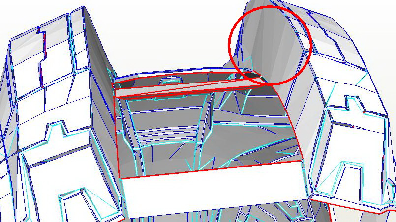

I have a few question. I'm at the resin stage with large pieces (chest and back):
- how to avoid wrapping for large pieces? For example, the "shoulder" piece of the back is really flexible even with supports. Do I have to add something to strengthen the part in the red circle?
- if wrapping happens, how can I correct it? Heat the resin with heat gun then try to adjust the piece? When can I do that? First layer of resin, second? Doesn't matter til I didn't put the fiberglass?
- the cod piece doesn't have supports. Do I have to make my own or the piece won't wrap too much?
Thanks for any answers you can give me, I really appreciate!

Re: Darkside501st's Iron Man Mk VII pepakura files - New Pics pg 100!!
Take your time with the resin work (the first coating), it's pretty much impossible to avoid warpage on those larger pieces. After you get a coat of resin on, you can use the heat gun to straighten pieces back out. I've also backed sections with extra stock to prevent flexing, with mixed results.
what you could do is stick some tape over the top parts to keep them in possition and stop the warping , it keeps a nice straight shoulder pod buddy , its what i did , if you look on my thread i have picks of my resined back piece hope it helps
Yeah, since those large pieces aren't even totally straight without resin, I won't hope to avoid warpage. Maybe gluing some ice woodstick in these parts may help...or after first layer of resin. :confused
Sometimes I realize the size of the project I began :D
Streetsoul: I'll go check your thread. I saw you finished the thighs...damn, those give me nightmares...all these long grooves :(
Just saw your back and the tape but that's not the part I'm afraid of. I fear the warpage will occur on the vertical parts on the links and right of the head (I circled them on the pic)

Yeah, I will be trying to help avoid any warping issues a little more on the V2 files. You can glue strips of wood to help keep these areas as straight as possible while hardening. Then use the heat gun to adjust as much as possible. Then after fiberglass... lots of Bondo to make them perfectly flat.
Cod shouldn't really need supports due to its shape and edges. Just don't completely soak it. Coat the outside, let it cure, then coat the inside, let it cure, then fiberglass.
