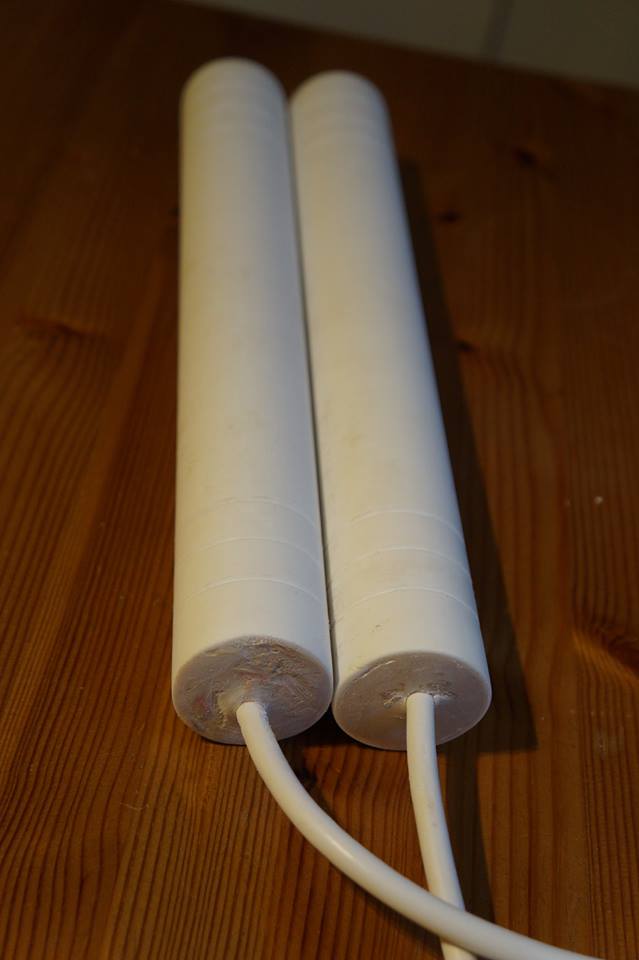

I thought that using just normal PVC piping would be a good starting point for the prop, so set to work on cutting them to the correct lengths and figuring out how to overcome my other hurdles.
I had some leftover bondo from another project and thought i could use that to seal up each end quite effectively. I could then use white electrical cable, lightly sanded where needed to get rid of markings from the manufacturer, as the connector between chucks and get a strong hold using expanding adhesive foam on the inside of each chuck to cling onto the cable. But before i could do any of that i needed the ends to stay open while i used a metal lathe to cut 12 grooves overall into the PVC piping at measured out points from the drawing above! (Unfortunately I only took photos of the end result)
(Don't hate on the swim shorts.... it's how i like to work... OKAY)
2.2 Finish
Now that i have made actual body of the prop and all the details, all that's left to do is paint it! I used just an undercoat of white primer, then several coats of a red i picked out based off samples sent to me from the lady making my client's red costume, finished off with a slightly glossy, grippy textures, clear, waterproof coat of spray to protect the prop;
3.0 Conclusion
And there ya go! Any questions about my materials or prices or anything just ask :D Thanks for ready, and have a great day!
