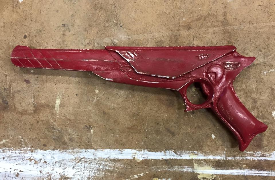

Despite my general incompetence, I actually got a pretty great wax:

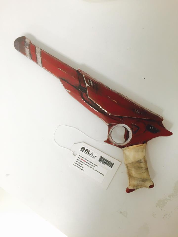

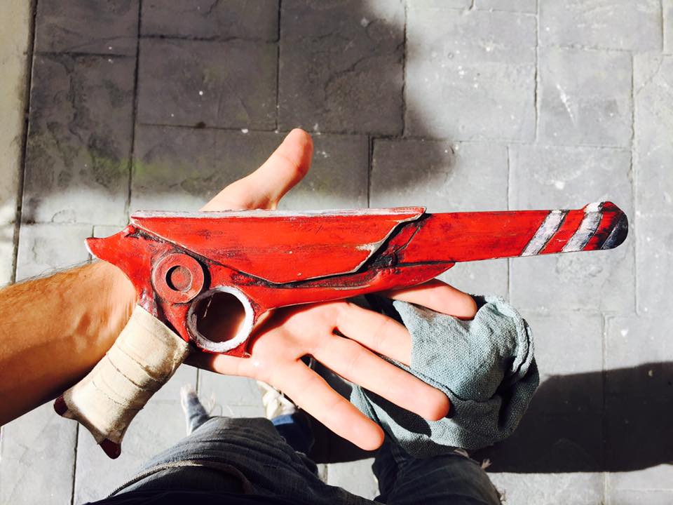

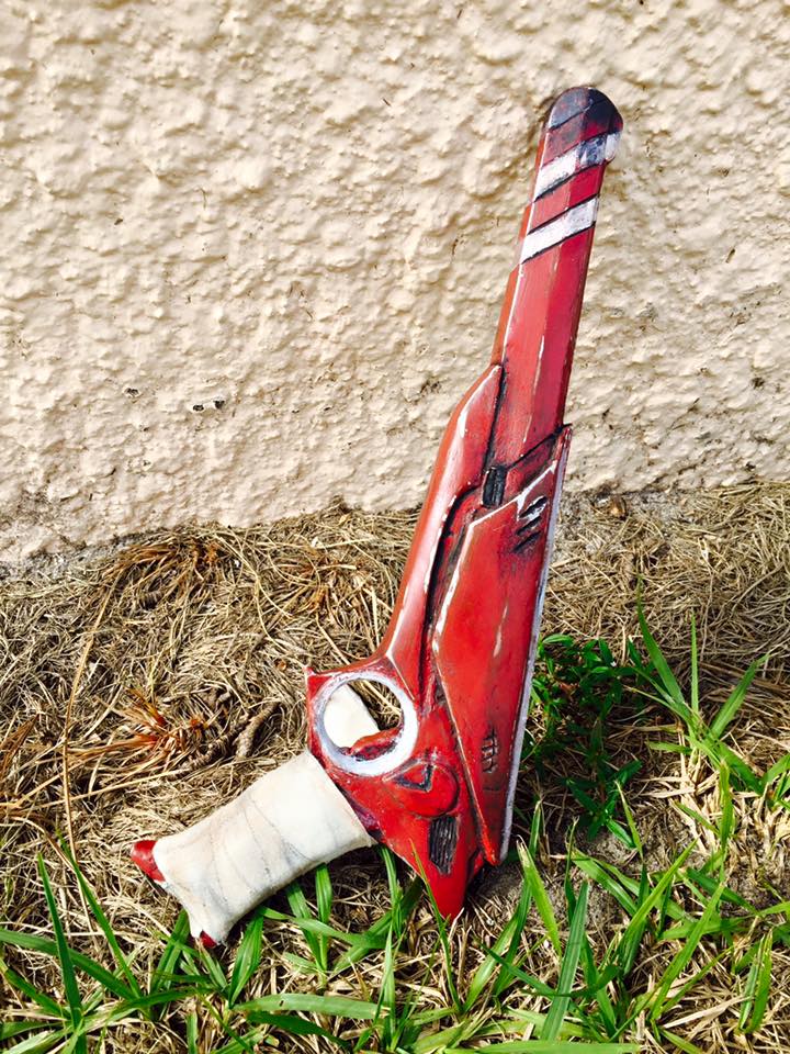

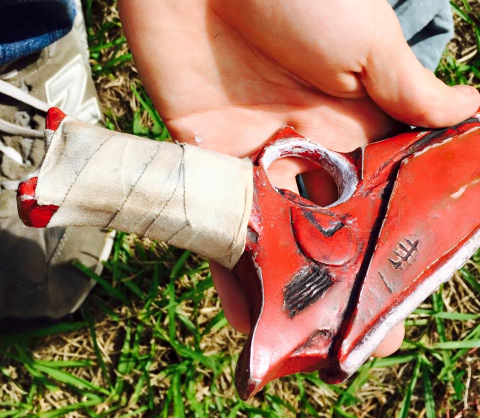

The front sight had to be re-carved, and most of the lower handle is pure bondo, and a lot of the scribed lines were re-filed by me. I had to use a cold chisel to recreate the vent sections and switch thingy. It sucked. But it looks solid. This is the first stage of weathering. I had been using red-brown primer to check for irregularities throughout the re-surfacing, and I sprayed some red enamel on top of it. After looking at a lot of reference for aged enameled metal, I sanded off most of the enamel in the exposed areas to give it a more matte finish, with shininess persisting in the more recessed areas.
Here are the final shots:
12373437_10206983795426595_6524315122085366744_n.jpg12341273_10206983801506747_798647990927894268_n.jpg11225386_10206983796146613_5367458257413998631_n.jpg
You'll note that the gun is asymmetrical, with the right side being a lot cleaner. This was due to some unfixable issues with the casting. I looked at some early concept art of the gun and sculpted/filled a few areas to make it feel solid and intentional. Guns shouldn't be perfectly symmetrical anyway, or at least that's what I tell myself. I decided to paint the white areas in acrylic and expose the red paint underneath them, because the characters basically customized their own guns. I believe there's a shot of them getting plain white ones out of a vending machine, and I always assumed that most of the details would thus be hand-painted. It was kind of risky, because I wanted it to look like a well-loved object rather than simply a shoddy shortcut on my end, but I think it came across well.

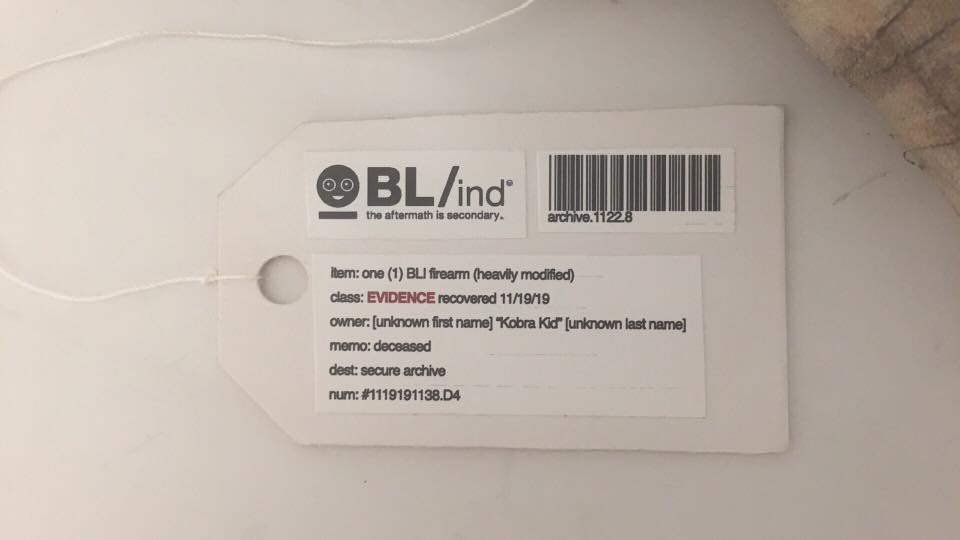

In the music video this character dies in a facility belonging to the Evil Authoritarian Baddies, so I decided that this object would have been recovered by them and filed/archived before being stolen back by the resistance or whoever. Thus, I decided to make an evidence tag to go along with it. Nothing super fancy, just printed stickers on some scrap mat board. I wanted it to look a bit cartoony, so I cut all the parts freehand.

I think it turned out pretty well! It makes such a difference to feel the weight and coldness of the metal and see it glint in the sunlight in the distressed areas. The photos definitely don't do it justice. Hope y'all like it! Now I just have to figure out how to wrap it...
