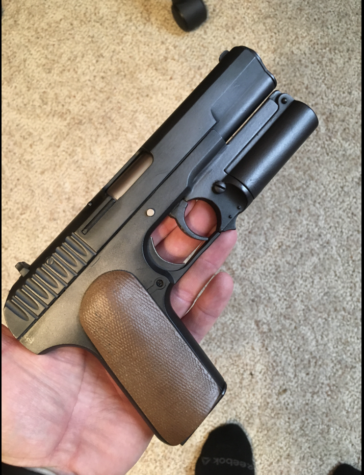

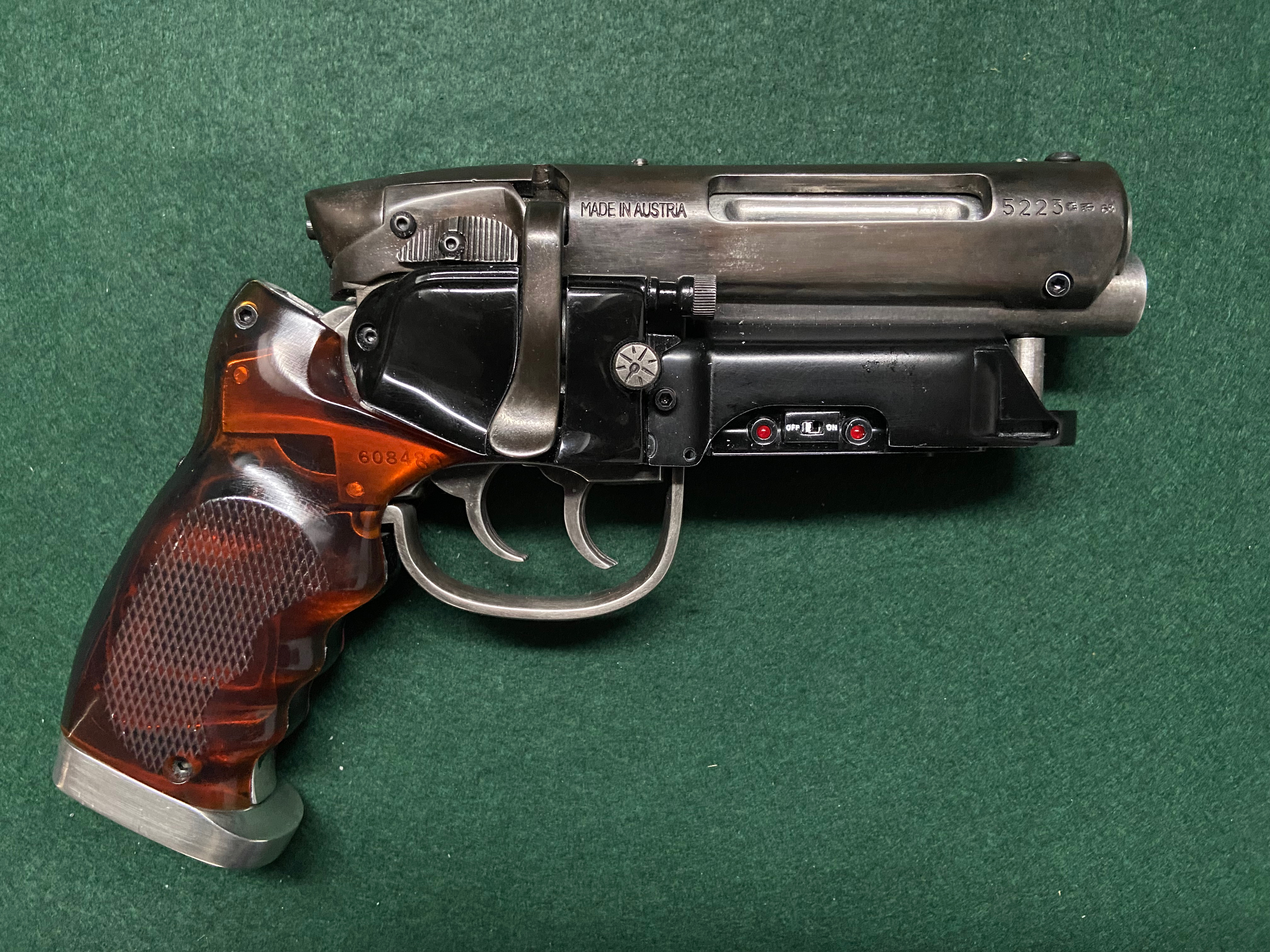

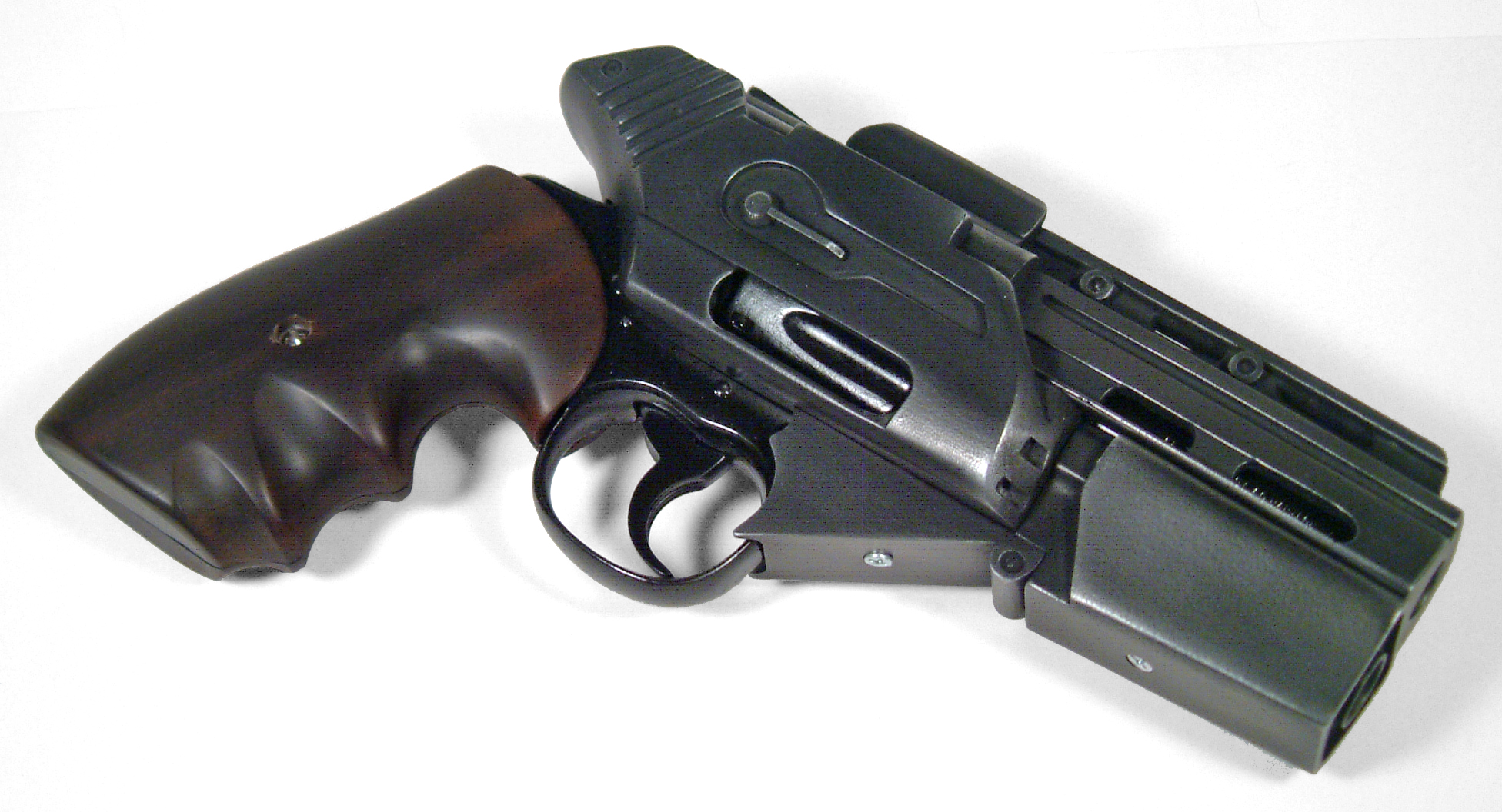

The technique I use, and I wish I could recall who explained it to me, is using BBQ paint. Once cured, I generally use a 0000 steel wool to polish it to a gunmetal sheen (can use paper towels and similar fabrics in the creases). Then for the appearance of wear, I'd use silver rub n buff.
Yes! I used to use BBQ Black on all of my gun-type props. I'd put a layer of gunmetal down first, then when I'd buff the BBQ black I'd try to be a little aggressive on areas I'd want visible wear and expose a bit of the gunmetal paint underneath.
