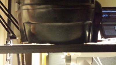

Also as a side note, as you can see in the below picture the helmet doesn't sit on a table flat (the table is angled in the photo but IRL it's flat and the helmet is angled.

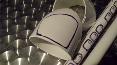

I used this template for my cut outs and as you can see below I've cut out the insides and used the template like a negative and just used a permanent marker on the inside.
http://i26.photobucket.com/albums/c115/jaydesu/Daft Punk - Guy Manuel/09template_zpsb70d91f6.jpg

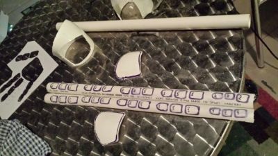

And here's the pipe split in 2 (showing both hands' fingers) and the back of the hands cut out.
http://i26.photobucket.com/albums/c115/jaydesu/Daft Punk - Guy Manuel/12HandsSomeCut_zps0998e9d3.jpg

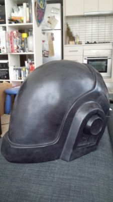

I've also received a helmet from (who I believe is) a respectable prop maker which is currently in the works.
http://i26.photobucket.com/albums/c115/jaydesu/Daft Punk - Guy Manuel/01Helmet_zps288ddd8f.jpg

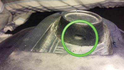

1. Dents and nooks on the ear cups
http://i26.photobucket.com/albums/c115/jaydesu/Daft Punk - Guy Manuel/02earcup1_zps8a8c4b25.jpg
http://i26.photobucket.com/albums/c115/jaydesu/Daft Punk - Guy Manuel/03earcup2_zpsde8e1b5e.jpg
http://i26.photobucket.com/albums/c115/jaydesu/Daft Punk - Guy Manuel/04chipear_zpsce9d71dd.jpg

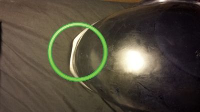

3. One side of the helmet seems to have "melted" - I don't actually know what to do here...
http://i26.photobucket.com/albums/c115/jaydesu/Daft Punk - Guy Manuel/06melted_zps9edad72d.jpg
http://i26.photobucket.com/albums/c115/jaydesu/Daft Punk - Guy Manuel/08notstraight_zps883844a4.jpg

This is one of my cast, went out with some damage because in this period with Halloween coming I had a lot of demands, this is not a valid excuse, I know that the cast should always be good, but unfortunately it happens and I apologize.
For photos of the points 1-2-4, you can fix simply by filling out the bumps with putty, for point 3, from the picture I can not see well qale the problem is, while pr distortion of the rear base is sufficient to heat the part with a heat gun, then place the helmet on a flat surface, and will straighten alone.No overall serious damage.If you need other help do not hesitate to ask.

I have cut out all the pieces for the gloves and sanded them down and washed them.
I've also set up my painting rig (below). Basically I hot glued broken up skewers to my paint cardboard.

I am going to try this with the PVC for the fingers I almost bought a kit til I seen this lol
