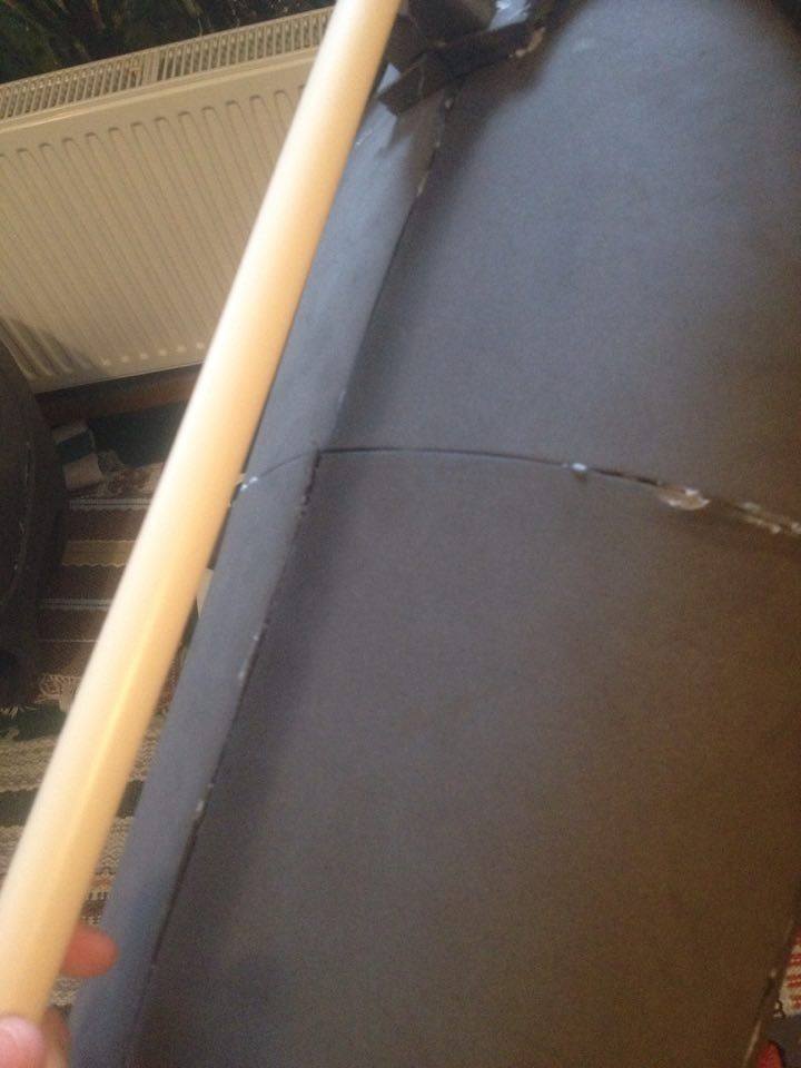

How did you manage to keep the arms in the right place? Cause i think i made mine a bit too big cause they are a bit woobly.
Is there any way i can fix this? Would this be visible on the suit if i spray it later?
You could take a slice out of the inside seam, maybe a 1" strip cut out, then rejoin the seam and it will be a smaller diameter. Also get some spongy foam, like the kind in couch cushions, and cut a ring that you glue inside the arm. Then your arm slides thru the ring and is snug inside because the spongy foam compresses to fill the void.
