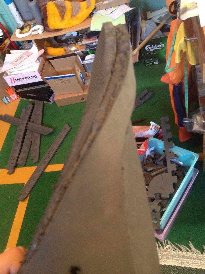

How do you get so clean cuts from the yoga mats?
When i cut i get it gets messy

.View attachment 654466
You need sharp new blades, and your trying to cut through in ONE cut! It's hard and takes practice. But try that. Angle the blade at a 45 degrees, then slowly 'saw' the tip into the foam till it hits the bottom. Then drag slow an carefully.

But what kind of knife do you? And do i have to redo everything or can i just grind a bit of the edges so it becomes smooth?
im sure most of us here use this kind of blade or something similar. also foam makes blade dull really quickly, so get loads of replacement blades. you can either cut the edges a few mm off with a BRAND NEW sharp blades or you can use dremel / rotary tool to get it smooth.
i suggest you search youtube for foam armor tutorial. try something simple first until u get a hang on it before continuing this project. not only you will more practice, it also save you alot of materials if you make mistakes with the armor.
