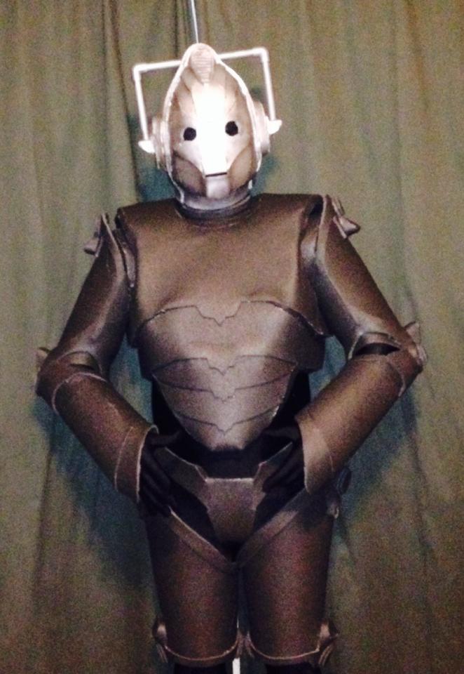

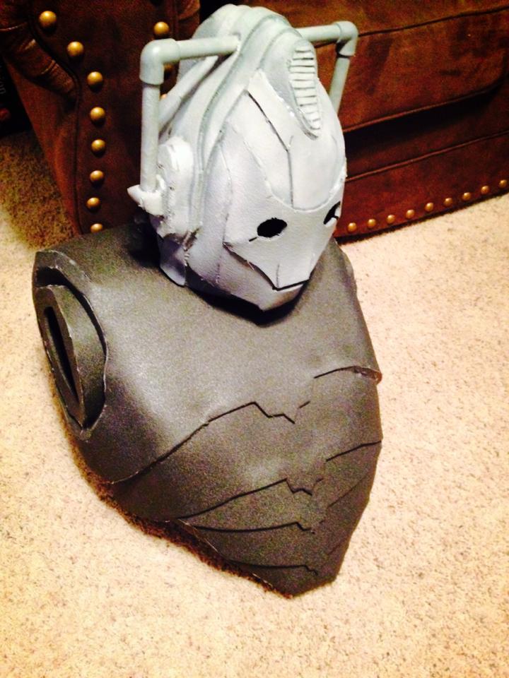

I am slowly working on a Cyberman build of my own here is what I have so far. I am going for that battle warn look of the armor, like the aged last of the cybermen kind of look. This is my first full foam costume build, its a start

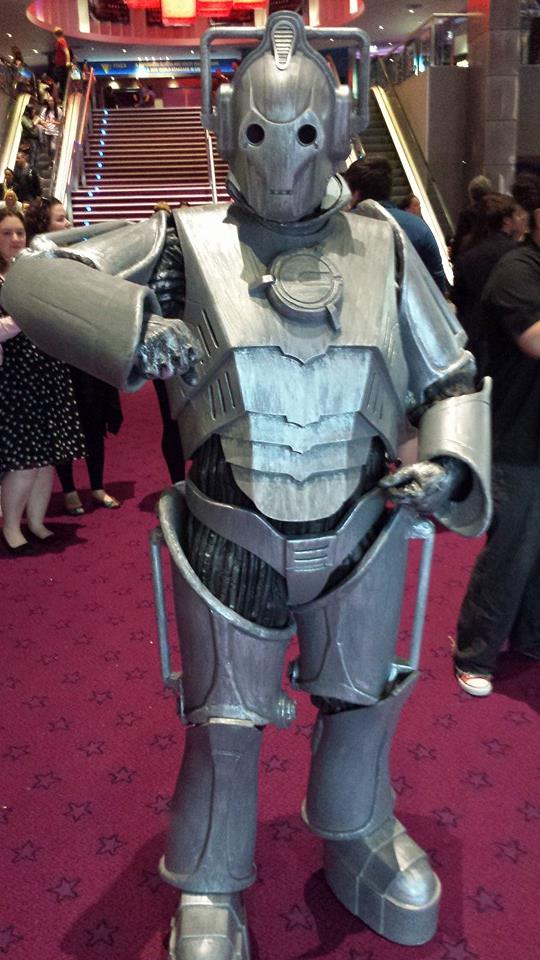

Just wanted to say a massive thank you to Wondersquid and his designs. I built this suit for the 50th anniversary of Doctor Who and wore it to a cinema screening near me and it was a huge hit!
I changed a couple of the sizes of things from the patterns (mainly the gauntlets) and there are definitely things I would improve upon if I built it again (and yes I know the Cybus logo is not on correctly) but all in all i'm very happy with the way it turned out!
Built out of the interlocking foam flooring mats, covered in PVA (2 coats) then in Smooth cast 300 (3 coats) for a solid plastic finish. Under suit was created from a handmade black onesie covered in foam pipes, detailed then painted with liquid latex for colour and flexibility. Helmet was a voice changer toy repainted, did not get time to create the back half but rewired the electronics to a portable voice amplifier strapped to my chest so i could talk to people.

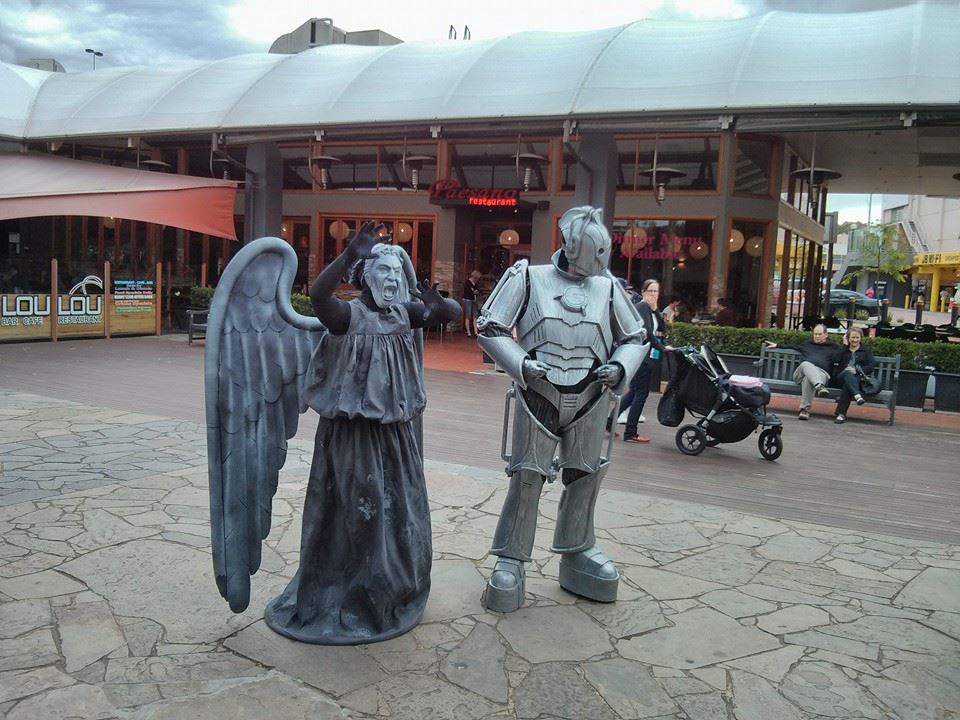

The Cyberman was fully built by me and the Weeping Angel was a joint effort between myself and a friend (who is wearing it). Run out of time to properly do the mask and wig join on the Angel though, but it still worked.

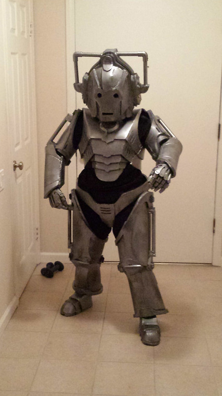

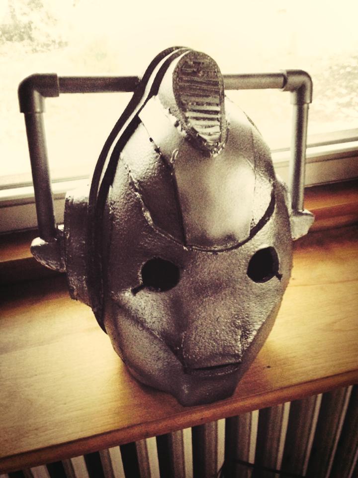

Despite not posting since around July/August I've still been working on my cyberman. Only very slowly with little progress until November-now.
Just in time for Gallifrey One I've finally finished! The undersuit and electronics I'll add later when there's time and funds :)

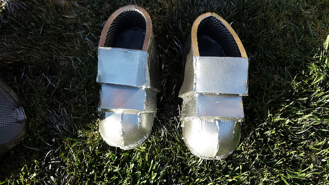

Helmet sealed with Plasti-dip!
Shiny shoes!
And the (semi) Final Product! Not too bad for a first foam build.
Thanks so much Wondersquid! These patterns rocked!
