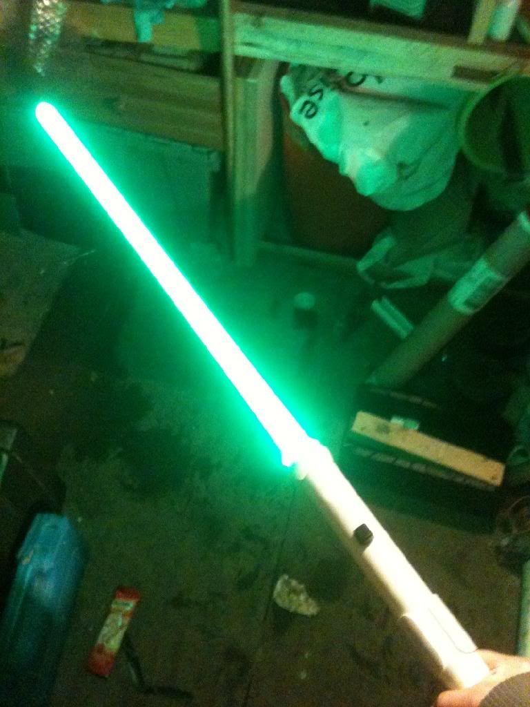

I ventured into my first saber project last year and made some for my kids. My remit was to keep it cheap but look cool whilst being durable and kid safe. They also wanted to be able to wear the hilts on their belts so the blades also had to be removable as well.
Here was my solution:
I used 1" OD polycarbonate tubing for the blades as they are very nearly unbreakable, which I discovered was snug fit for the stick glue tube so that became the blade seat. the glue stick tube also happens to be a good fit for the PVC down pipe section, and the red part of the empty disposable inhaler provided the pommel, also a very good fit.
Unfortunately, if you want removable blades, you either need to make some kind of quick connect for the hilt and base of the blade and seal the LEDs inside, or go torch style.
I chose the latter because it's a lot simpler, but still effective.
The trick with this type of setup is getting the light even all the way to the tip. I solved it by gluing a small acrylic mirror to the underside of the blade tip, and inserting a roll of celephane into the blade tube and glued it to the inside at the base to secure it.
I scratch build my emitter heads from all sorts, here a few in the mock-up stage.
...and one finished
Thanks :)
The finished one was my first and I was enormously pleased with the results considering they only cost around £35 total to make :thumbsup

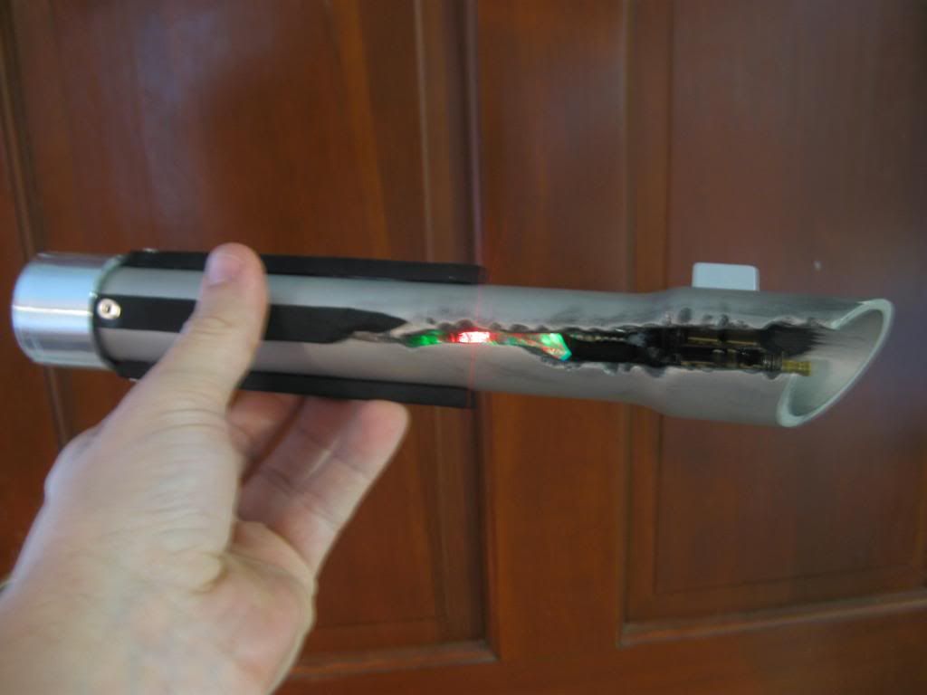

Here's a couple of my pvc saber hilts I made for a costume: (Sorry for the pics hijack, just though you might get some ideas)
Those are awesome! I love the "damaged" one, it gives makes it almost speak it's own story.
