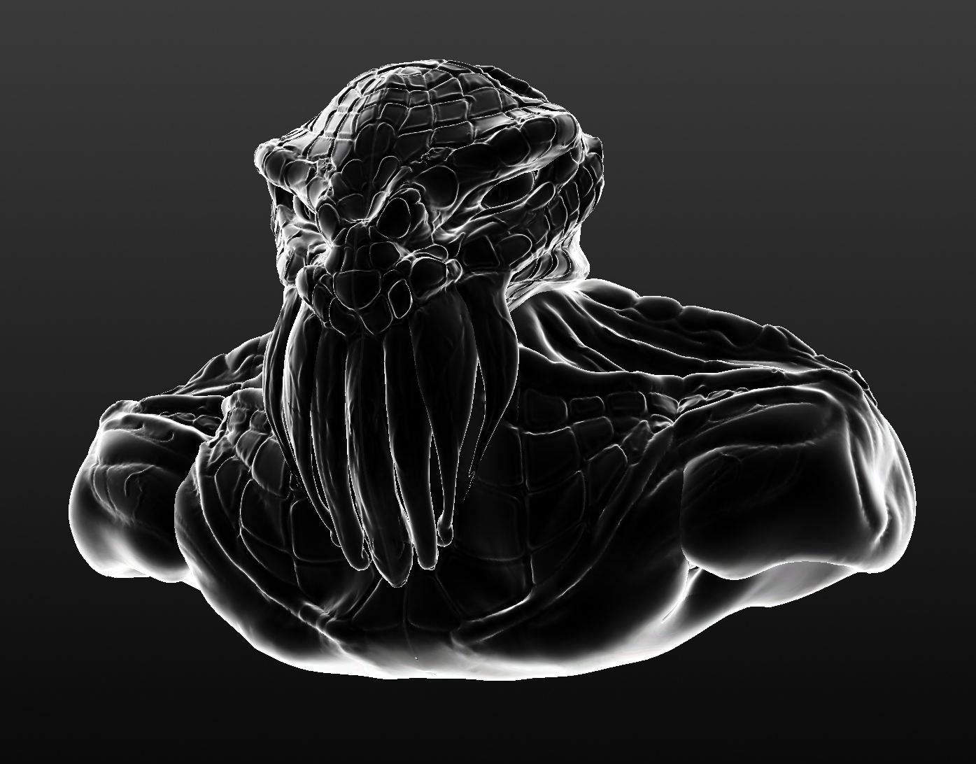

Hi guys,
inspired by Nick Daring's awesome, awesome (yes I said it twice) sculpt, I decided to finally start trying my luck in 3D modeling.
A lot less "hands-on" than working with real clay, but a lot less messy as well :)
Using Sculptris I tried to recreate the image I have in my head of what Cthulhu looks like. Couldn't resist using some "human" bits. Vascularity and such. The bust itself is gonna have some muscular tissue and vains as well. I really wanted to add the power of this creature and visually, adding muscles is a nice way to do it. ( I know Nick disagrees haha :) )
This is a work in progress of course, will add more detail and neck/shoulders.
The plan is to have it 3D printed and painted, although that is probably pretty long-term.
Let me know what you think!

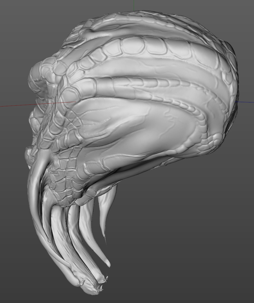

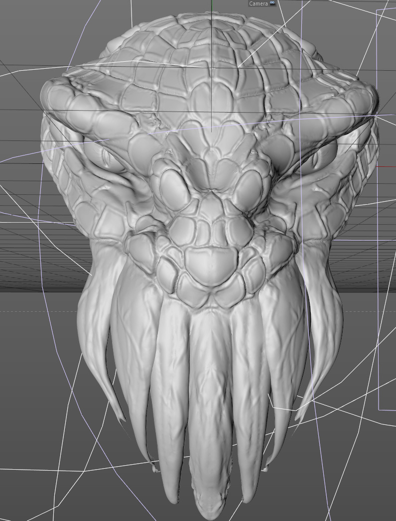

Update time!
A lot of the bust added. Computer reaalllly slowing down because of the polycount.
Slow and steady :)

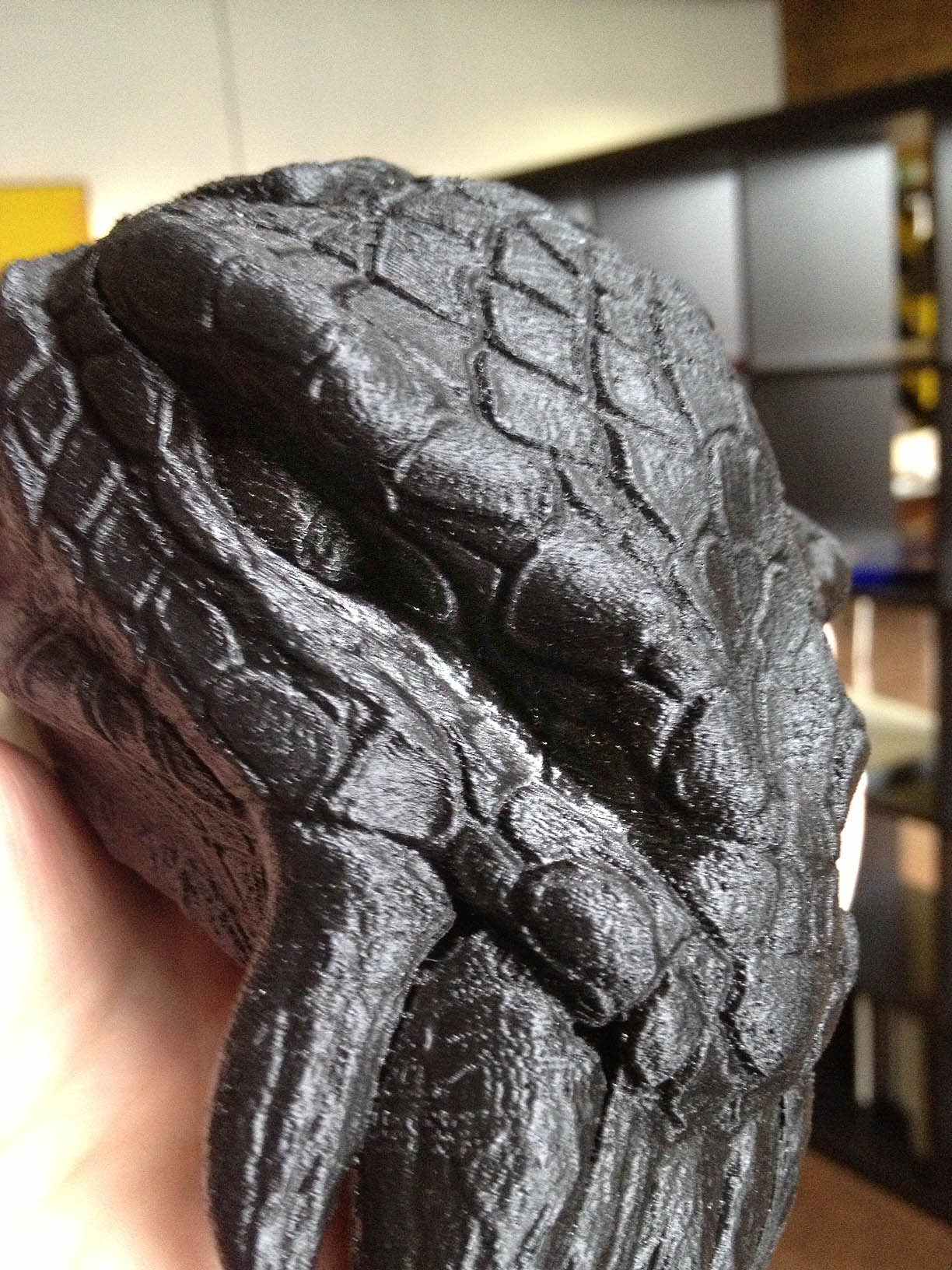

After 38 hours, the first testprint is there.
Awesome to have something in hand that was digital a few days ago and just an idea a few days before that.
Next stop, refining print-settings, making a base/stand for the head, and do some filler/paint test on this testprint.

How much was the 3d Print? And how big is it? Iv'e never tried Sculptris but I love Zbrush. Any 3d printer recommendations?
I hope I can answer this.
The model itself is 15cm tall and weighs 400 grams. The cost of 1kg (2 pounds) PLA reel is $30 here so it was $12 to print.
We have an Ultimaker 3D printer. We chose this one over any other because it is simply the best layer based printer there is. You can set it to extreme speed, extreme accuracy (0.06mm layer thickness!) and it's build volume is the largest (220mm height x 210mm width x 210mm) and the company behind it has some seriously good client support. Did I mention they also have their own very good slicer Cura? The latest beta has a new way of building support structures that actually sculpts a model around your model to support it in key areas, it is also VERY userfriendly.
It is also primed for upcoming upgrades like the Dual extruder kit (released this week), a heater bed upgrade (motherboard has connectors ready to go), and a 60cm frame upgrade which let's you print heights of up to 600mm (2 feet)! This means you don't have to buy a new printer every time the company releases something new.

thank for the detailed response to the 3dprint.... Sounds good. I was asking another 3d printer how much for a 4 inch figure he quoted me over 500.00 I can't afford that so I was like I better put some ideas aside and work on some traditional sculpting but I really do want to see some of my zbrush sculpts printed someday at an affordable rate.
The easiest way to bring down the cost of a model(and the print time) is making it hollow to some degree. While a 100% hollow item might be delicate(depending on plastic type), even printing with as little as 10% infill makes a very sturdy item. The 3 inch Maltese Falcon I printed for demo purposes so the people at work can understand what I'm talking about when I talk about my printer has a 15% fill and can with stand falls, knocks and someone carefully standing on it.
Wow that is a lot. Material costs for the Cthulu head were $12, print time was 38 hours on maximum resolution. If I would have optimized a bit further I could get the print time down to 12 hours and the cost to $ 7 by using less infill because the current infill was way too much. I would quote depending on printer demand.
If you'd like I'd love to see if one of your sculpts is printable. I am always looking for quality meshes to test the printer on. I am still learning about it all the time so I don't want to ask money for it yet.
Yea 10% is more than enough. Reason I use a bit more is that it gives a bit of a better internal support to the print so the top doesn't sag into this rectilinear grid pattern.
I am also testing a new way of support structure that works way better than the previous one.
I am looking forward to the painted result of the Cthulu :) .
I definitely would set up a 3d file and optimize so your not spending 3 days on it...wow..I didn't realize it would take that long to print...I have some tutorials on setting up zbrush files for 3d print. Whats the largest dimensions you can print on that machine. Id love to send you a mesh but before that Id like to set up file correctly and paypal you cost of material.
