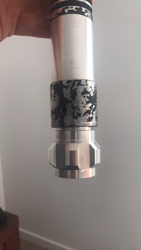

More pictures of the saber... there isn’t a starkiller that has a threaded pommel

Agreed, I have never heard of a threaded pommel version of the AS V2. In general I feel as though all the AS V2's have the tiniest bit of play at most connection points to avoid issues like this. I would need to see more pictures of the saber to see what we are working with before I offer any advice.

The first runs of Starkiller’s V2’s were designed to have a gap between the booster and the pommel area, so if you are trying to force that gap closed, I recommend not doing so.

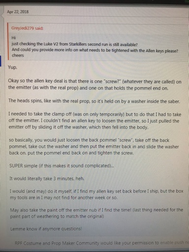

I bought it already assembled from the Junkyard and full disclaimer this is the first saber I’ve ever worked on. Was only trying to take it apart so I could tidy up what the original seller said needed to be done. I didn’t even know if it was threaded or not, just twisted and felt like it was.
Got a screenshot of the conversation with the original seller/owner.

What is happening with these pommels?
They are not threaded, so if they're a little too thick, a little sandpaper around the pommel insert section or around the inner surface of the booster will make them fit perfectly.
The receased groove should line up with the grub screw in the booster.
