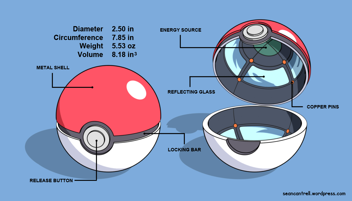

I've been trying to replicate a pokeball, but functioning though, as my first professional prop making replica. I plan on doing this through modeling it out of a foam sphere then making a mold and metal casting it with aluminum, then I'm going to situate how I'm gonna put in the hardware to actually make it functional. Here are some dimensions I found online (a 2.5" diameter):
And calculating out the other specific measurements through a high-res picture I found online. But I'm sure the machinists will figure that out with you :)
