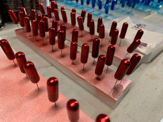

I have used Alclad paints to to make an anodized aluminum look with pretty good success. The surface prep is the key to success.
The surface wants to be as smooth as possible. If there are pits and scratches on there before spraying the silver, they will become glaringly obvious once the silver goes on.
Also, be sparing with the silver. Use just enough to color the part. Avoid the desire to hose it on heavy and wet.

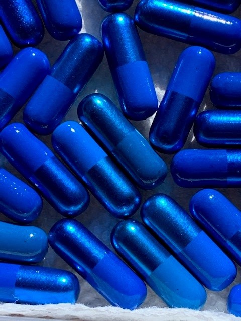

After spraying on Alclad's chrome, I used their clear colors to get the look that production wanted for the last Matrix film.

You can mix the clear colors to create other tints. Also, how much clear color you spray on can change the color. For example: The blue color for the Matrix pills looked teal when a light coat is sprayed, or purple when a heavy coat is sprayed on. The blue was the Goldilocks amount.
