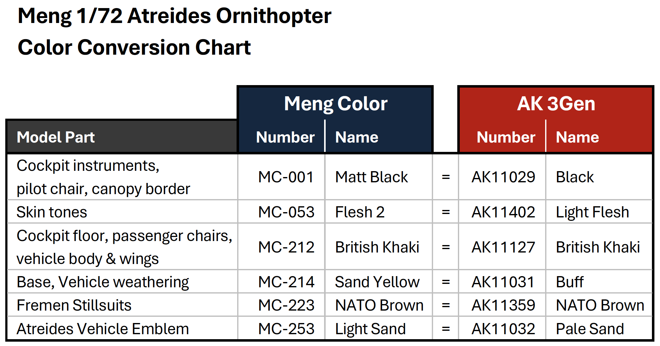

Thanks everyone for your feedback! I agree builders should paint to whatever they see and think is best, but I decided to do more digging around online across multiple sources and may have figured out the correct colors according to Meng's instructions.
Here's a chart I created to convert Meng Color to the more common AK 3Gen acrylic paints, aligned to the specific model parts:
Hope others will find this helpful!
Feel free to share or let me know if you found something more accurate.

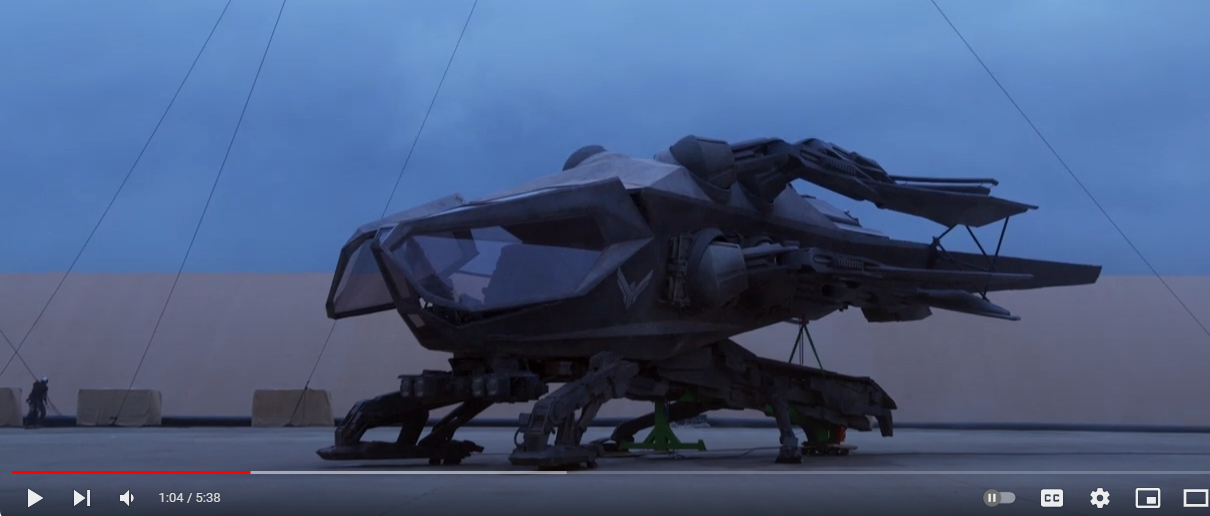

But when they show the set piece, it sure looks black / german grey
Is it possible there were more than 1 color? I guess it is possible, but doubt it.
The above seems to be the "pristine" showroom model while below is after a bit of use

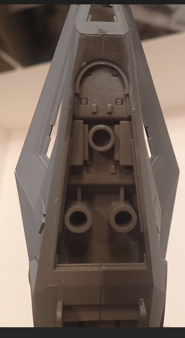

Looking over the kit and some reference stuff, I feel more and more like the kit plastic color is kind of the closest average overall color and probably the best tone to start with as a base color
The weird thing it is nearly an olive green, but shifted towards the brown side. I noticed it was very close in color to some of the USAF olive drab used on B-17s etc... but again, without as much green, but still a slight hint due to the amount of yellow sand type of color embedded in the brown
I found an FS color or at least a Vallejo version of that FS color that matches the plastic color nicely. It is not a 100% exact match, but is close
It is FS34084 and assuming other paint lines are close you theoretically could use any paint brand you prefer that has the color
Here is the color compared to the bare plastic color. Similar brownish type hue, but a bit darker which I prefer since it allows for some lighter sand color weathering to be added after the base. Area painted is circled in red
The difference here is a bit more contrasted than it looks in person under normal lighting
