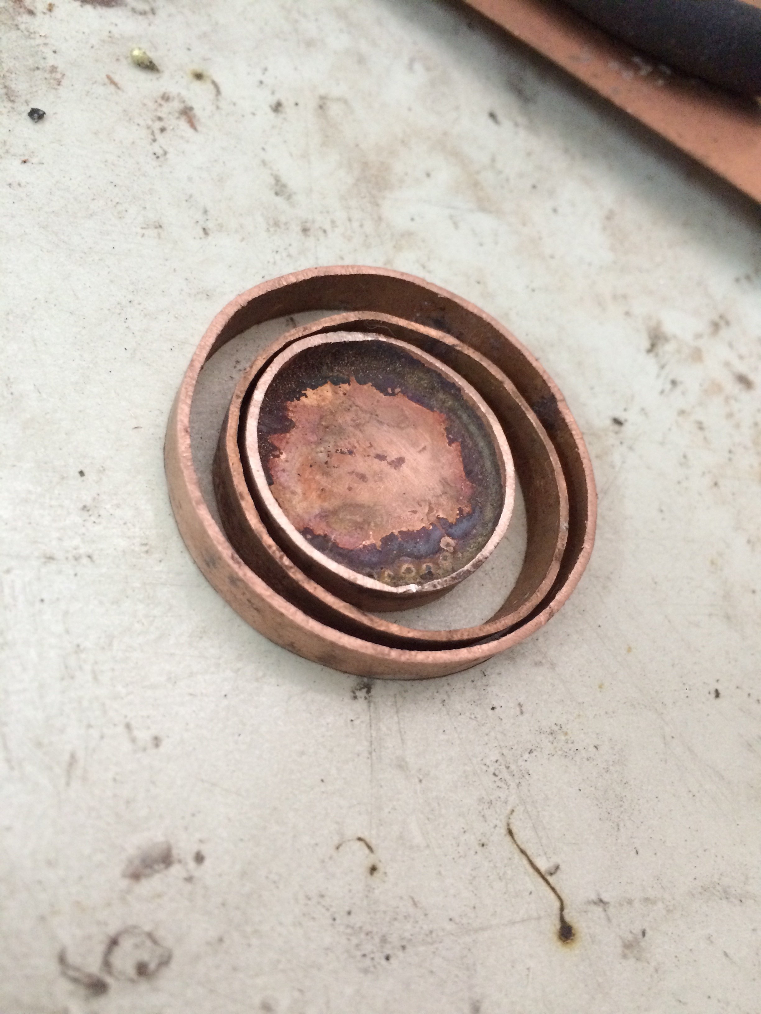

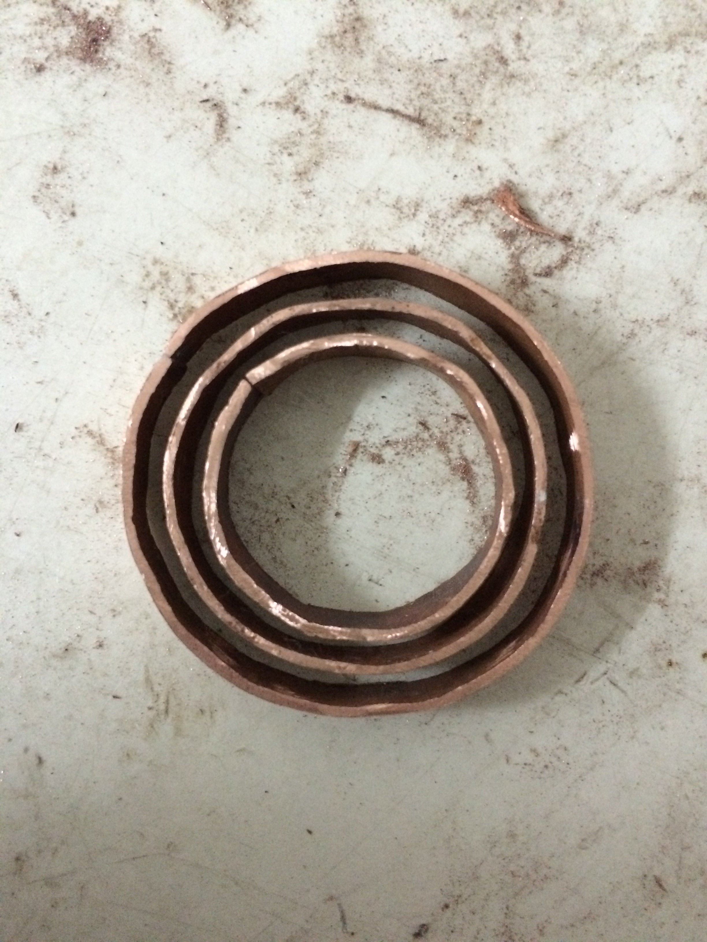

The rings are laid out here, pre-soldering.

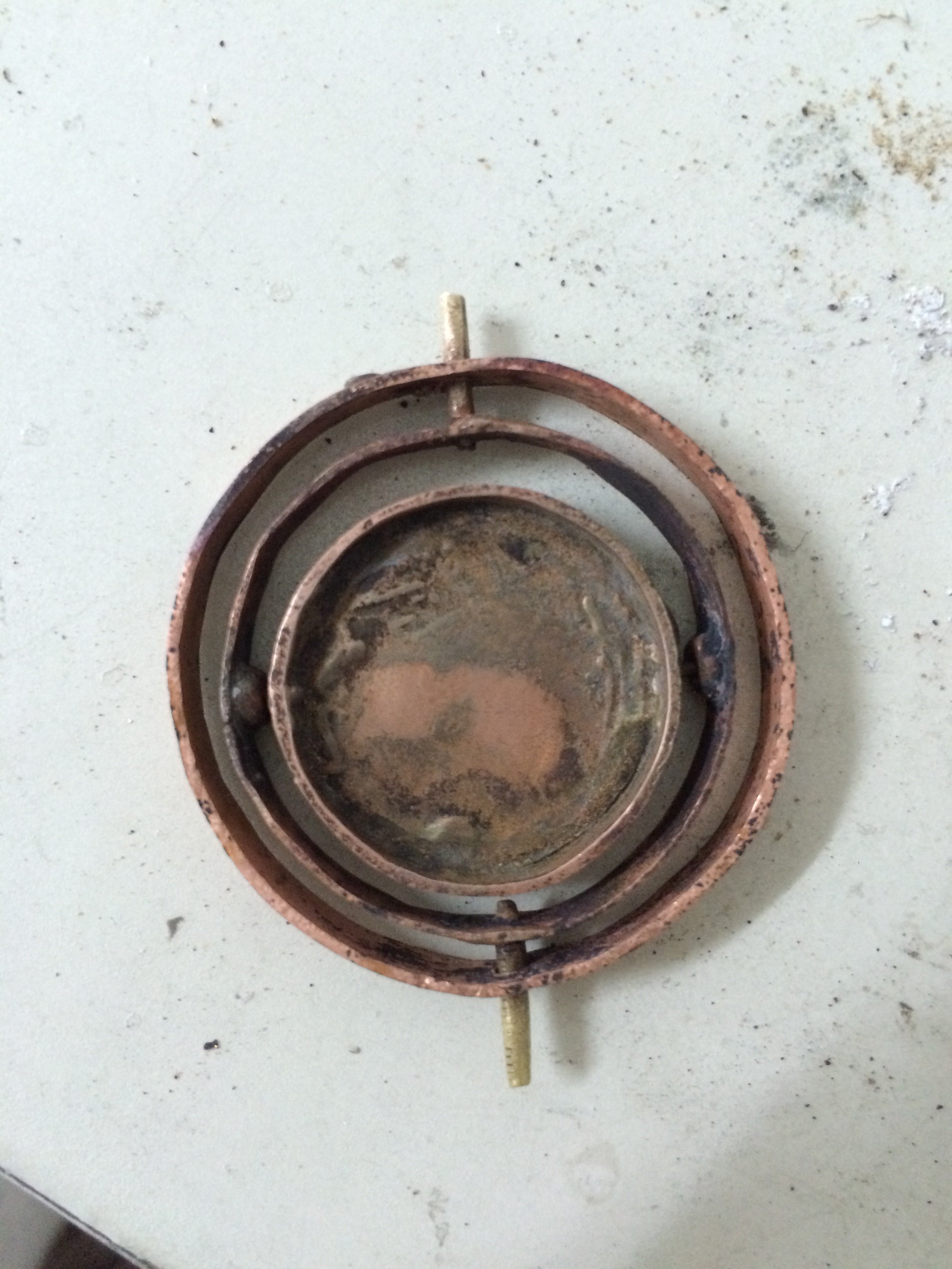

Here they are completely soldered, with the middle disc.

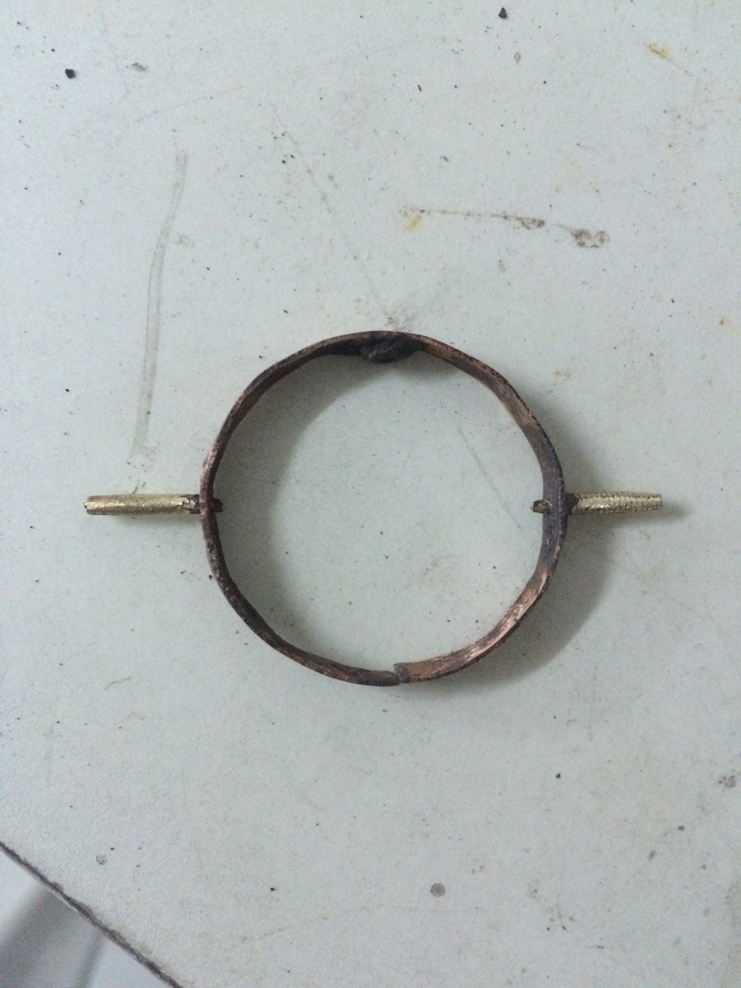

Here is one of my unsuccessful attempts at soldering the rods (which i obtained from brass screws), which was one of the more challenging parts, just to give you an idea of how frustrating it can be. The two rods that are attached to the middle ring need to be perfectly aligned, and opposite each other so that they can rotate properly. There were many unsuccessful attempts, believe me.
After finally soldering on the inner rods correctly. Some of the other major challenges included getting the drilled holes to align perfectly on both the middle and outer rings, again so that the rotation is perfect.

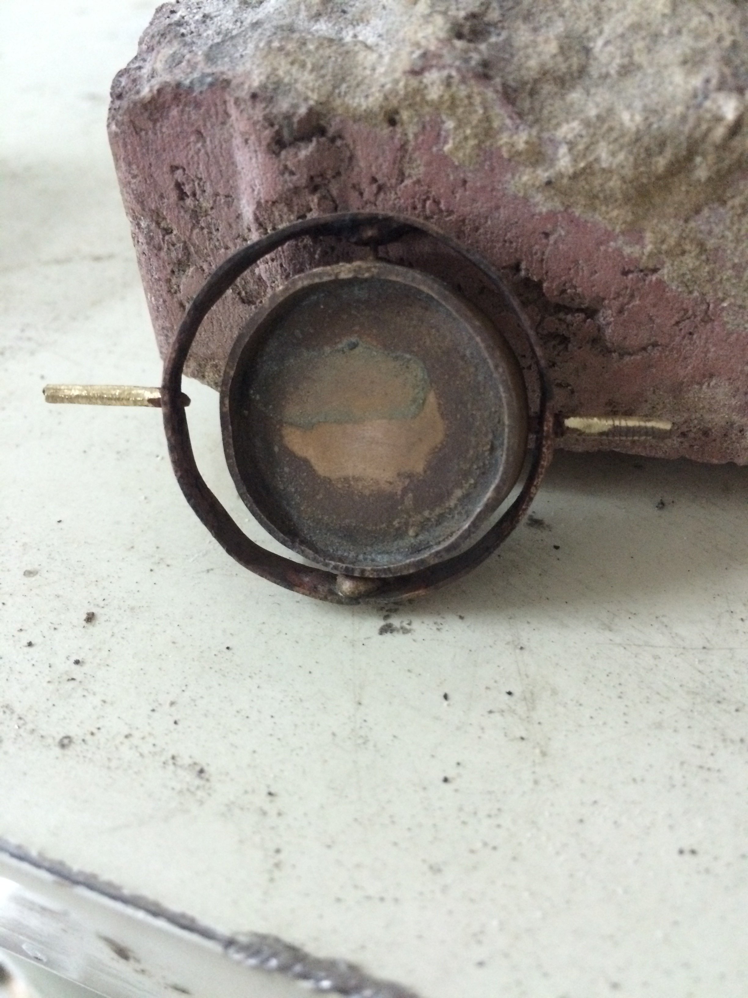

The middle and innermost ring are fitted into each other. The copper kept softening after being annealed all the time so I had to use pliers extensively throughout.
Unfortunately, and I do hope to remedy this in the future, the innermost ring simply fits into these little 'beads' that I soldered onto the middle ring, with holes drilled into them,so they are at risk of falling out. I didn't have access to any copper beads, so I had to create them myself by drilling tiny holes into copper scrap (again one of the more challenging parts).

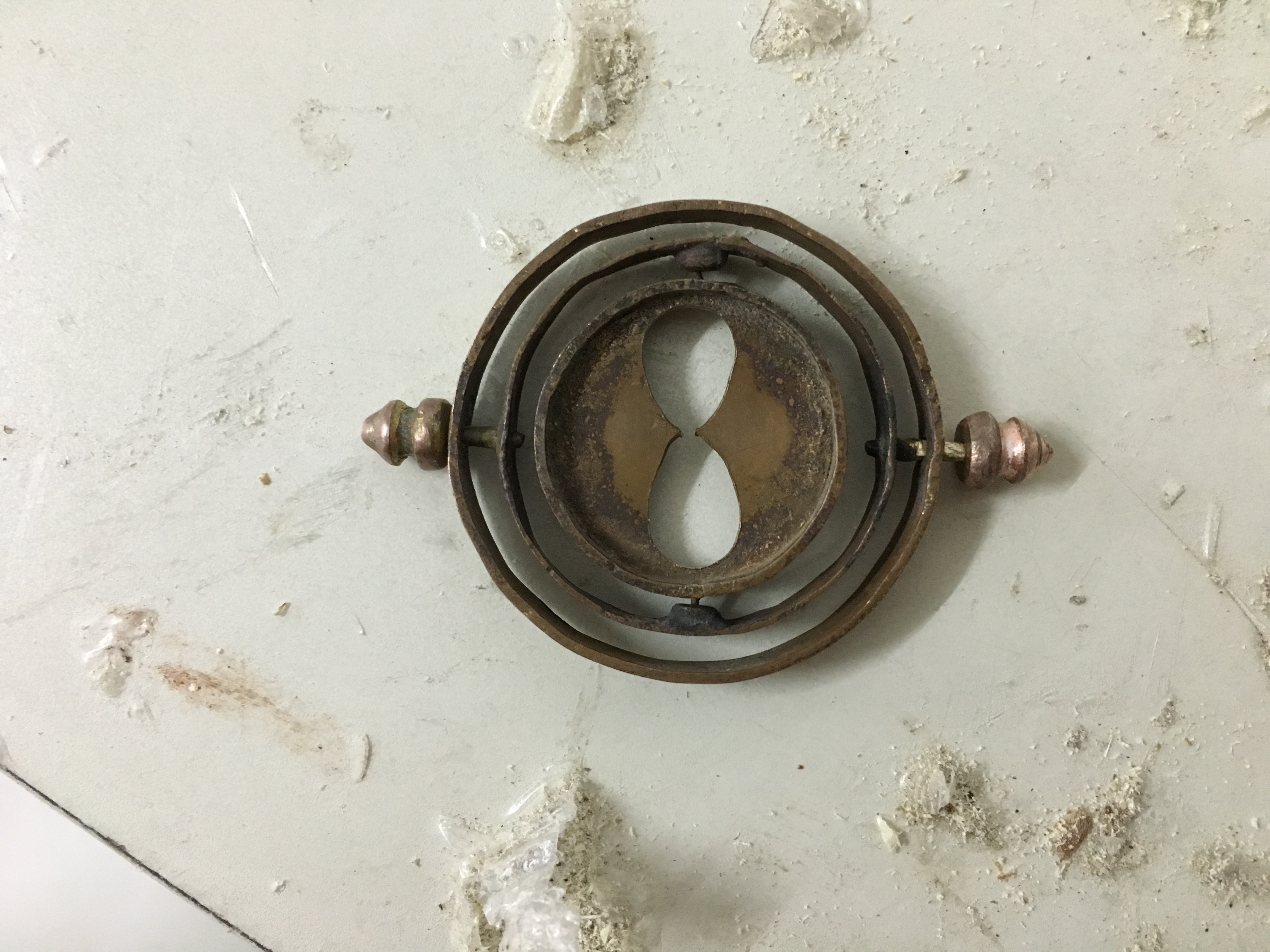

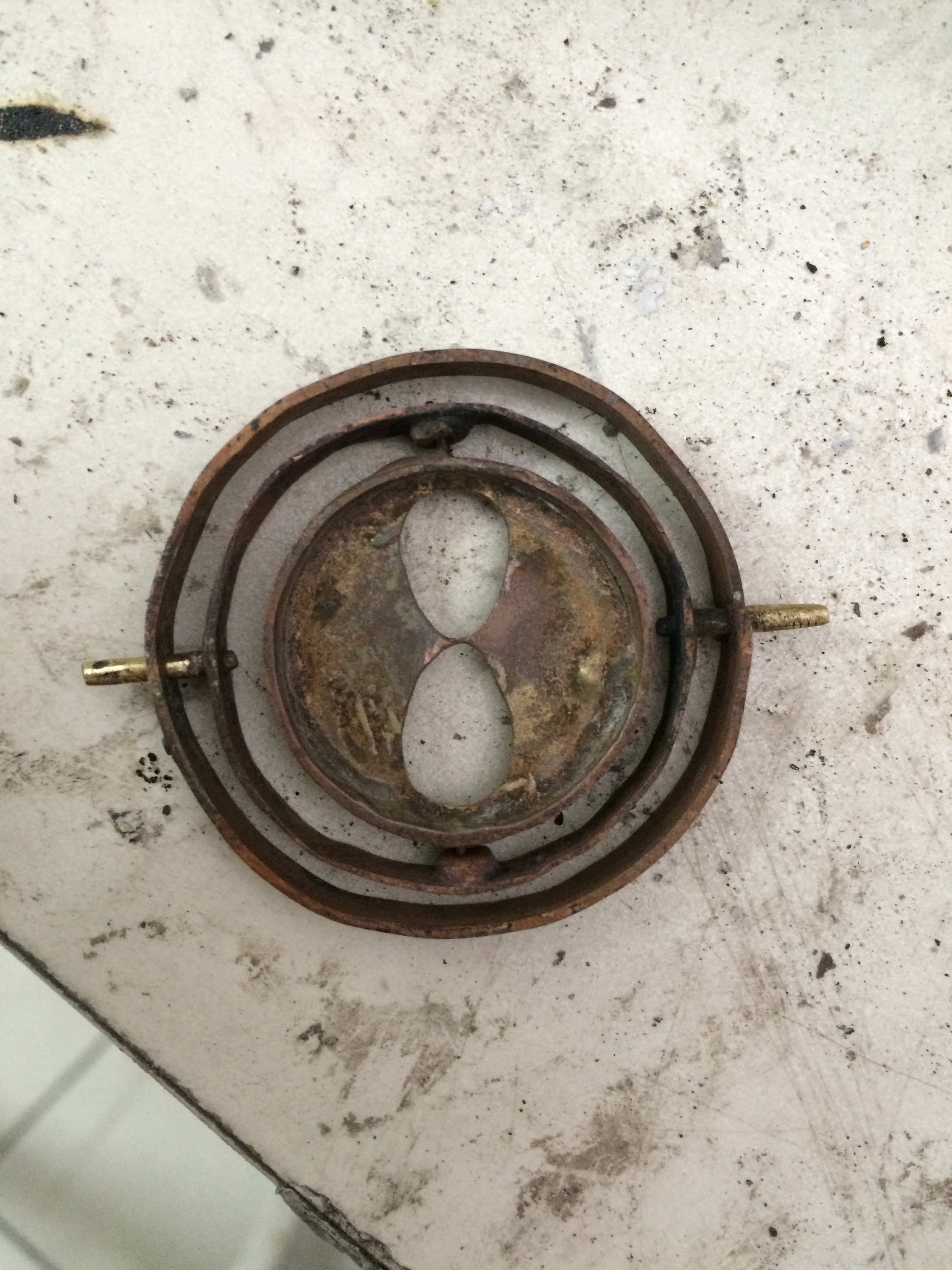

This is after fitting all the parts in and cutting out the hourglass shape. Unfortunately I realized too late that the hourglass shape doesn't exactly match the one seen on the actual prop versions. At this point all the rings could rotate properly.

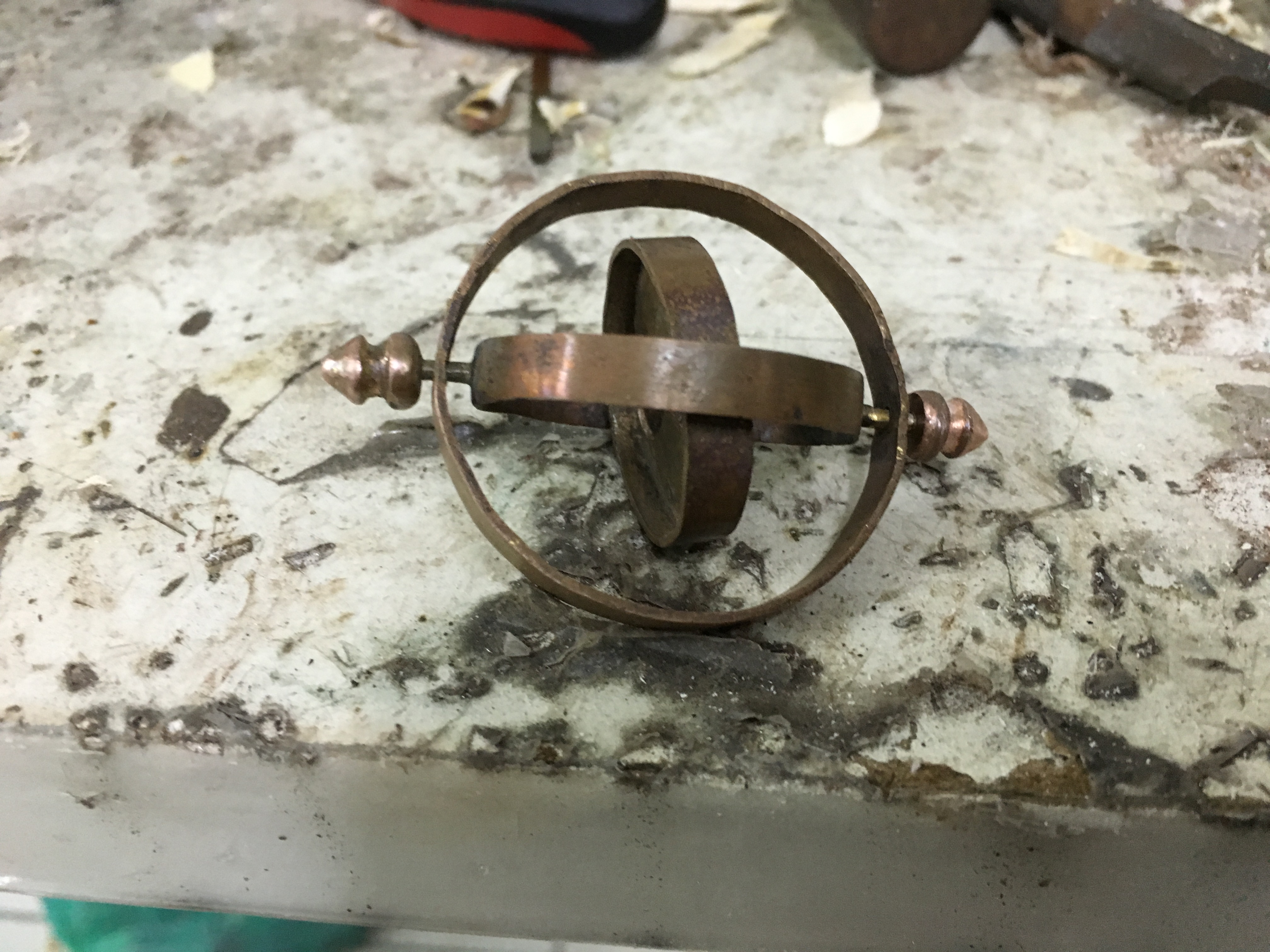

Next were the knobs. These were created by sawing of tiny chunks of copper bar, mounting them on a drill and using a dremel disc to shape them. The tips of the rods had to be ground slightly in order to get them to fit on the ends of the rods. The knob on the right still needs some fitting so that the final piece can be symmetrical. I plan to use some sort of glue on the knobs to secure them better, as I am afraid any further soldering would risk ruining the piece (please excuse the dirty work space).
As you can probably tell the middle ring looks weaker and thinner than the rest, which is due to excessive sanding and hammering (I'm still new to this kind of work).

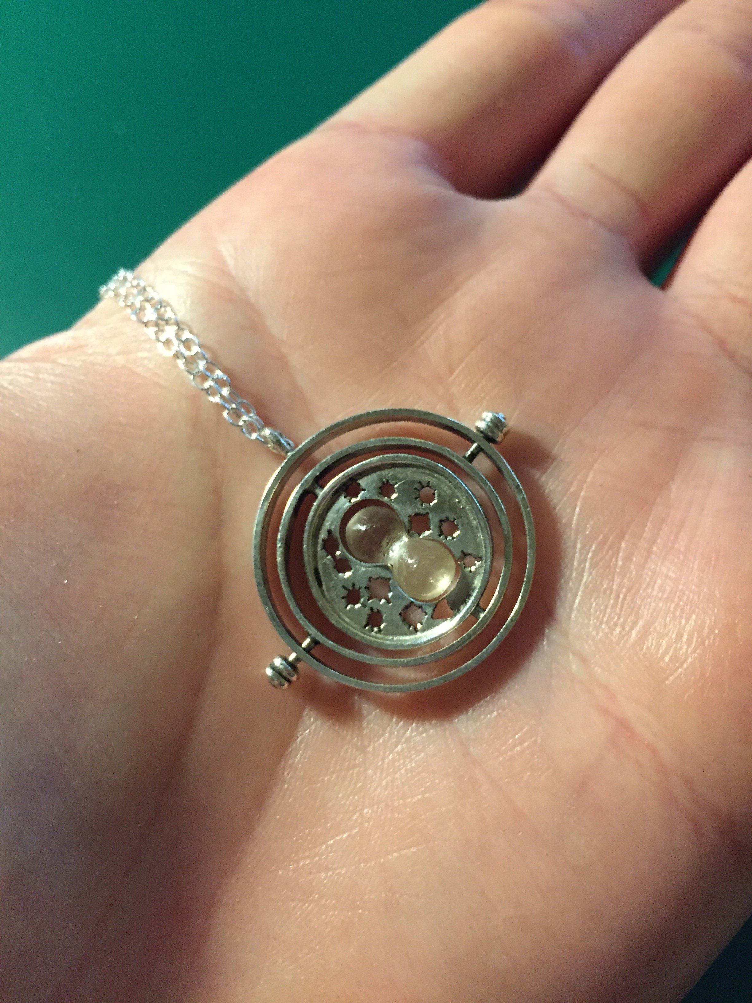

I made my (not screen accurate interpretation) in silver, which I have a bit of prior experience with. Your construction looks pretty much the same as mine, though.
As for advice, I'd try hammering the rings around a mandrel of some kind. I used a rolling pin among other cylindrical things, it really makes a difference to the look.

For the hourglass I just carved and polished a chunk of clear acrylic cylinder. I have toyed around with glass since, but I was concerned about it shattering since I don't have any experience with glassblowing and I made it as a gift. I'd prefer it to be a working hourglass in there for my next one, so I've been experimenting with reshaping the glass pipettes from dropper bottles. If you've got a blowtorch it's surprisingly easy to melt thin glass. In fact, there's still some drops embedded in my cutting mat to attest to that fact.

Completed silver time-turner.
Thanks for the interest! Glad you liked it. And may I say that is one beautiful time turner, I think it looks great in silver.

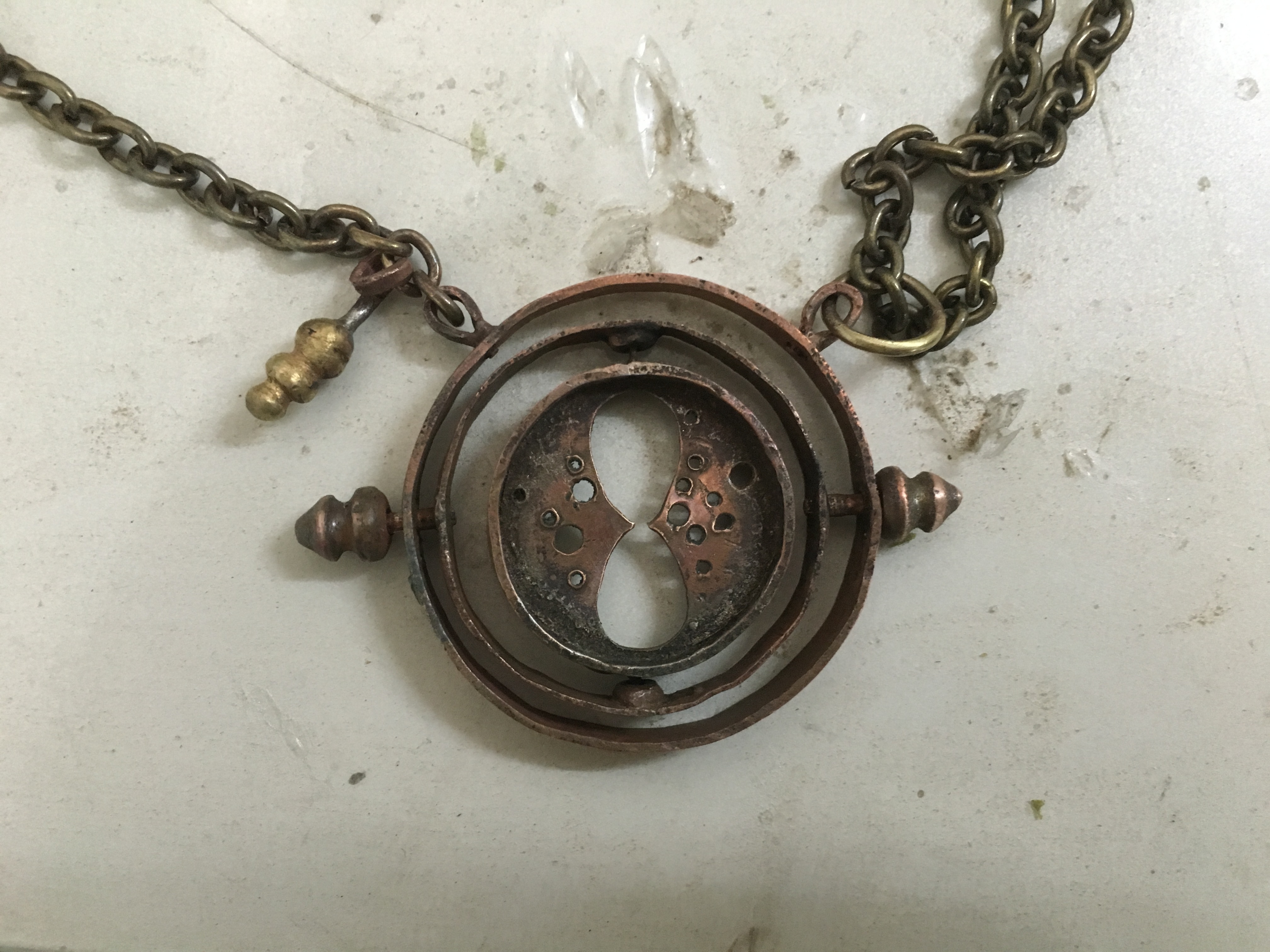

So i'm nearly finished with all the metal parts. The triple bead and chain rings have been added (although I might redo the bead later, i'm not entirely happy with how it looks), and of course the chain itself, though by looking at the screen used prop i can tell the chain probably should be slightly thinner. As you can see I've just started drilling the holes in for the stars, but i think it'll be a bit more of a challenge to try and get the actual star shapes cut in. i don't have a jeweler's saw so I'm planning on doing all the shaping by dremel and possibly diamond files. Also, I'm not really planning on making the star pattern perfectly accurate.
