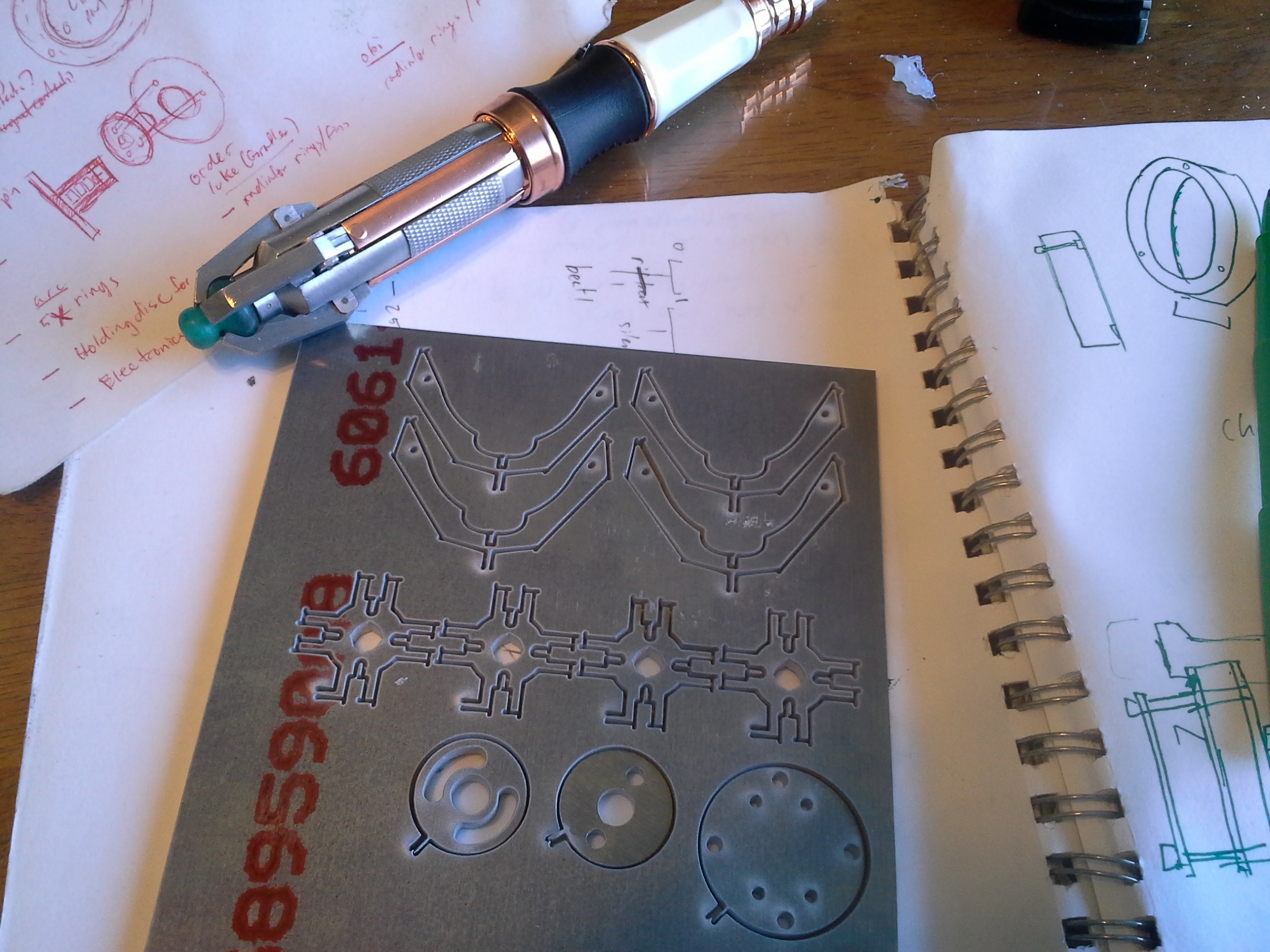

I have one extra set of the waterjet claws at the discount price, so the next person to order a deluxe sonic will get theirs for $520. After that, price goes back up to $555
Re: Completed 11th / 12th Doctor Sonic remote conversions + extra parts *price drop*
Hey guys. Just touching base with everyone. A number of you have Sonics and upgrades pending and its taking a bit longer than we all would like. Mostly due to a communication snafu on my part. I sent my file to the waterjet company and then sent another file concerning a different project and they thought I wanted them to halt all cutting until I gave the go ahead for the second project. Anyhow all parts are in hand and getting worked on. At least as soon as I finish typing this. To all my customers waiting on their sonics, I have been doing this for 2 years and have never let anyone down. I highly appreciate your patience and offer my apologies for the delay. and while this may seem self serving on my end, a good thing is worth the wait.

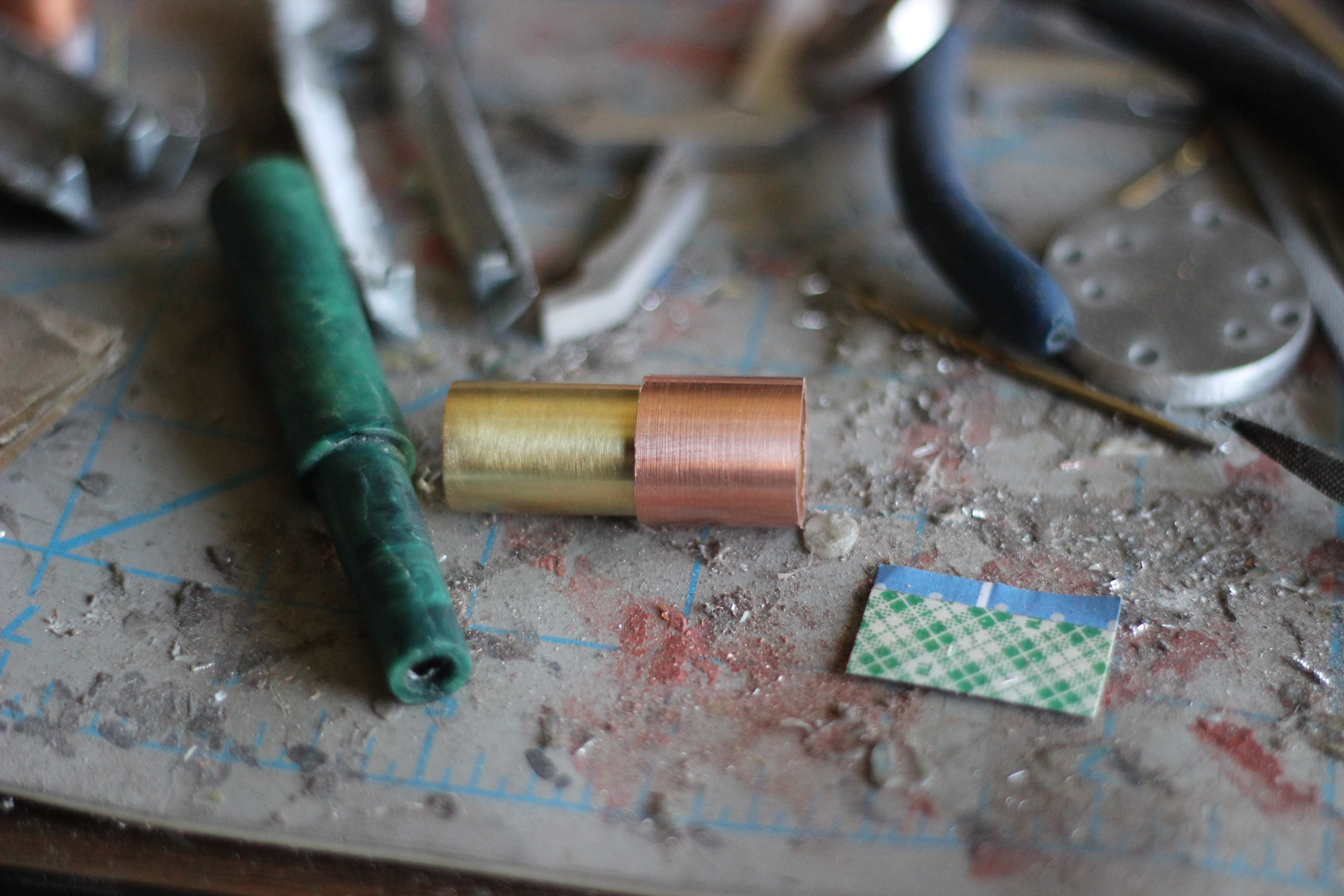

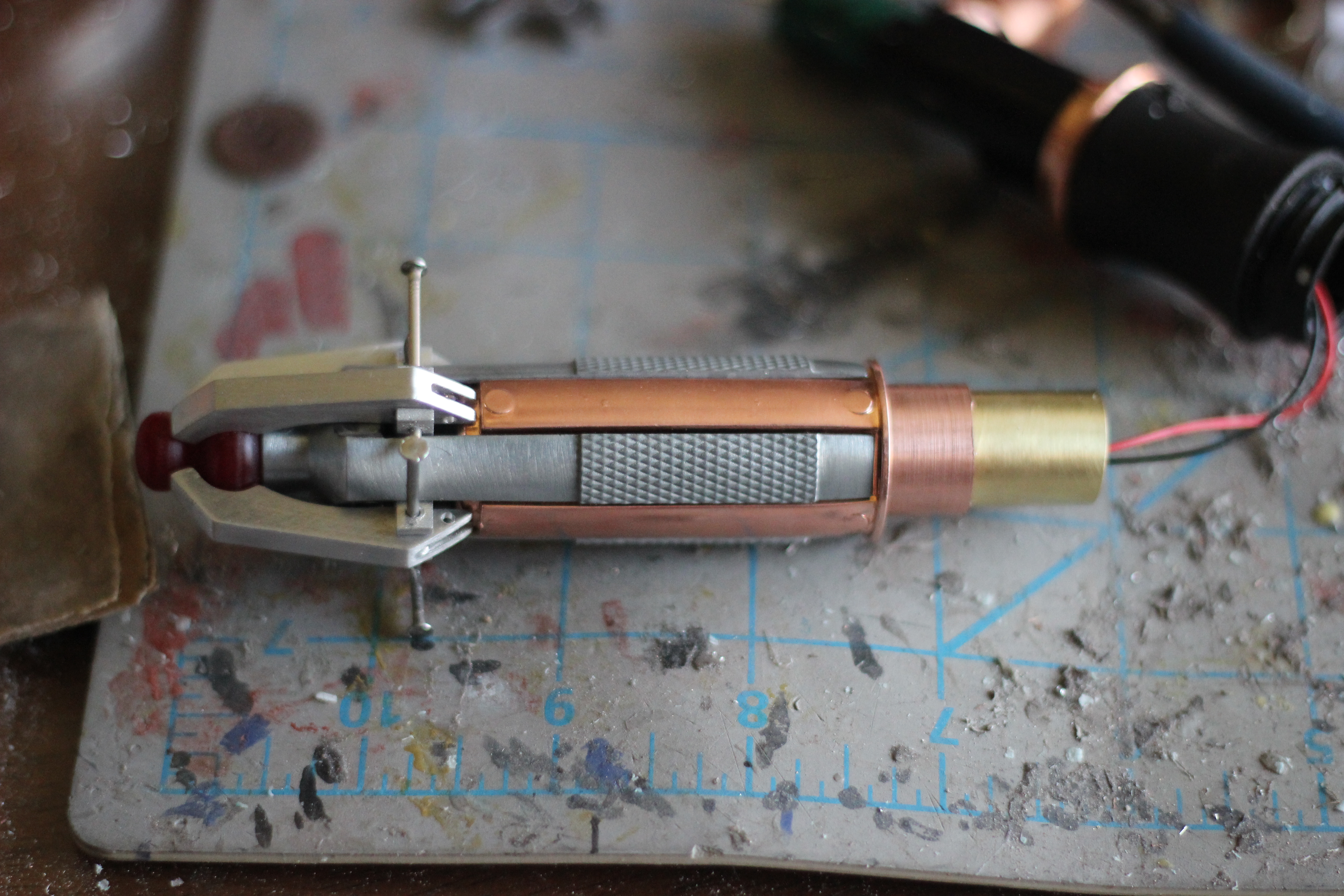

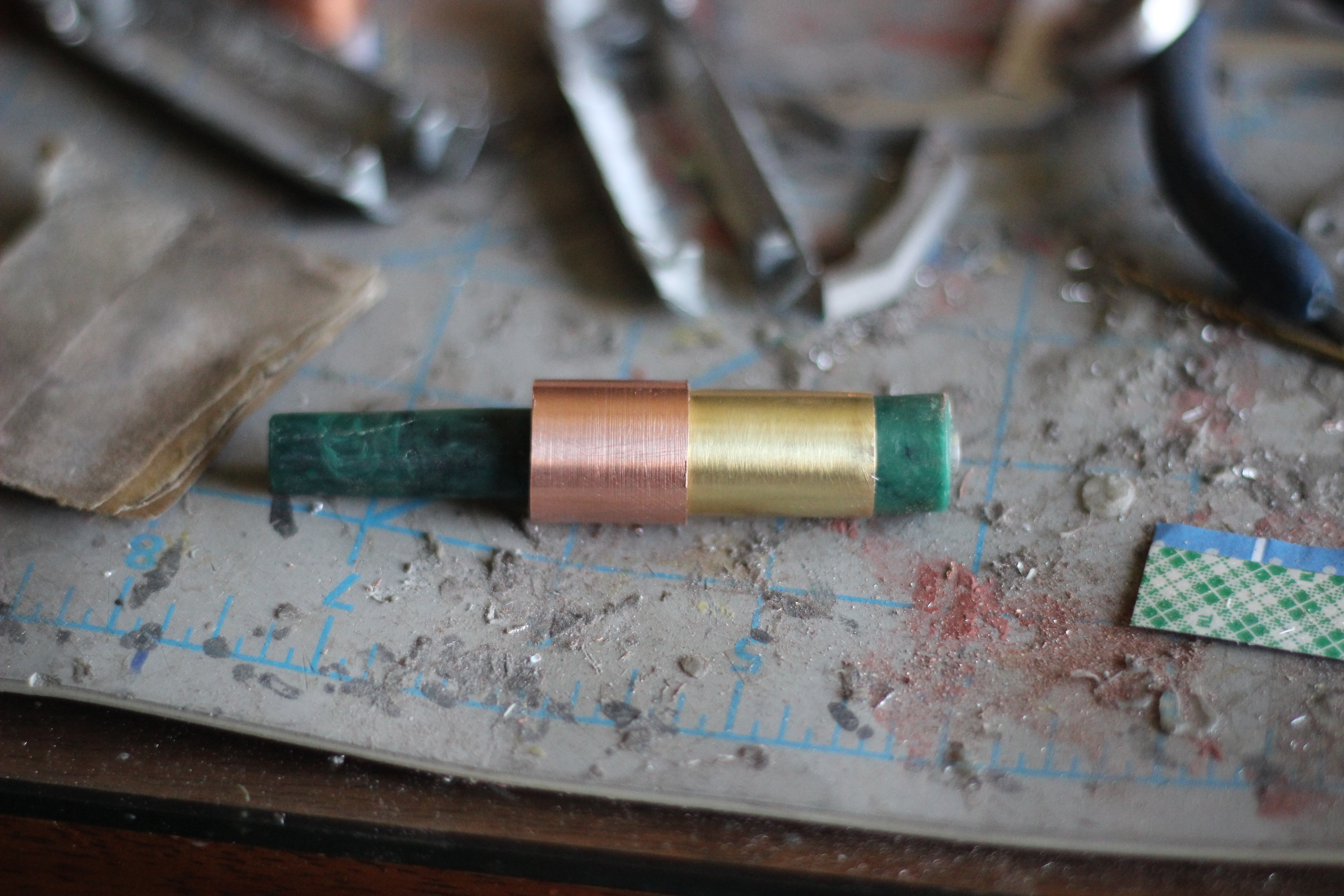

Pics of the new brass/copper attachment point between the upper and lower halves and everything fits like a glove. The connector is twice as long as the previously used ABS connection piece, as such it sits deeper into the sonic for greater stability. Makes me wish I had implemented this sooner. But hey, live and learn I guess. The assembly is held onto the copper cage via a set of brass pins, and the lower half is held on with 2 phillip screws and the entire assembly is given a generous amount of JB weld.
