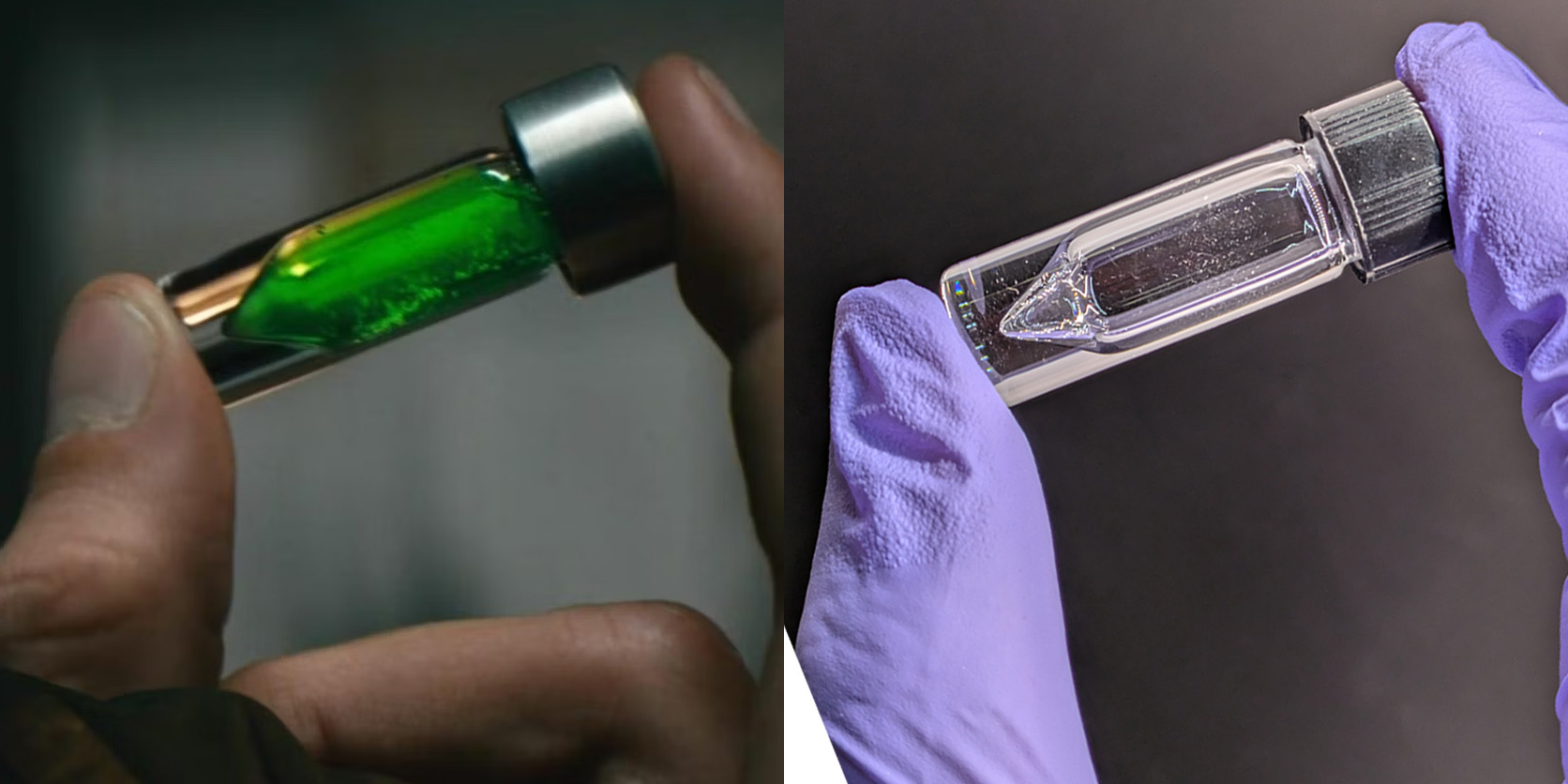

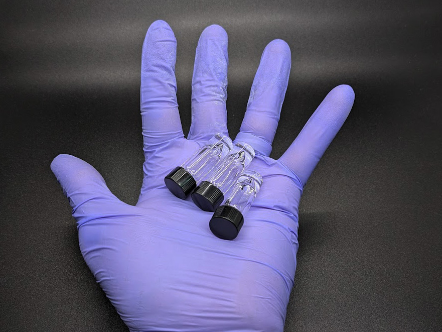

After some moderate success with the 10mL Blue Compound V Vial run, I was asked several times to offer the smaller "Temp V" vials as well.
I did quite a bit of research of photo references and measuring of protoype shapes...

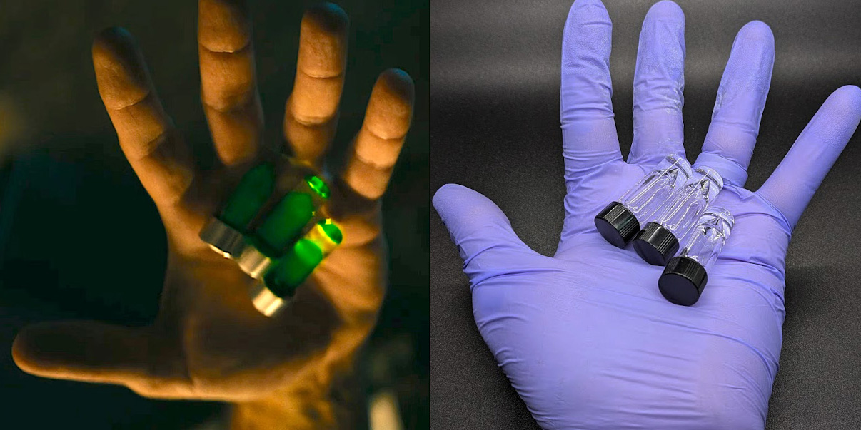

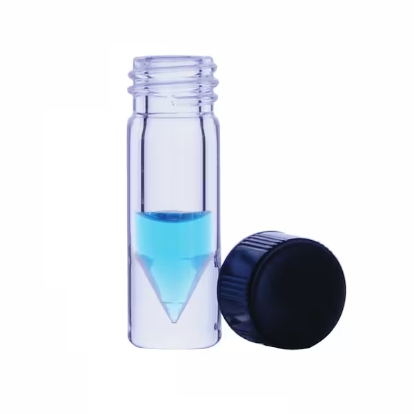

...and I have concluded that the Wheaton one-milliliter "V-Vial®" is a perfect match!
As with the larger blue vials, these glass vials with the conical internal bottom are not only insanely expensive, but also only sold in cases of quantity. It appears that Wheaton has a patent/trademark on the "V-Vial®", which means they can set the price, as is quite common in the medical and scientific industries. No wonder they waved those vials around in the show so much; they're elite!
I plan to gauge interest in a mini-run of these and do a group buy from Fisher Scientific Zoro (best price I could find) and offer them individually. I'm not looking to make a profit; I just want one for myself! I checked eBay, Amazon, Etsy, all the usual suspects, and there doesn't seem to be anything better out there. And these are shiny and new!
SPECS:
After much searching and research, I have concluded that the Boys V-Vials are 1 mL in size, which is the smallest available. Specs from Wheaton are as follows:
  • Outer Diameter: 13 mm (~1/2")
  • Height: 44mm (~1-3/4")
  • Capacity: 1 mL
  • Material: Borosilicate Glass, Type 1
They come with a 13-425 screw-top rubber-lined black phenolic screw cap faced with PTFE. The lids are partially ridged:
Additional tech specs can be found here.

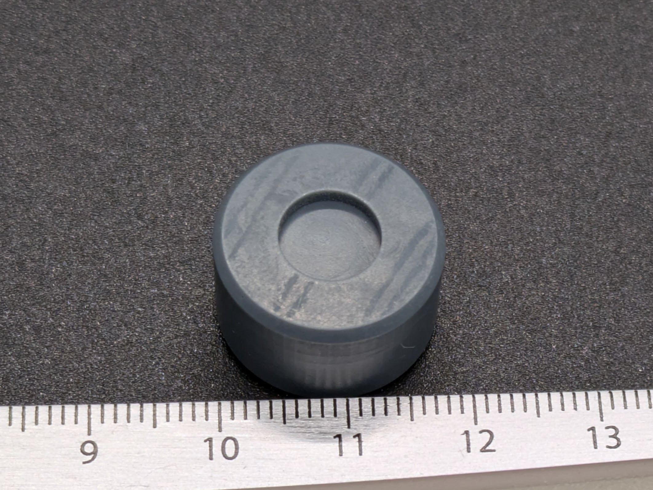

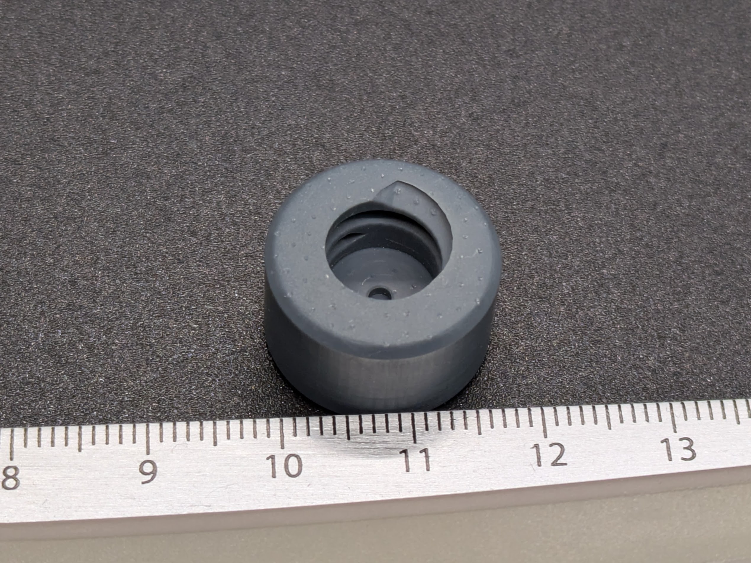

I have just been notified that the vials are on their way and should be here in less than a week!
I also have a prototype lid printing right now, but it's guesswork without a vial to test on.

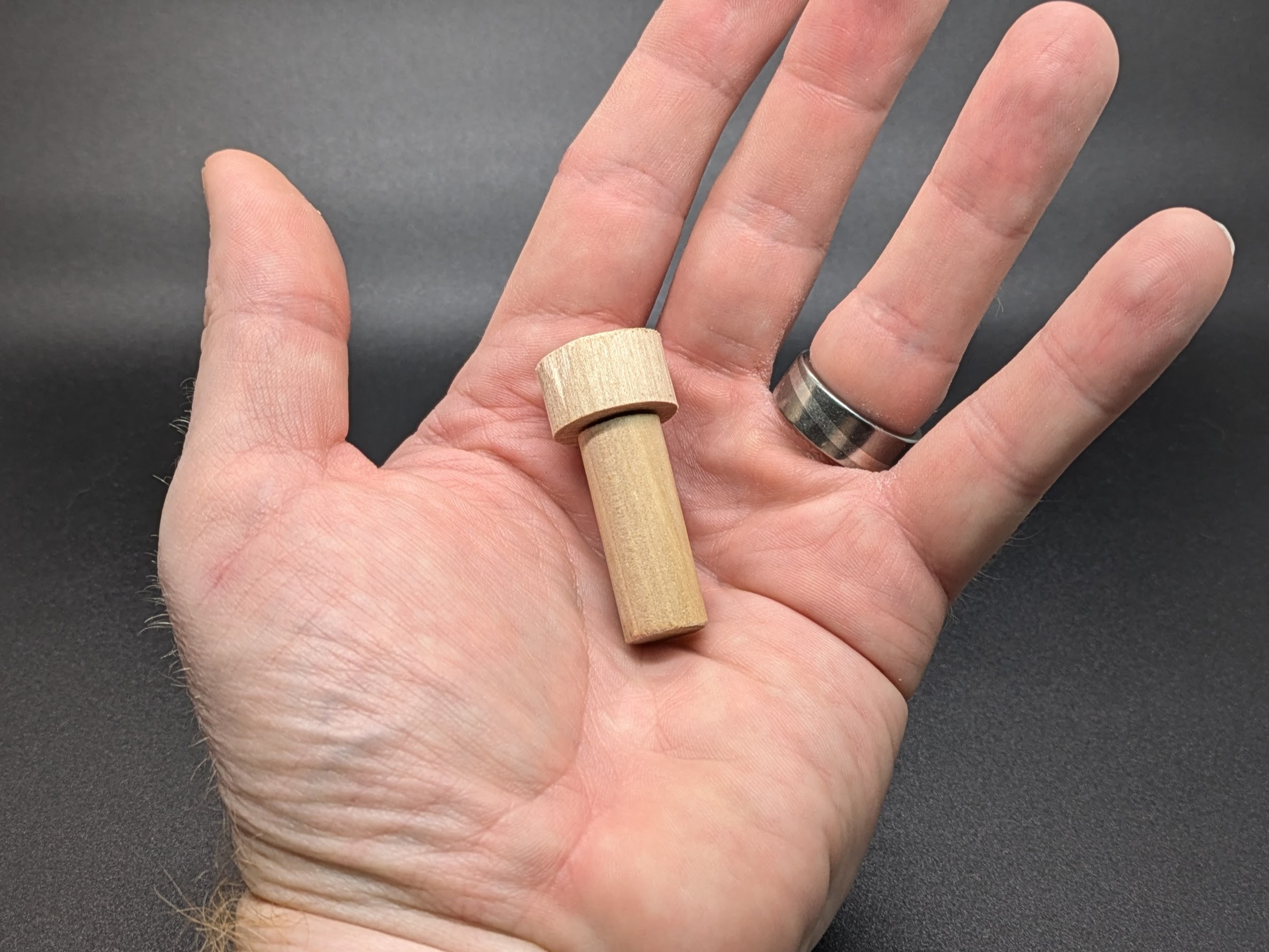

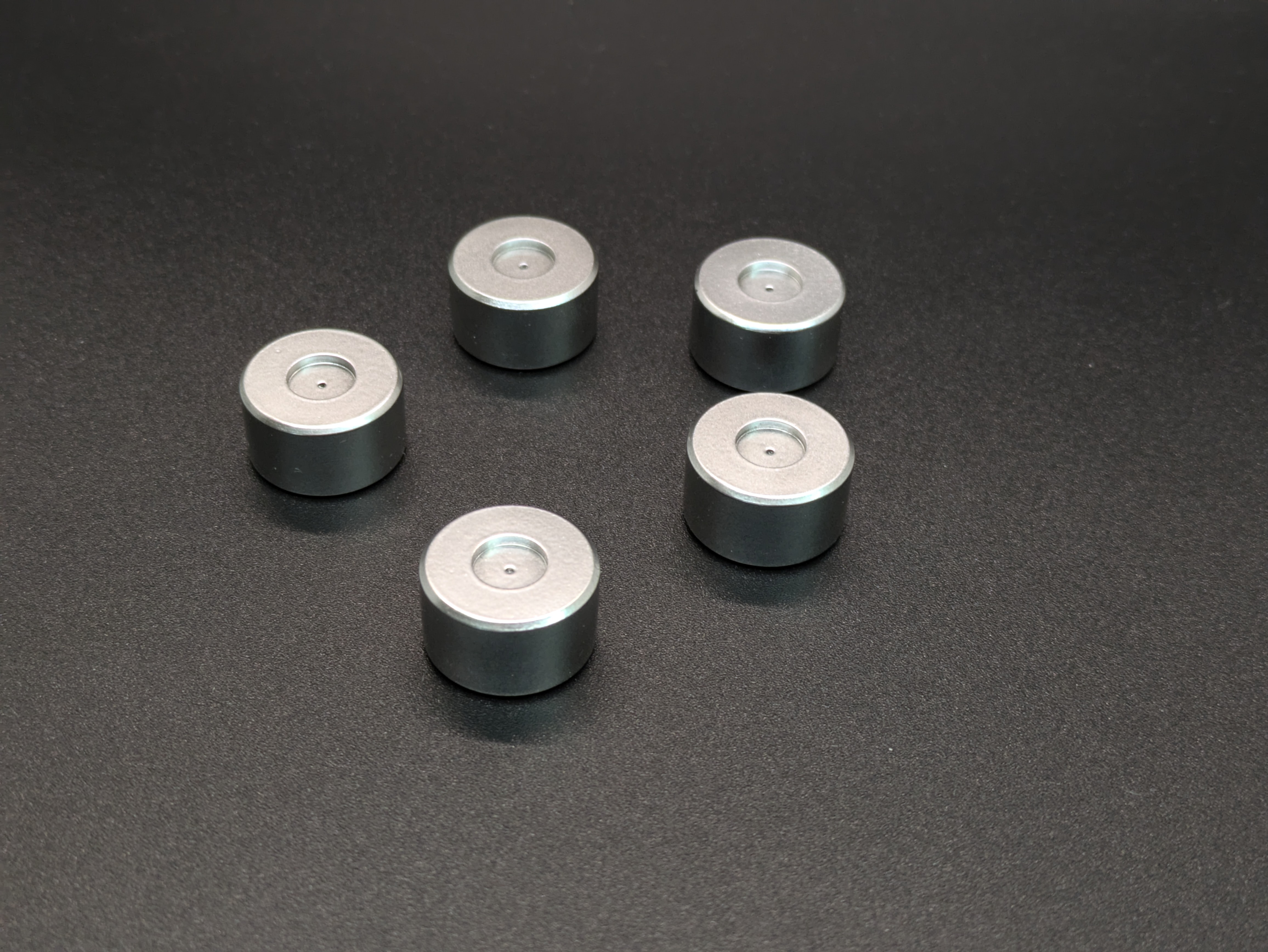

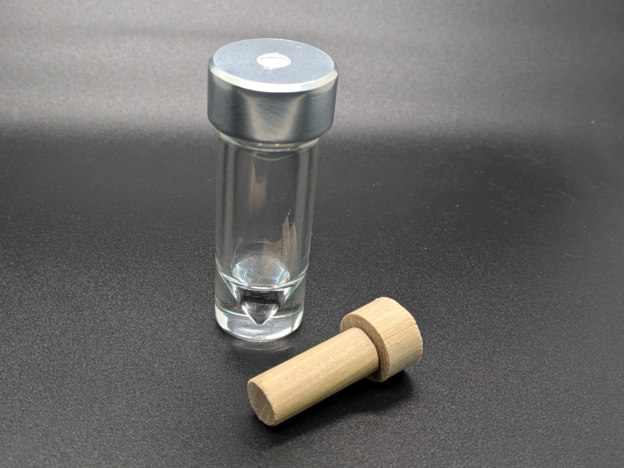

First prototype print of the Temp V lid:
The "septum" on top is the same size as for the larger vials (8mm diameter).
Won't know how it fits till the vials get here!

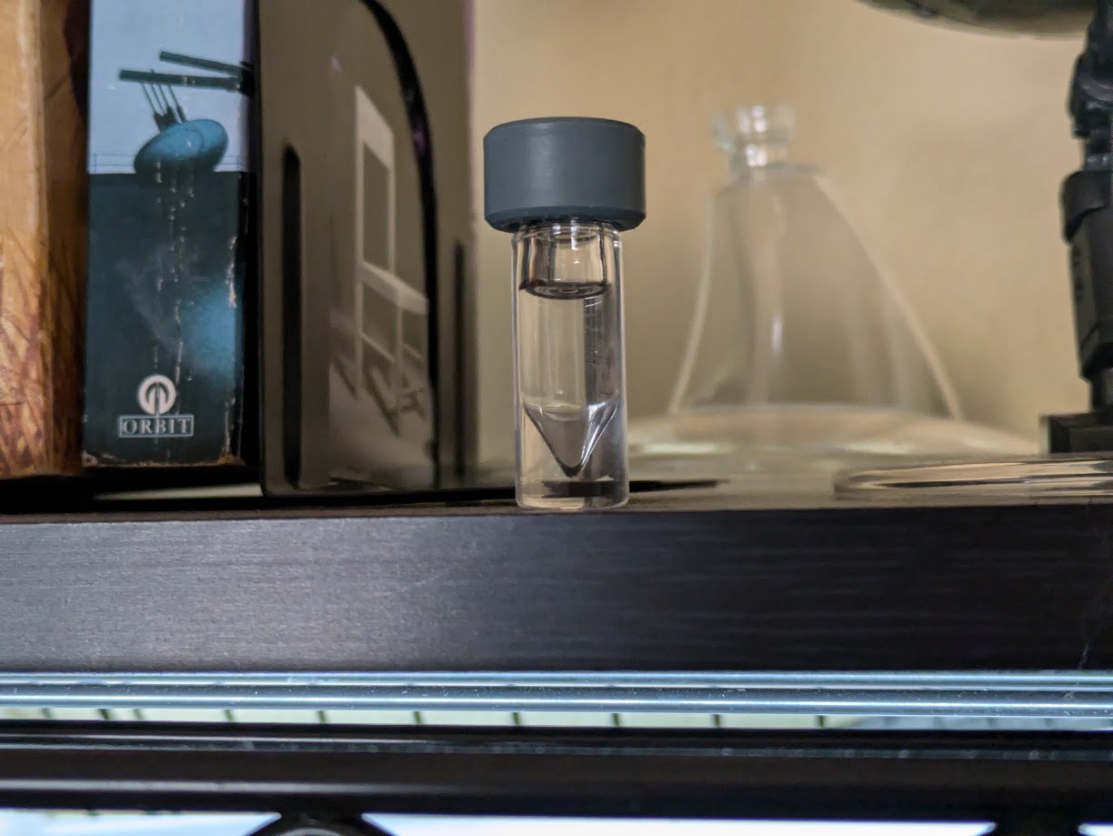

All right, it took six iterations, but I have a lid that fits!
Doing a 2-day test to see if it remains airtight with the o-ring in place. That's 91% isopropyl alcohol in there:
If the level stays the same we're golden!
Bill

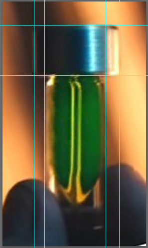

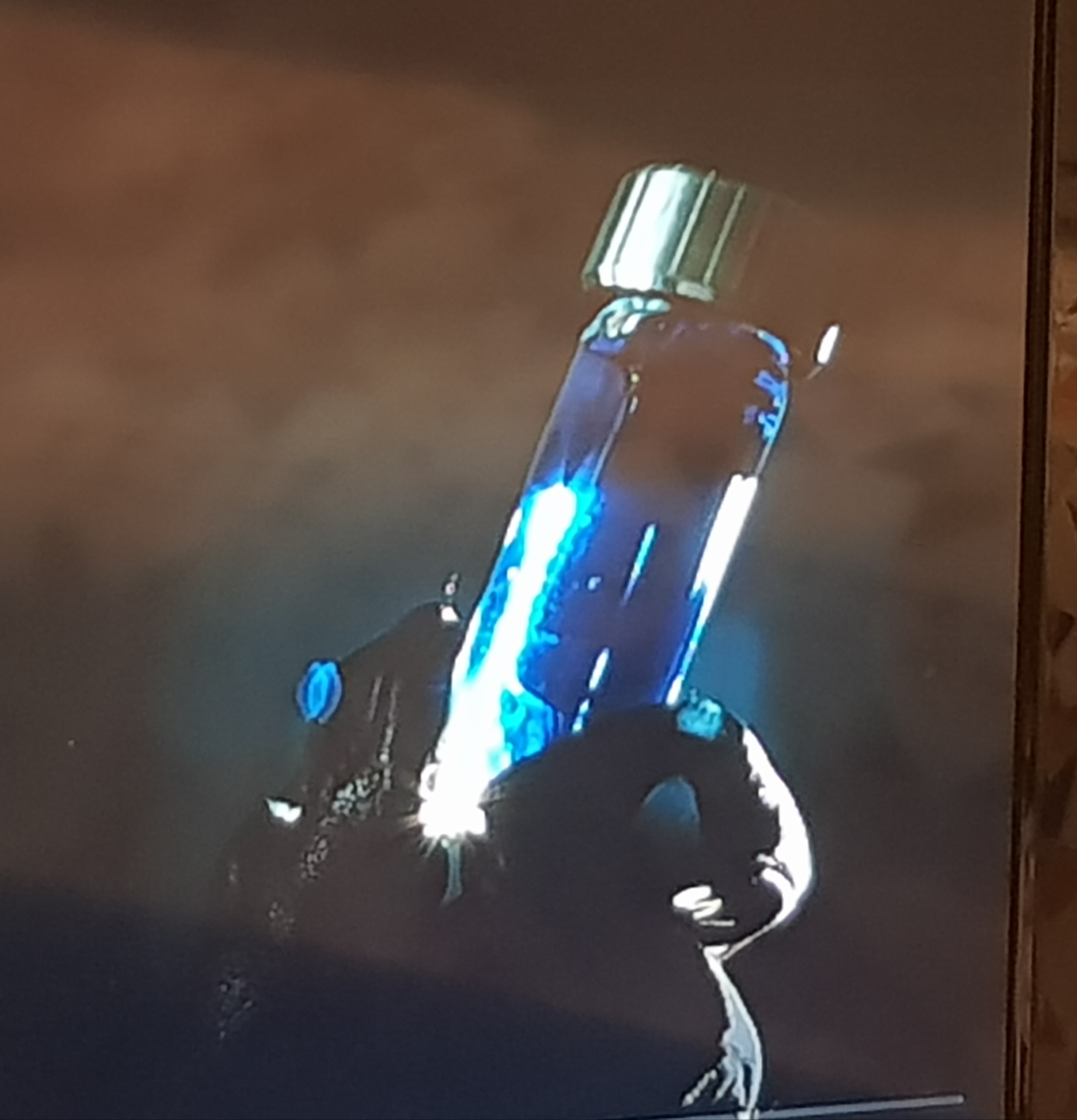

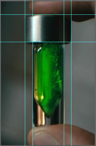

Its kinda weird how in some pics the lid looks like it has the same width in proportion to the bottles width as the compound v bottle. But in others like the main closeups it clearly looks like it has a bigger 'overhang'. Or is this just my imagination?
Totally agree, I think there were a couple different props, although shadows are very much playing tricks with us too. I think there are more shots of the bigger overhang (19mm wide) than the smaller (especially in closeups), so that's what I'm going with. The bottle is 13mm in diameter.
These were my measuring shots:
Starting with the 13mm provided by the absolute size of the vial, I used that to scale the other dimensions. And that results in a lid that is 19mm in diameter and 11mm high.
Yeah your probably right, Ive also been rewatching the show and just noticed the first compound v closeup we see (S1 Ep8) has a lid with ribs on it. My guess this is just the stock lid painted. But then it definately changed from season 2 onwards to most likely a custom lid, just like youve replicated.
But yeah I think youve done great work trying to size these as accurately as possible. And going with the more frequently and clearly seen bigger overhang version i totally agree with.

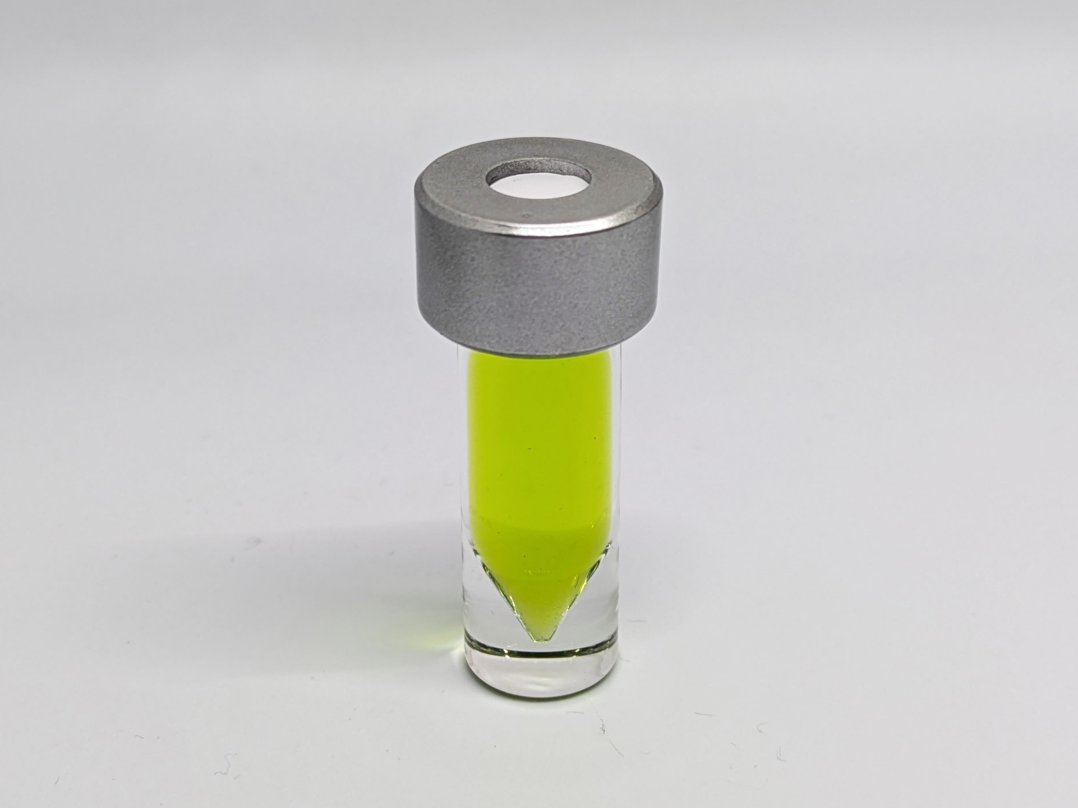

Confirmed, the lids are nice and airtight, although I will recommend giving the o-ring a thin coating of petroleum jelly (Vaseline) or silicone grease before using it. This ensures a tight seal.

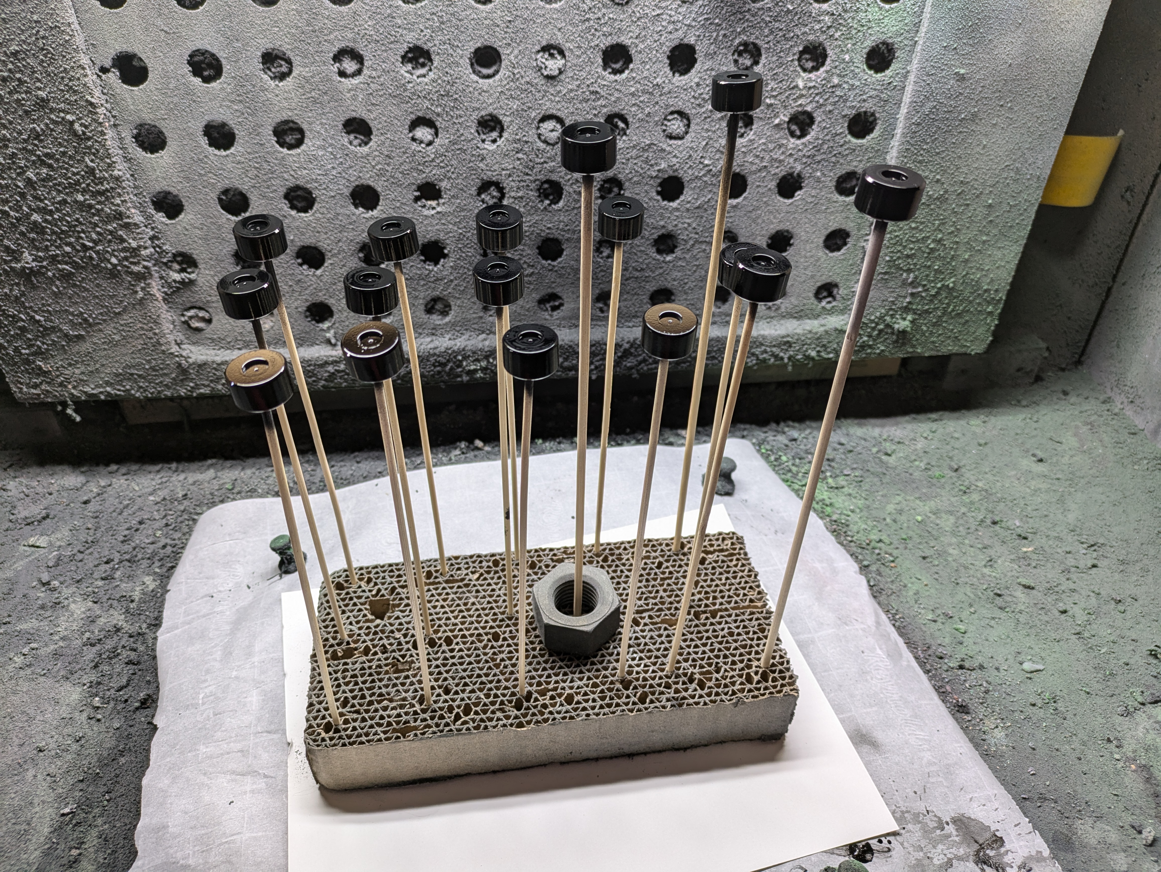

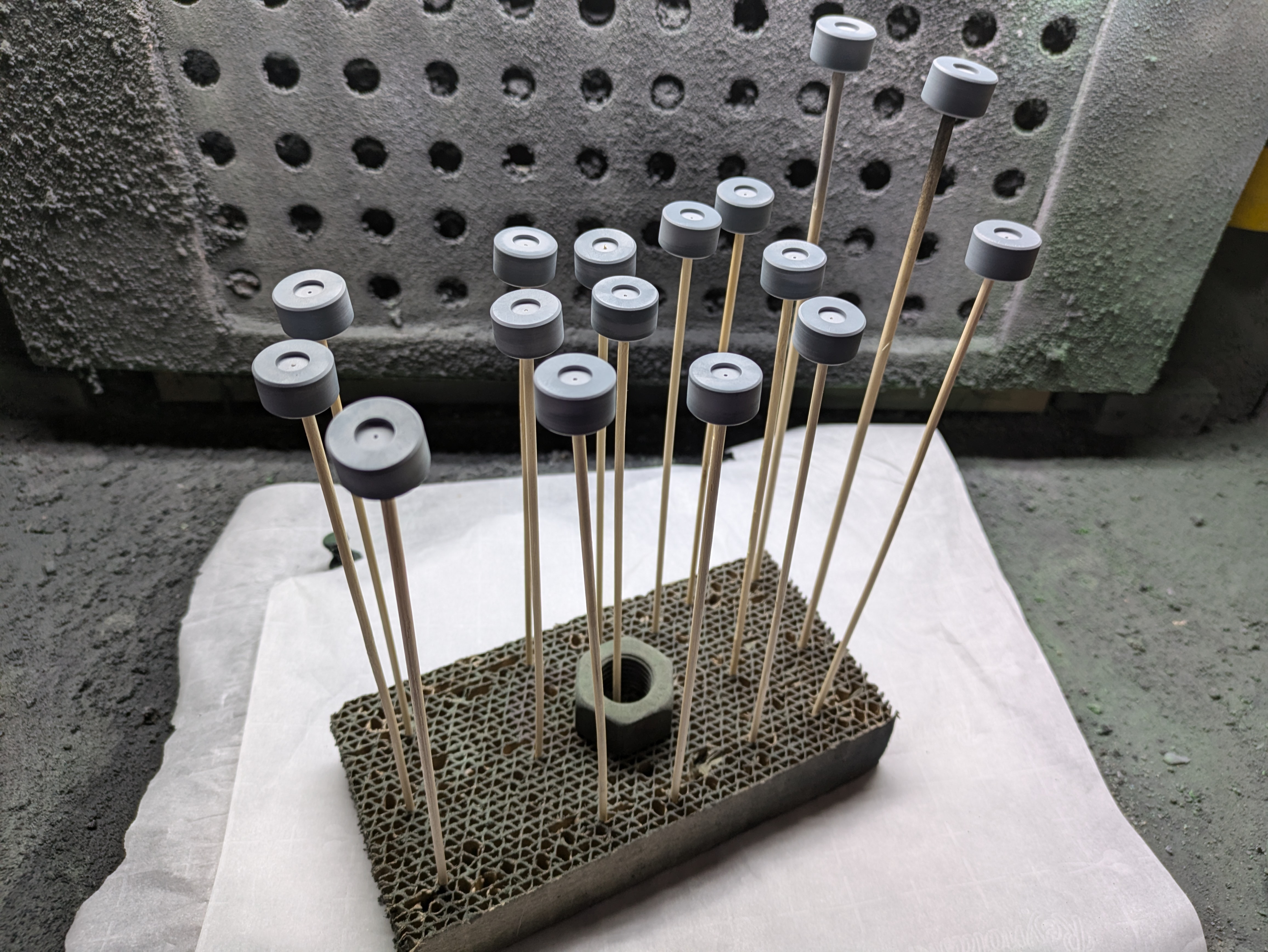

Painting lids this week!
Lids have been sanded, primed, fine-sanded, and washed. They won't be touched again by human hands until they're finished!
Next step: Alclad II black gloss base via airbrush.
Lids have been painted in black gloss:
Next step: Tomorrow they'll get airbrushed in polished aluminum, and clearcoated.
Some of the caps came out okay, most didn't. These are the good ones:
It'll be 2-3 more days while I print a few more and try for better.
Thanks for your patience!
Looking to finish painting lids today, for potentially shipping out tomorrow. Watch for a DM from me!
