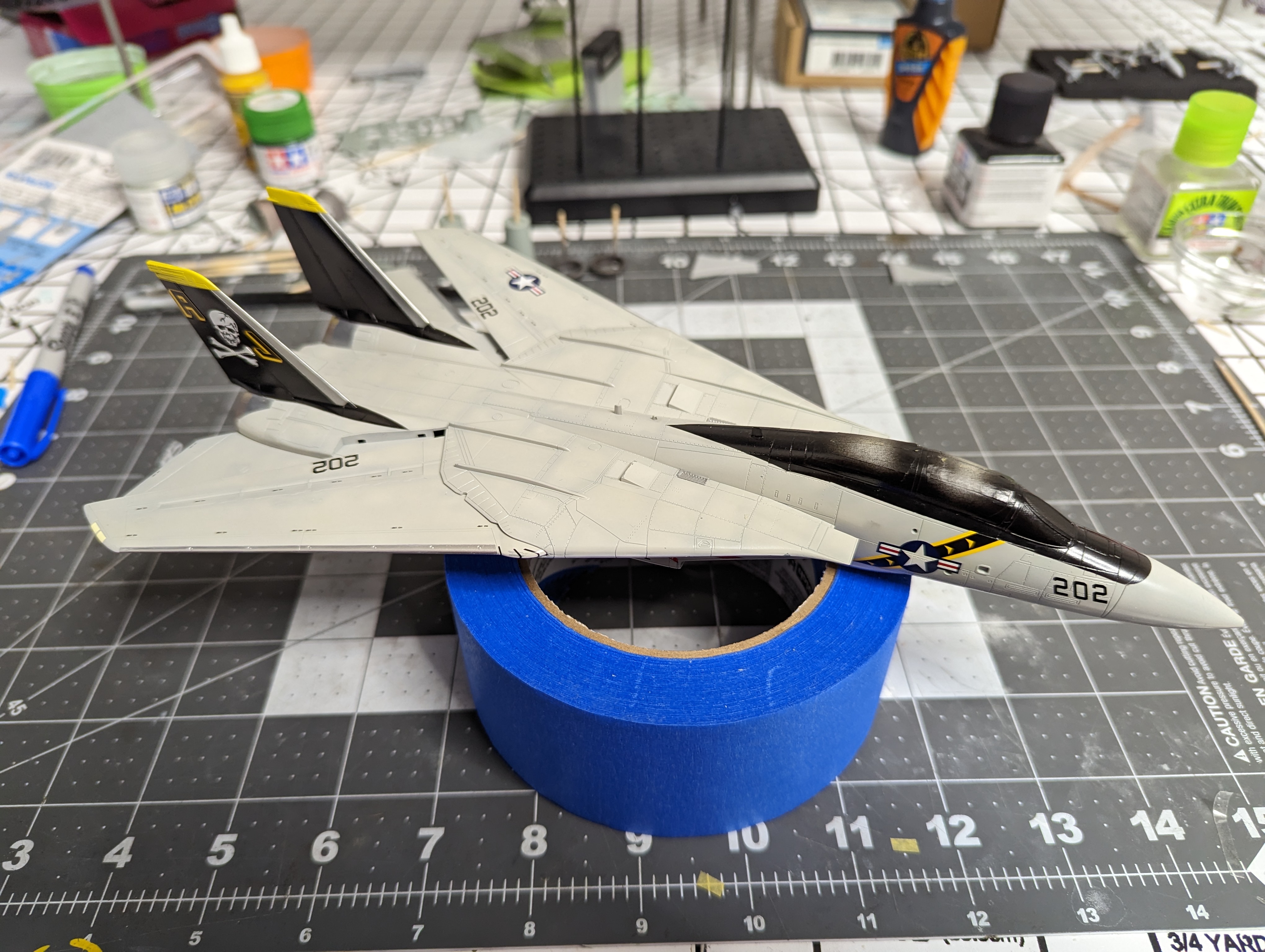

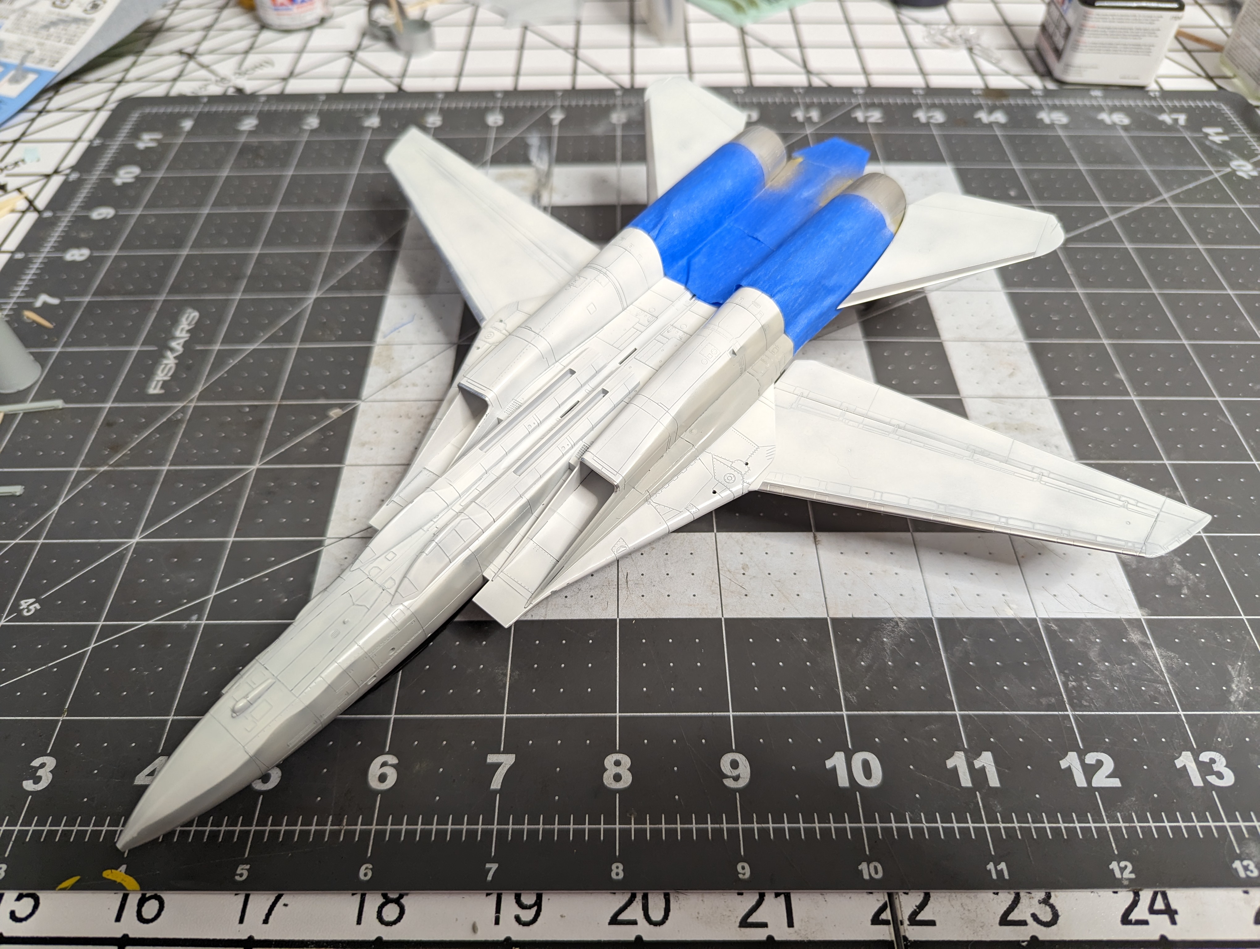

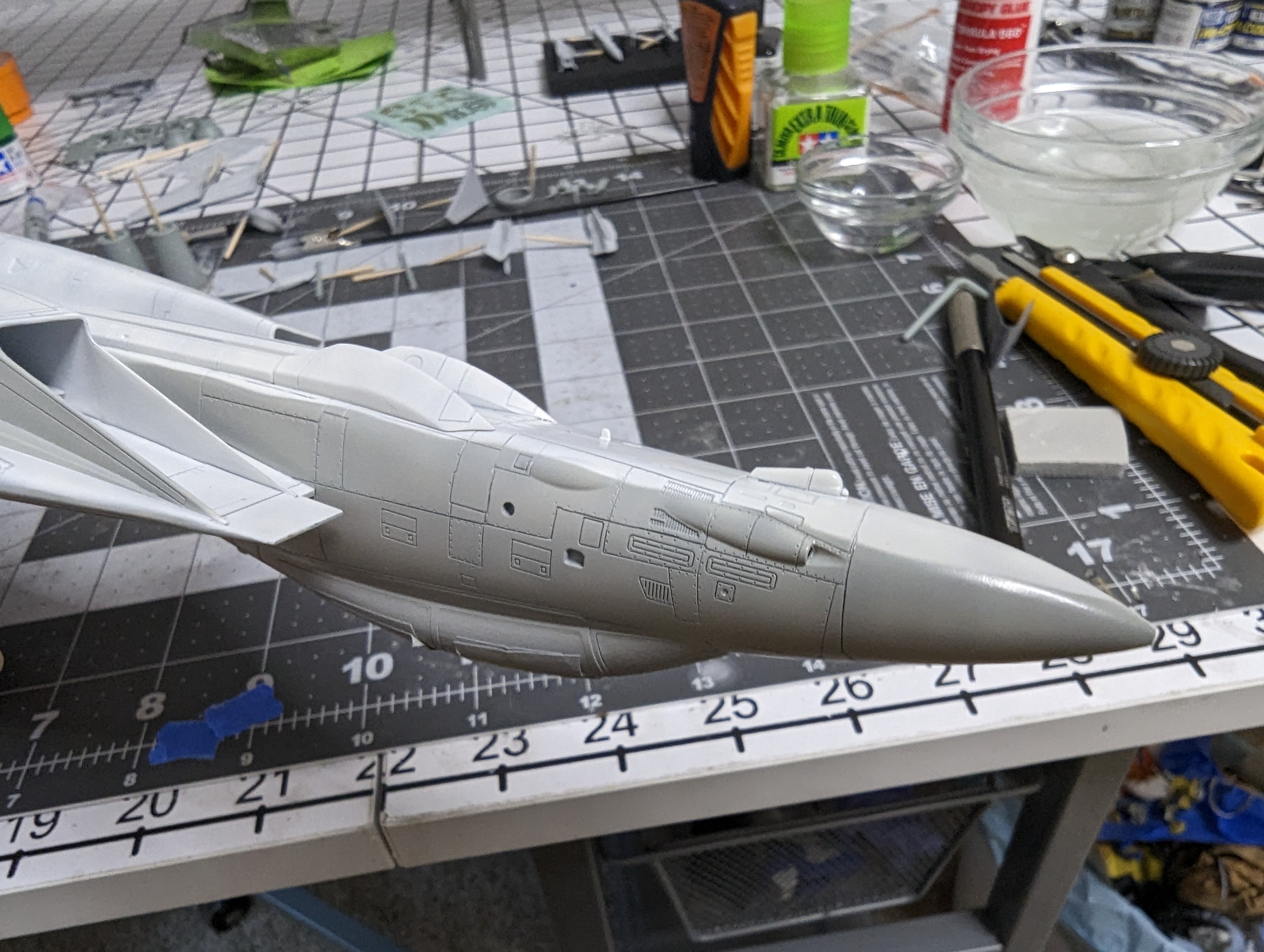

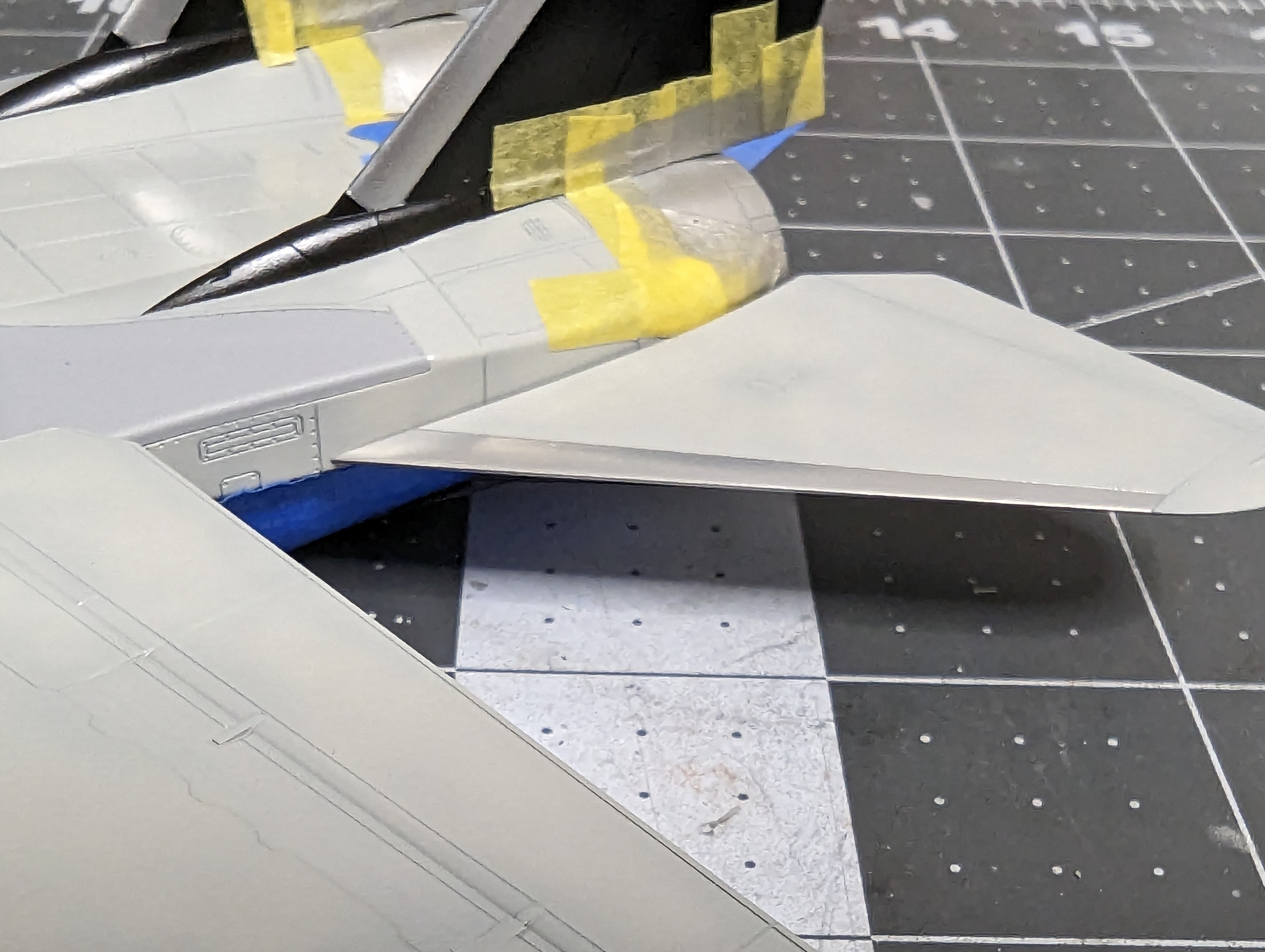

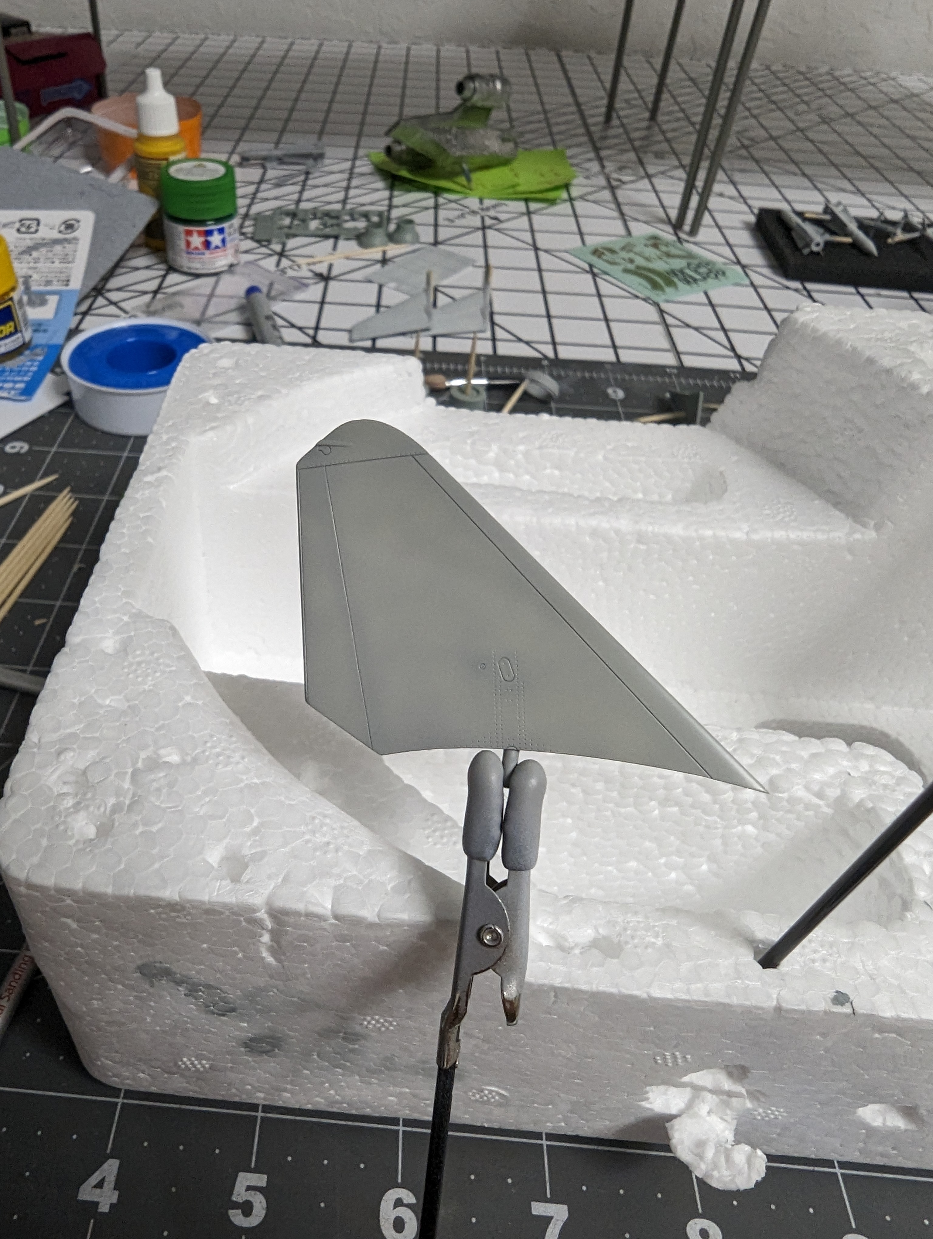

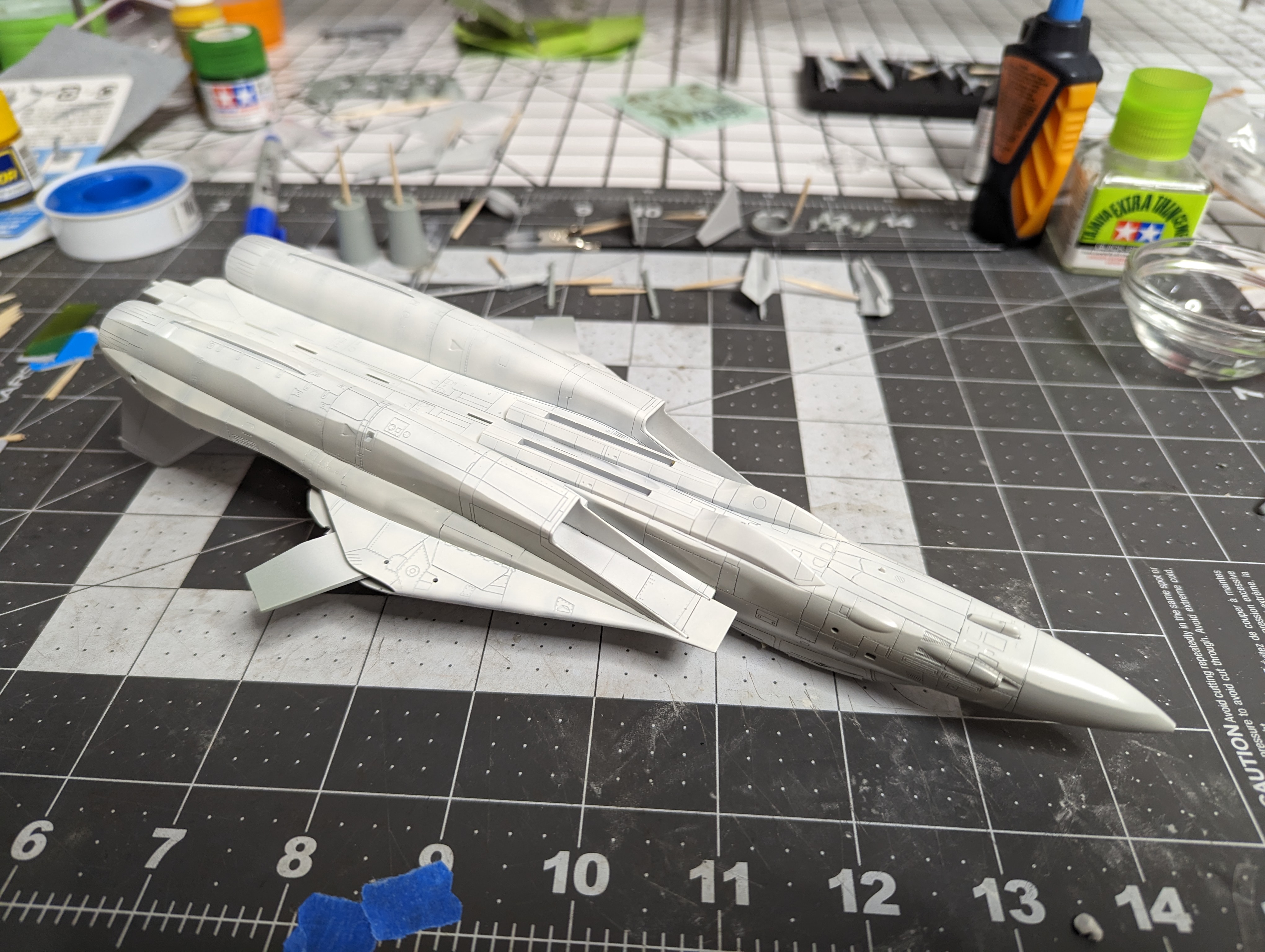

One last pic for the night. The paint is dry, if not fully cured so I did a quick test fit of the wings and horizontal stabs and it's really starting to look like proper 'Cat.
One helpful commenter on Reddit pointed out something interesting that I totally missed. These birds didn't have the white upper surfaces on the horizontal stabilizers, flaps, and spoilers. I don't know how I didn't notice with the amount of times I've gone over the film footage. I prefer the white on the upper parts, but I won't have to mask the spoilers, so that does make things easier.

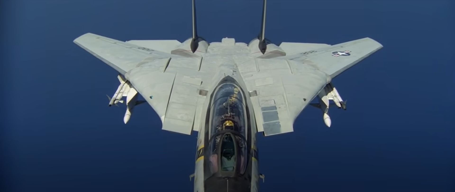

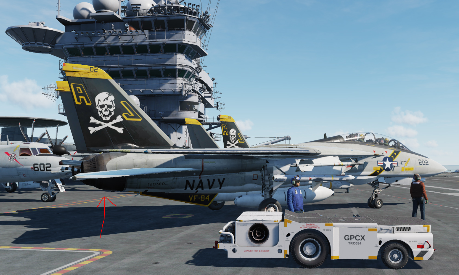

Yeah, it can be tricky to tell colors for sure from a photo, the angle of the light can make a huge difference in the perceived tone. But I think this shot from the film is reasonably clear, the flaps spoilers and horizontal stabs are all about the same color and the missile pylons are definitely different.

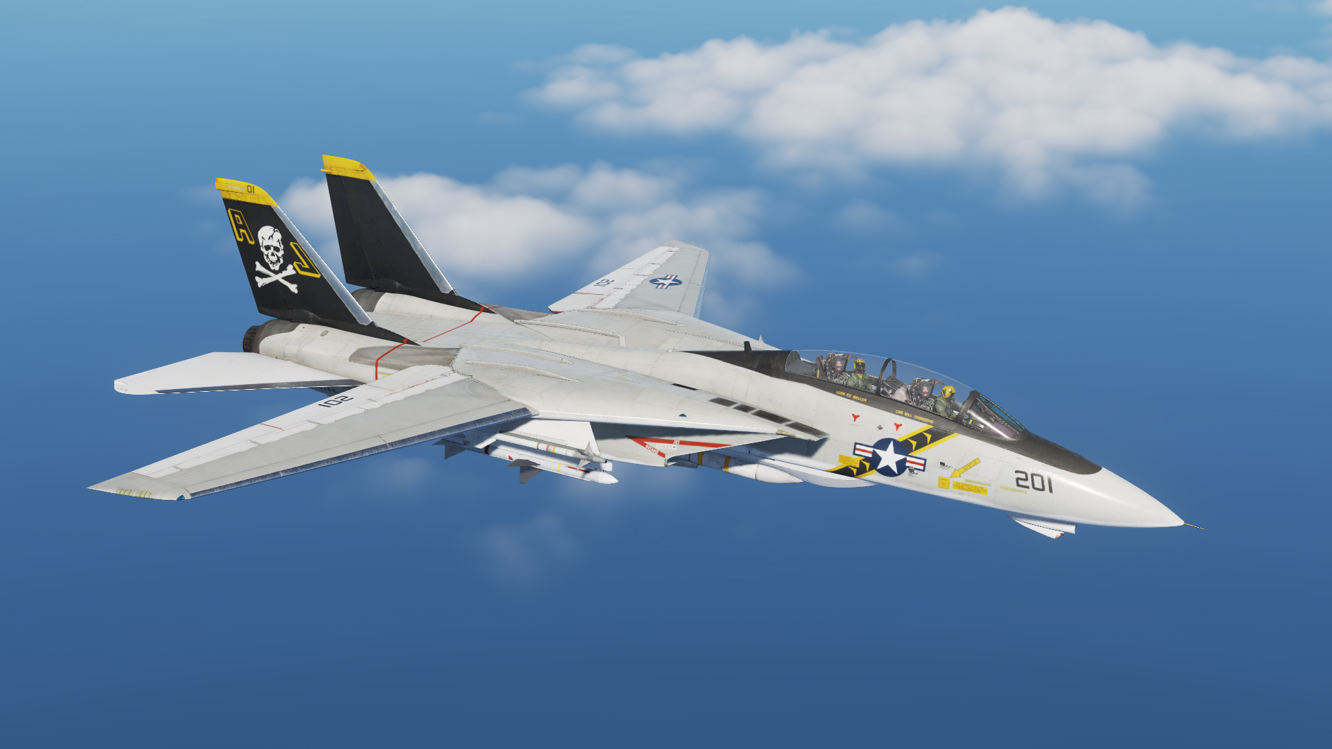

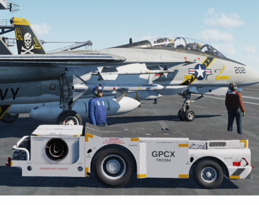

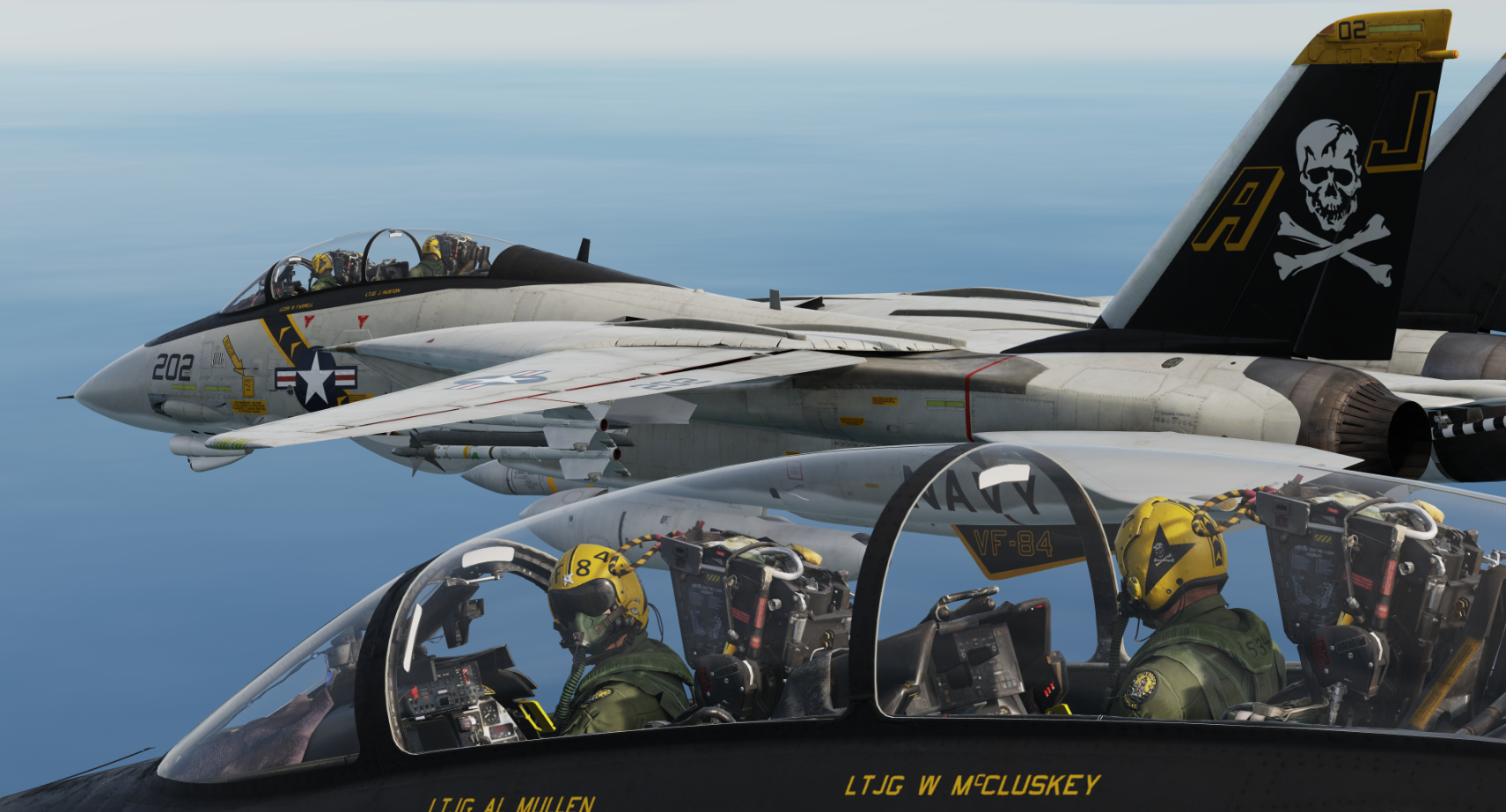

Hm. Those look like 3D renderings, not photos.
Yes...manipulated for sureo_O
The one at the top maybe, but the other three I do not think so
although at first glance it looked like the tractor was badly edited in and there are weird floating people, but the top of the tractor deck blends in so well with the color of the flight deck that it creates that illusion of their legs/feet being cut off in mid air :lol:

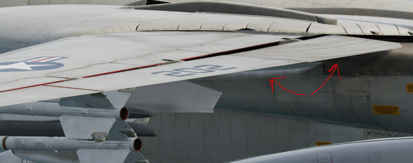

I believe they're in-game renders of The Final Countdown F-14A skins from the DCS flight simulator (the fidelity is extremely impressive). Also explains why they would come up in a Final Countdown F-14 image search.
They are pretty impressive renders
Definitely. The only reason I knew of the DCS skins is because of the Reddit user that pointed out the all grey uppers in my WIP thread there. He mentioned that he found out about it because he saw the DCS screen grabs and thought all grey was wrong, but after researching it turned out to be correct (as we noticed from taking a closer look at the film footage).
Not to knock 3D illustrations (wish I could make them!), but drives me nuts how often a Google image search surfaces these types of renders (they're often the top hits) whenever I do a search during a build and need actual, accurate photos of aircraft.

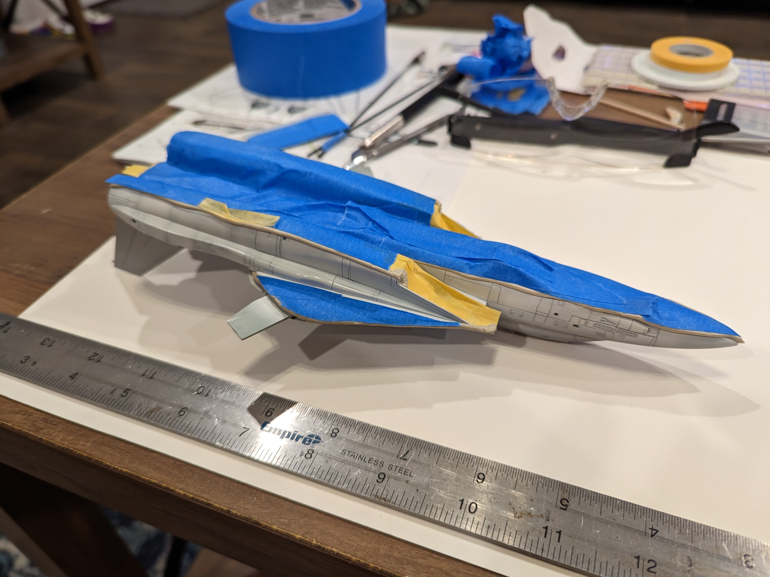

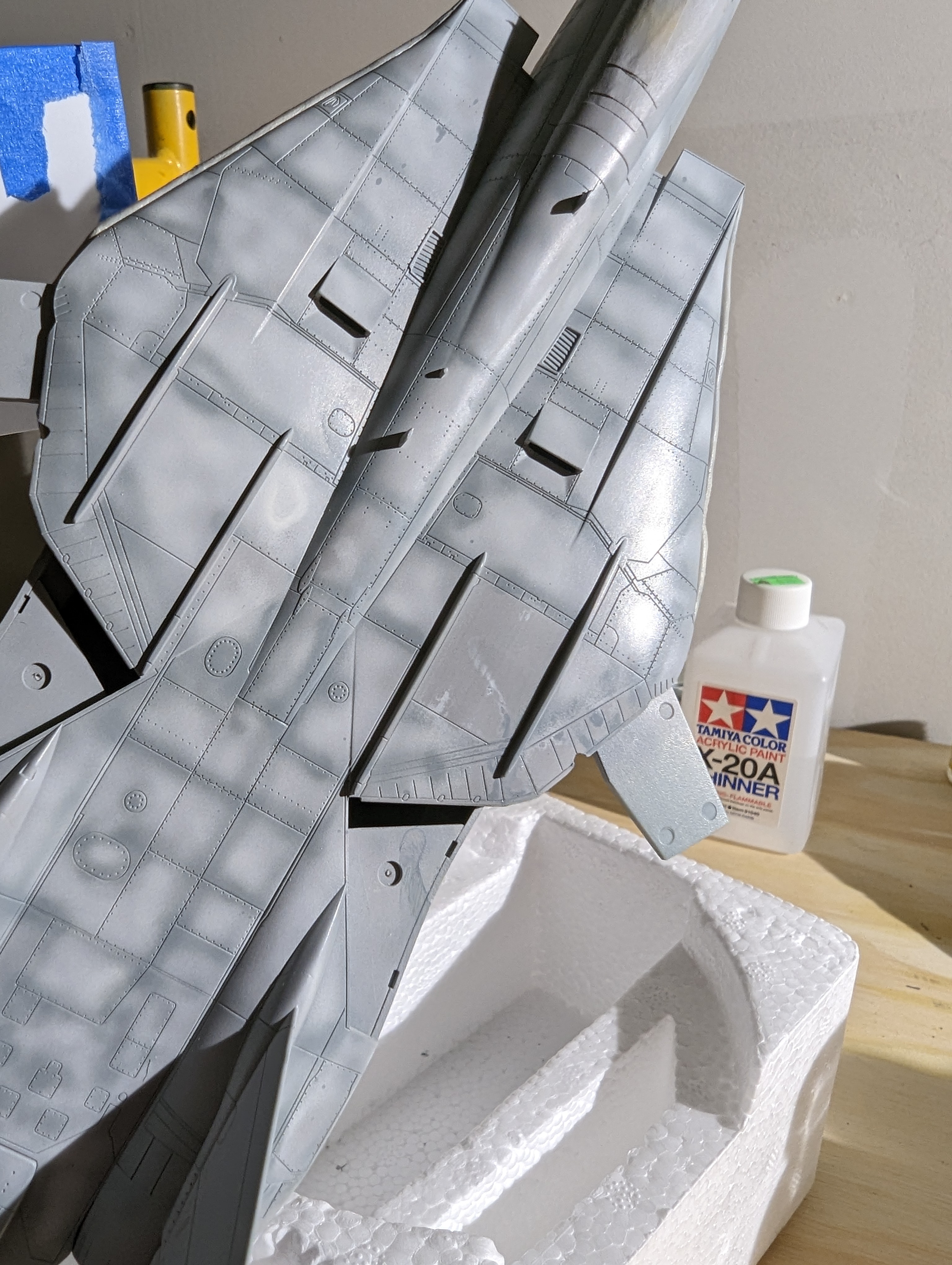

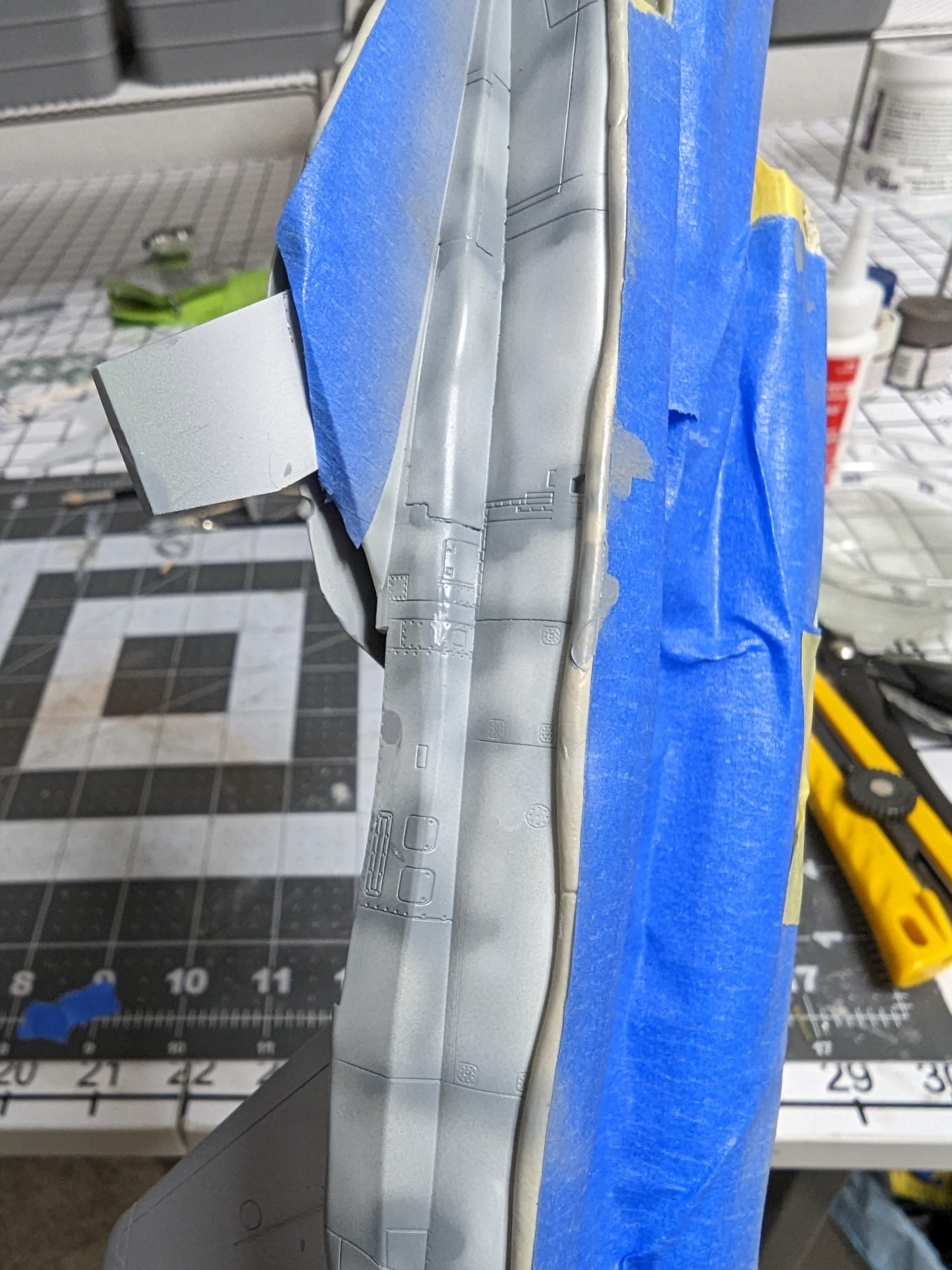

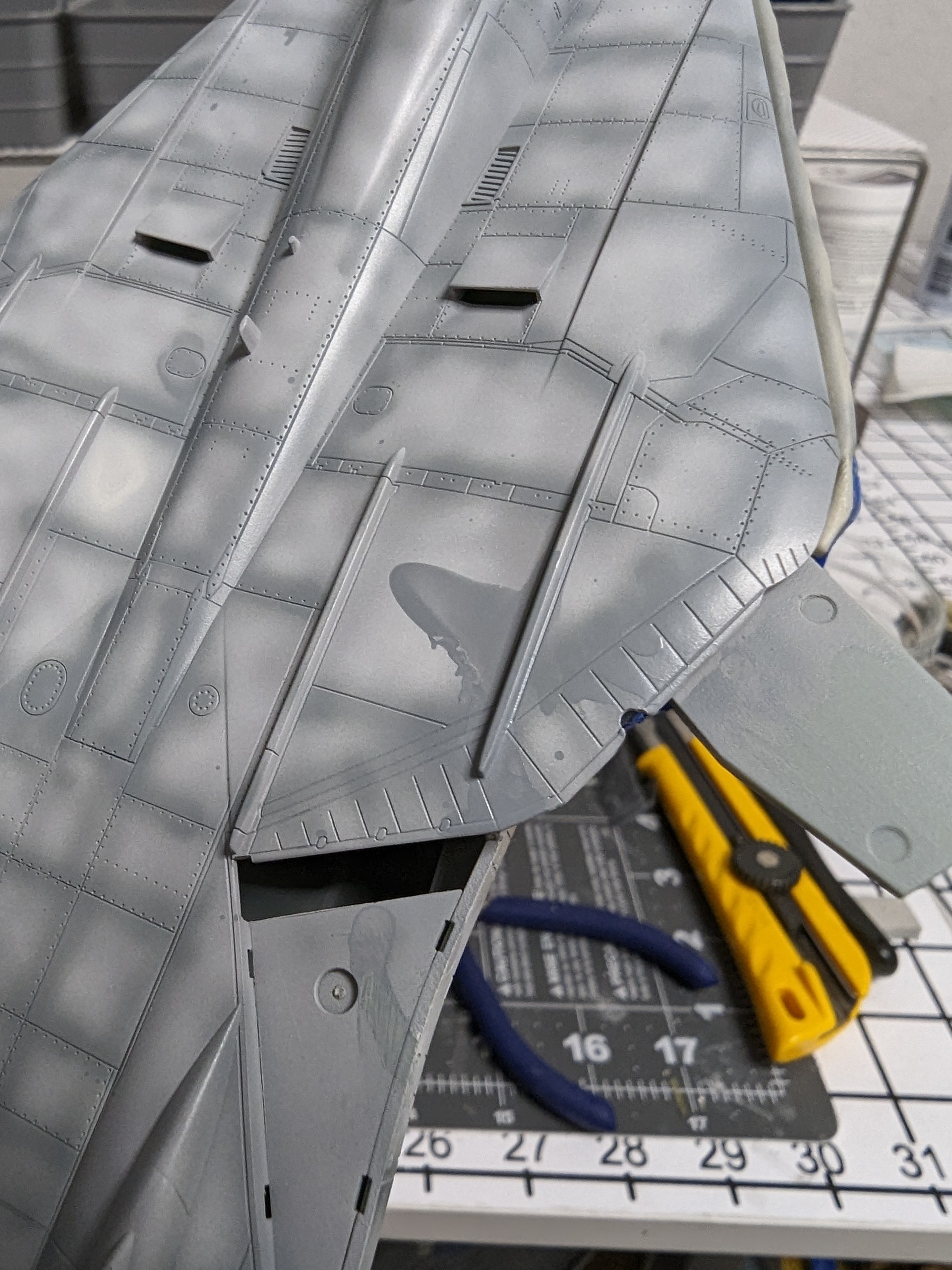

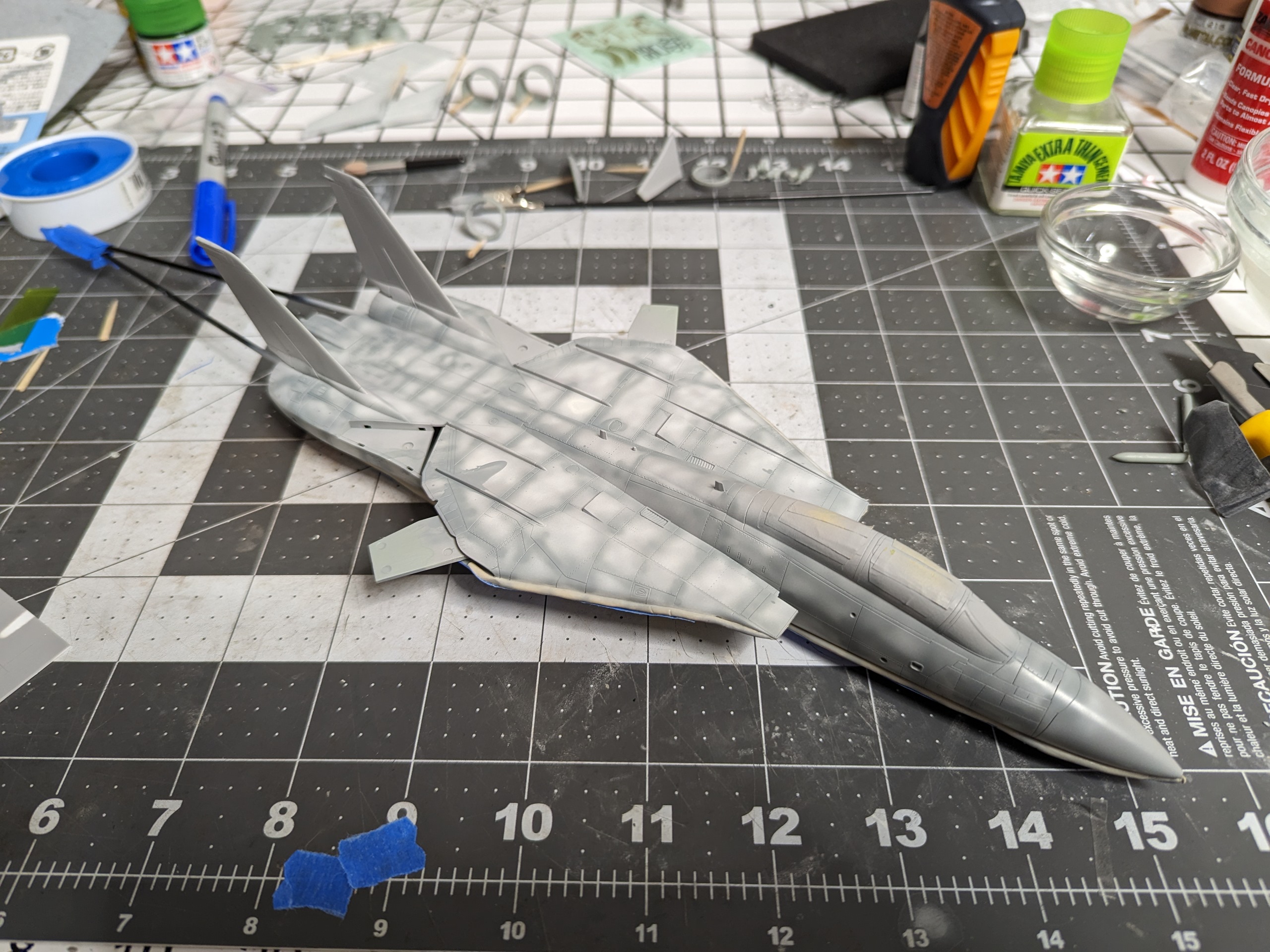

Well, there's good and bad today. I got the ventral parts masked off and started on the underpainting. Unfortunately the fuselage slipped out of the foam I had it supported on while I was painting. I caught it and prevented any major damage, but I jarred the airbrush in the process and spilled paint on it. Thankfully it was heavily thinned with Mr. Leveling Thinner and didn't gloop too badly. A little very careful sanding once it cures and maybe a little touch up and I should be back in business.
All masked and ready to go. I used Blu-Tack to do the soft edges, hopefully it works out.
Pre-shading done, other than the oopsie and whatever I need to do to fix it.
The worst of the paint spill.
There was also a very small scratch just aft of the main gear door.
oh no, that sucks, but like you said, it could have been worse
Maybe one way to hide it is to make it look like one of the "touch-up" panels by masking off the ones around it and have it freshly painted a bit lighter?
Yeah, a little sanding with a 3000 grit sponge basically took care of it. and with the base color on it basically disappeared. If you look in just the right light, you can see a tiny ripple, but otherwise it's fine. And once it's weathered and top coated I'm pretty sure it will be invisible.

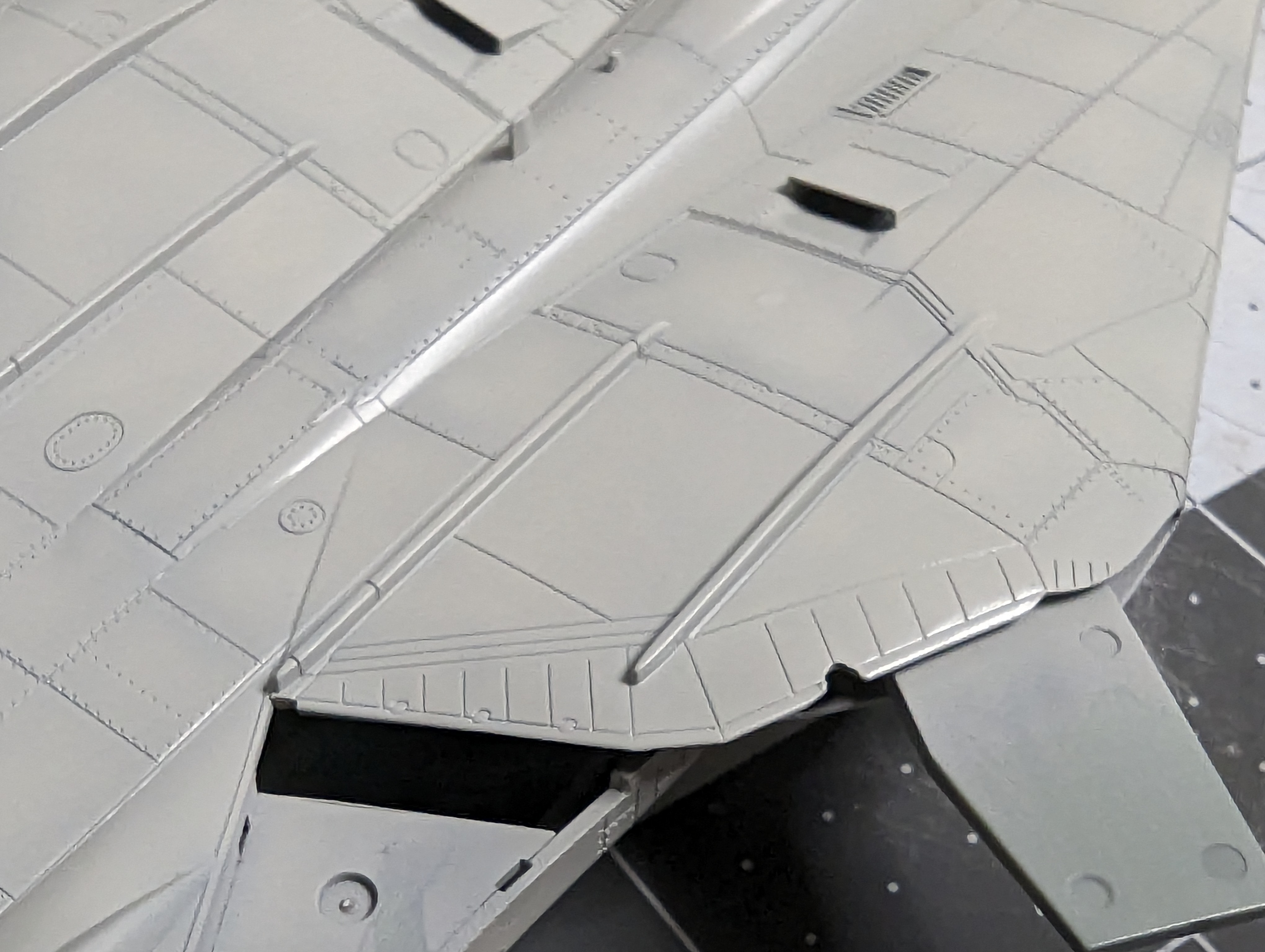

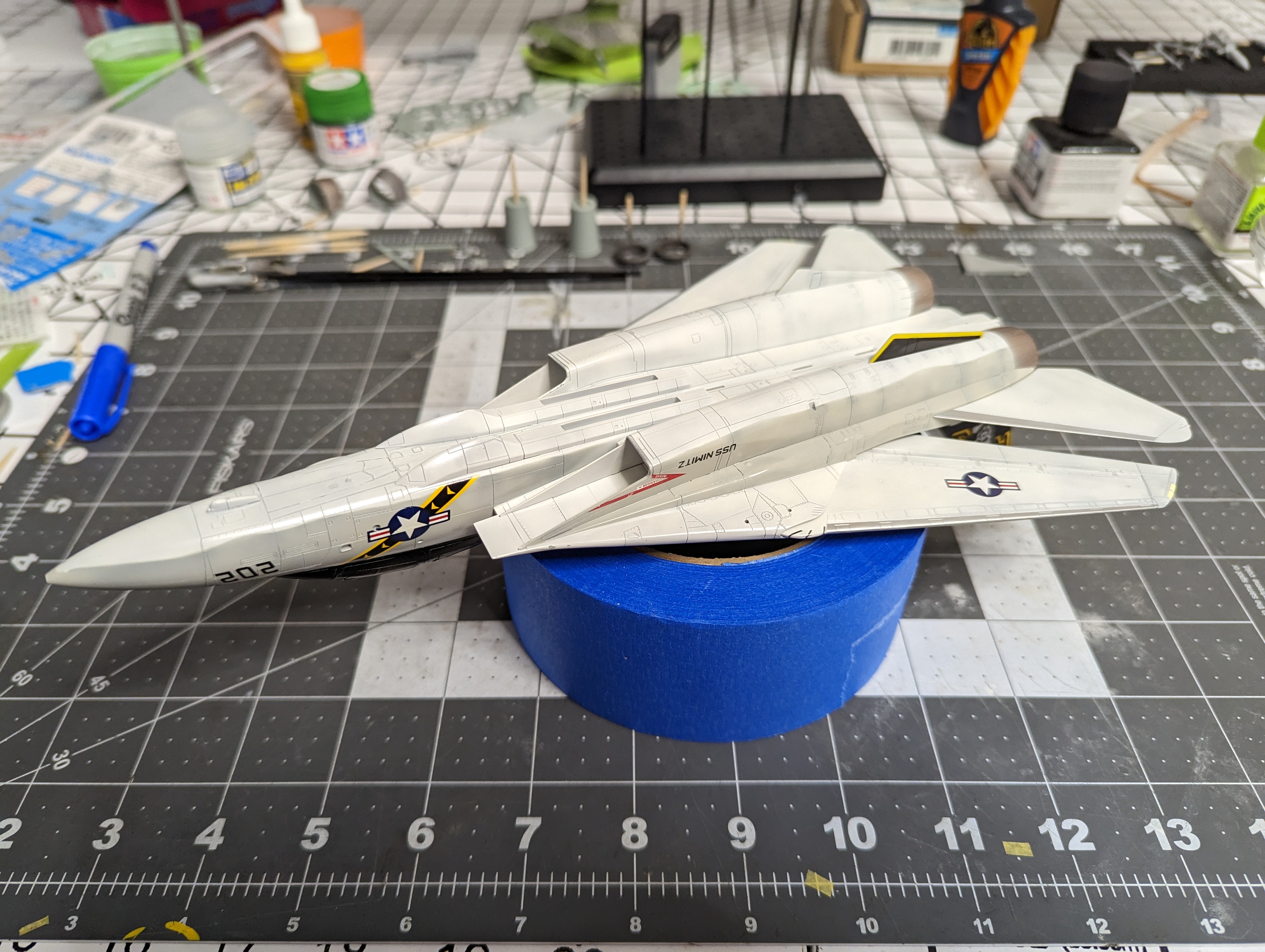

I managed to recover from last night's disaster. A little sanding and the light gull grey went over nicely.
Bottom side looking good.
Top side:
A little sanding on the area where paint spilled.
And you can't really tell there was a problem:

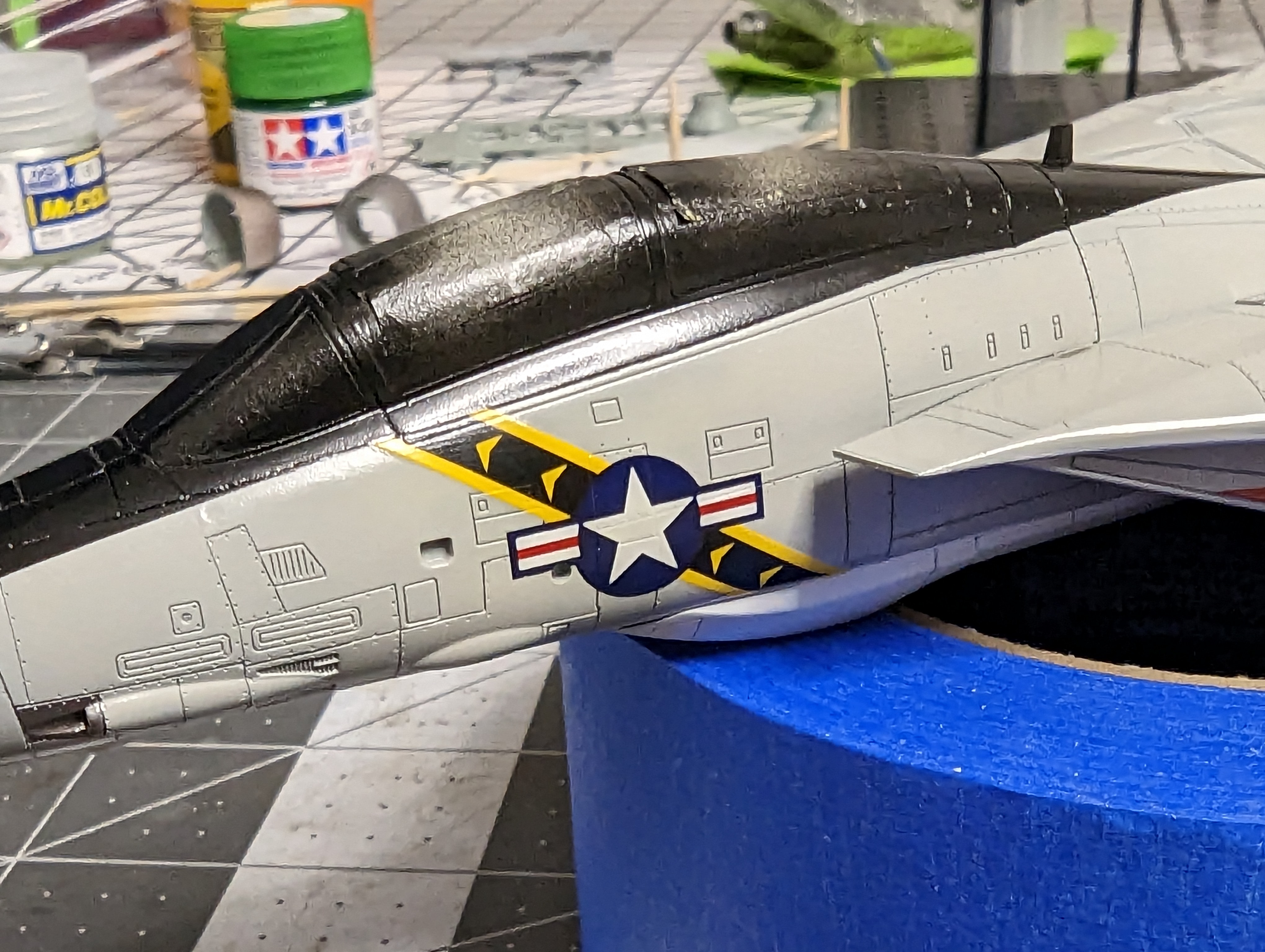

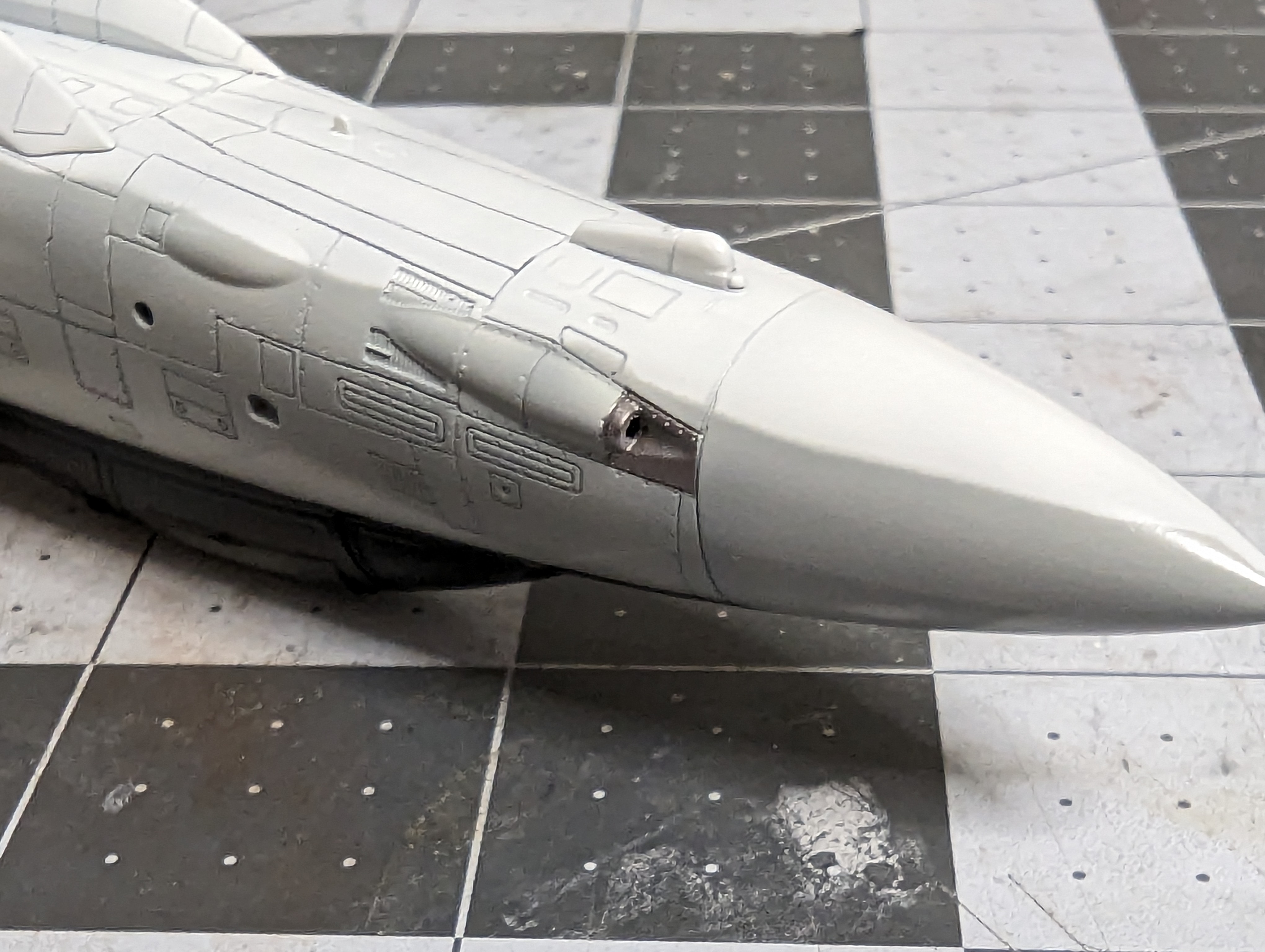

Close up of the nose. I'm happy with the transition between grey and white:

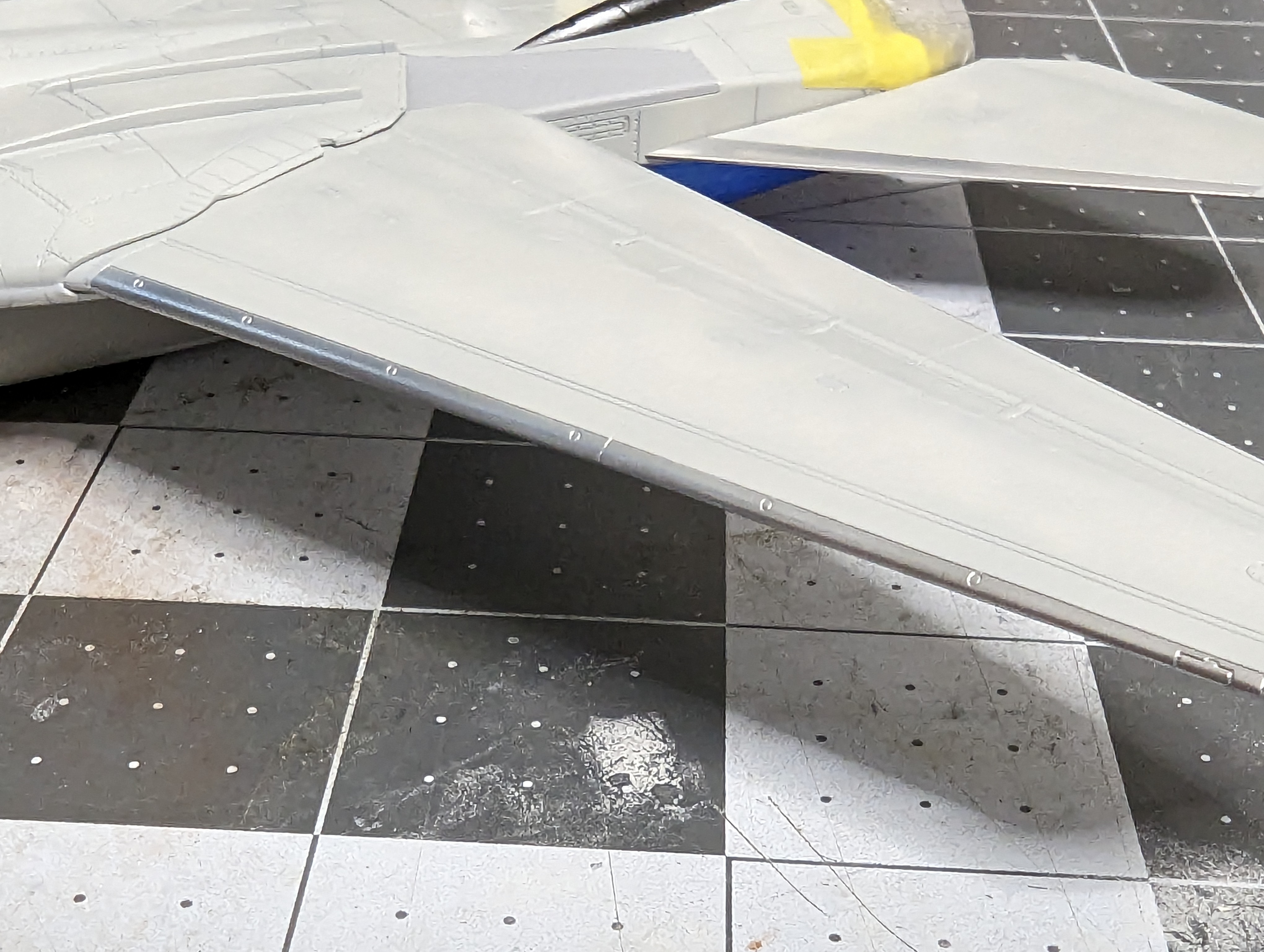

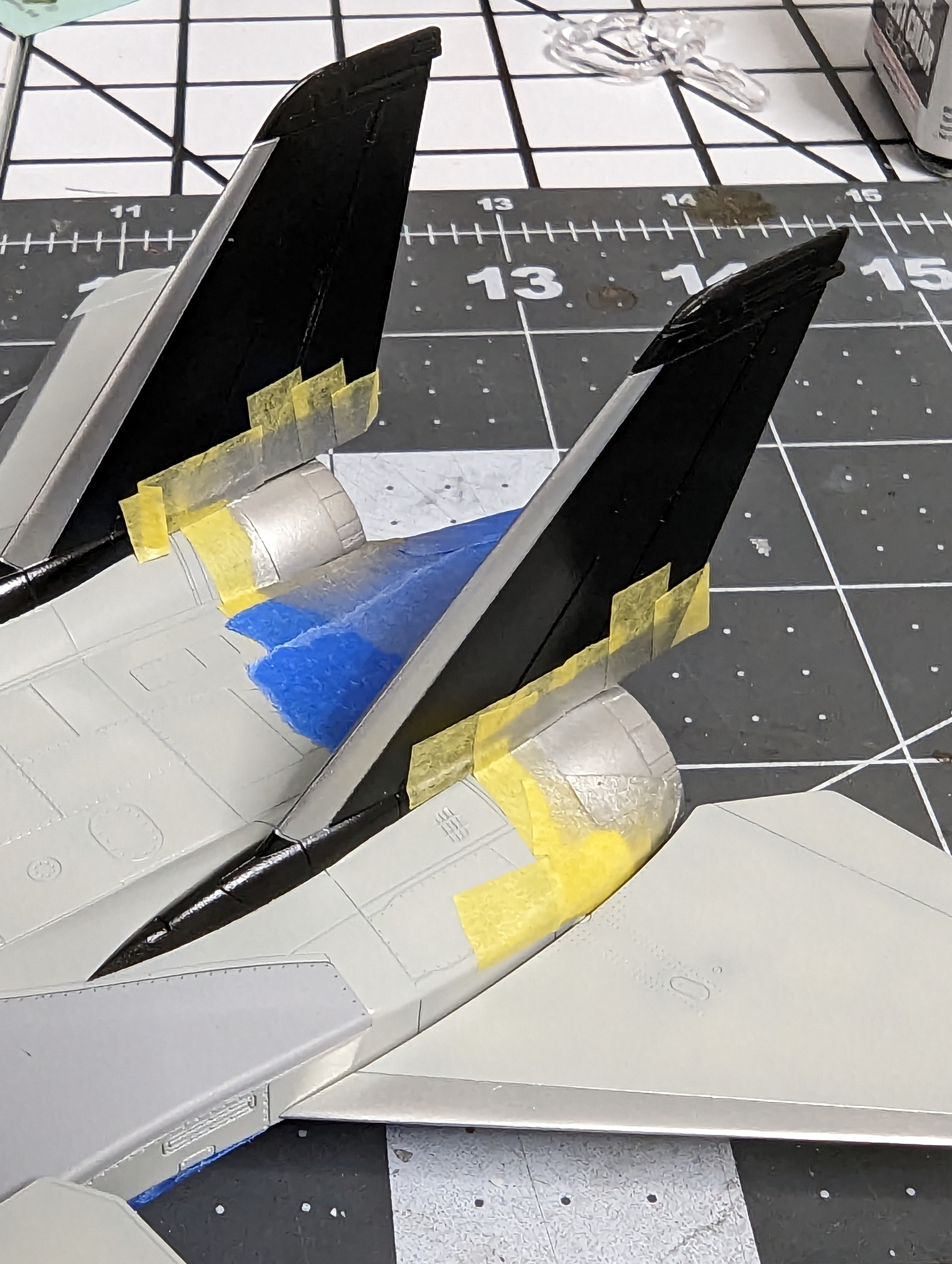

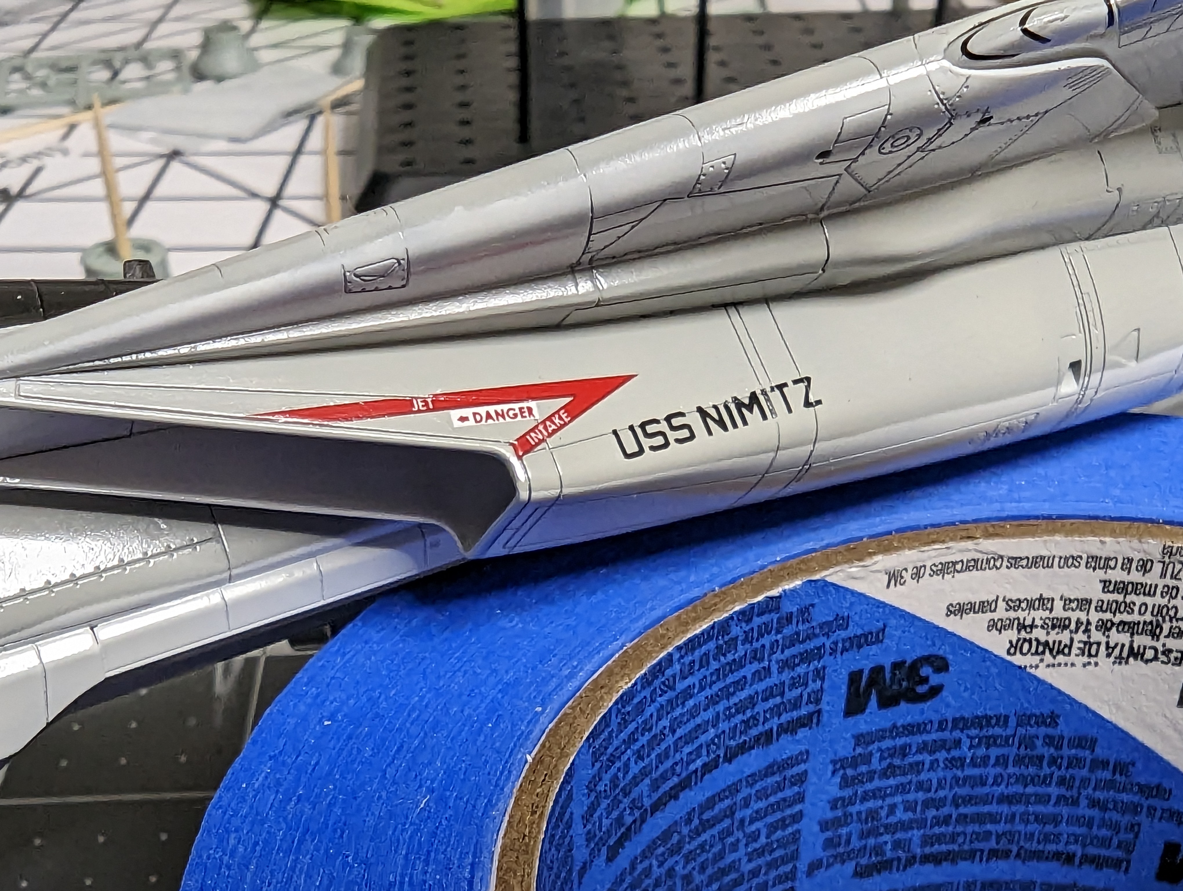

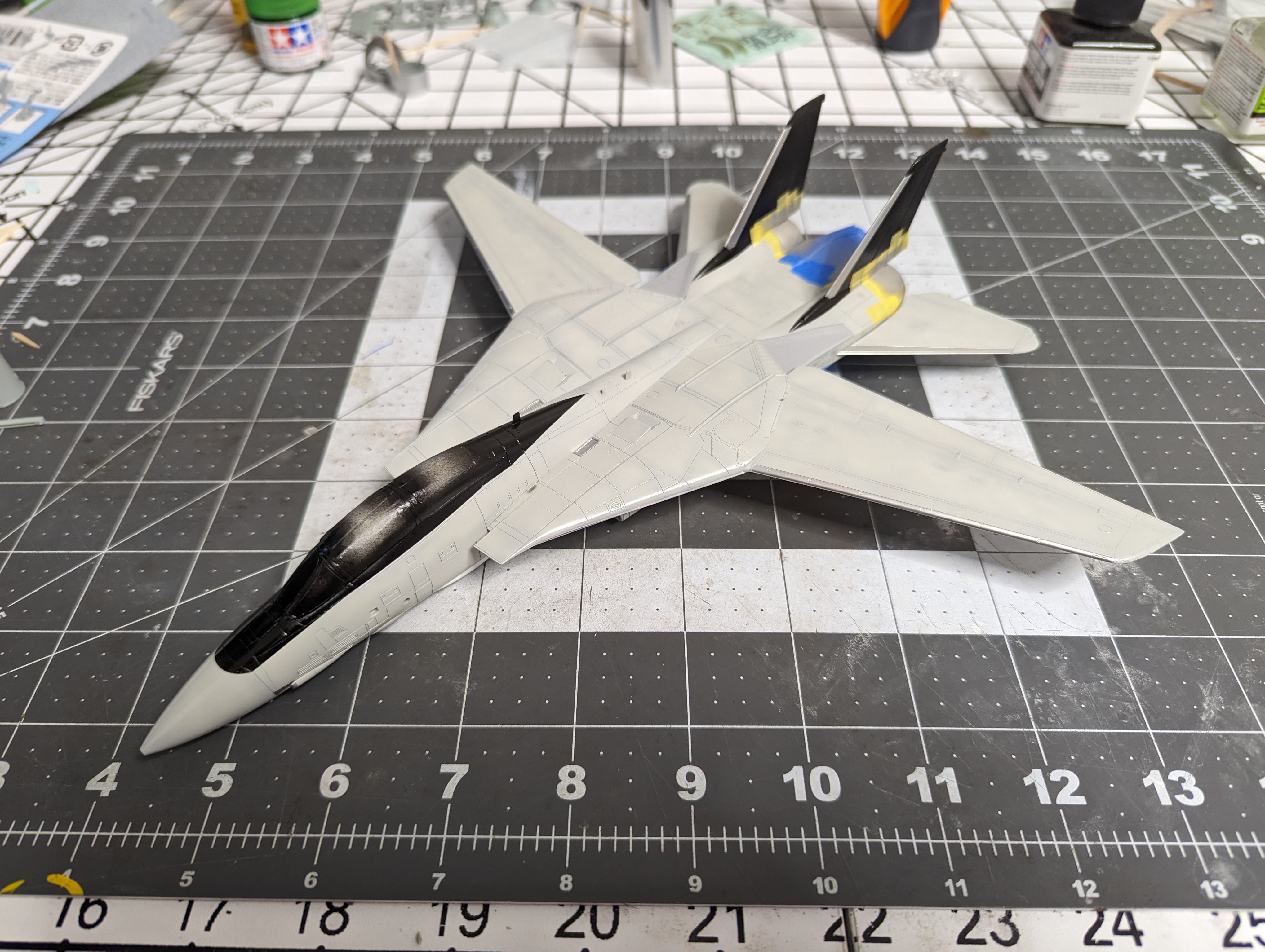

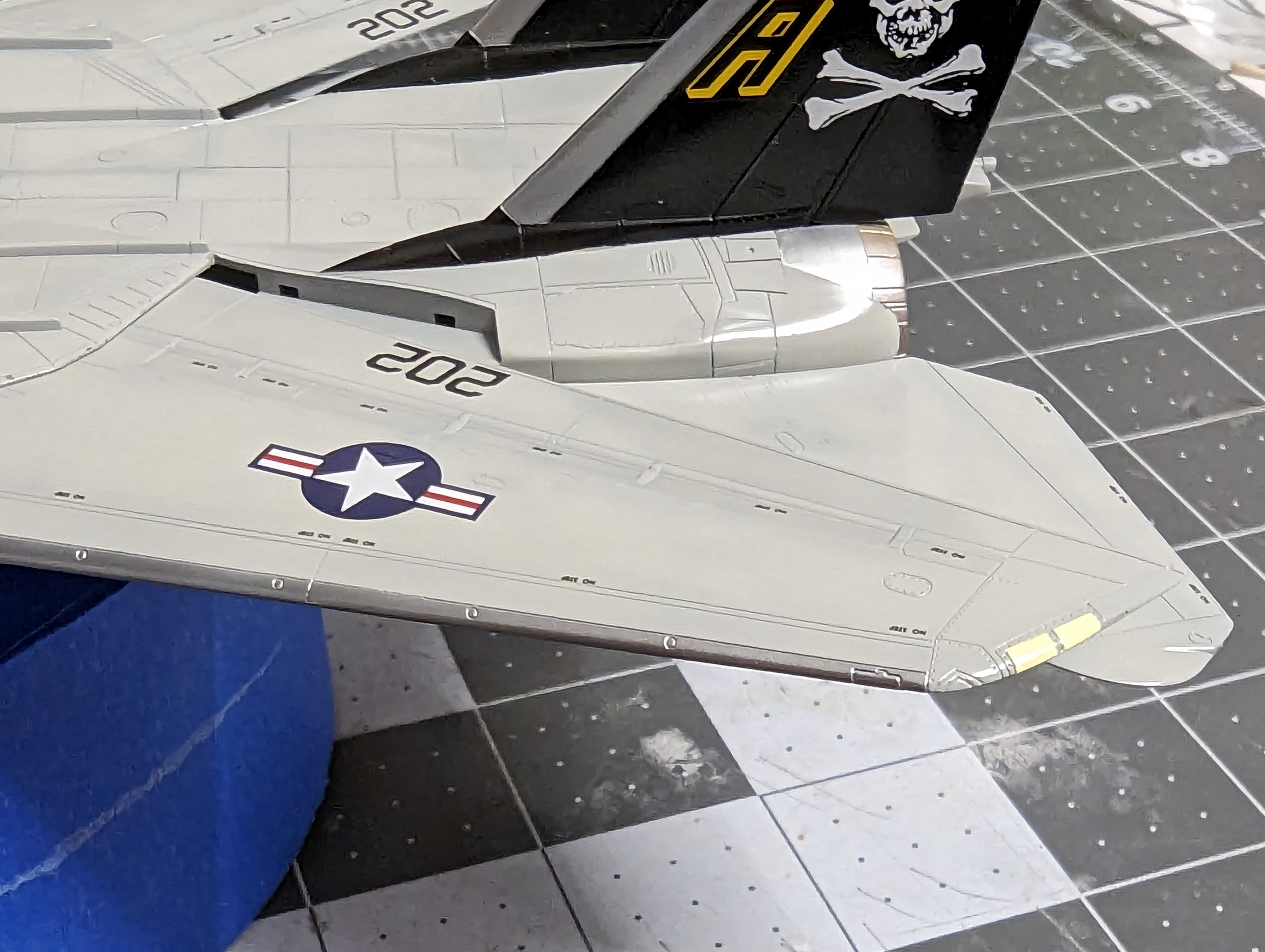

It's really starting to come together. I'm making good progress on the detail painting. I've got the black cockpit anti-glare and horizontal stabilizer done, as well as the metal for the leading edges, gun port, and ECS heat exchanger painted. I've also got a start on the exhausts, but that is a multi stage process.
The gun port was sprayed with Alclad Airframe Aluminum with a very light coat of Mr. Color burnt iron on top.
Intake leading edge.
I love the bare metal leading edges.
