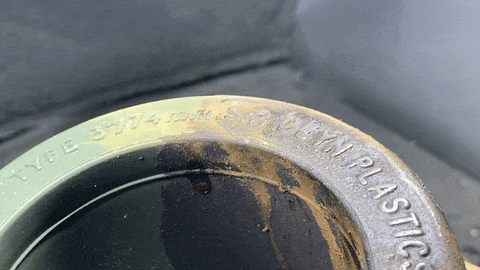

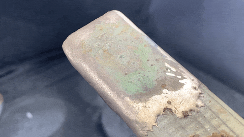

Update: first rust experiments
The iron-coated plastic can be made to rust with vinegar.
I used "Scopas Cupra" (contains acid solution and copper sulphate) to get a little verdigris going on with the bronze, but you can add more to get a stronger effect.
I suspect both these effects would have looked better if there was more of a textured surface for the rust to settle in. The cold casting experts out there will have some good tips.

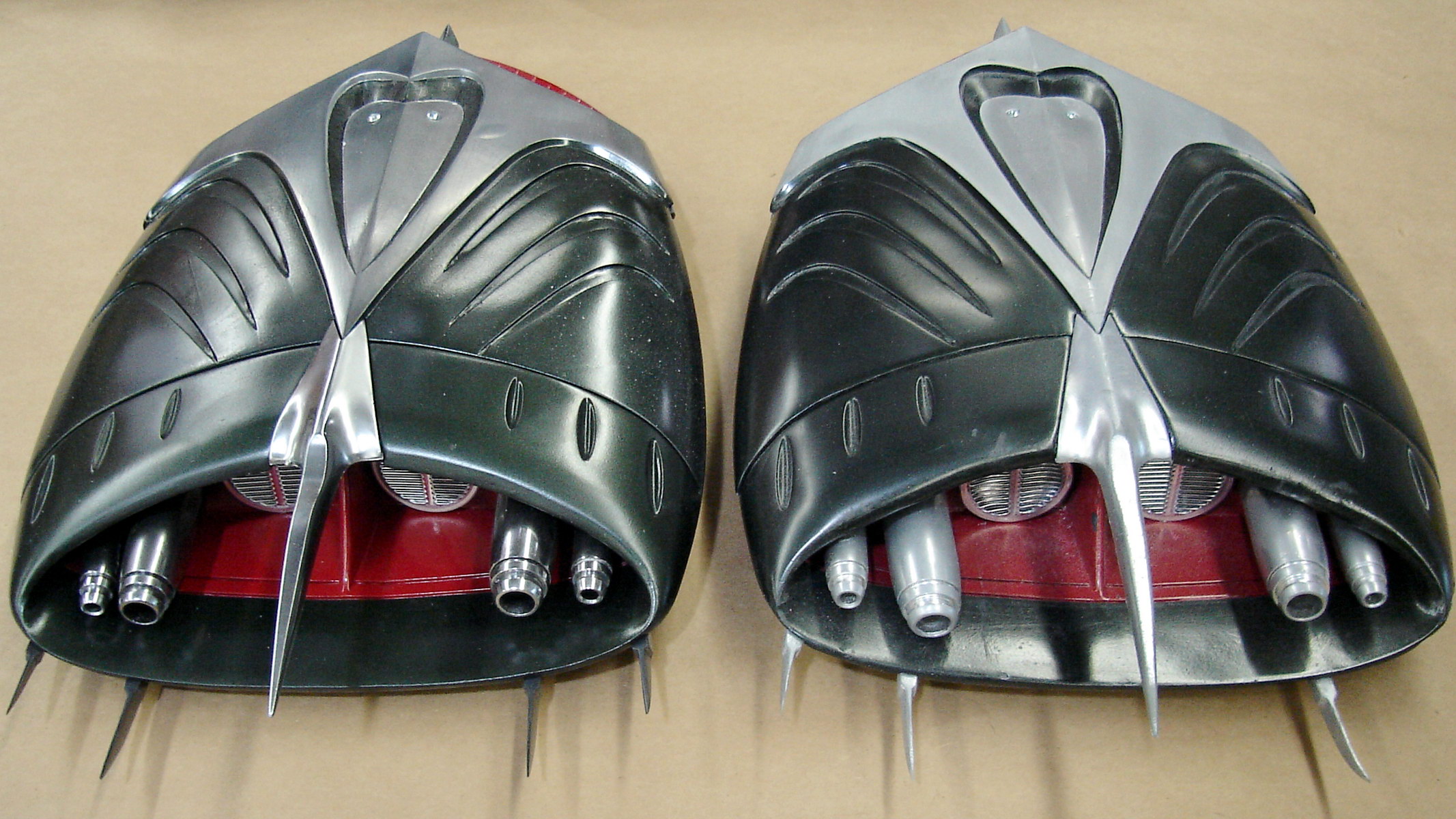

a similar method was used back on the Sky Stick for Spiderman 3. Except the method used took hours to set in the mould before the spray in metal could be backed with any other material (rigid foam, rubber, plastic...) so it was ultimately abandoned yet some of those parts did end up used on the screen used props. Mainly the rocket motor tips, spikes and some tiny bits. We had used Turtle Wax to buff them out as the idea was to keep them from being too reflective for filming. In the end minus the actual machined metal parts of the hero versions, the stunts and lightweight versions were painted with MirraChrome.
Its a method that has its purpose but there are much easier and more reliable (parts failure rate) ways to cast metal looking items.
The MirraChrome lightweight stunt version on the left and the spray in metal parts on the hero motor to the right.

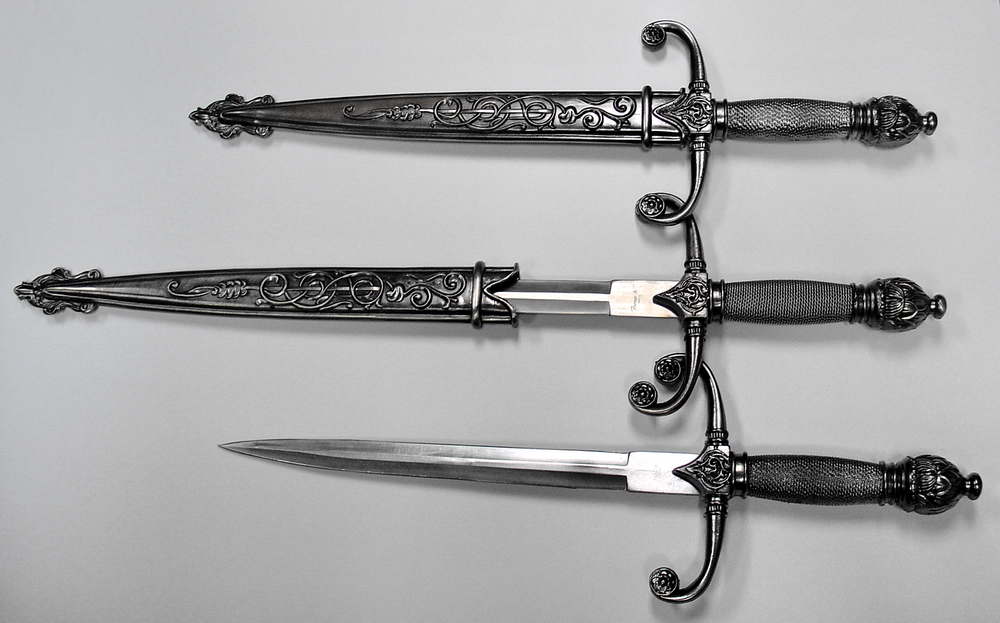

Mirra chrome is very simple to use. It's all about the bare surface. The glossier the base surface the better the result. Literally shake the bottle, pour some into an airbrush and dust it on. It's durable enough for film prop use and abuse.
the middle is the original metal hero knife from Spiderman 2 that was moulded for Spiderman 3. The top and bottom are rubber castings painted with mirra chrome then some raw umber Mohawk added for color.
