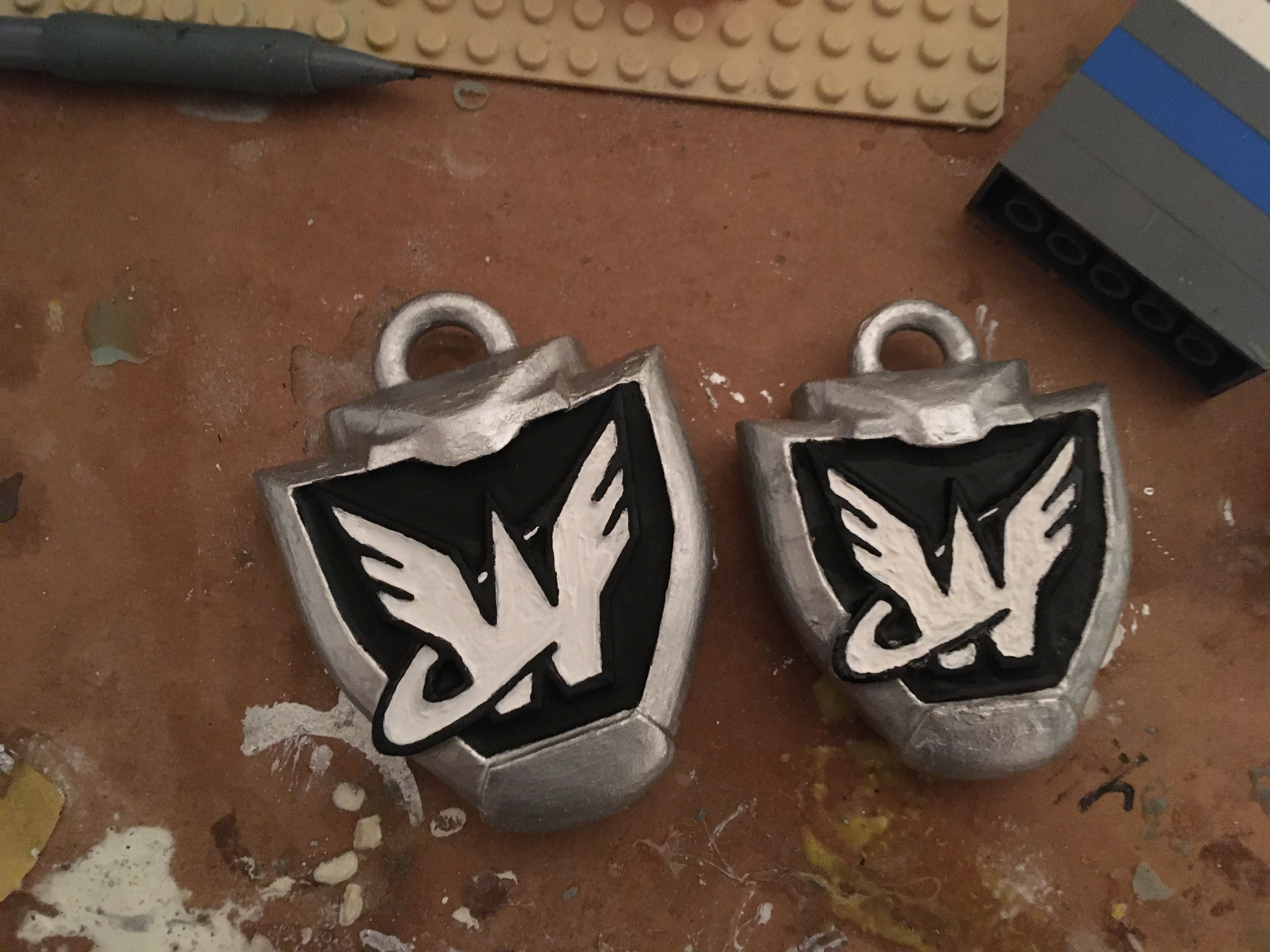

Wanted to provide a little more context to see if maybe that makes it easier to solve.
These are my Wonder Pendants based on The Wonderful 101 Video Game. I designed them myself from scratch, including the original 3D Model and 3D Printed many of them in PLA, later resin coating them in XTC-3D. These are my 2nd and 3rd painted ones, which I primed and painted around a month after coating them. The first painted one (not pictured and made with Tamiya paints) is 'finished' but with some imperfections for various reasons including what I pointed out in the original post. These ones were painted with Vallejo paint. The smaller one on the right here has been clear coated on the back.

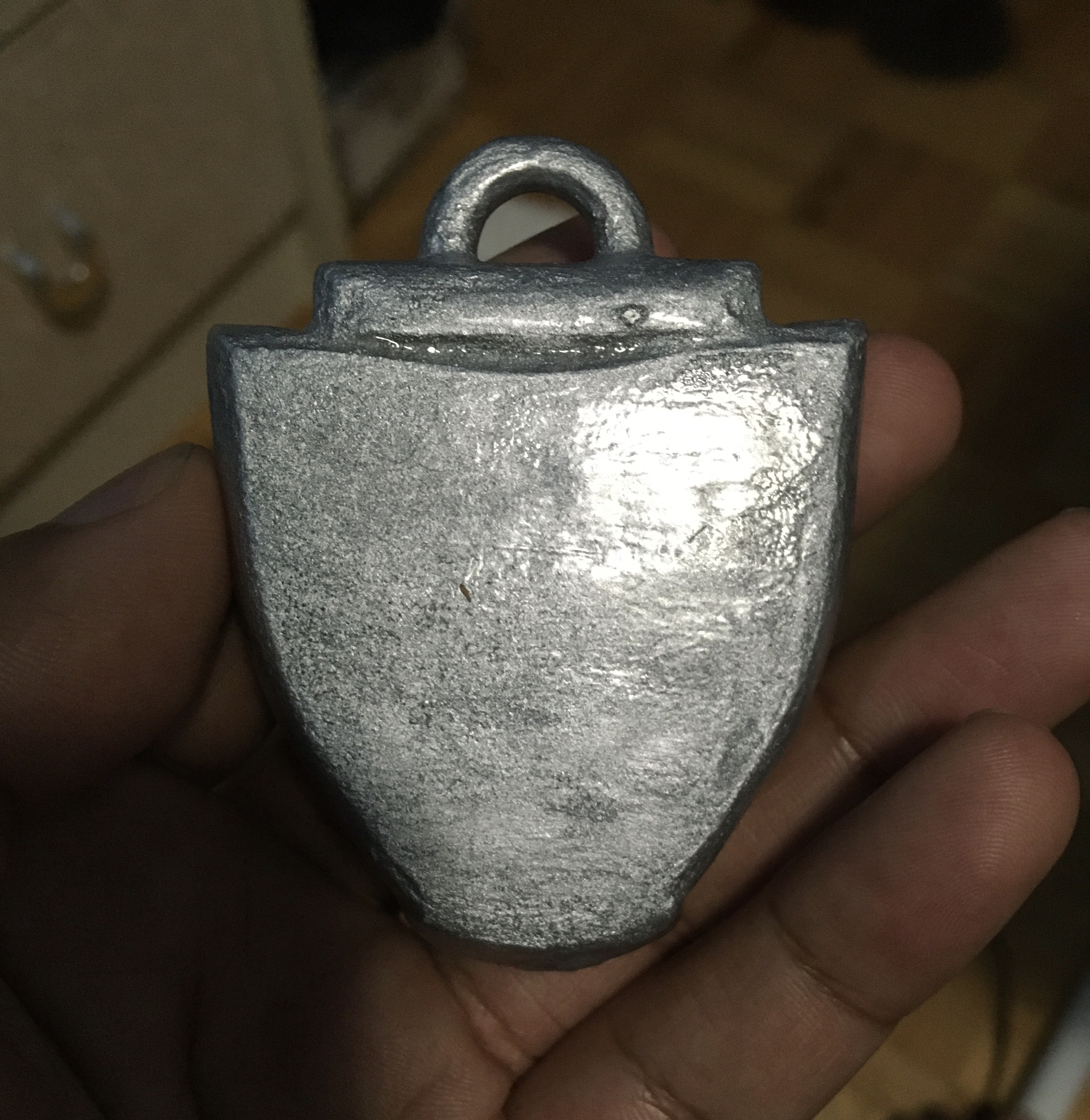

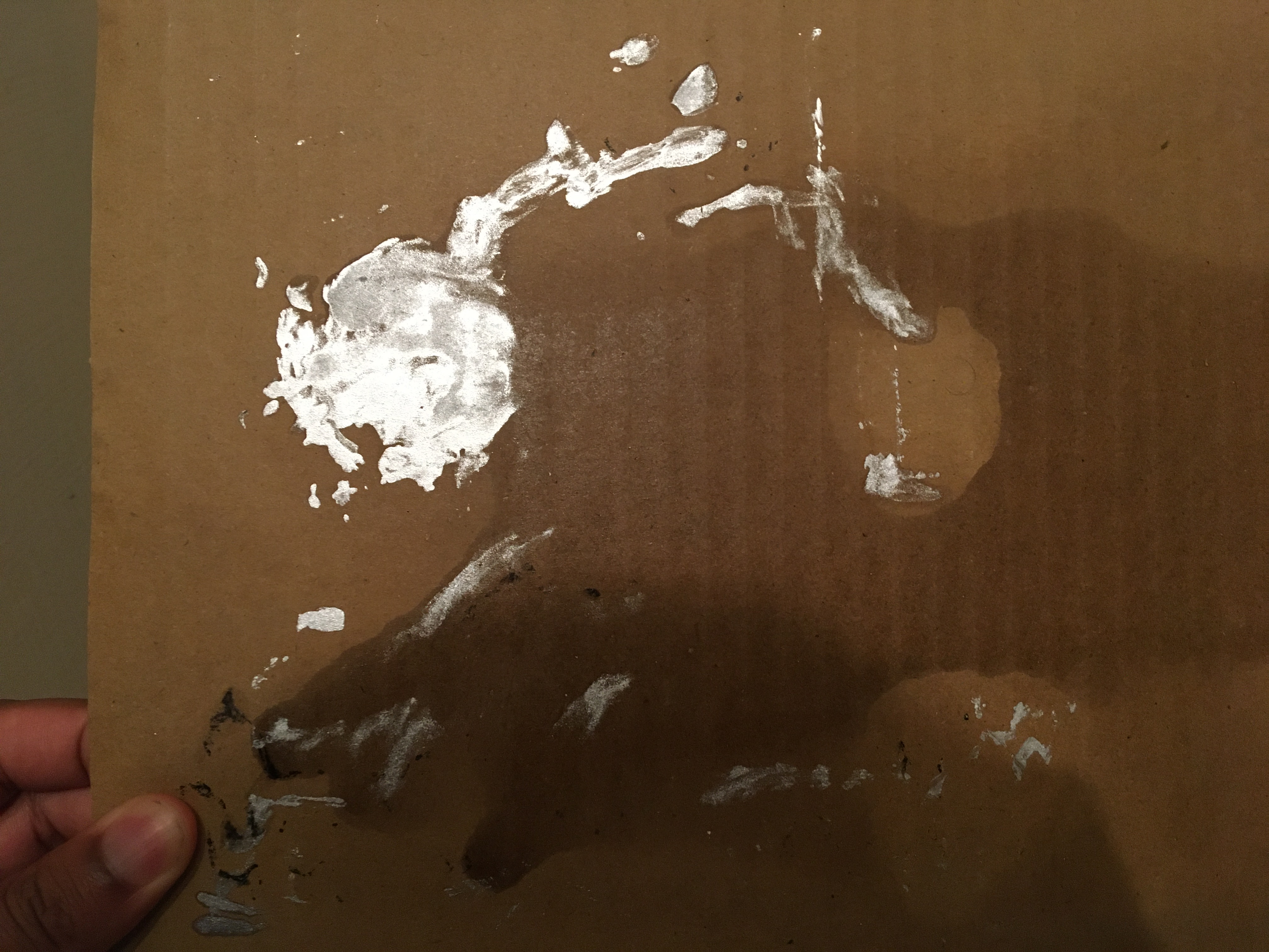

When I clear coated the back of the smaller one, it created this mess. The silver paint melted into a puddle and I had to move around to make sure it didn't stick to the cardboard and potentially flood the opposite side. That is what happened with the first one with Tamiya paint using Krylon Clear Coat. However, on this one, I used Tamiya Clear coat in hopes it wouldn't turn out that bad again and it did. I'd like to figure out what's happening before attempting the bigger one.

That is totally bizarre. The only negative thing that lacquer can usually do is lift the paint underneath, but you'll see that as bubbling or cracking. I've never seen it flat out melt everything... So when this melting off of the paint happens, does it then fully dry afterwards or does it stay tacky? You may just need to do very light mist coats. Like dusting the surface with quick bursts from 12+ inches away. I have experienced clear coat kind of softening metallic paint and sucking it up into the clear, and I can imagine if you sprayed the clear on until it was so heavy it ran it might do what you're experiencing. Hmm...
Well, one easy test would be to use all the same paints and clear but on a neutral surface like wood or metal. If it still does it then it must be the finish alone after all.

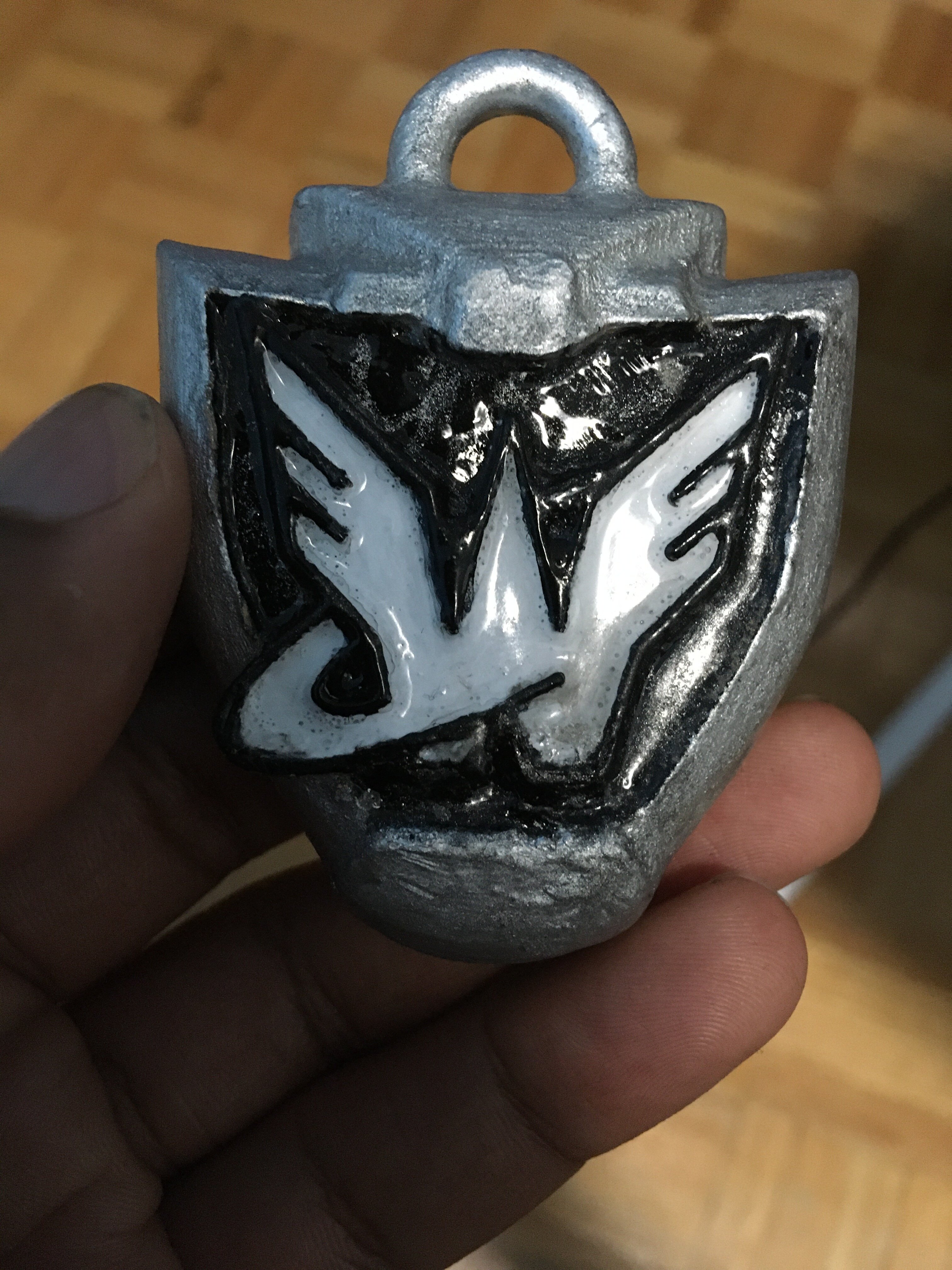

EDIT: Here's how the first finished one looks under the Tamiya Paints and Krylon Clear Coat. It's done and it's sealed mostly fine, but you can probably see a bit of evidence of me fighting against the clear coat. The darker area on the bottom right of the W is where the clear coat was melting when I poked it with the foam brush, in addition to the general melting elsewhere. I had to paint corrections over the clear coat and then clear it again... Twice. Not fun.
It's actually easy to tell what type of coating it is. If you look at the directions on the can and under "clean up" it says lacquer thinner then it's lacquer. If it says mineral spirits or acetone it's enamel. Plastic reactions aside, you generally want to use all of one or the other, or you can put enamel over lacquer but generally avoid lacquer over enamel since it can eat the enamel. I'll have to see if I can replicate the issue and figure out why.
