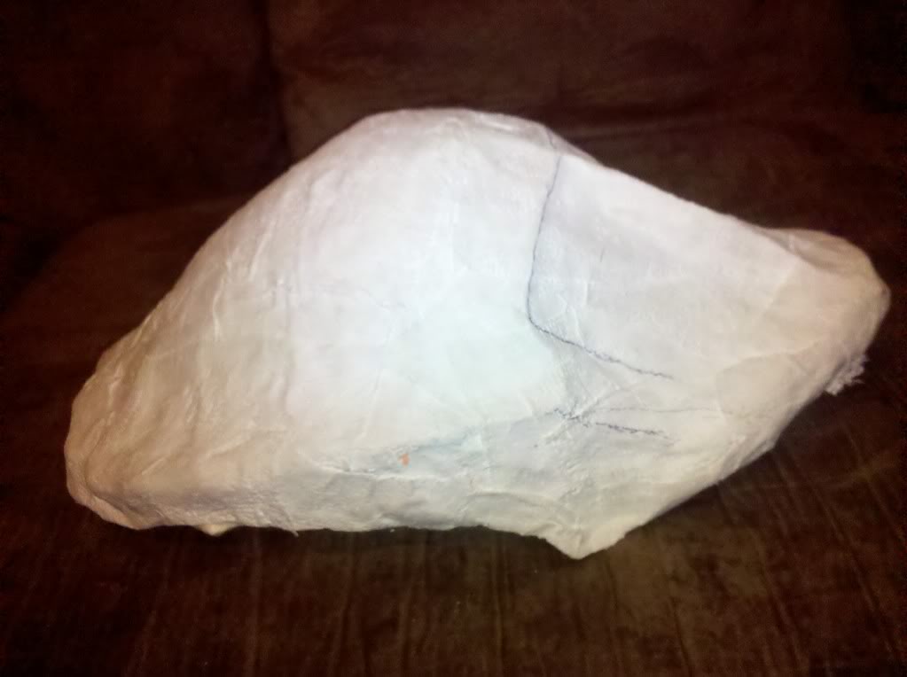

I can take some pics of my armature if you want, it's made off of xdmray's gen 1 half mask. I think xdmray has some pics up of his somewhere.
Yeah man! Daman took some pics of his for me, if you have them that would be cool but you really don't have to go out of your way for it I have that mask too so it should be epic :)
All I did was put saran wrap over the half mask and tape down the edges so that it was flat to the mask. I just put two layers of plaster bandages on the exterior and waited till they dried. I then put two more layers on the inside. Once they dried, I spray expandable foam on the inside to make the armature firm.
