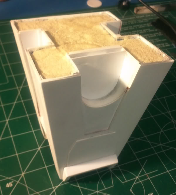

I had to put this on hold for a few weeks due to some important reasons. I left off at the point of filling the master body.
As you can see, I tried filling with resin before realizing that the arm box side-walls were bowing in at a slight angle making it difficult for the parts that go in it to fit properly.
I ended up having to tear some of the body apart in order to get the chunk of resin out.

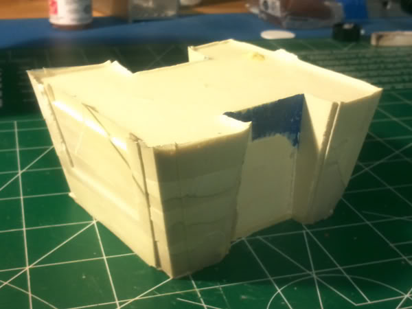

I fixed the arm boxes and decided to use foam instead to fill the master.
Then I shaved off the excess. It's now ready for the top plate that will close off the master. I'm looking at having this rotary cast for a hollow center to allow for electronics.
After the top plate goes on, I'll begin body work and then start adding the details. More to come later....

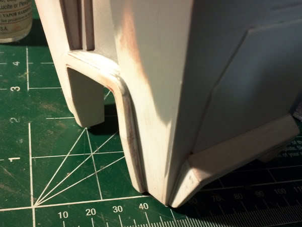

I also installed the side bumpers.
Things have been moving slowly due to some major re-works but things should start to pick up.

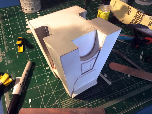

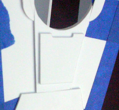

Initially, I wasn't trying to be 100% accurate and while it won't be 100%, I'm slowly converting parts I'm not happy with to make them as accurate as possible.
For example, my first center chest plate was not rounded out like the video game model.
BEFORE...

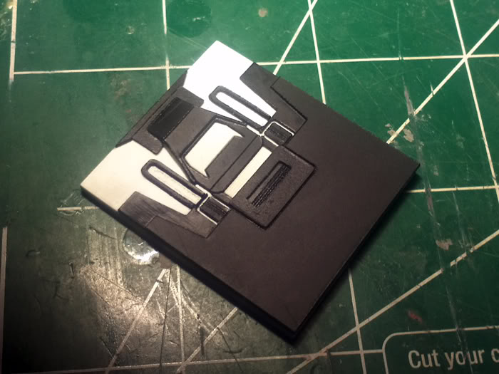

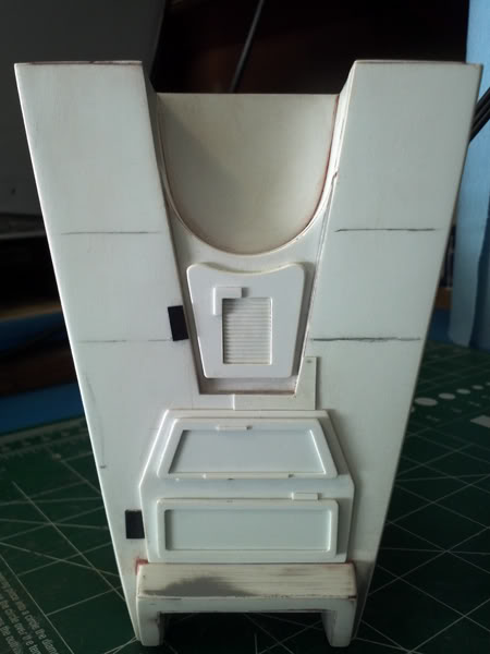

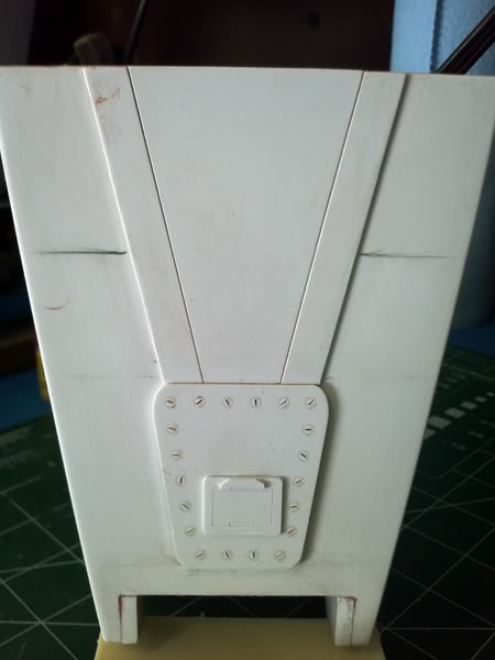

...AFTER...along with the drawer and whatever that thing is below it. I also added some of the bits. I haven't added what I call the collars since I'm still lining up the decal drawings to make sure everything stays straight.
...the collar I was talking about...
...back shot....what I have so far...
Thanks for looking....
Joe

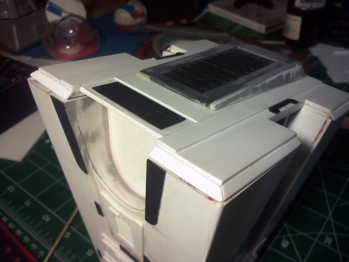

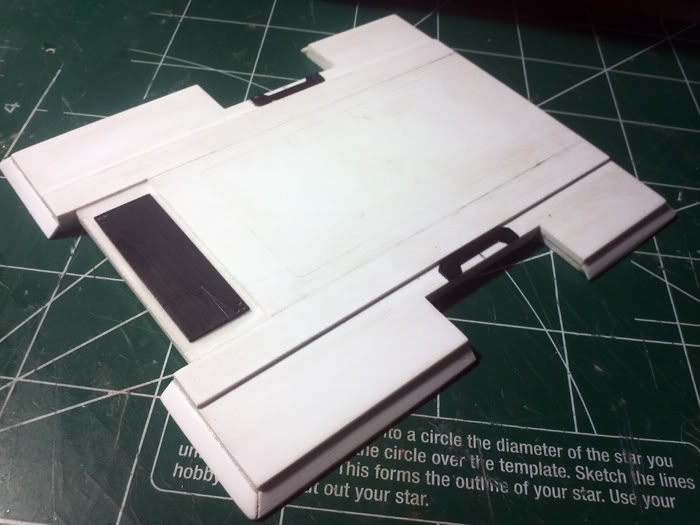

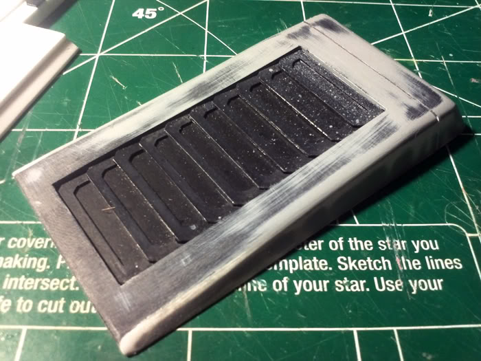

Here's the latest and greatest....the top head plate so far. I haven't added the antenna and a few details. The head plate will be a separate piece so that you can add electronics in the body and still access. Also, the seams still need to be filled and smoothed out. I also didn't align the plate very well for the last pic which is why it looks off. Things have been slow.....getting close!
Joe
