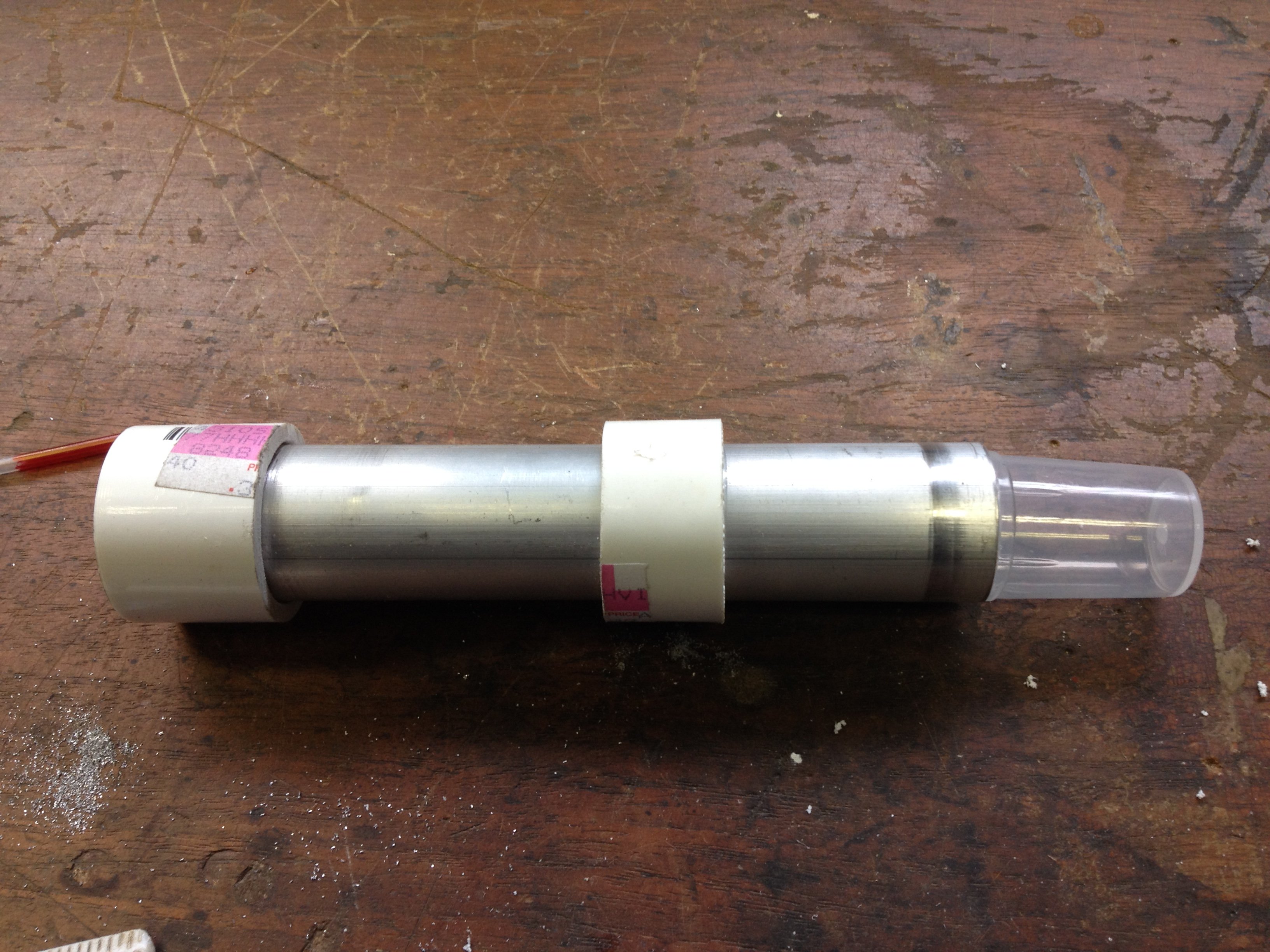

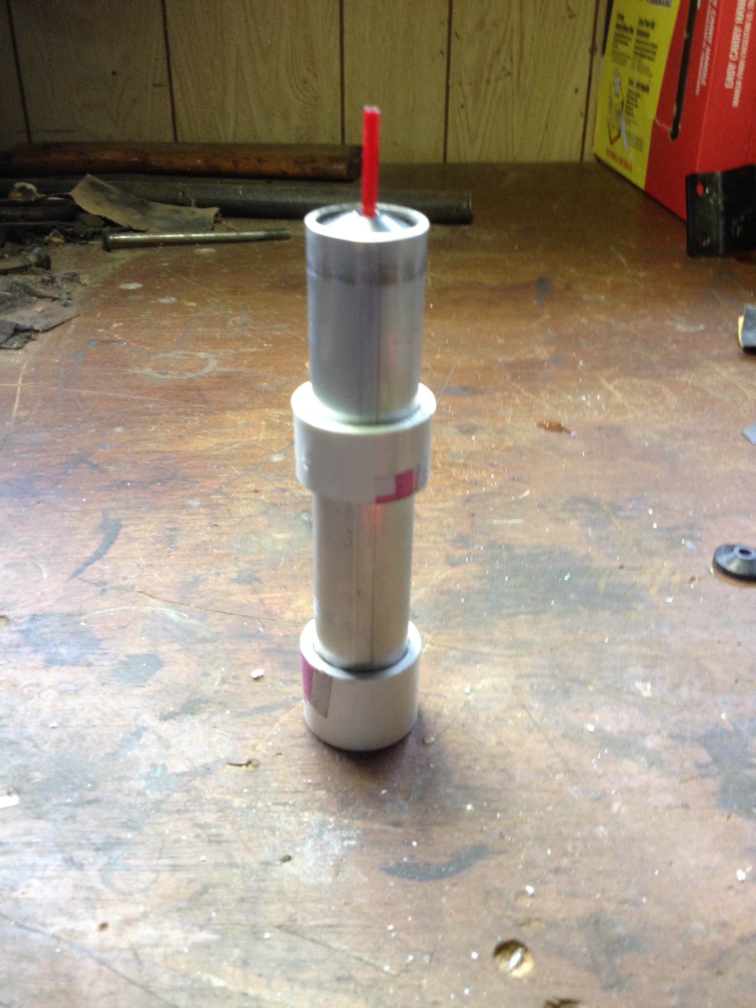

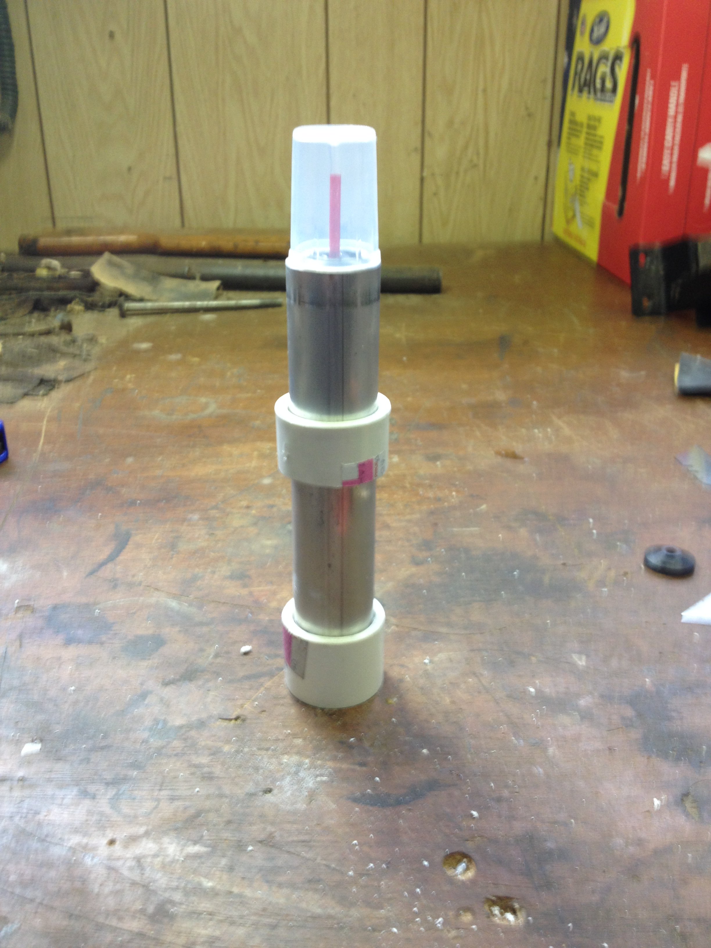

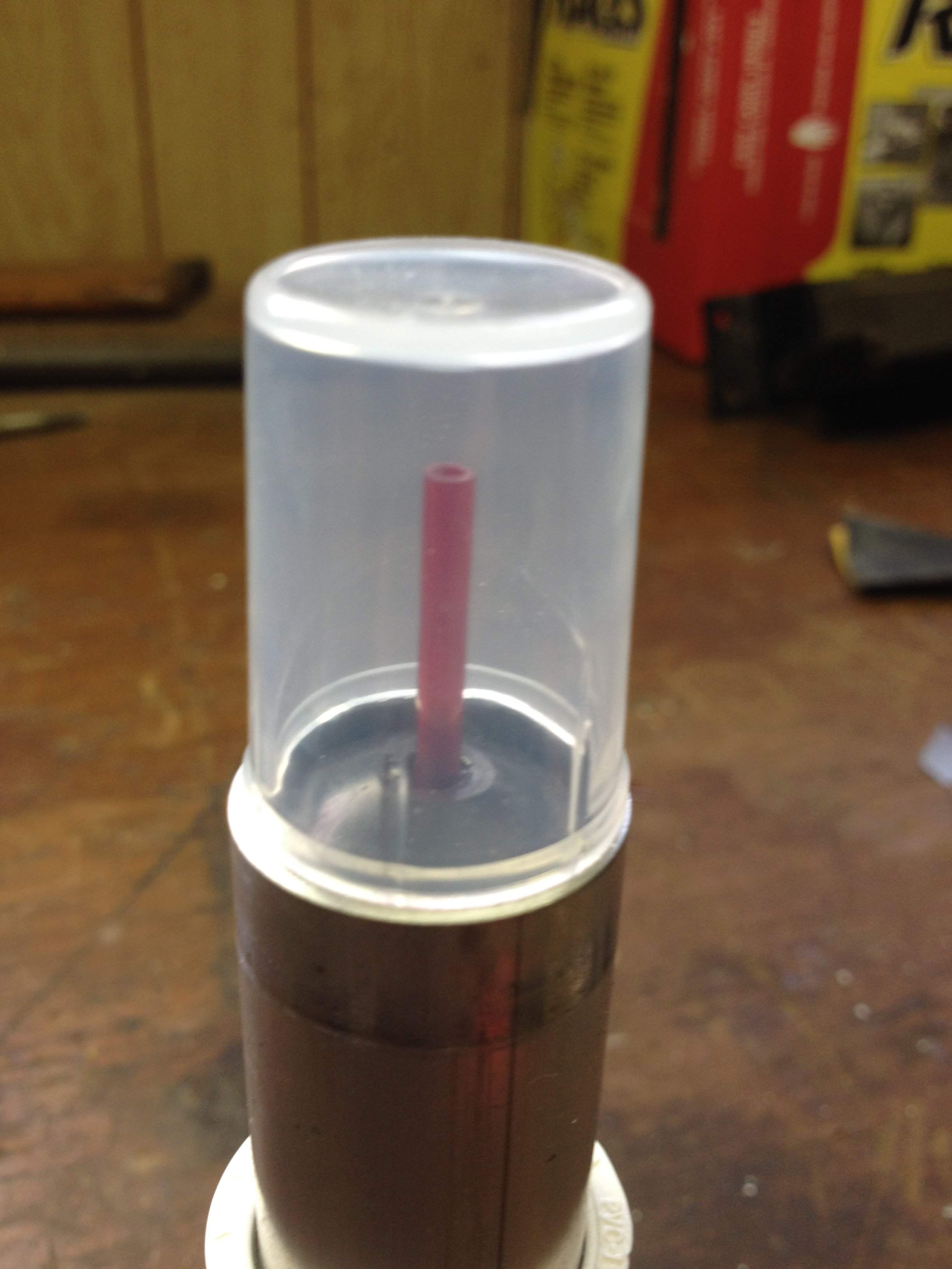

Hi all
decided to try my hand at building a single point scope. Started with a 3/8 aluminim tube and a couple of pvc couplers. Cut and glued them on then made my red filament by cutting off part of a ballpoint pen and colored it with a red sharpie. This gave a nice translucent effect. For the clear cone im using a cap off a throat spray from the drug store. More pics to come as i progress.

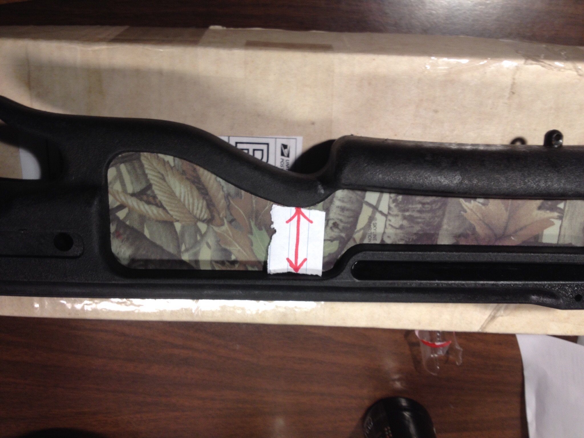

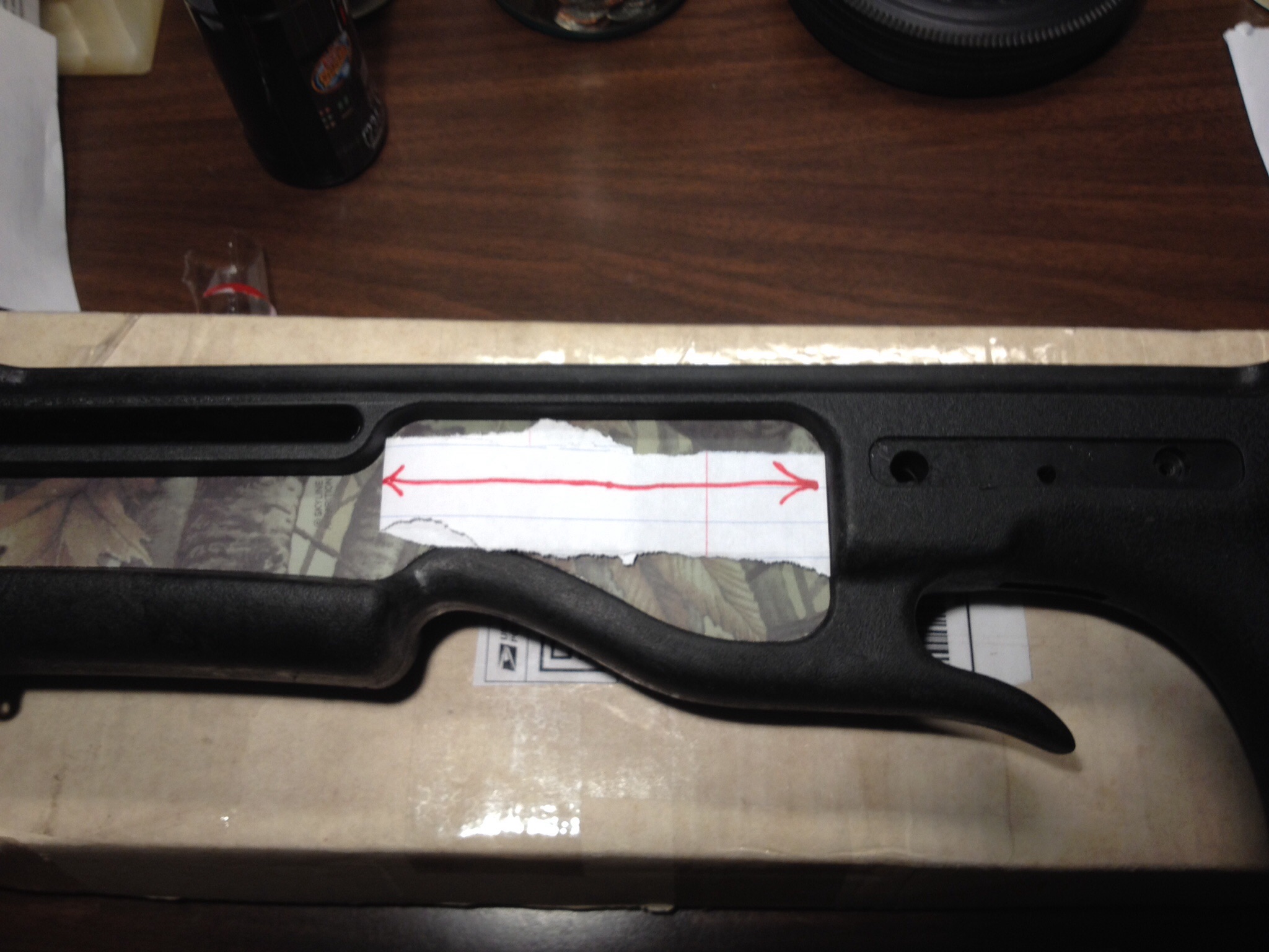

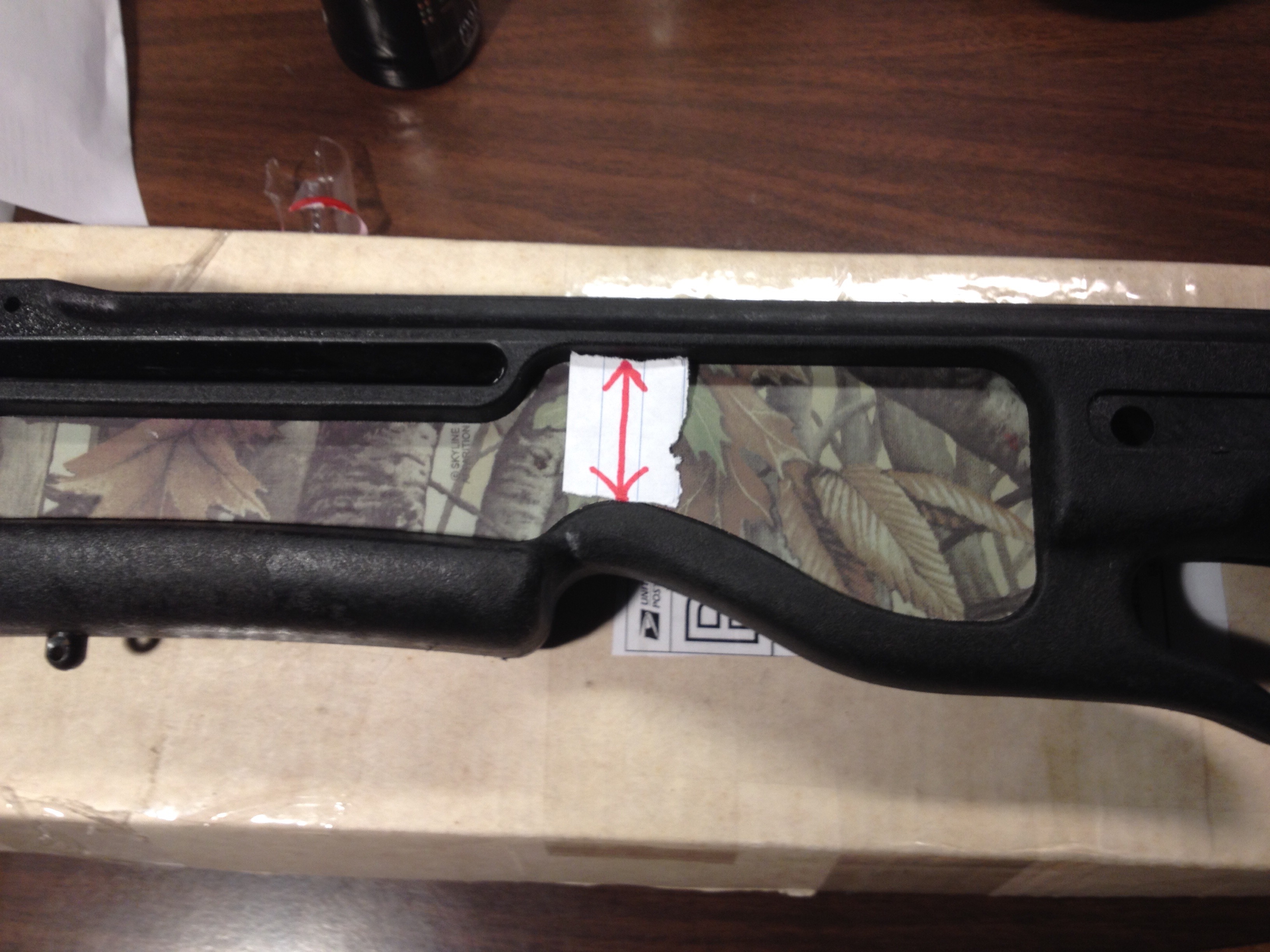

Hello
just opened up my horton stock from the box. Im hoping someone can help me with a couple of measurements which will help me determine if i can use this or not. Im looking for the measurement from the area where the sideplates go width and length if possible. I know this is not the proper horton but im thinking i can make it work. Thanks
Re: Chewbaccas bowcaster build
ok I measuredthe height at 1 and 3/8ths on my Horton at the area just in front of the grip between the area where it curves upward to inside the sideplate cutout area. is this too small? the Horton safari looks like less of a curve in that area.also the length in the cutout area where the sideplates would go appears to be a little less than 5 inches. how does tis compare to the safari?

Ok so no answer? Heres another question i have does anyone know what size the rings are on the single point scope? Cant seem to find the info here.
Not sure what you want to know - if you post a pic of your bowcaster with lines painted to know what measurement you need .........
As the tube of the scope is 1", the used rings are also 1".
Thank you
heres pics with markings where i need measurements.
