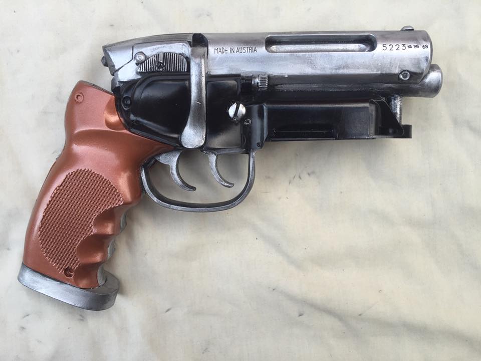

Yeah lots of good paint schemes here. May have to give the soft iron a try. It has a nice sheen is that the paint itself or a clear coat?
No clear coat. Buffing with a little steel wool makes it shine a little and look even more like metal. I’ll get some better pics tomorrow.
WOW! What's your painting technique for that?! That looks unbelievable.
Thanks!
The gun came already pre-painted in glossy black. I took off the grips and masked all parts that needed to stay black (including underneath the grips, otherwise they'd become too light orange).
I then used Humbrol Metalcote steel and polished Aluminium spray (it's amazing!) and after a few minutes of drying, I buffed it up with a silver-cloth. It looked really shiny. Then I used dry brushing to make it dirty with tan and black oil paint and speckle it with tan to fake the rust. It was done very quickly. Masking took most of the time.

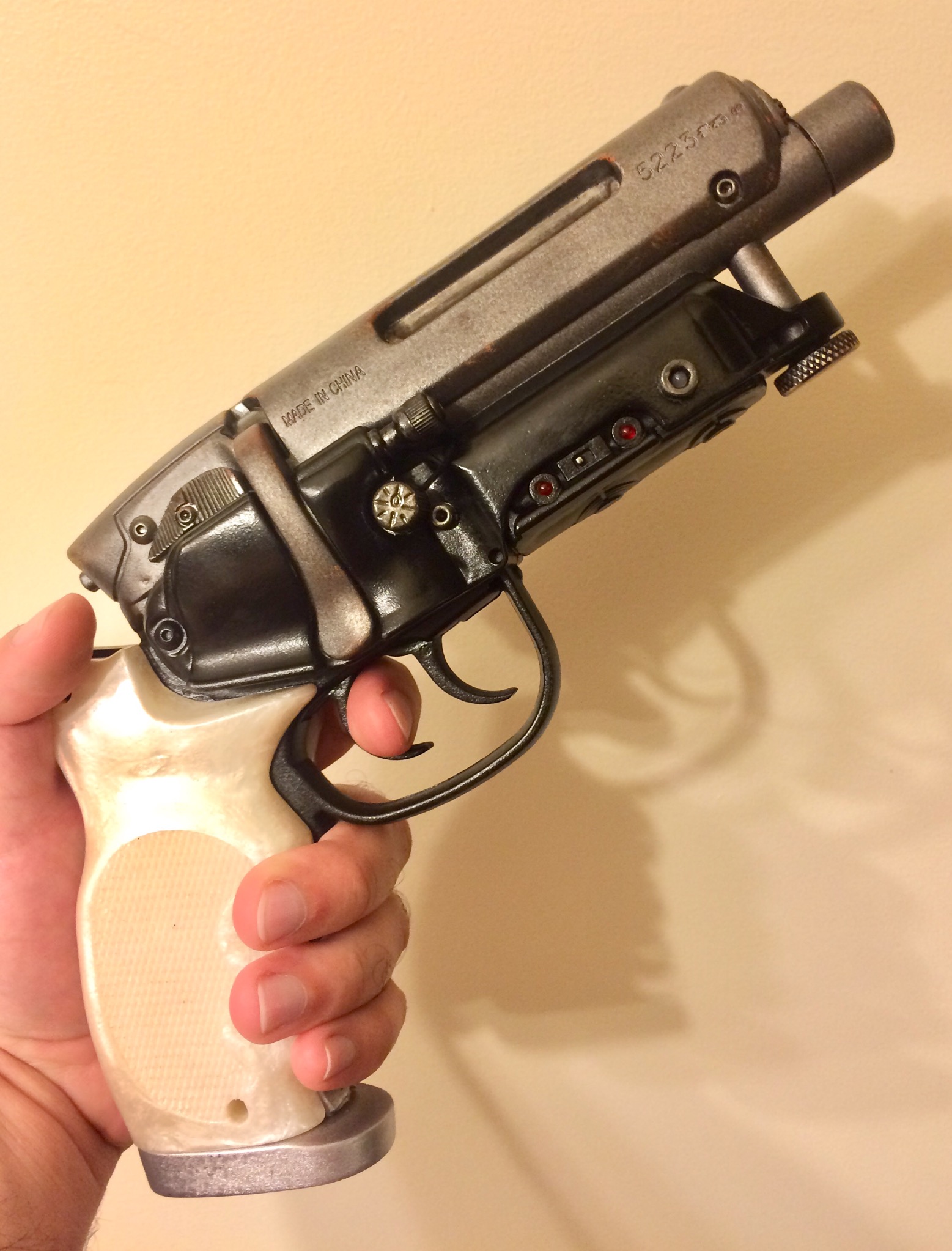

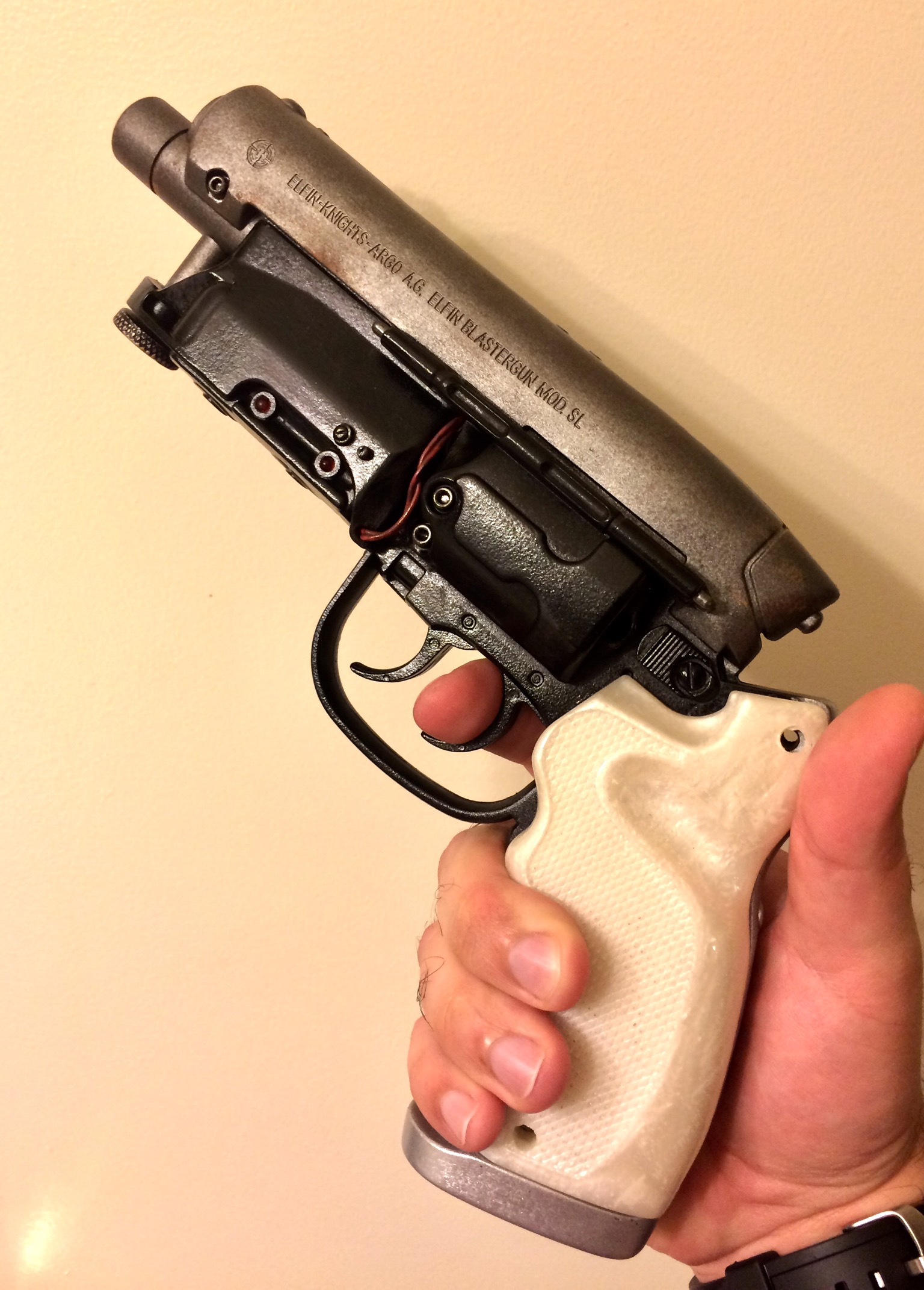

Quick update. Got the inactive LEDs and wire added, did some weathering and detail paint, next is masking off for the final silver section around the triggers and grip.
I kinda feel like this could be Gaff’s blaster. The pearl grips are just a little dash of fancy, and it has enough slight modifications to make it special.
