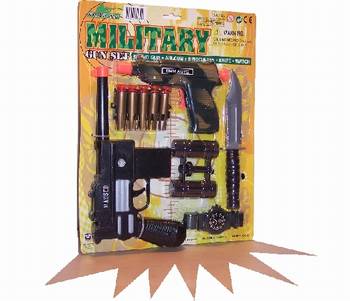

Where did you find the Mauser base gun? Or who makes it so I can look it up in NC?

Something caught my attention that actually made me laugh out loud. Take a look at the card and the artwork that's attatched to the bag. It looks like somebody went on a rampage on a beautiful, sunny day in front of somebody's house! :lol:lol:lol
Very nice buildup out of a toy gun. Looks very "Starwarsie".
The guy's definitely got a crazed killer look.

This thread inspired me to look for cheap mausers and I found these for around $5
The playset is found at buytoyguns (no idea if they are reputable)
