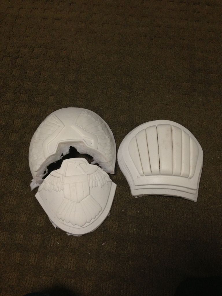

Has anyone ever reinforced their polyurethane castings while still in the mold by adding fiberglass fibers to the casting resin?
I want to make thinner castings but stronger at the same time.
Any suggestions?

I am making Dredd 3D shoulders. The thing I want to make strong and thin are the edges so they can be drilled and sewn to EVA without worry of cracking for any reason.
Polyester resin kills mold silicone and I'd rather my molds last a while.
