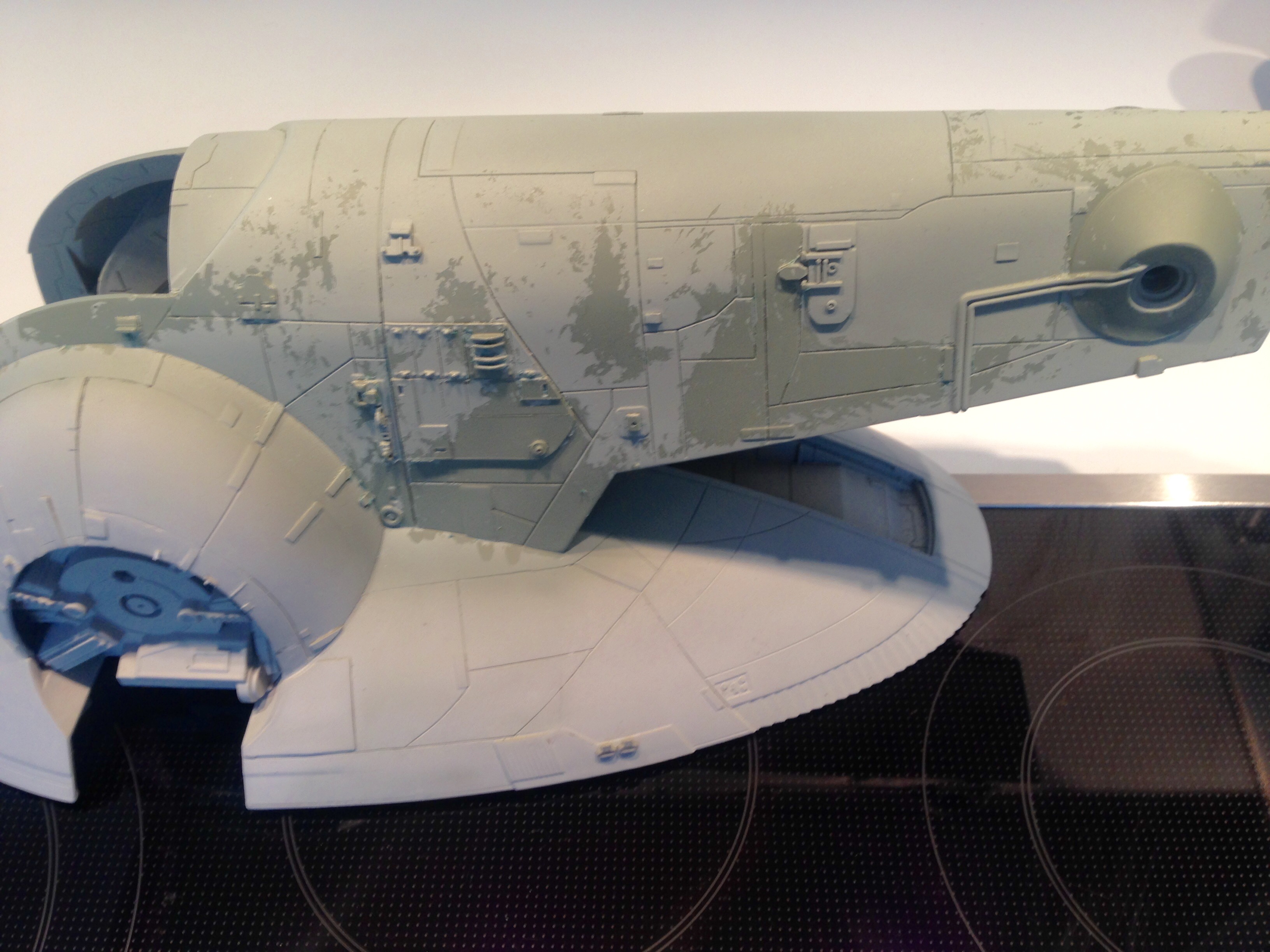

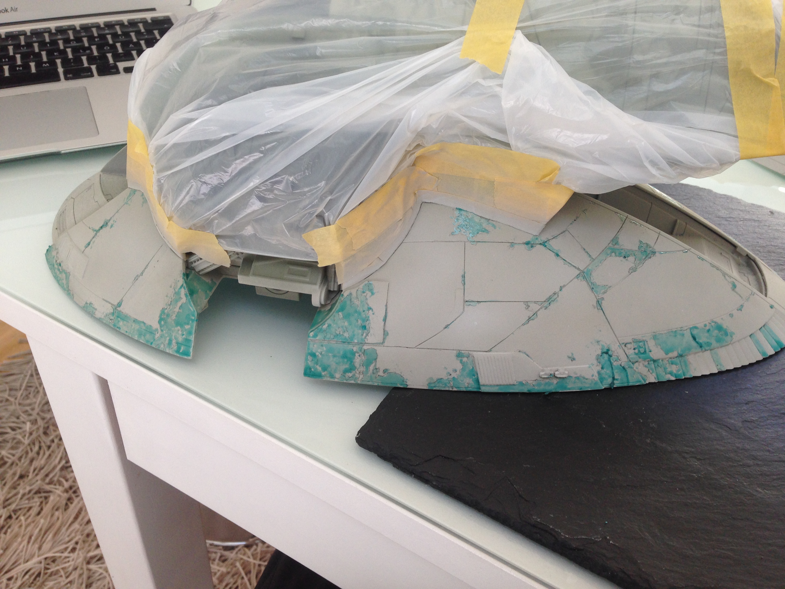

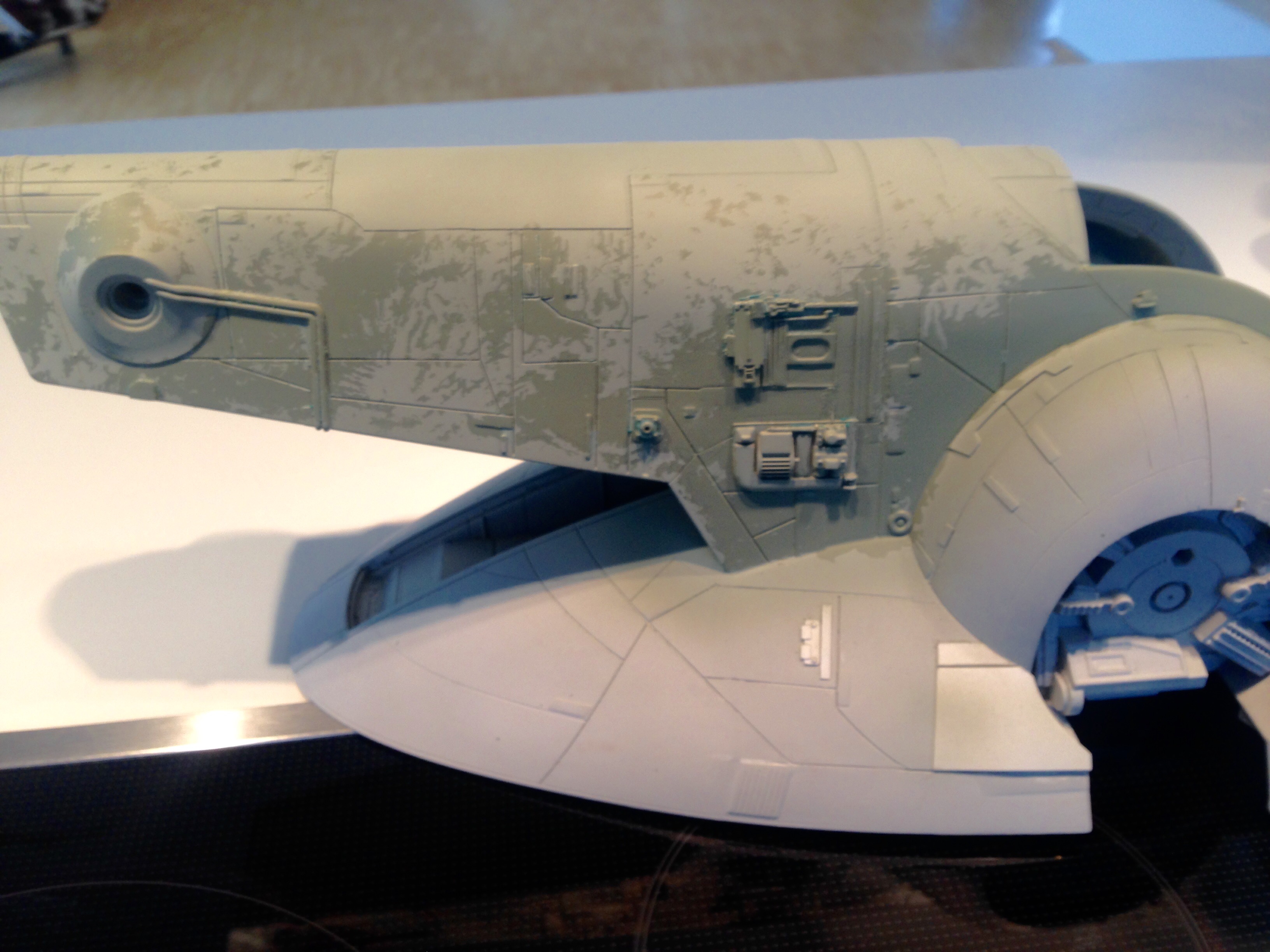

Hi Guys

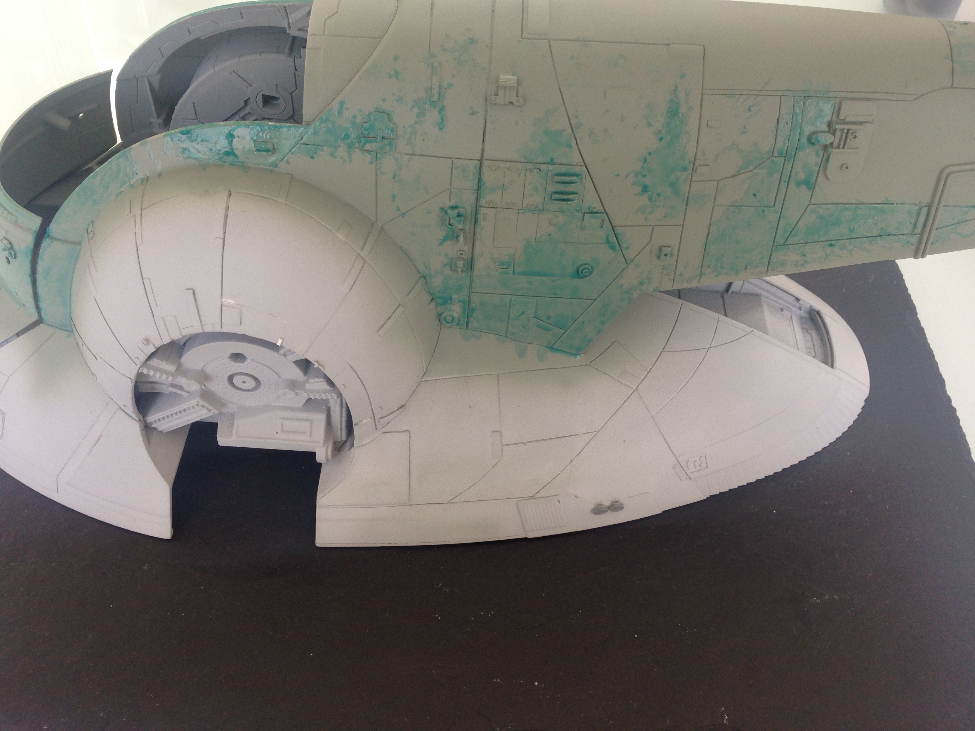

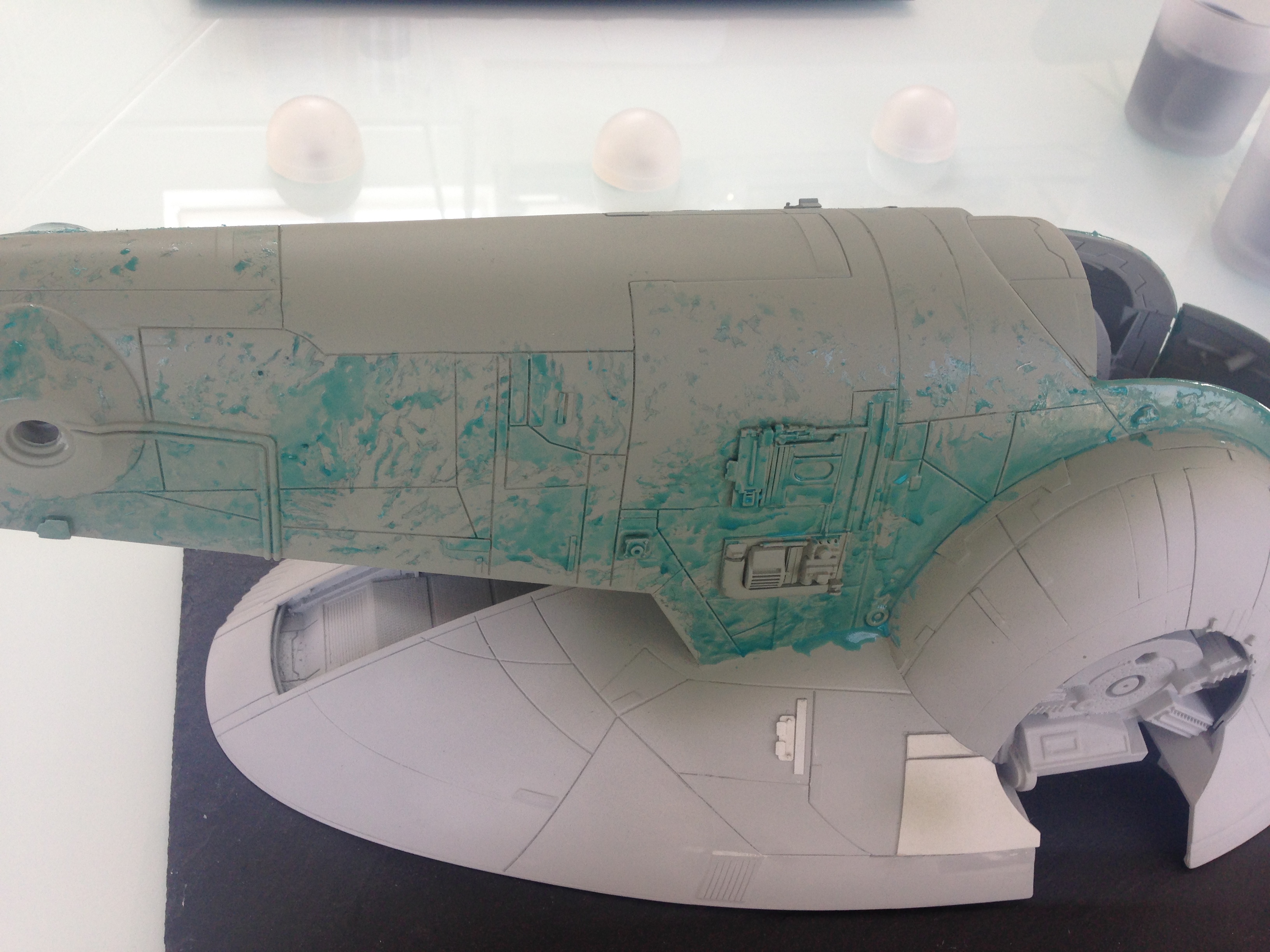

So I did my first mask job ever using Liquid Mask. I actually had doubts using this as I thought that the patterns you can create don't really look like the patterns on the ILM model. To me it looks like ILM used tape and sorta tore off the 2nd layer of paint at random...could be wrong but it sorta look like that.
Anyway I was really surprised as it turned out ok.
I traced the outline softly using a Led Pencil, that gives you a rough likeness to the original pattern, I think its almost impossible to get it 100% but I think I got it pretty close.
Then applying the Liquid mask, pretty tedious and in a way pure guess work, but you have to sort a imagine that this stuff covers 100% and not sorta semi covers it, I was really scared that some of the other paint would bleed through, looks like that cause the Mask is sorta translucent in places, but it really does cover. Used a sponge sparingly to sort a get those fine splatter effects.
The first try came out like this after paint and I must say its not bad at all. Still need some touch up and correction using a brush but not that much.
Next, the Dark Green panels and the Side Bulges...will get out that ol Toothbrush for those splatter effects :)
Cheers Guys.

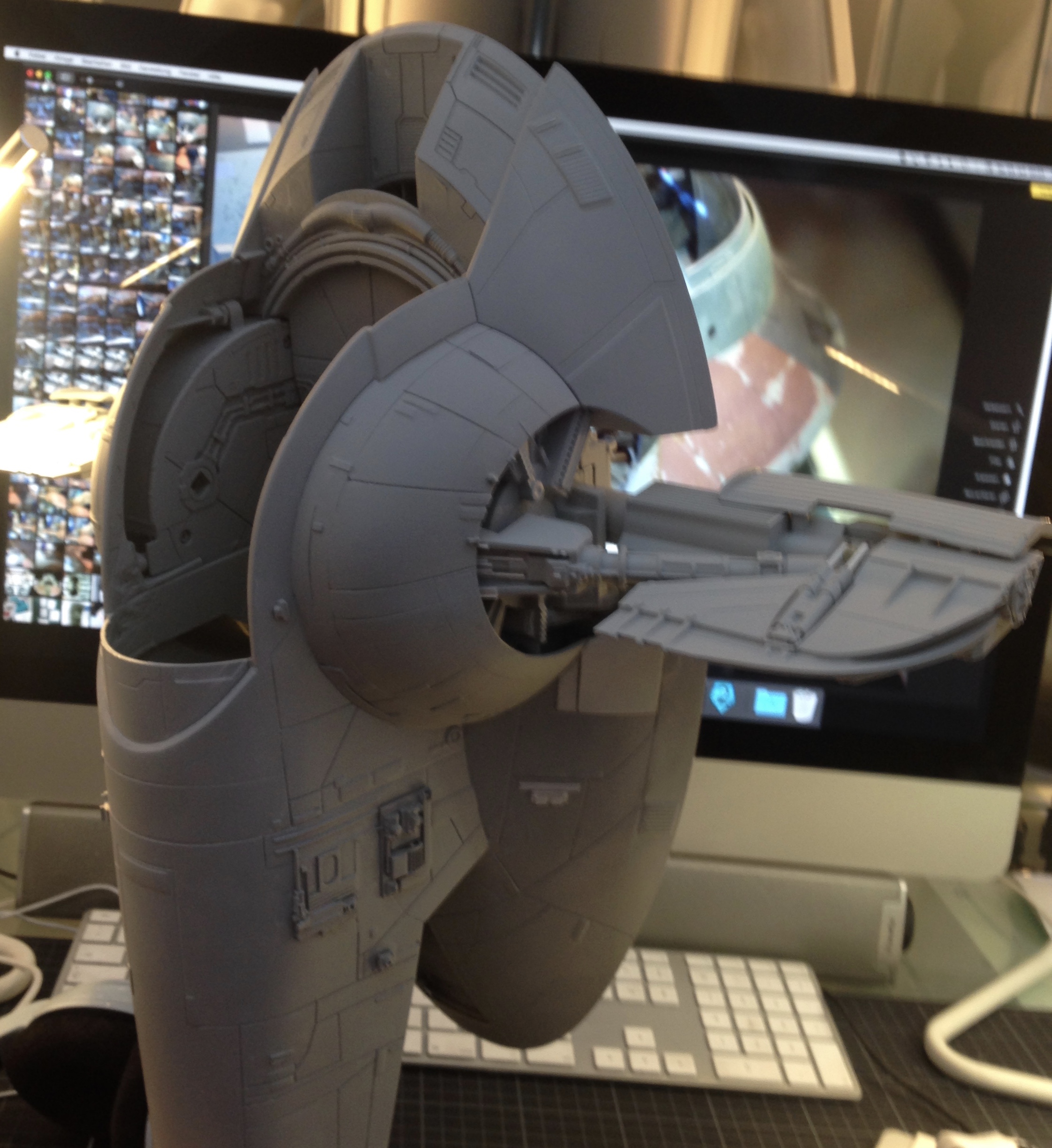

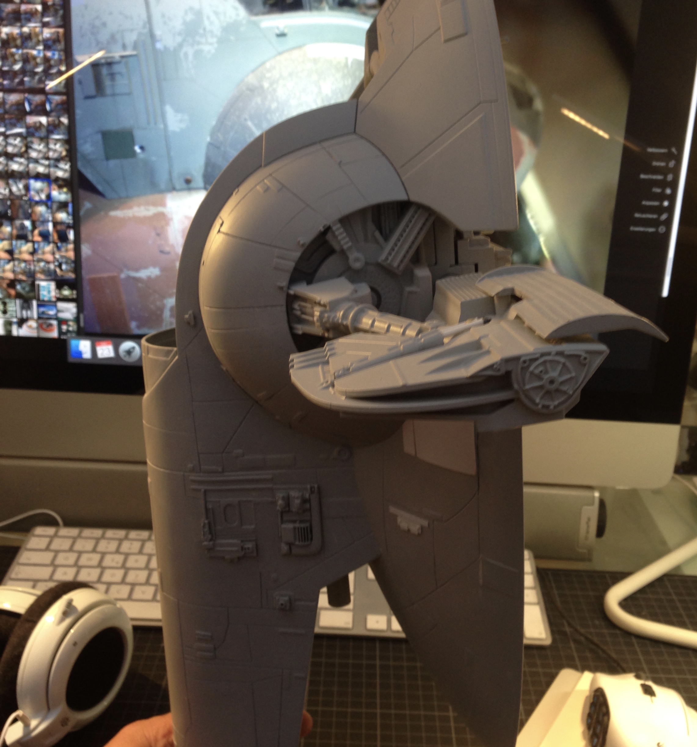

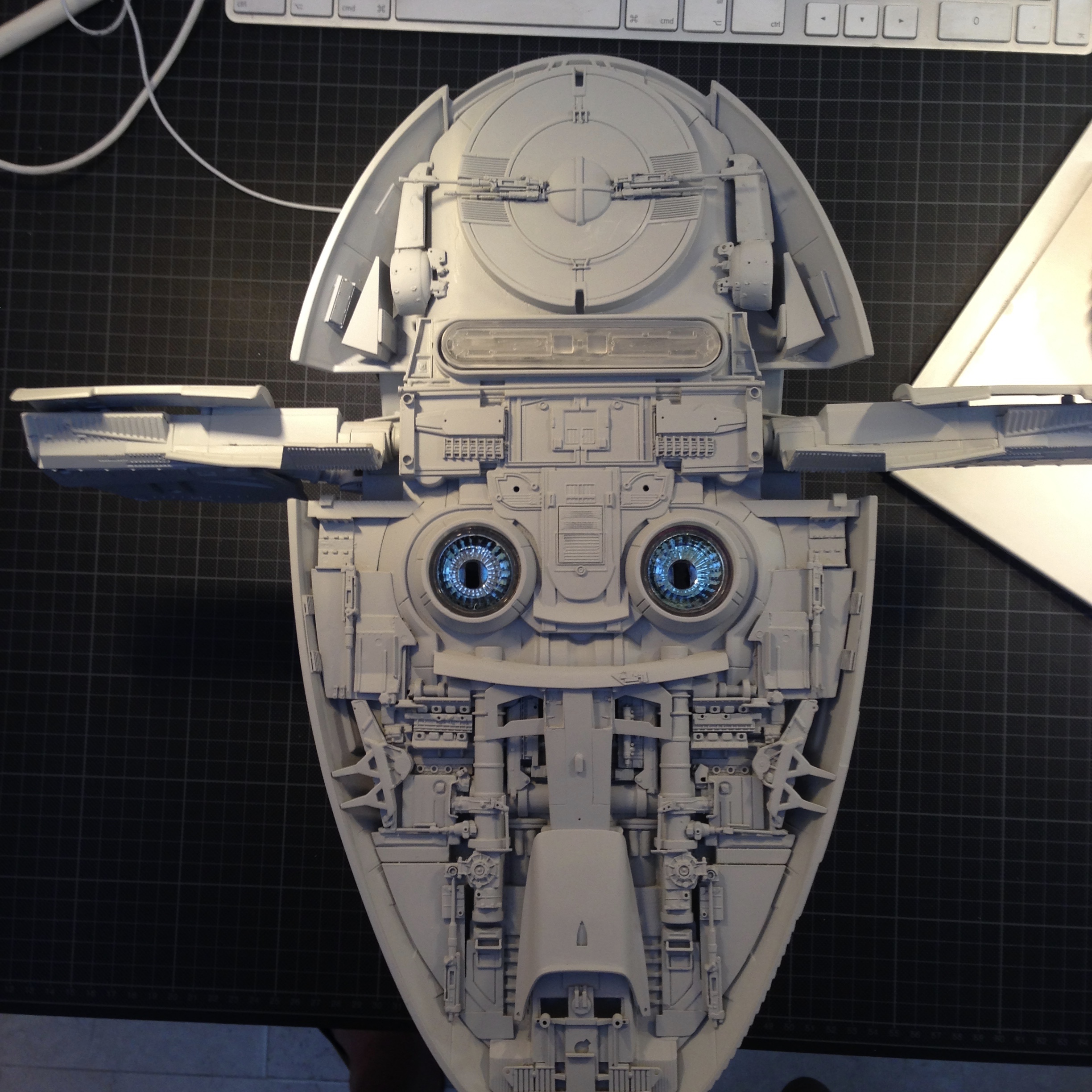

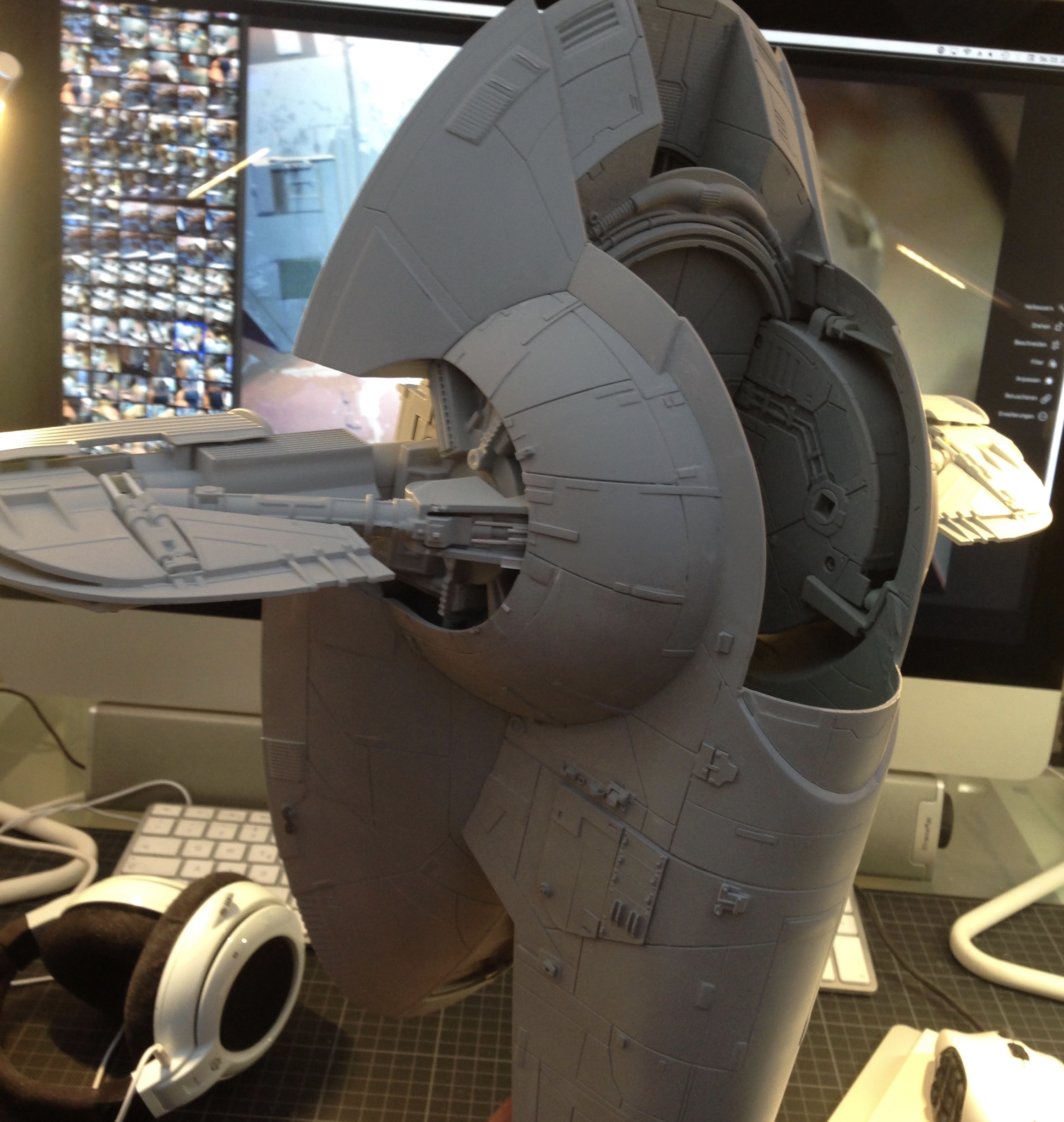

Hi Guys
I think I got it down to where I want to be before starting the Paintjob...now the real deal starts :)
View attachment 647294View attachment 647306View attachment 647305View attachment 647307

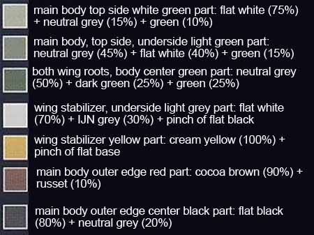

I will start mixing the Paints using the Bandai Slave 1 Paint Guide
View attachment 647308View attachment 647309
They base their Paints on Mr.Hobby/Gunze as far as I know and I will use that as starting point, so far the best color match I found for the Slave, I am sure I will have to tweak it but.
Will post more on the colors when I am starting to mix them.
Cheers Guys.

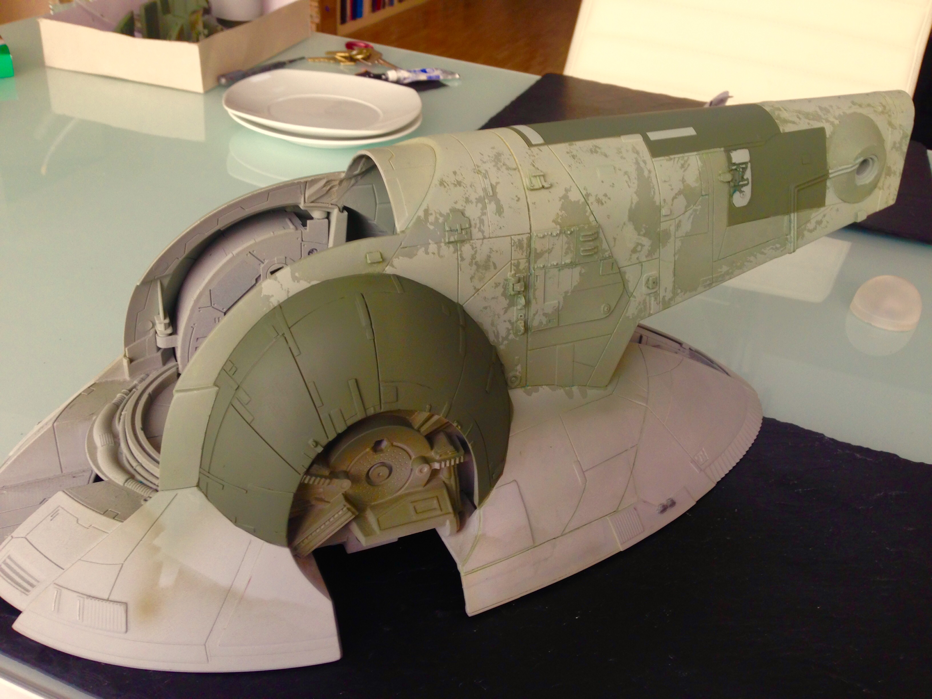

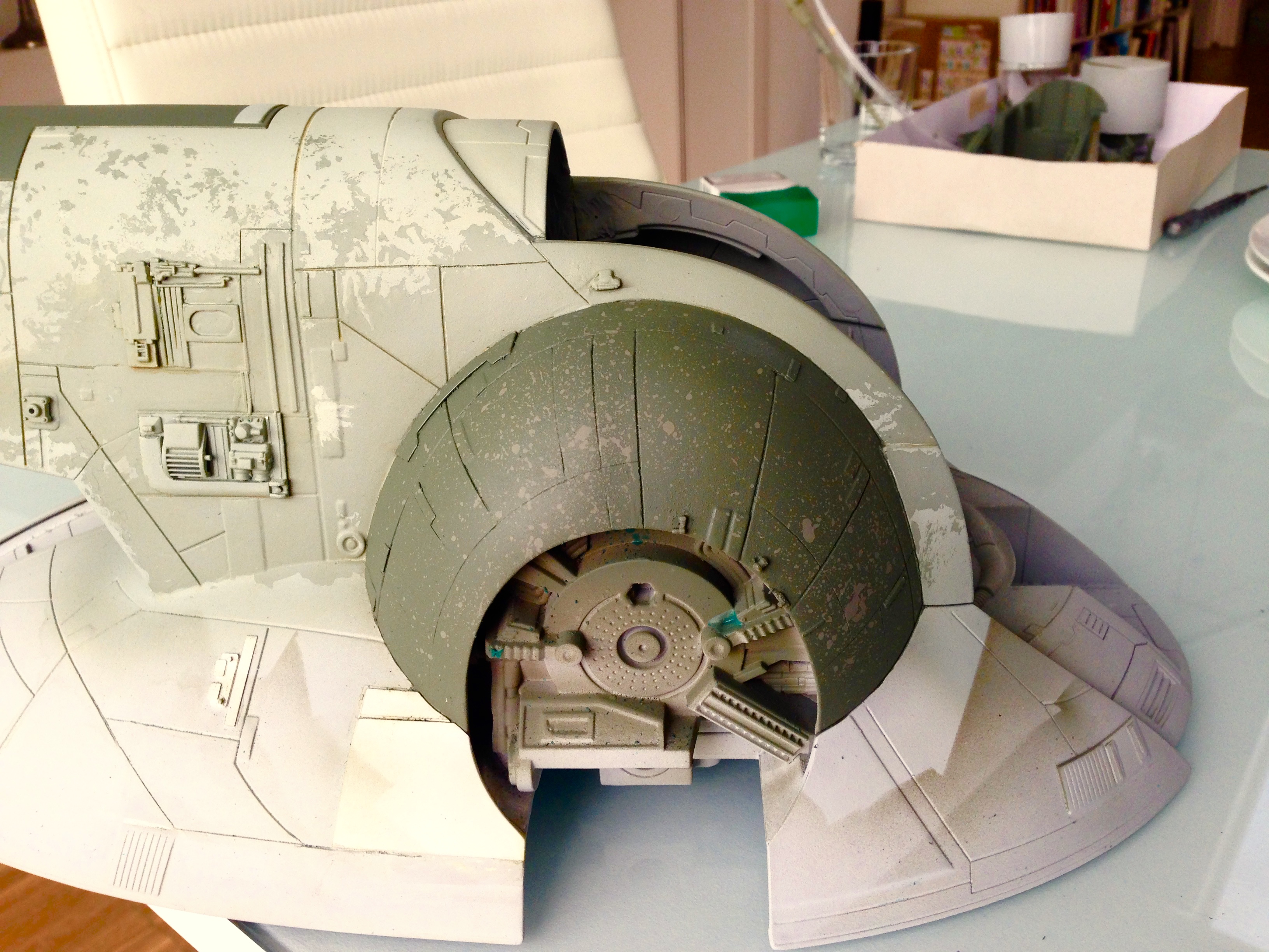

Cheers guys!
Getting the color right have proven pretty tricky, started painting the "Green Bulges" and I am not happy with the hue...and the speckles on the port side are to dark...no matter back to mixing some more "GREEN" today...

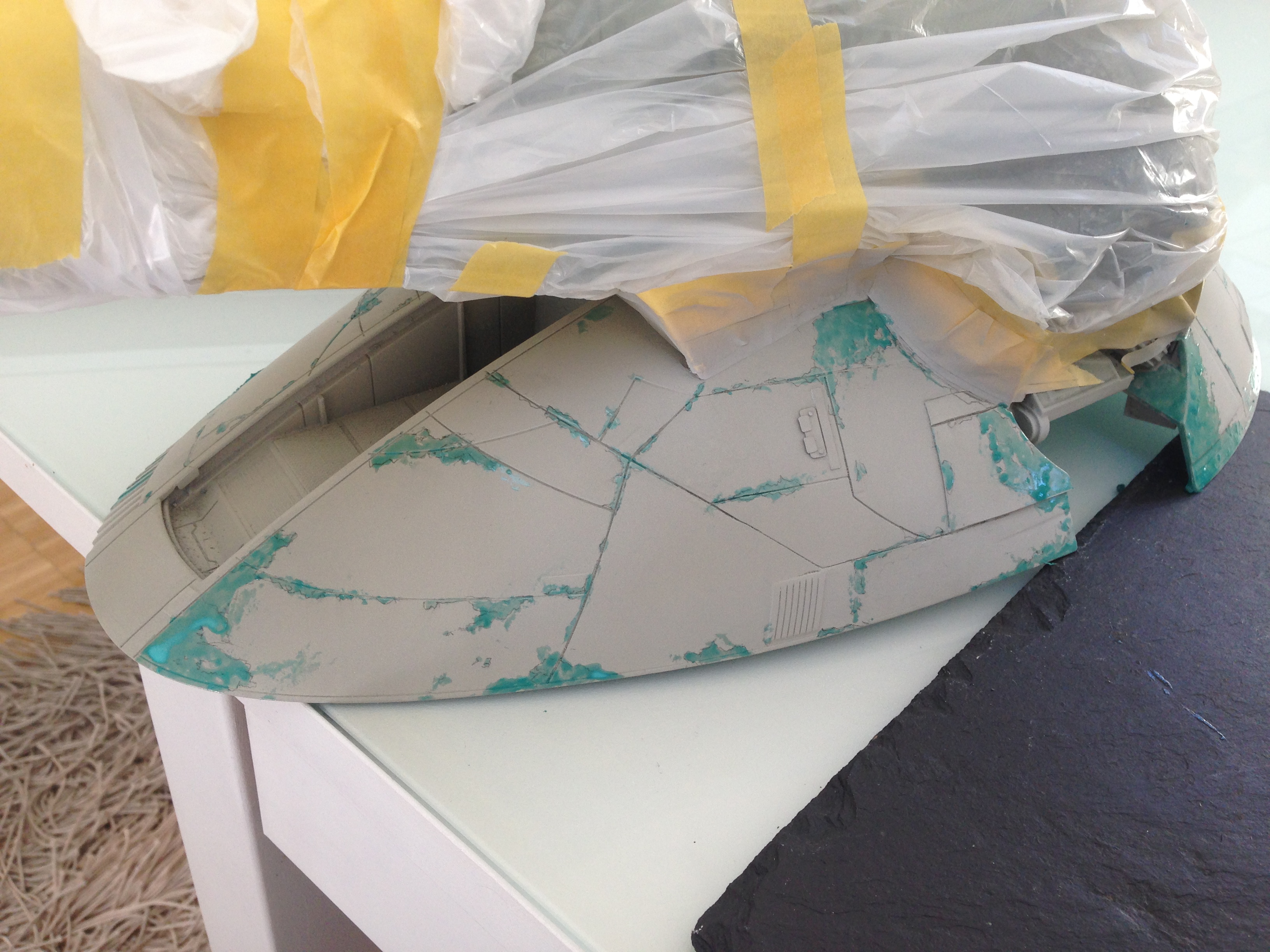

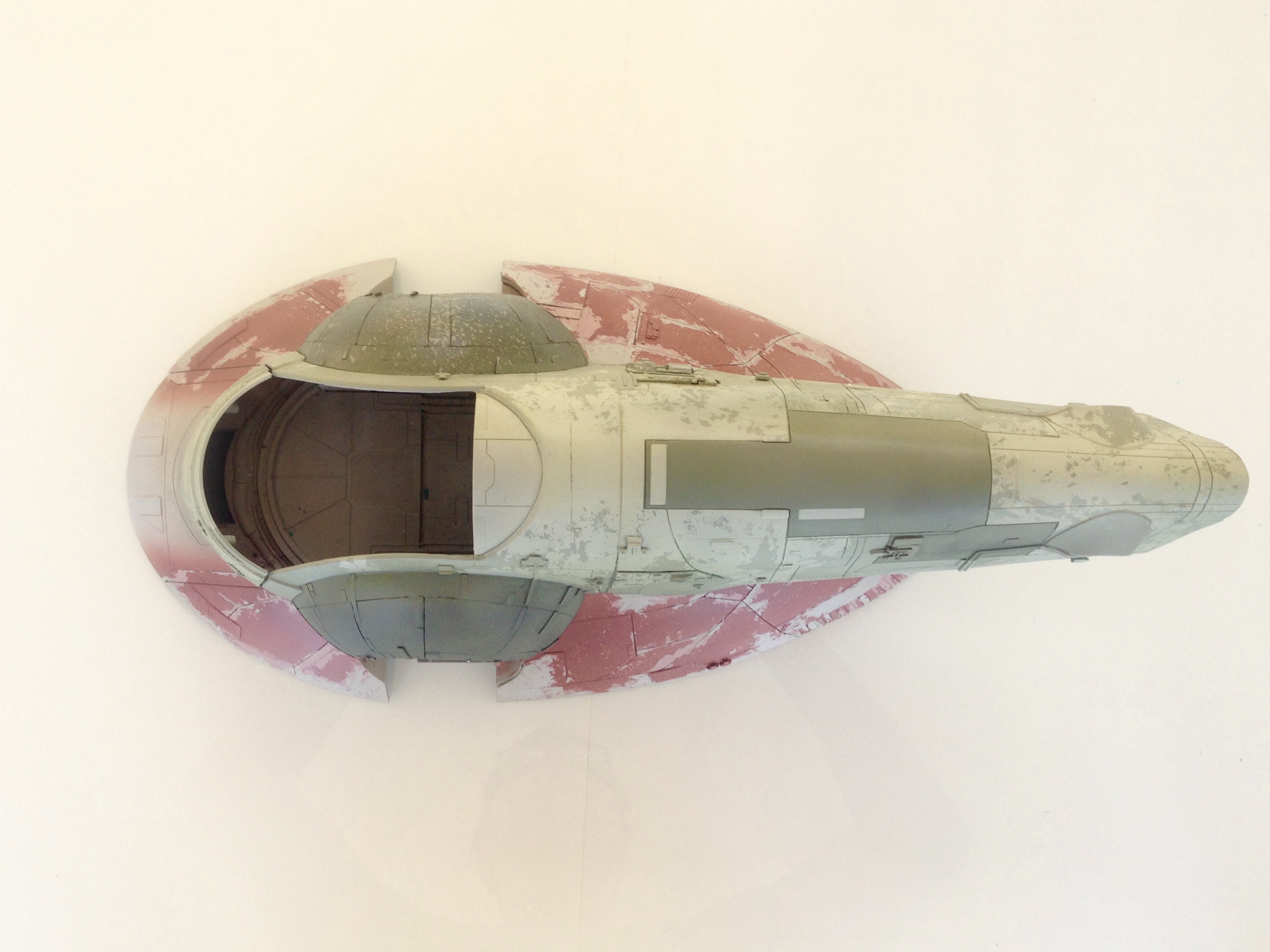

Hi Guys
Update on the paint job...
First I would like to say that Liquid Mask is an absolutely brilliant product and perfect for this kind of weathering. I used the one from Valejo, it has a sort a strong green color so its easy to see what you have masked and what not, I am sure any brand might do the trick, have seen guys use the Winsor & Newton one wich is actually a product for Artwork and such, but seems to do the job none the less.

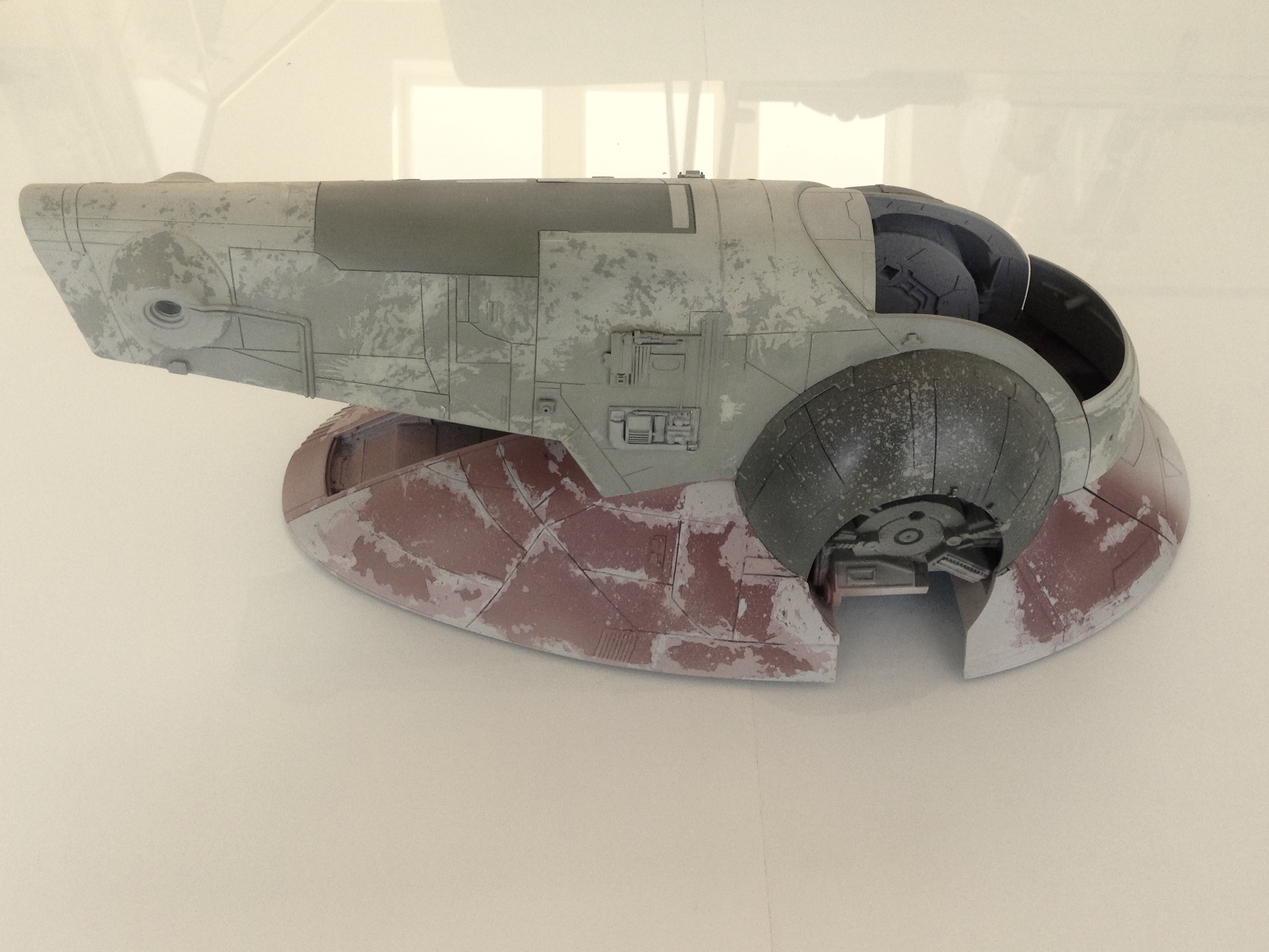

So I dug in to what I think was the most complex part in terms of masking and Color matching...the SKIRT!
I think I was mixing reds/yellows/browns and what have you till my eyes where sore from trying to match the colors from books and ref pic (none of them looks the same by the way) in the end I actually asked my Wife to check it (She is an Artist and has a pretty good eye for stuff like this) so I went for what she said for good or for bad :p
Airbrushed on a light neutral Gray and started to mask of the bits that should later be visible, next I applied the "Flesh/Pink" tone, masked that off and finally the Rust/Brown Color ...sorry forgot to take pics of those last two steps.
I think the end result is ok...I need to make some minor adjustments using a brush as I am not 100% happy with the way some of the chipping is flowing. Thats a little bit the problem when using Liquid mask...its hard to actually see what the end result will be as you are painting in Reverse if you know what I mean. I think it will be pretty easy to correct though, just needs a dab here and there. In the end I will also modulate/weather the colors using Oil anyway so all in all I am pretty happy with the result so far.

As for the Colors I used, normally I use Tamiya but this time I actually started of with the Bandai Slave 1 Color chart (post on page 2) as a base and they use Mr.Hobby/Gunze so I got me loads of those. But in the end I mixed all kind of colors on the fly until they looked right. I tried to stick to that Bandai chart but its only good as a base. So if you ask what exact color I used the answer will be...no idea, look at the Bandai chart and start tweaking :p
