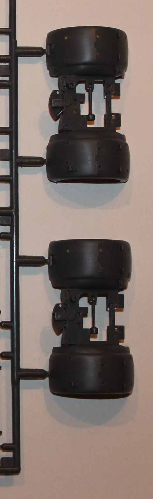

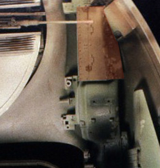

Got another Kit part riddle.
Sits next to the Radar Dish outside those Porsche Fenders, I think the Green part is from the Tamiya 88mm Flak 1/35, but I can't seem to find that red brownish part. My first guess was that it must be from a British Tank because of the Rivets, like a Crusader Mk II/III or something but I can't find a match. I also looked at different trucks (bonnets) but no match, Russian Tank...no match. Any ideas?

Re: CAPTAINCOX Slave 1 Hasbro Mod
Was thinking Italian at first, due to the rivets and shape of the parts, but the Carro Armato and Semovente didn't look right. Looked through scans at Studioscale Modellers and found it. I have a "few" kits at home as well, which helps!
Studioscale won't take on any new members it says on their website :(. Again thanks man!.

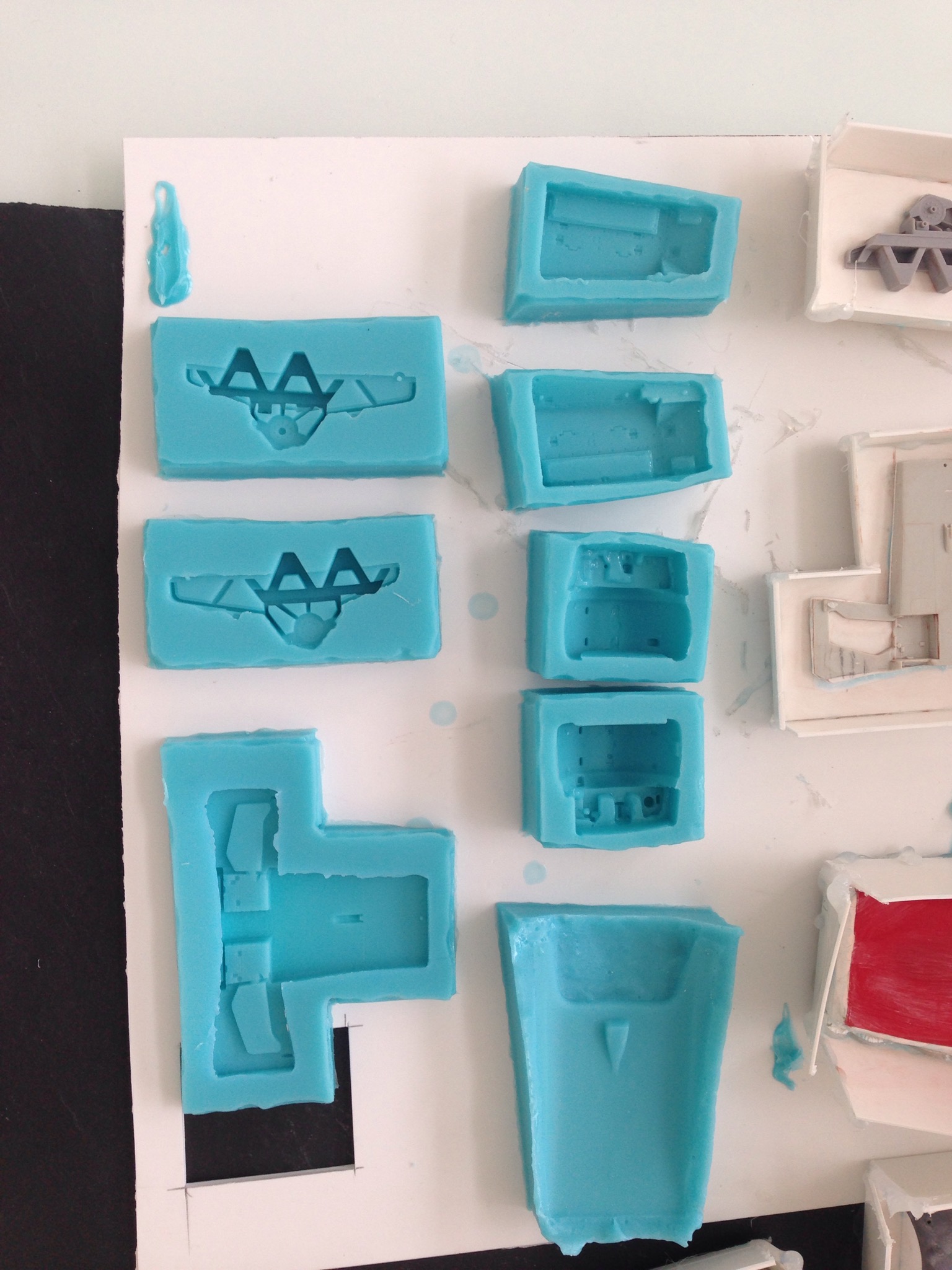

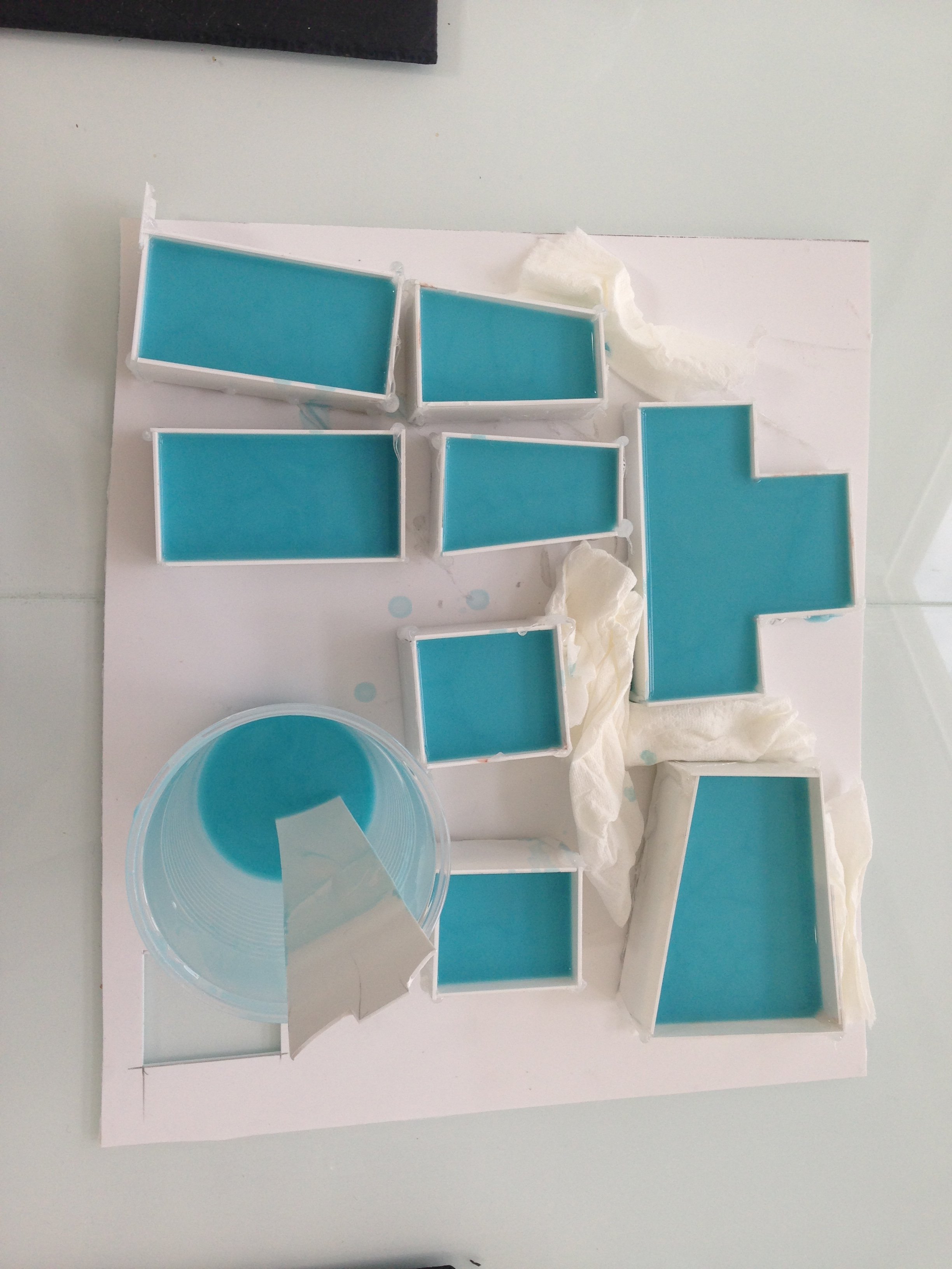

Started to prepare for the Shrink Molds...
The 88 Flak, Japanese Type 1 SPG, F5 Tiger II, Mörser Karl and I will pic up the Ferrari 312 from the custom today.
Mold box preparation ready to be hot glued together.

I actually got the Silicon yesterday and of course I went right at it :p
I think the molds came out ok, might need to get rid of some flash or what have you. I realized that I did a mistake casting the Ferrari 312 nose, the mold don't have a back wall, but I fix that when pouring the Resin later.
Now comes the interesting part...waiting for them to shrink.
On the website from Smooth-On (maker of the Novocs Thinner) it says up to 18-20% shrinkage over 10 days...I really hope it will go faster.
Cheers Guys

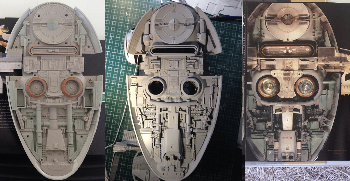

So I finished the Shrink Casts.
As you can see I had to do two batches as the first one only shrank about 10mm, target was about 20mm. The shrink process sets in almost directly after demolding the parts. After about 20-24h it seems that the max shrinkage has taken place, it could be that it shrinks more over Time but I did not want to wait :p.
After the second cast I sorta hit the right dimension. The resolution or detail quality is not bad, not as good as the original but close enough I think.
This method does require a lot of patience and is somewhat costly, I think I spent around 70€ as I needed to do two batches. It does work though and is a pretty cool method if you don't want to scratch build parts and have access to original Kit Parts.
I guess the next level would be to completely scratch build the hole thing...but as it is a Toy Mod I think the result so far is ok.
Comparison of the Original Hasbro Slave-My Mod-Original ILM Model
Almost done...still some detailing stuff to do but it aint looking to shabby. Now I can seriously start thinking of Painting it...and that will be equally challenging, but fun none the less.
Cheers Guys.
