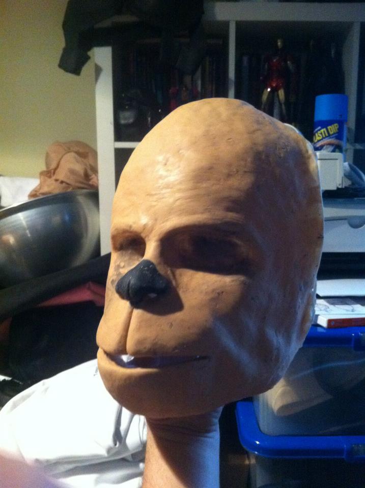

Luckily I already had the workspace to sculpt the mask in, and an old plaster lifecast I wasn't doing anything with. So I printed off the reference I needed, got myself some WED clay, and got to work.
Here's a pic of Chewie as he looked before I started pouring the plaster shell mould. I made a wall out of old business cards, and got pouring.
Once I demould, I'll be able to clear out the residual clay so I can start pouring the Platsil Gel-10 silicone. I'll keep you guys posted, and hope you enjoy what I share.

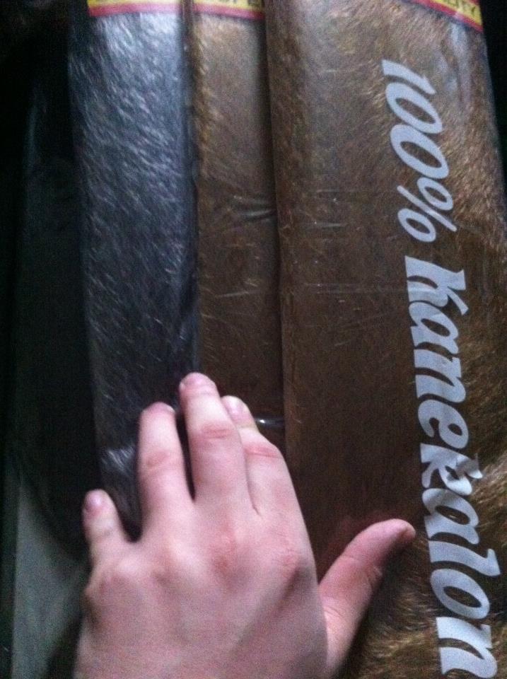

I got these as a sample of potential fur. While personally I think these look great, they might be a little too ragged for Chewie. What do you guys think?
They'll work great. You'll just have to straighten out the hair first. Two options; 1. Hold on to one end of the hair while blow drying it and brushing. 2. Use a straightening iron that allows for low temp settings.
With both of these you have to start out with a very low temp and work your way up. There's a fine line between straightening and melting the synthetic hair.
Which hair colors are you using?
I read on "Making Wookiee" that the brown is #27 (honey blonde), and the grey is a mix of #4 and #44. But having ordered two samples of #27 from different sellers, I've learned that the numbers aren't really a universal match. This #27 pictured looks to be the shade I'm after, just slightly the wrong texture. I'll keep hunting to see if I can avoid needing to straighten it all.
The herculite plaster mould. Like a FOOL I forgot to spray my mould release on the sculpt before pouring the plaster over it, but most of it came out pretty smoothly. :p
The Platsil Gel-10 silicone face, with a resin backing layer that'll become the underskull of the mask when it's done. I still have to cut the eye holes out before I carry on, but it's looking pretty promising so far!
Looking great. I don't think you'll be able to avoid straightening the hair. Unless you want to go with a natural hair. Which will get pricey in a hurry. The straightening doesn't take that long at all really. While it's not the most exciting part of the build, it helps keep the cost down. All of the hair for my full chewbacca cost less than $100...and I'll have more than I'll ever need!

Hmm, I'm holding this pull right now, and while I love how close the sculpt is looking, there's definitely areas that I cast too thin and others I cast too thick. Think I might have to order some more silicone and try another pull. And next time hopefully get better coverage of the black around the nose and eyes.
In the meantime I suppose I can use this pull to test out my hair punching technique. :p
