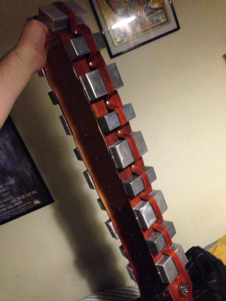

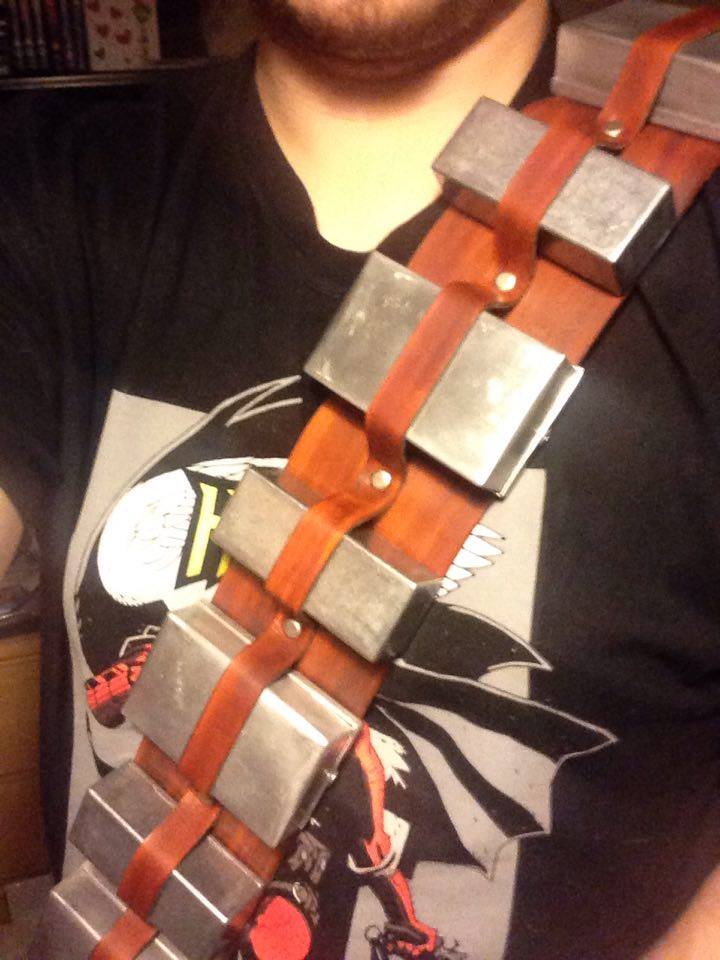

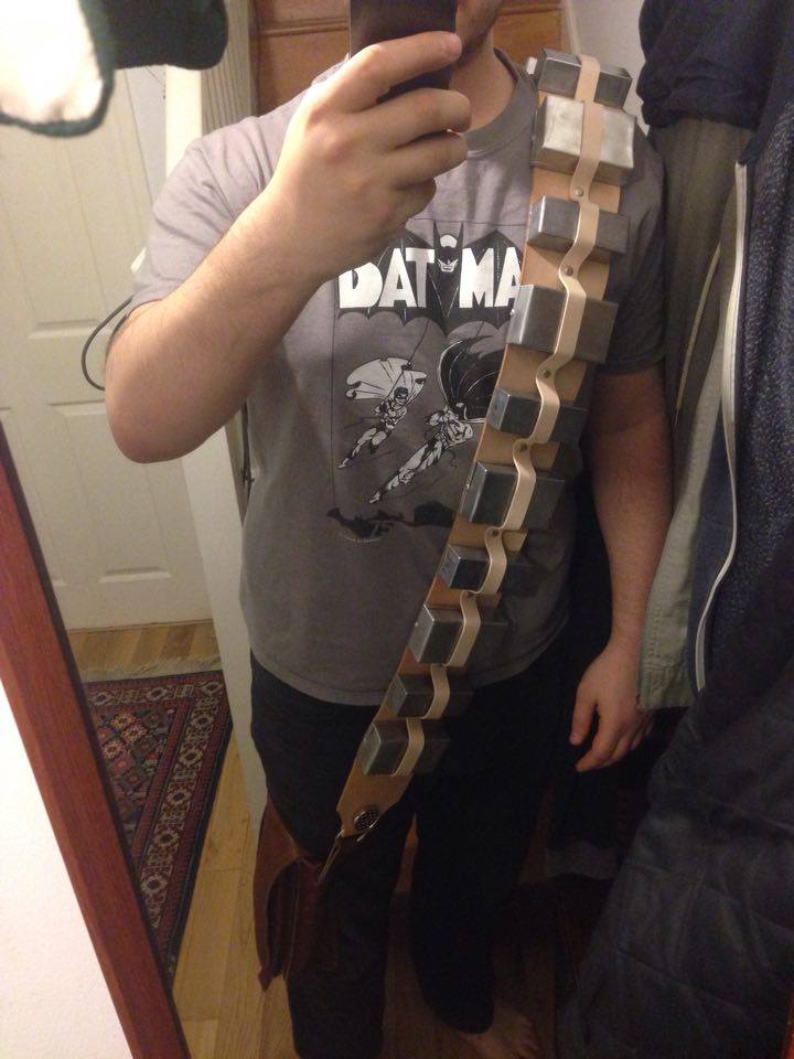

My leather bandolier with accurately sized aluminium boxes and the ANH discs in place. This is the first pass at dying the leather, and I don't think the colours look as deep as they should, so I may well do a second pass closer to completion. But for now, this is looking pretty darn cool.
12319387_10153712627946698_565108891_n.jpg12511651_10153793027171698_1369444559_n.jpg12511637_10153793027211698_2027125325_n.jpg

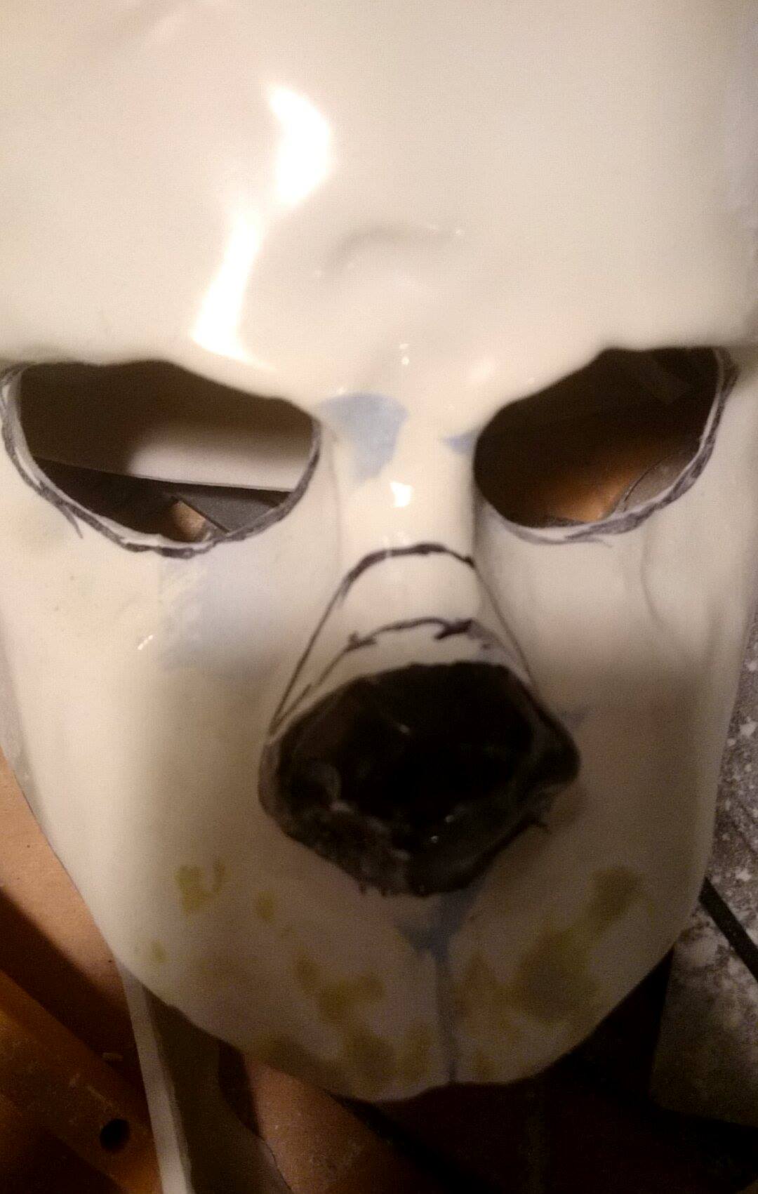

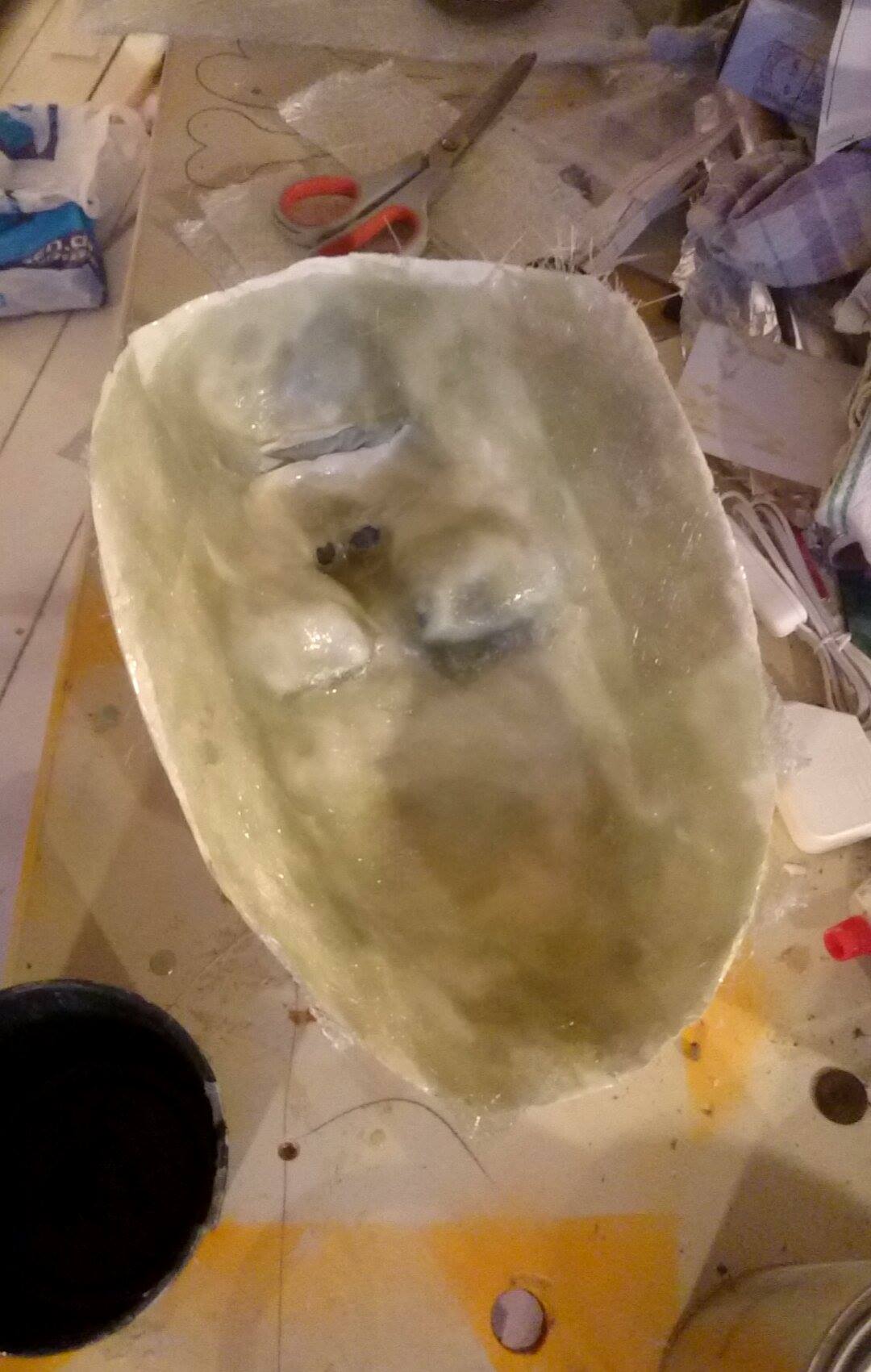

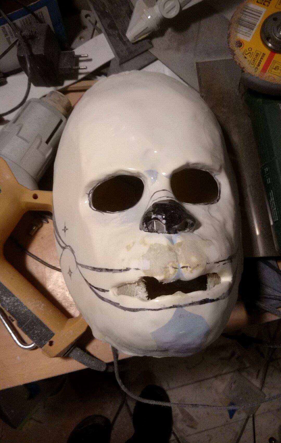

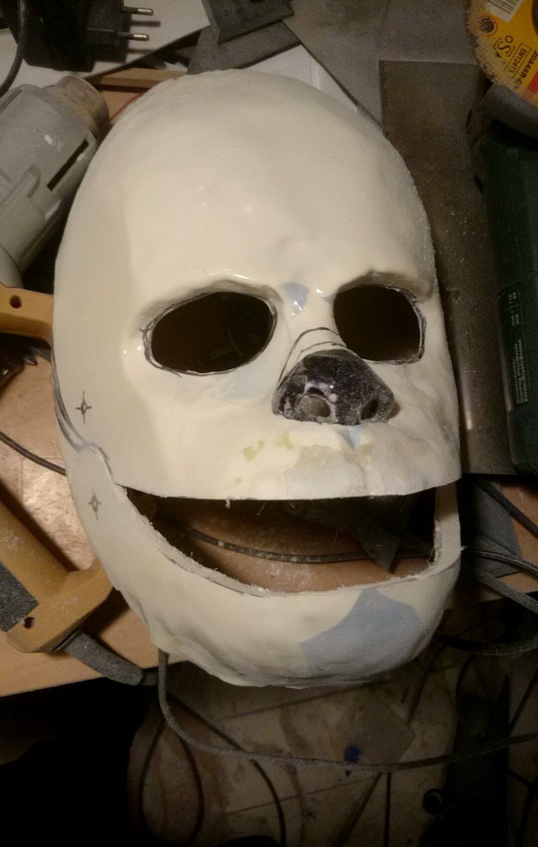

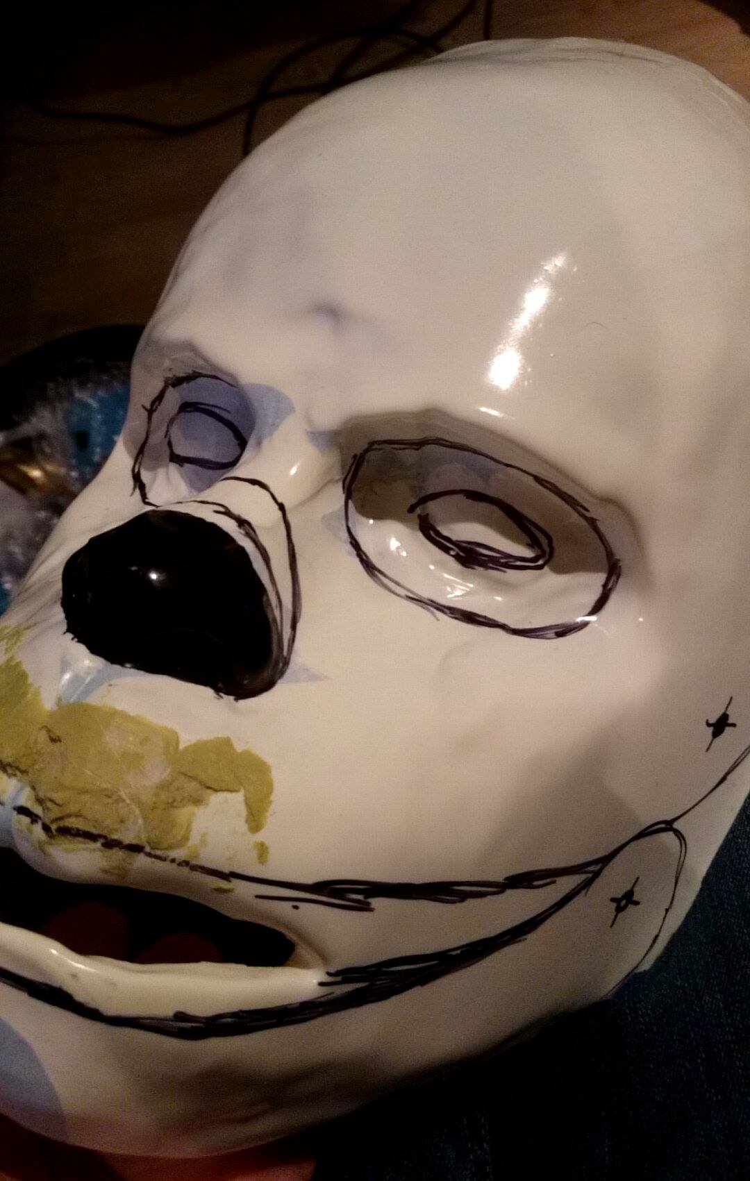

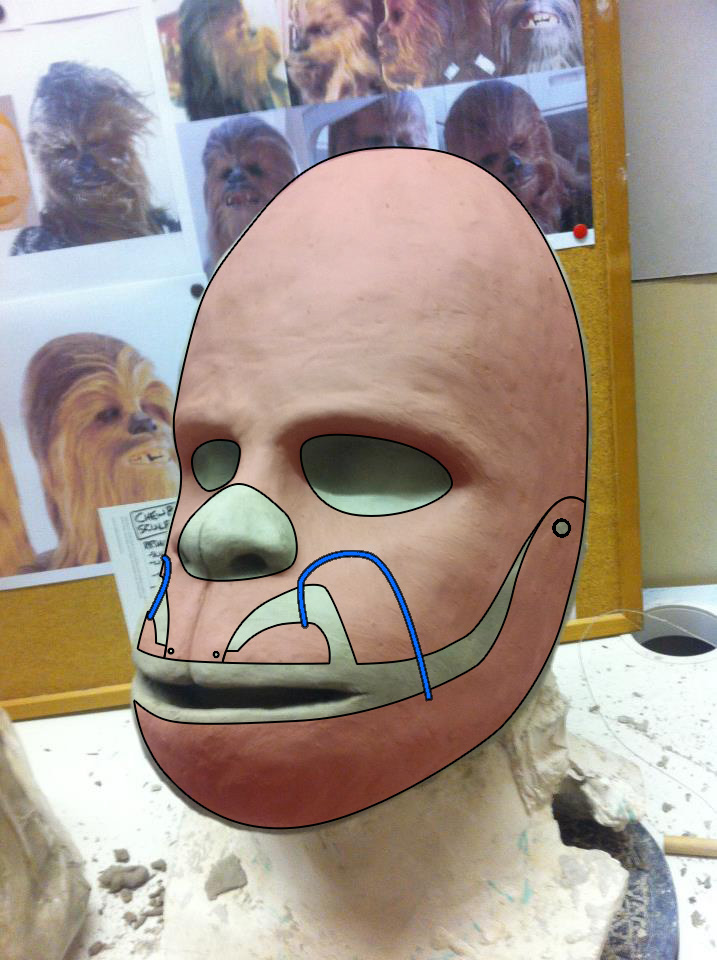

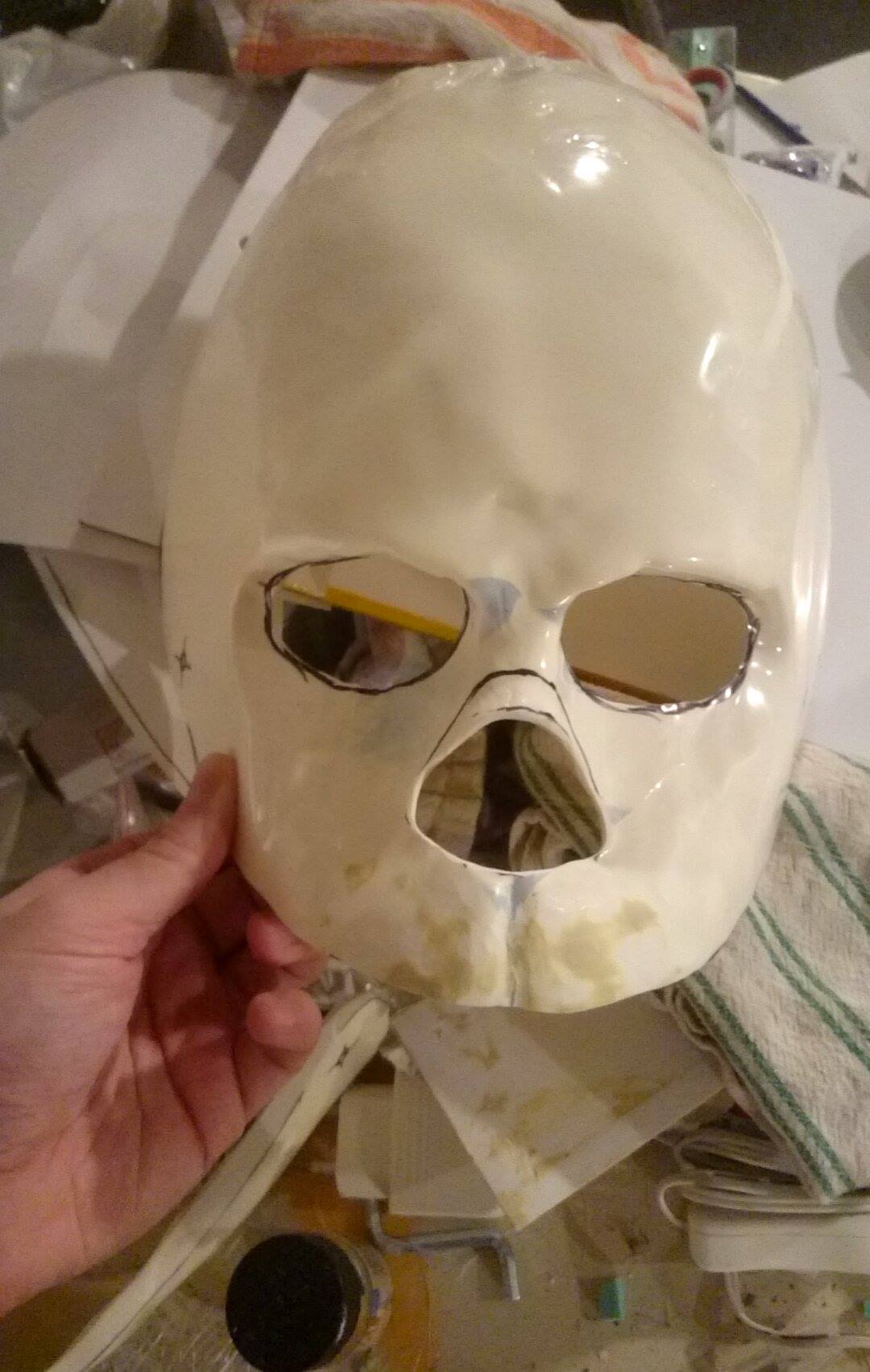

Chewie's underskull, being fibreglassed by my friend Oli Mansfield (of Wibbly Wobbly FX in Denmark). The plan is to run wires from the jaw to control a lip snarl mech, just like the original Freeborn design. I've simplified a couple elements because I still consider myself a novice in the creature FX field of costuming, but I'm trying to keep it as authentic as possible. Hoping to get some 501st approval out of this costume lol.
underskull_concept.jpg12476677_908485502533605_1780127692_o.jpg12490025_909022029146619_1700263979_o.jpg12400199_903337566381732_1277734158_o.jpg12471277_909033635812125_757827902_o.jpg12471297_909023725813116_711485275_o.jpg12482782_909027389146083_1022784925_o.jpg

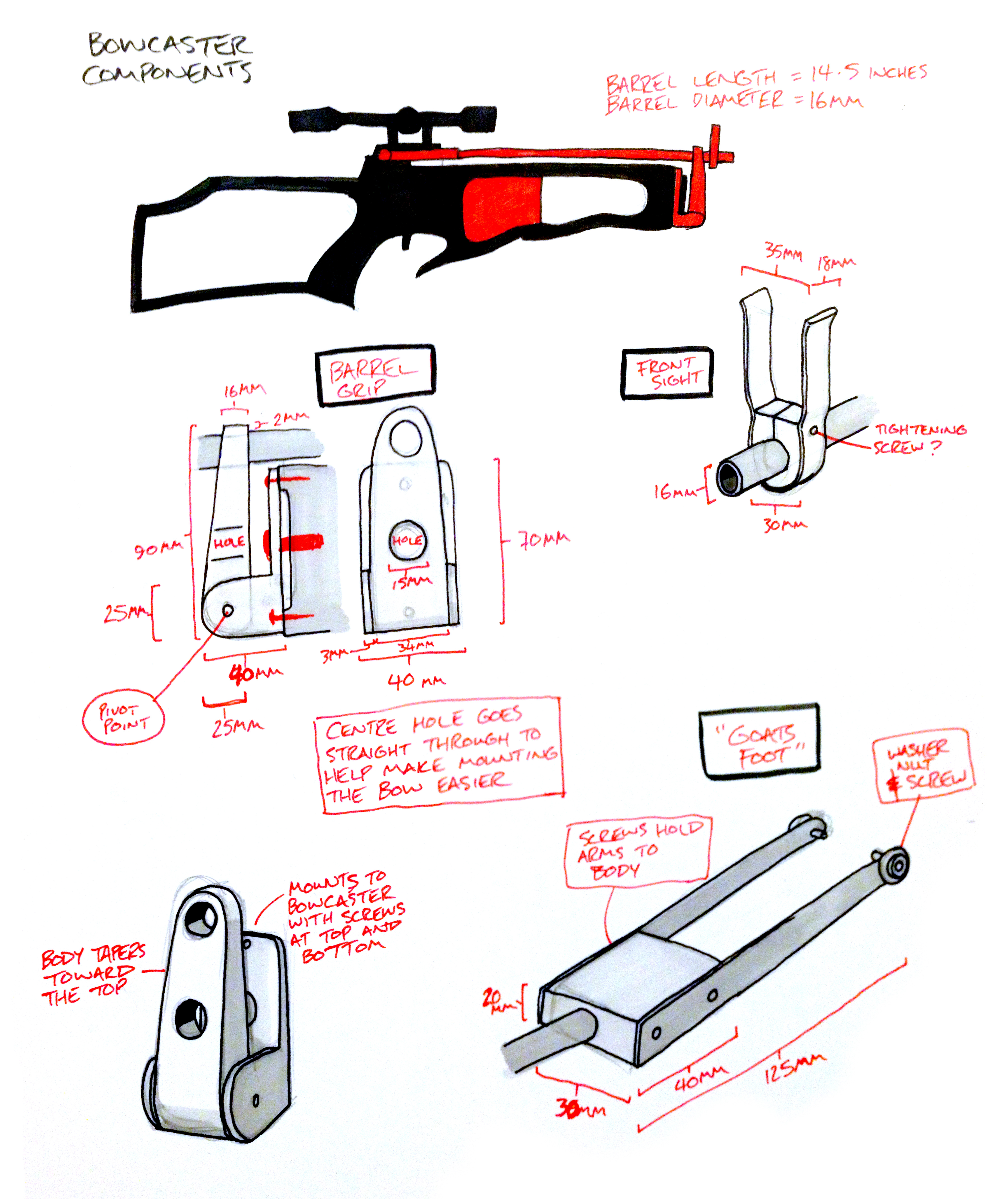

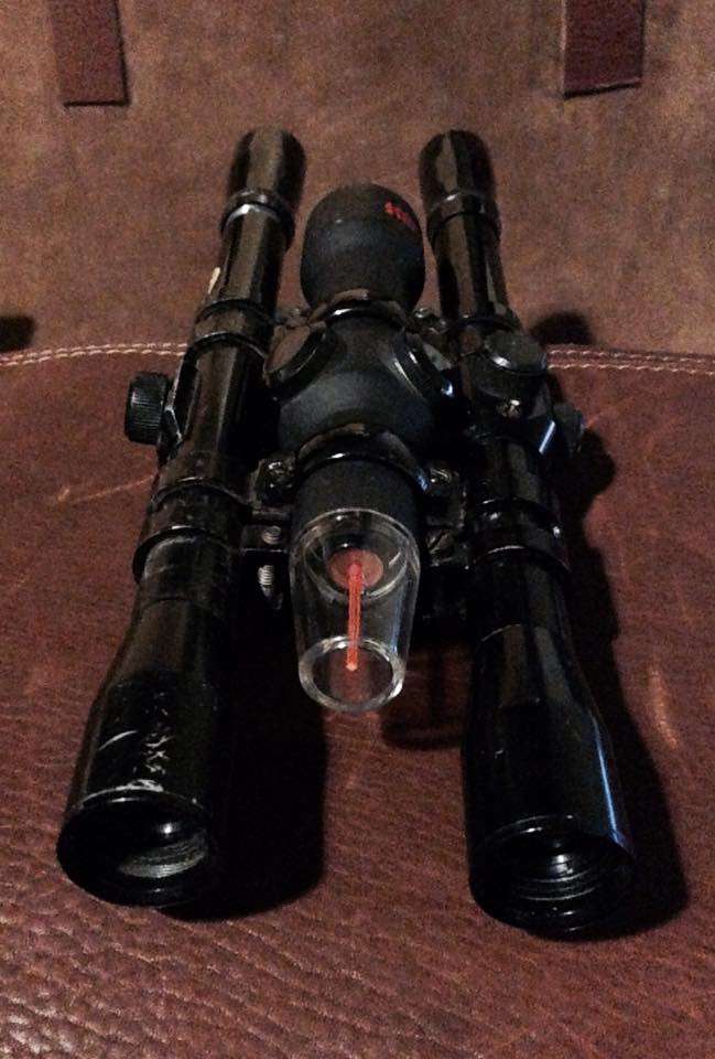

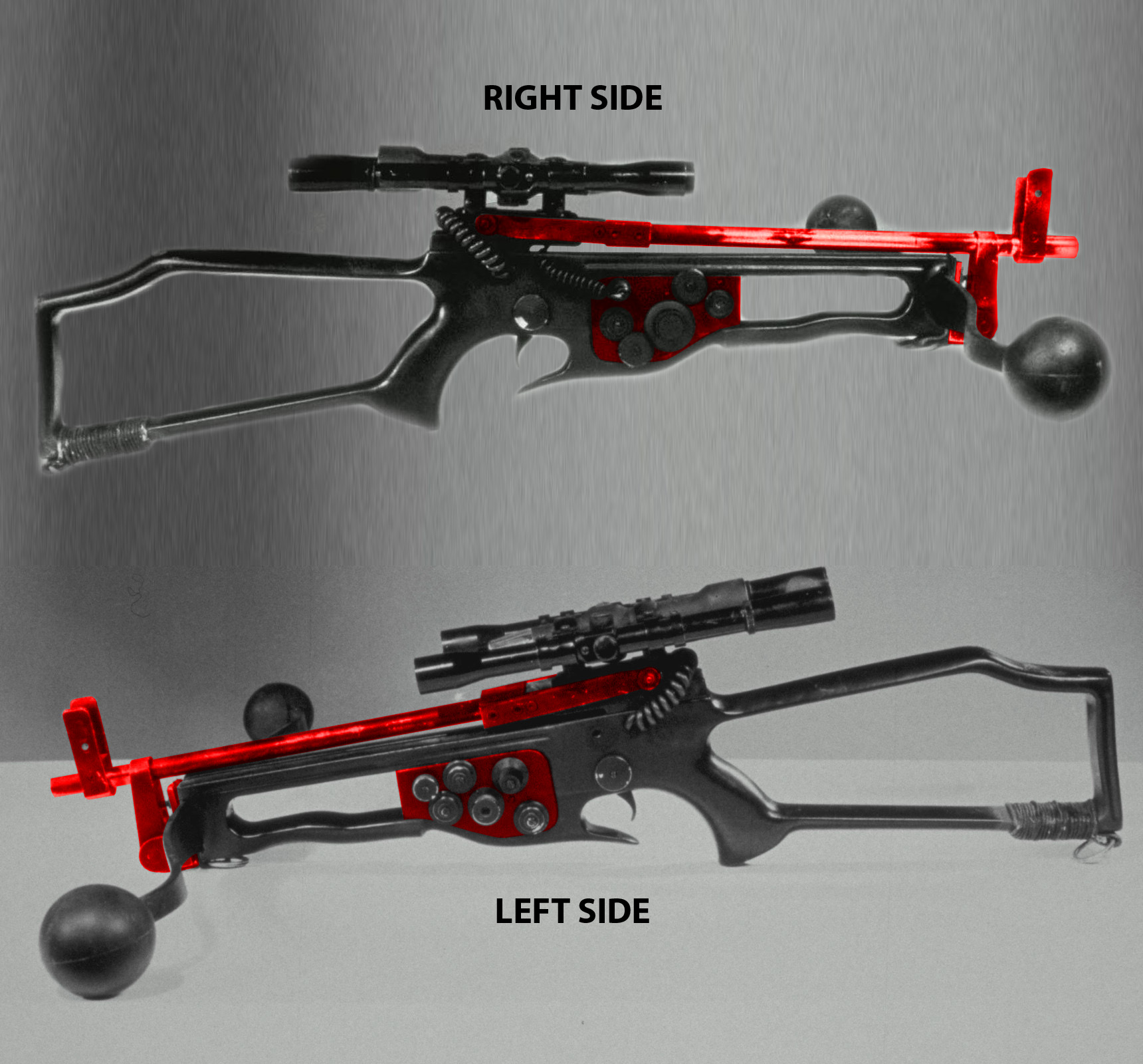

... and finally, bowcaster progress! I figured out how to assemble my scopes (all accurate ones from what I can tell, but the scope mounts may be a little shorter than the ones used in the films) and have started working with a metalworker friend of mine (same guy who made my larger bandolier boxes) who I'm commissioning the remaining attachments out of. Also hoping to get a soundboard and ultra bright LED wired into the stock, to make the bowcaster fire at bucket-headed troopers hahaha.
12122437_10153634837411698_5199708141609295628_n.jpgbowcaster_metalpiecestobuild.jpgView attachment bowcaster_components1.jpg
