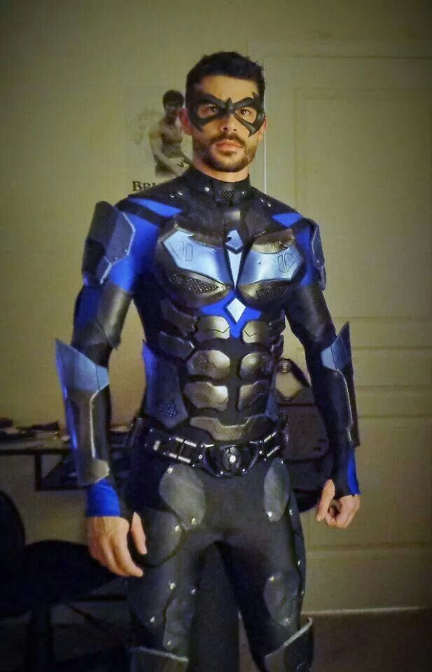

Very cool concept, the build sounds similar to Shawn Webber's style, especially his blue nightwing suit.
Nailing the cowl/face will be the toughest part, I've yet to see that pulled off perfectly because if you try to imitate the animated style, it looks strange in real life. I personally think a real life Batman Beyond suit's cowl would be a like a cross between Spiderman, MCU's Vision or a really slim armor Iron Man.
Attached pictures of Webber's Nightwing and the art I found that made me think of a Vision-esque Batman Beyond mask.
Yeah I've been following Shawn Webber for a while and took some inspiration from him without realizing it lol. I agree with the mask and thats why I'm making a perfect fit latex one for my face, giving it a look similar to the picture you added.
