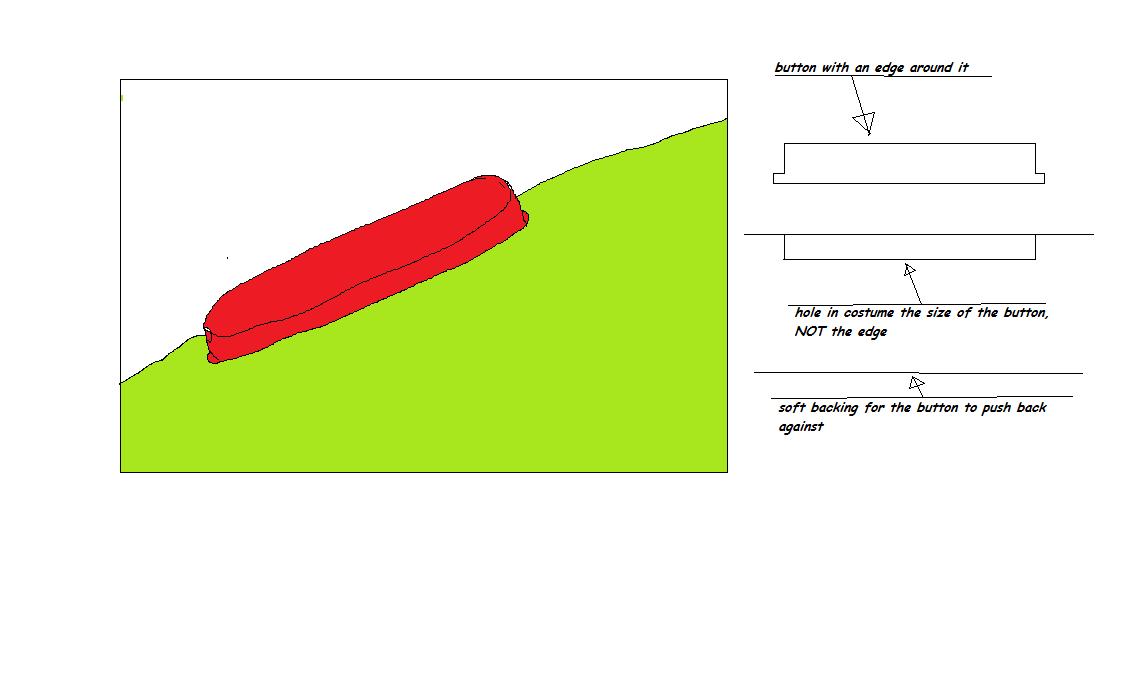

lightyear buttons.jpgHow about this? Make the buttons(vacuu-form, papier maché, fimo, fiberglass resin, etc) with an edge around, so a cross-section looks like a hat. Then, cut a hole in the main body of the costume the size of the button, NOT the edge. Then put something spongy behind the button so it has something to push back against. See attached bad drawing. Am I explaining myself?

View attachment 229093How about this? Make the buttons(vacuu-form, papier maché, fimo, fiberglass resin, etc) with an edge around, so a cross-section looks like a hat. Then, cut a hole in the main body of the costume the size of the button, NOT the edge. Then put something spongy behind the button so it has something to push back against. See attached bad drawing. Am I explaining myself?
Thanks for the suggestion! Perhaps I can get these buttons going once I am able to finish the costume.
