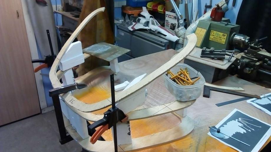

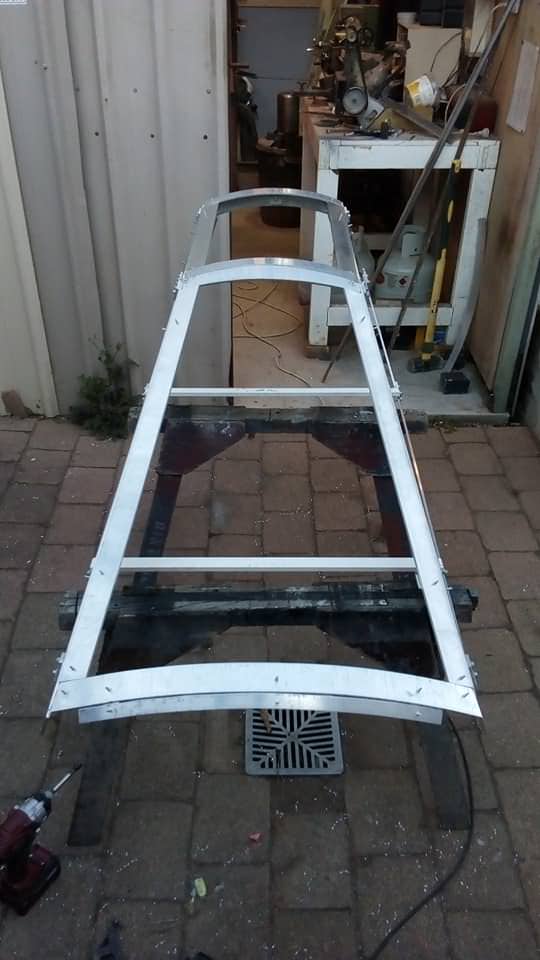

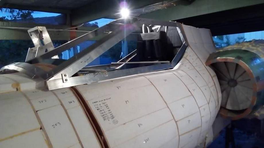

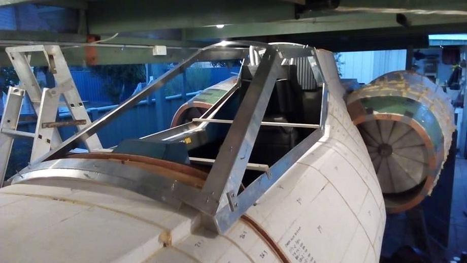

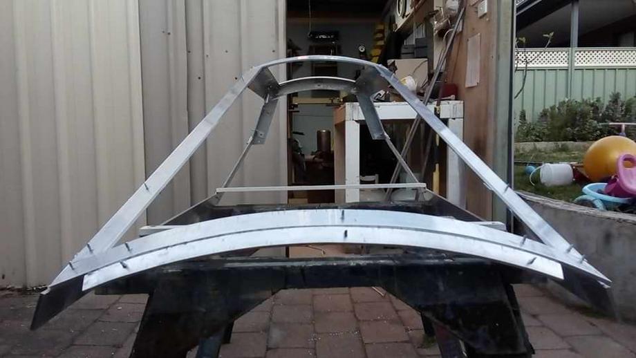

I did however, steal a little bit of time today to finish bracketing the canopy together. It's all done now, ready for welding. It fits nicely on the cockpit now, with both bottom bars parallel. I can now go ahead and install the track and rollers for it to run in so it can slide forward.

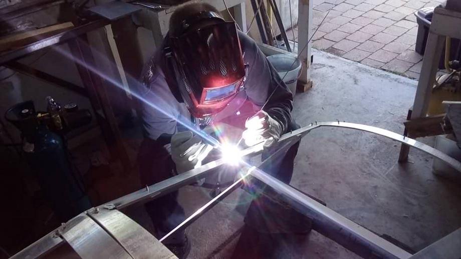

Update:
My friend Jacob has again volunteered his skills as a welder. I'm pretty good at MIG with steel right now, but hopeless at TIG welding. Jacob has his own machine and has been practicing for a little while.

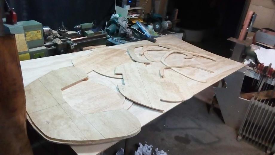

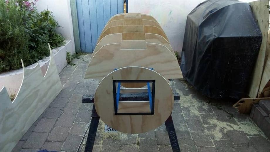

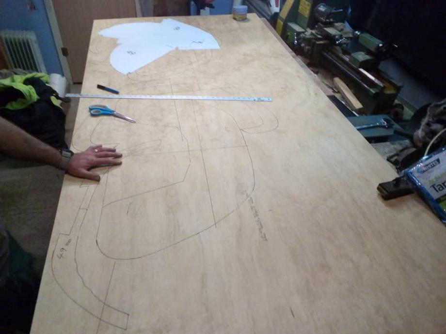

The last former templates have now been printed and cut for the top engine. This is the last major module of the ship. After this it's just wings and armaments. Ready to trace onto plywood.

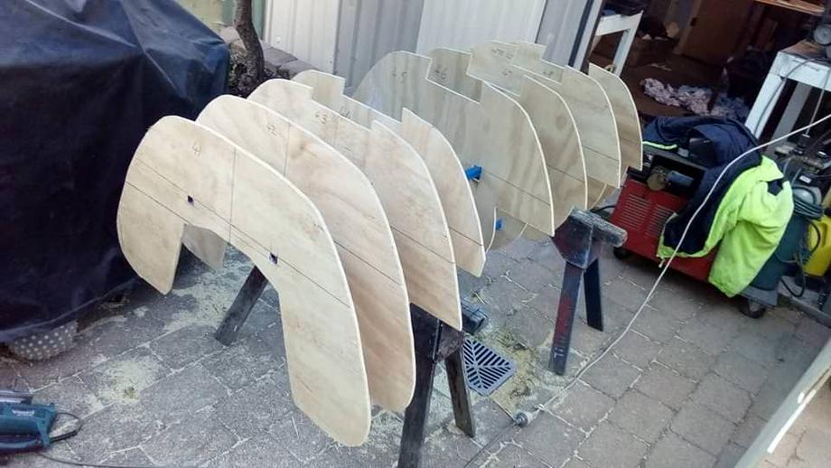

Everything laid out, measured and marked. Ready for my fortnightly big day to get as much done on the Viper as possible. If I get this undercarriage finalised tomorrow, I can move straight onto building the top engine. All the formers bar two, are cut for that. I also have all the steel I need for it's internal support frame. Let's see what the day brings.

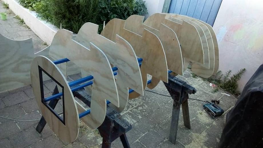

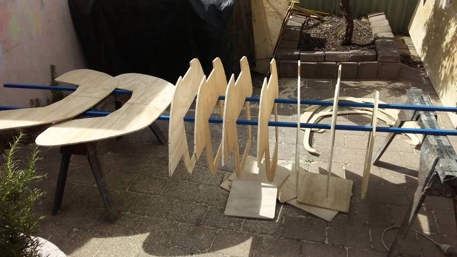

Top engine formers cut and now the internal support frame holes are also marked, ready to cut out and slide over the frame.

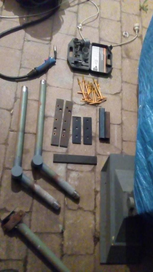

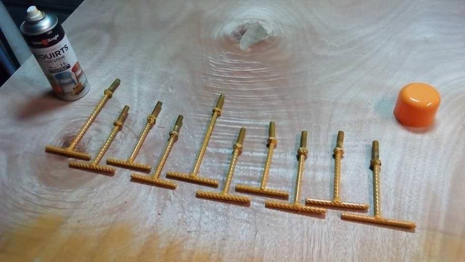

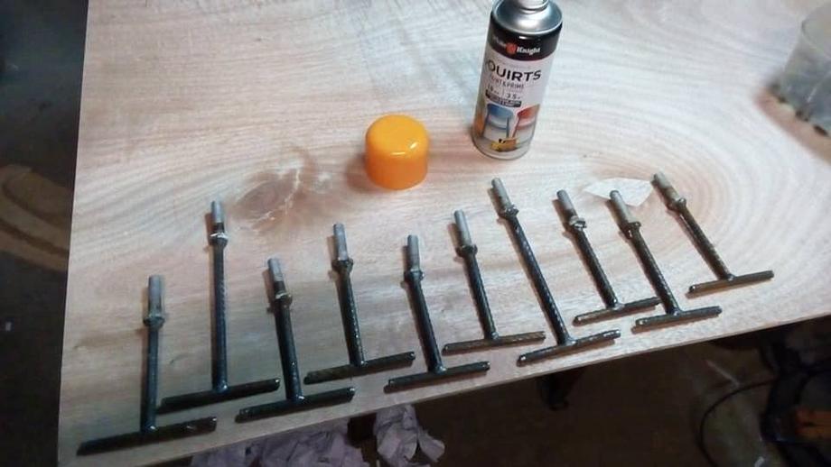

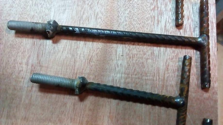

Making all the frame bolts tool-less and high vis. They will be chained inside the frame, hanging next to their fixing position so I never lose or forget to bring them. Some bent ones in there. Easy enough to bend straight tomorrow.

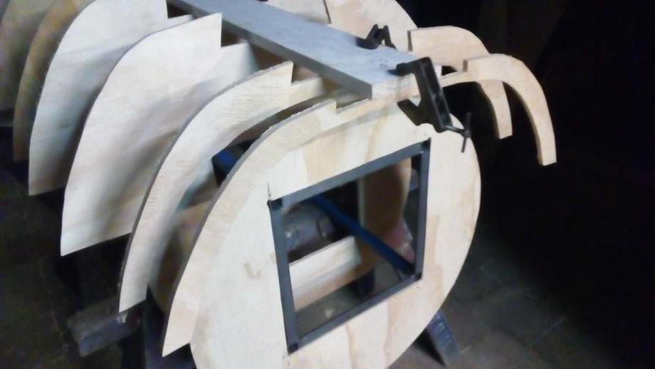

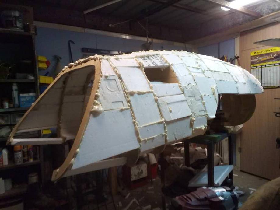

The last of the large modules of the Viper construction is now well underway. After this all I need to build is the wings and cannons, then it's onto all the finishing and detailing.

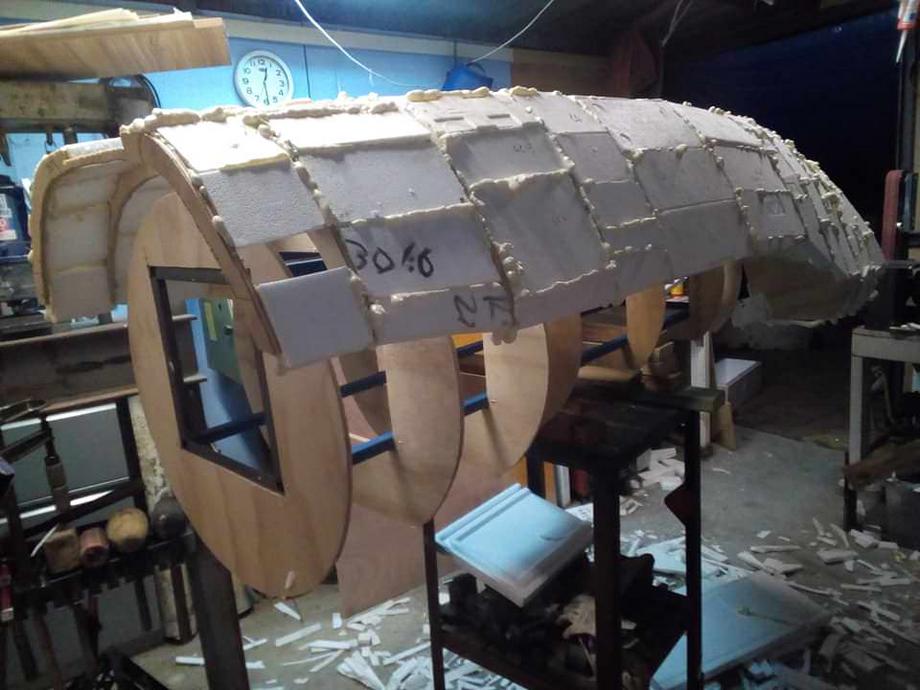

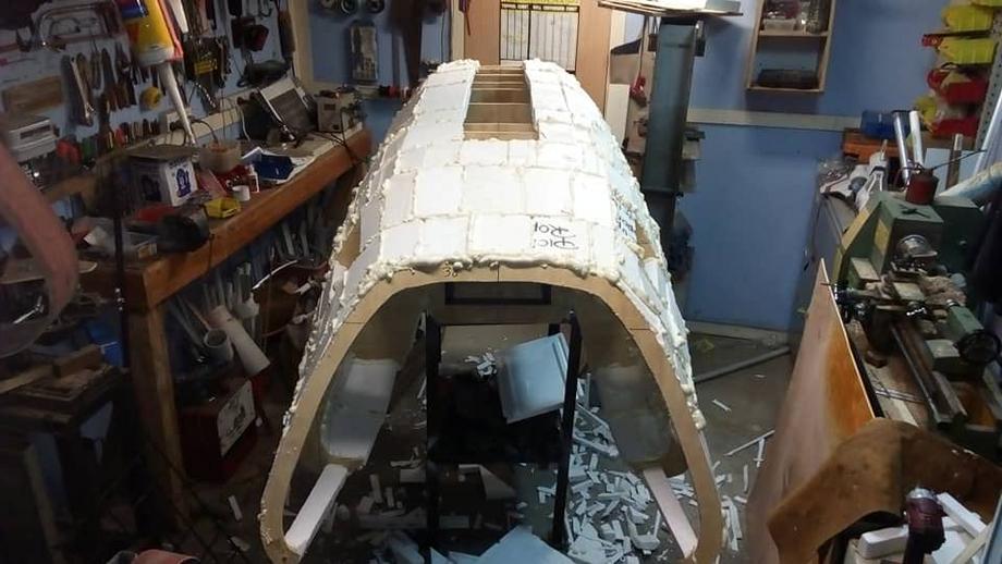

This is the top engine nacelle. I will make this in three parts, I think. The intake, the main body and the exhaust cone. It's a bit of a challenge because of the floating shroud at the rear, but I have worked out a simple solution.
Soooo bloody sick for the last 72 hours. Took me all day yesterday after sleeping in until 2pm , to work out that it was food that was making it worse. Once I worked that out, my belly started thanking me. End result, I couldn't sleep last night. Went into the shed around 9:30pm to enjoy the cool night air. Ended up tinkering, which led on to cutting and gluing polystyrene to the top engine nacelle. In bed by 4am this morning. I went back to work today and spent the day plasma cutting very slowly, feeling pretty ordinary. Not sure if it would be a good idea to go to work tomorrow. I tried to go out again tonight to do some more, but I think I'll just go to bed.
