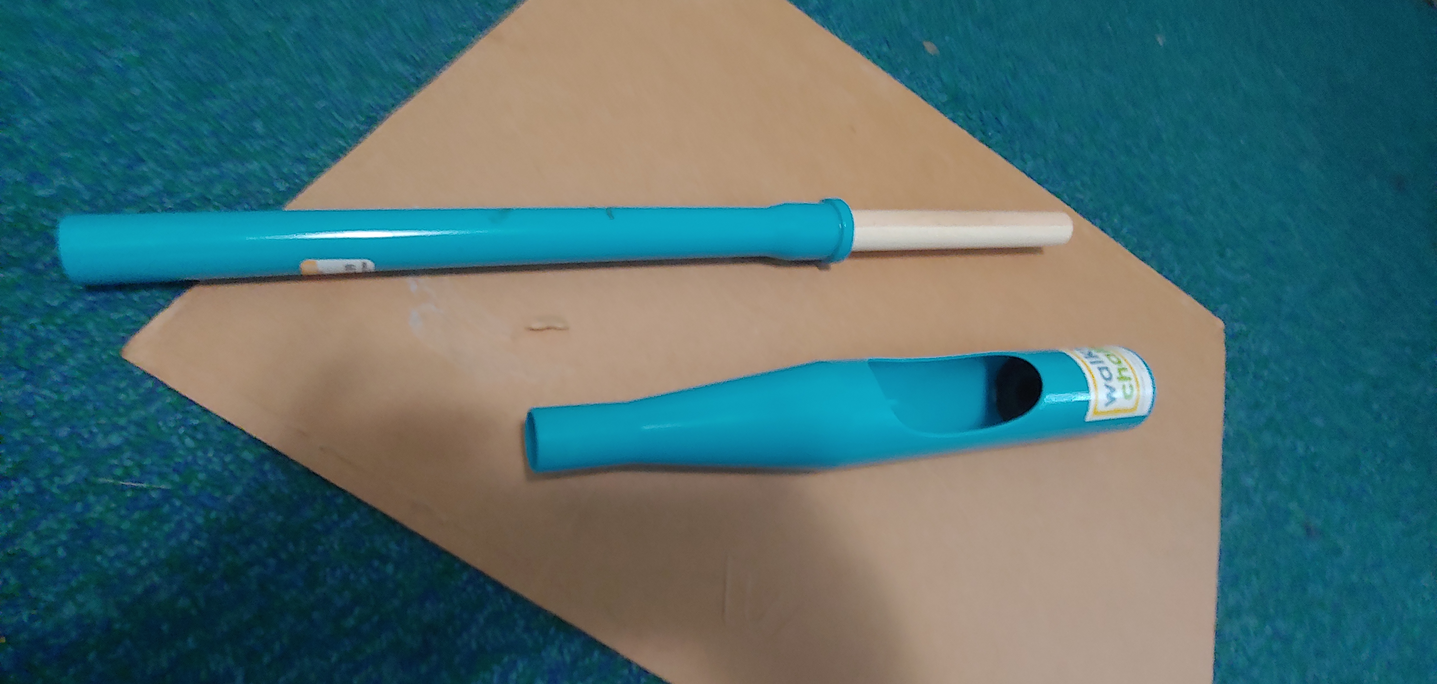

This is my first big build using EVA foam as well as other materials. For this first step, I located this Walkie Chalk stick from my local Goodwill but you can purchase it online as well. What I like best about the Walkie Chalk is that it comes apart in three different pieces and since I am wanting this prop to be travel friendly, it is key that they are able to separate and come back together in a manageable way. Since I only need the first two sections, I am able to keep the last piece as a spare in case something should go wrong.
This thread will cover my journey of building the Crabclaw Keyblade.

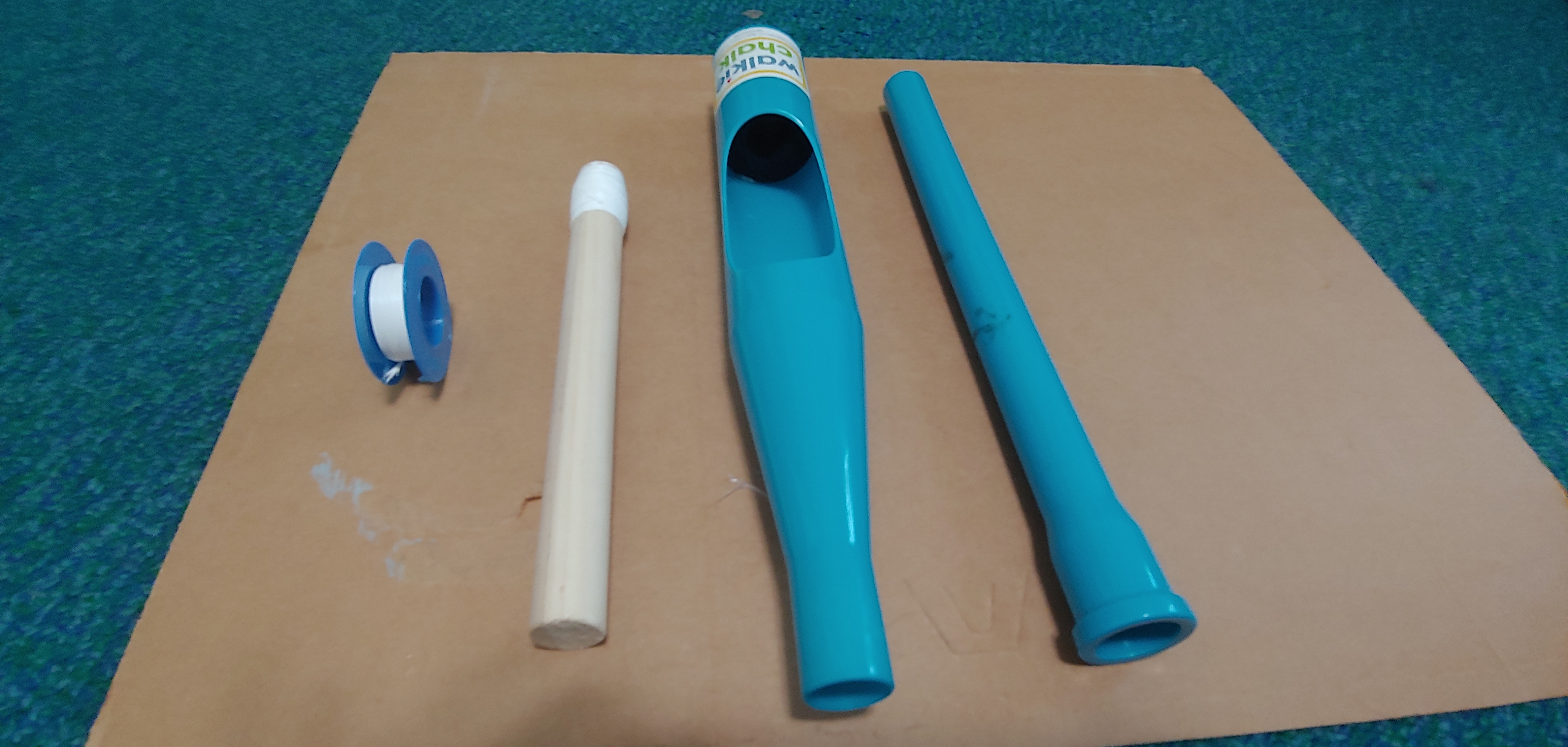

For the skeleton of the Keyblade, I have purchased a wooden dowel which is 7/8x48 but can be shortened to the desired length.
The pvc piping where the dowel will disconnect from was a bit loose, so to remedy that while still leaving it so that it can be disconnected, I used PTFE Thread Seal Tape to give the dowel a bit more thickness.
My next plan is to attach the other end of the dowel to the remaining pvc pipe.
