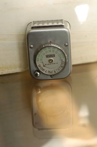

Just got this Eumig Lightmeter.
Need to paint it black first though. But honestly I think it's too small. The real box is a bit bigger, about 1,5 cm I think. Still trying to figure out what part was used for this. I'm almost certain it's some sort of vintage photography equipment. I've contacted Elstree Props in the hope they know something more. So any help/leads will be appreciated.

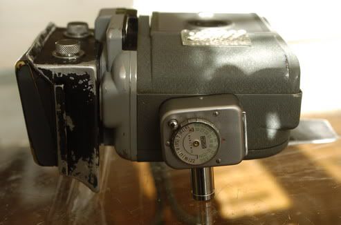

About the lightmeter. I've added some Kalimar parts to it and I think it looks better this way.
I will post pictures when it's painted and stuff.

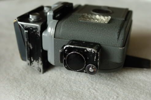

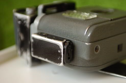

Did some work on the lightmeter. Added some Kalimar parts. Painted and weathered it. As I couldn't decide what looked better I made it possible for the lightmeter to turn around. This way I can do whatever I like :).
Version #1
Version #2

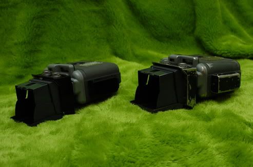

All I need now is one lens. The other one is on it's way. And the lens plate. I hope Russ will start his run soon ;).

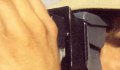

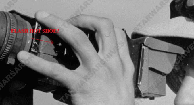

I've been looking at the 'darkside' detail for years, and still can't figure out what it is.
Here's a pic showing what appear to be two silver screws / rivets, and the box is quite slim.
Also, I believe the dial on the opposite side still has a clear plastic cover over it, seen in this shot from the garage scene. If you watch it in slow motion you can see the plastic catching the light for a split second.
EDIT: It was my old mate Killdozer that proved the bar sitting along the centre of the dial is offset, and not actually central.
If you remove the screw which holds the bar it will fall into the correct position while in the dial.

Here's the best pic I have of the mystery greeblie.
I often thought (as Marcus mentioned in an earlier post) that this piece could be the Eumig lens cover, as it has the little protruding lip seen in almar's pic above, where the arrow is pointing.
However, the lens cover is plastic, and from the look of the pics the mystery greeblie has metal (or at least a bright highlight) along its edge.

About your picture, seeing the red dot makes me even more convinced that this is a flash. This red dot is probably the little light that lights up when your flash is ready to fire.
