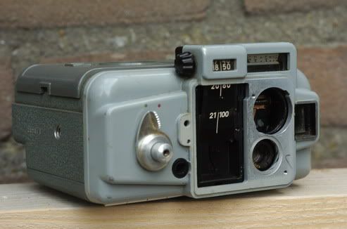

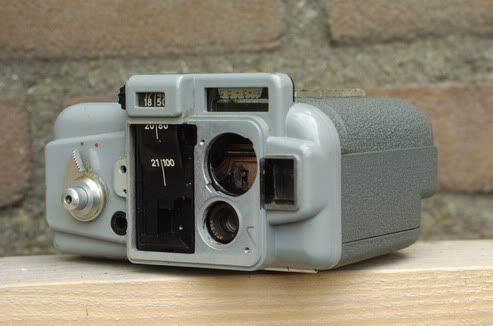

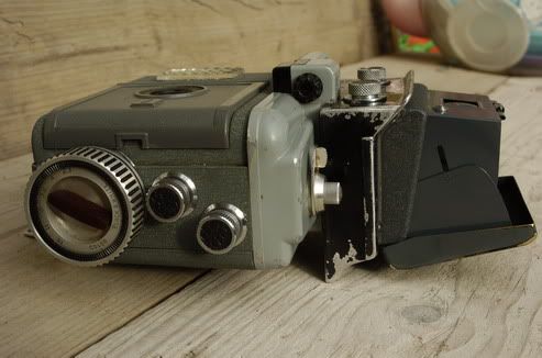

Thanks to Clutch's little tutorial this Eumig has now been stripped and ready for it's parts. Still need the parts though.

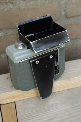

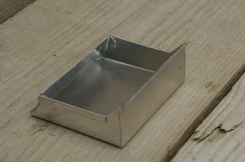

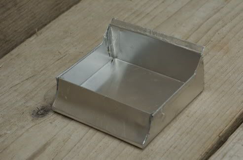

I used Killdozer's tutorial to make the box. All it needs is some sanding and a paintjob.

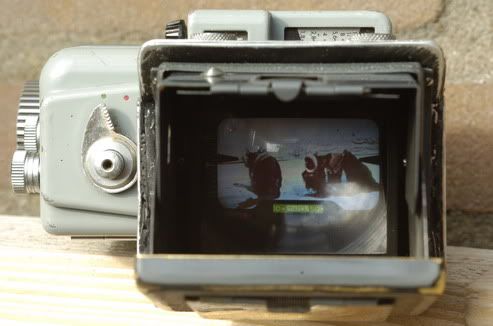

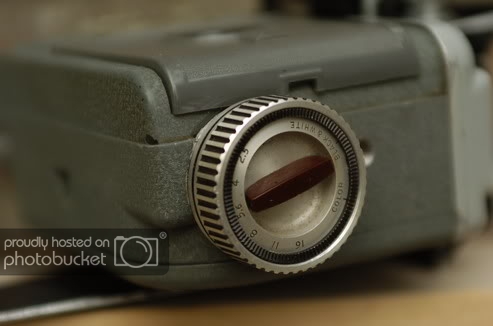

Got the Seagull camera this week. Started stripping the camera for parts. Unfortunately the little transparent plastic cover from the focusing knob broke so if anyone has a spare one (does the one from the Kalimar fit?) please let me know.
The Bell & Howell two twenty should be arriving soon so I can place the dial in the focusing knob.

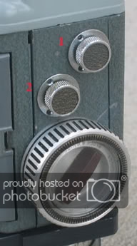

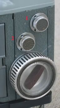

When were the two knobs on the black box figured out? I was always of the impression they were 660 knobs.

You might be right Gary. I think I might have misread Chris' post. I think these (or at least one of them) belongs next to the large Seagull knob on the side of the camera.
@ Macklin, why touch it up? It SHOULD look kinda busted up I think. Gives it character.

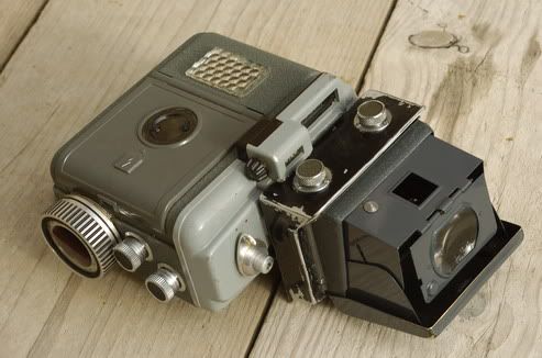

Whoa, just tried to remove the little knobs from the box. This is impossible. I drilled two holes and glued the knobs in it using 2-comp. epoxy glue. I can't remove them without seriously damaging the box. Think I'll have to leave it like this.

No, I mean 1 of the 4 small knobs is possibly from the Seagull (in addition to the big dial). I don't think they're all identical.
There are 2 macro props (stunt and hero) each has 4 small knobs (8 total).
The Seagull knobs are taller than the Kalimar ones so they stick out further.
The lower (closer to the viewer) small knob next to the large dial sticks out further on both props - I believe those are the 2 Seagull knobs.
I'm 100% positive on the stunt, but I'm not sure if the stunt uses both small Seagull knobs or just one.
There is still at least one more unidentified still camera used (and one movie camera) for the two props.
The 2 Kalimar 660's yield 4 small knobs, the Seagull another 2, and 2 more had to come from another camera.
Could someone please tell me which knob Chris means. Number 1 or 2, or both? I personally think number 1.
I managed to remove the two Seagull knobs I put on the box without damaging it.
Monday I'll be picking up a Kalimar camera so that means a viewfinder and 2 knobs. No lens though :cry.

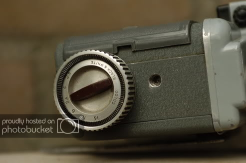

Oh, today I received the B&H camera so the macro is now upgraded with the dial.

Correct. Knob #1 is likely a Seagull. I'm not positive though. It seems to stick out further (than #2) and the knob in that exact same position on the Stunt Macros is a Seagull one for sure.

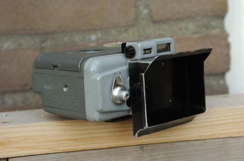

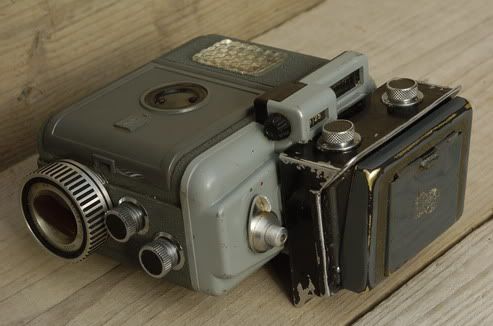

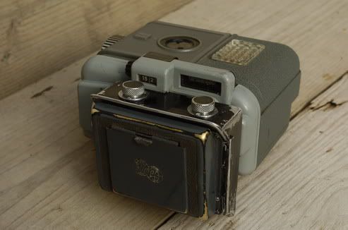

Just a little update. All I need now are the 2 Kalimar lenses and the lens plate. But I think Russ will start a little run of these soon :rolleyes.
Re: Luke Macrobinocluars help wanted
Looking good! Don't forget to paint the plate with the Kalimar logo black. :)
