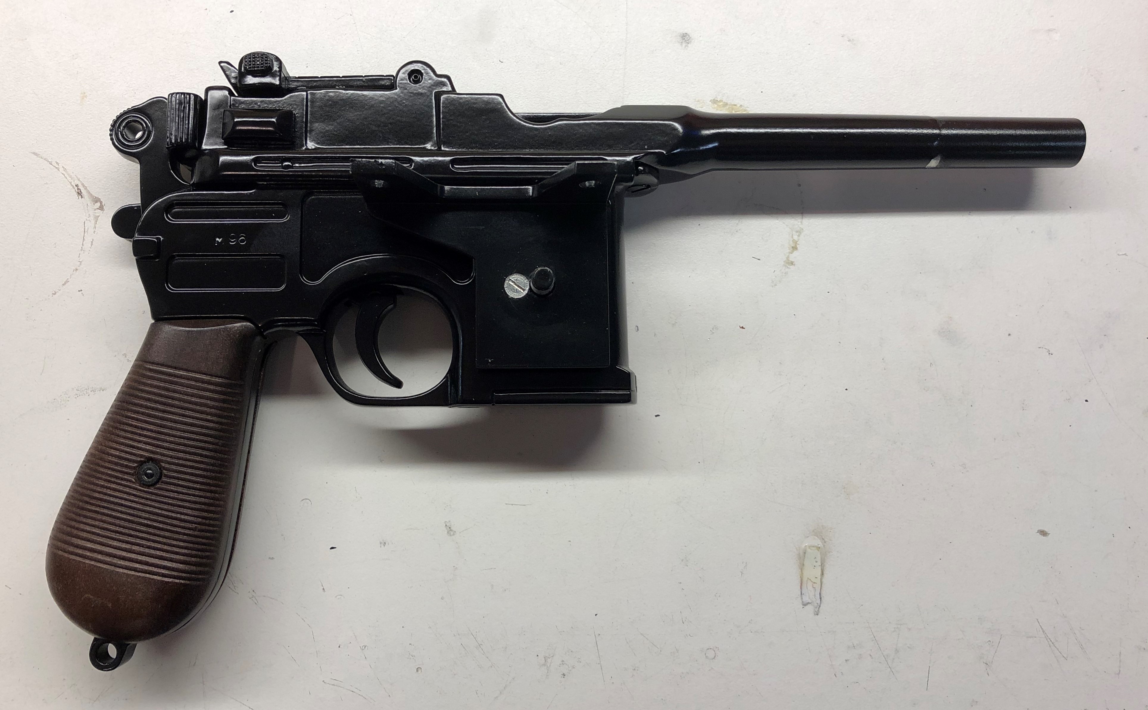

So at this point, I've taken apart the Mauser, wiped down all the parts, removed 1/2" off the end of the barrel and removed most of the pin at the back of the bolt. I used a belt sanded to remove a little material from the rear of the trigger stay; just enough to allow the hammer to hit the back of the bolt.

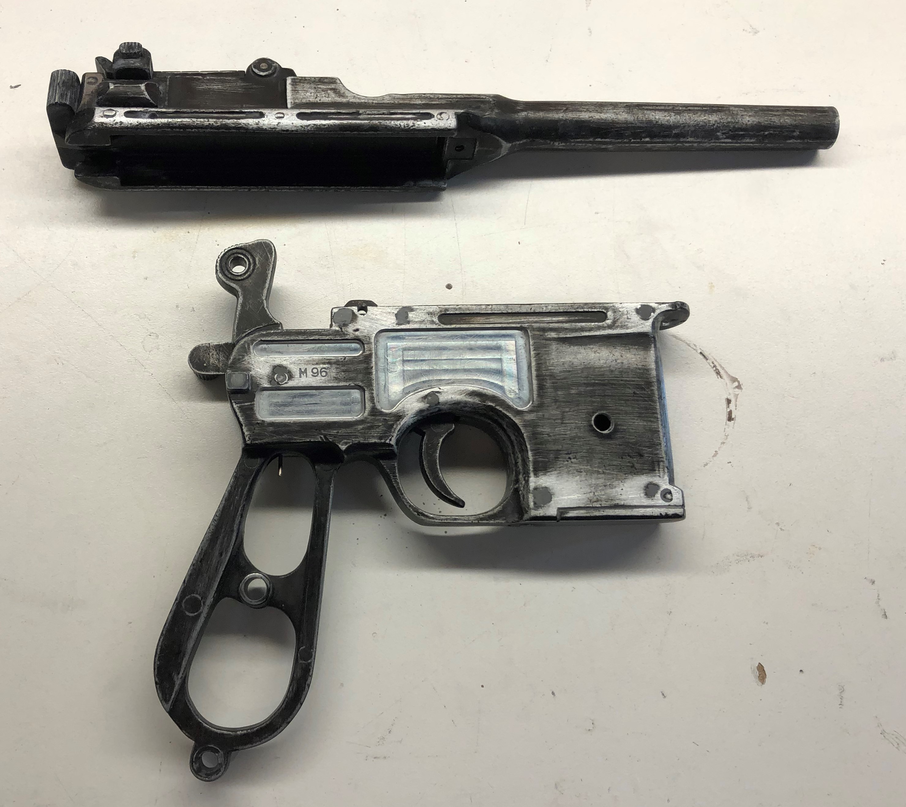

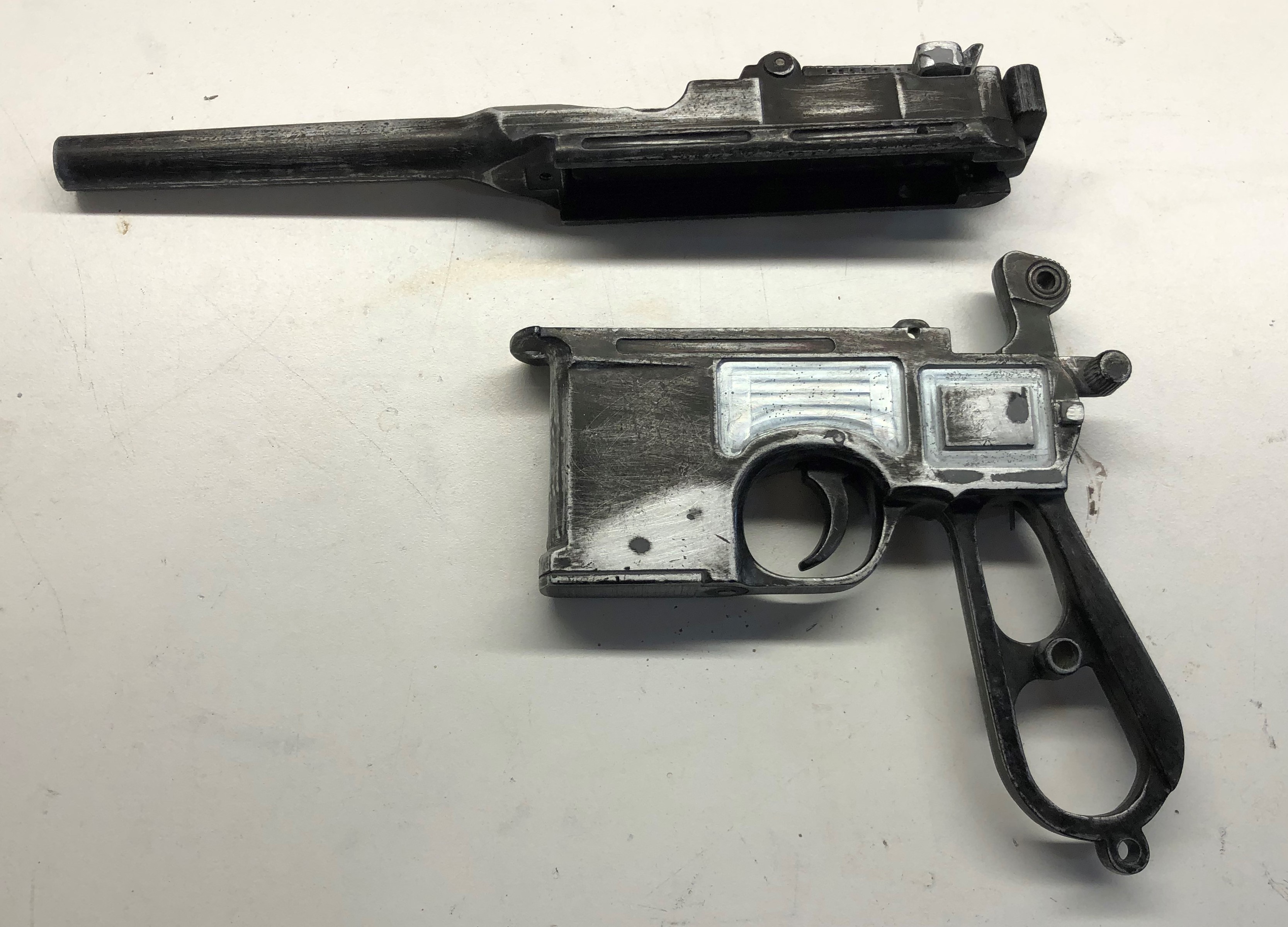

Then I sanded down the three main, metal parts and let them sit in soapy water over night.
I cleaned the parts with de-natured alcohol and then filled in the holes/Denix lettering with JBWeld. I've also glued down the site with JBWeld.

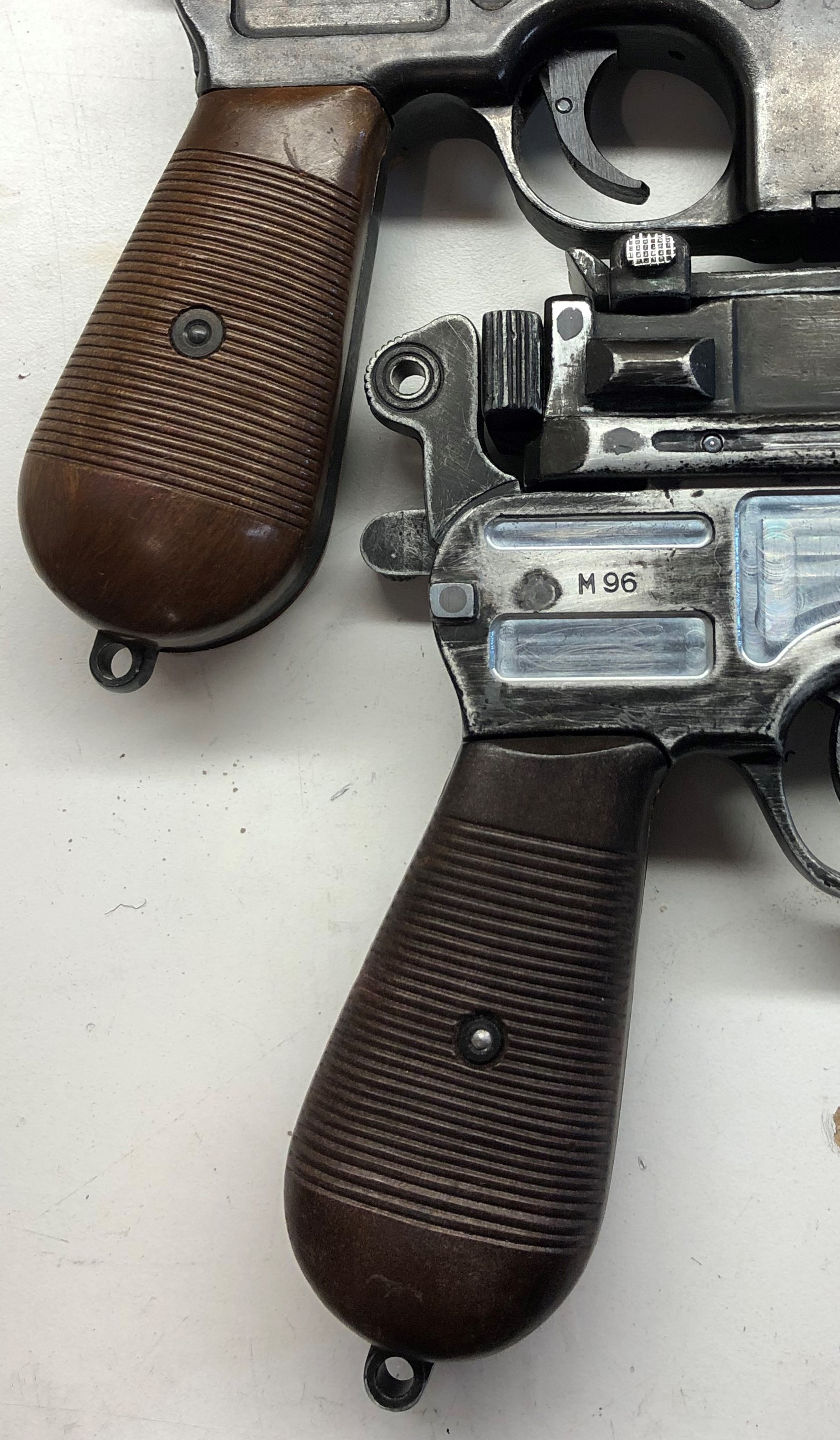

Here's a side by side with a MGC Mauser:
Another tid bit I discovered was the lanyard ring hole. The Denix is too large, so I used a belt sander to make it smaller.
Here's another side by side with a MGC:

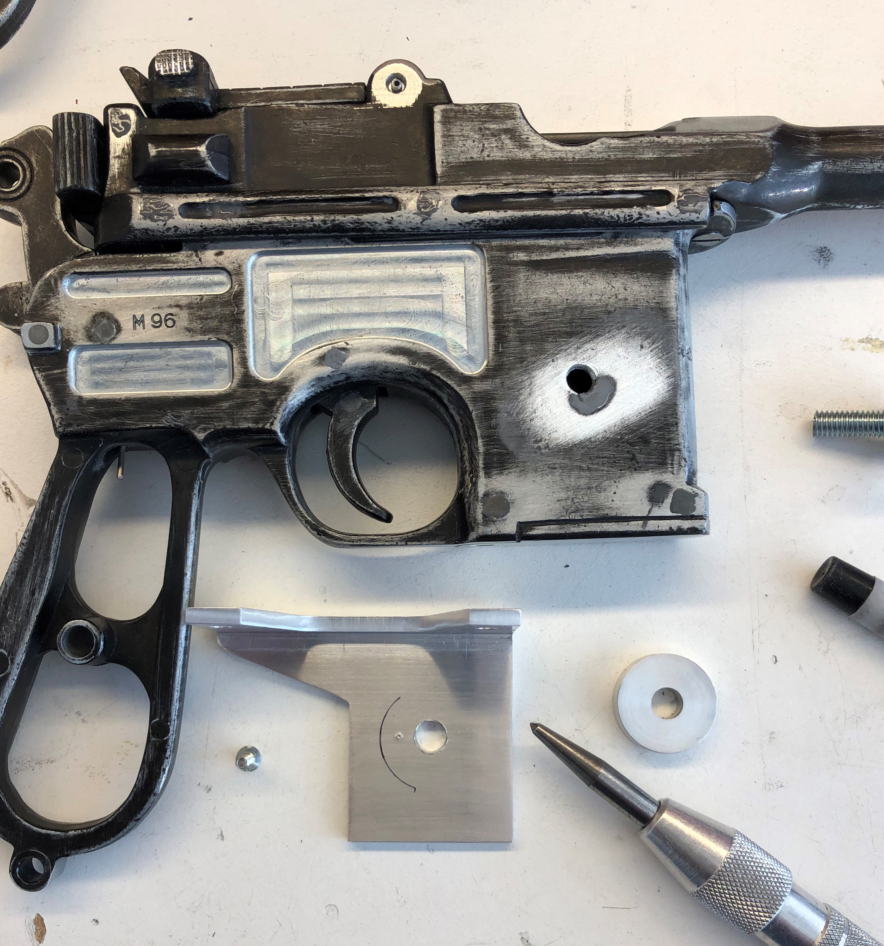

And now on to the magazine plate. I've marked the area. This time, I'm going to try to machine around it.
I used the smallest end mill I had (1/8") to machine the area and then used some small, rectangular files:
I removed a little too much material from the left side, so I just added a little JBWeld and sanded that down.

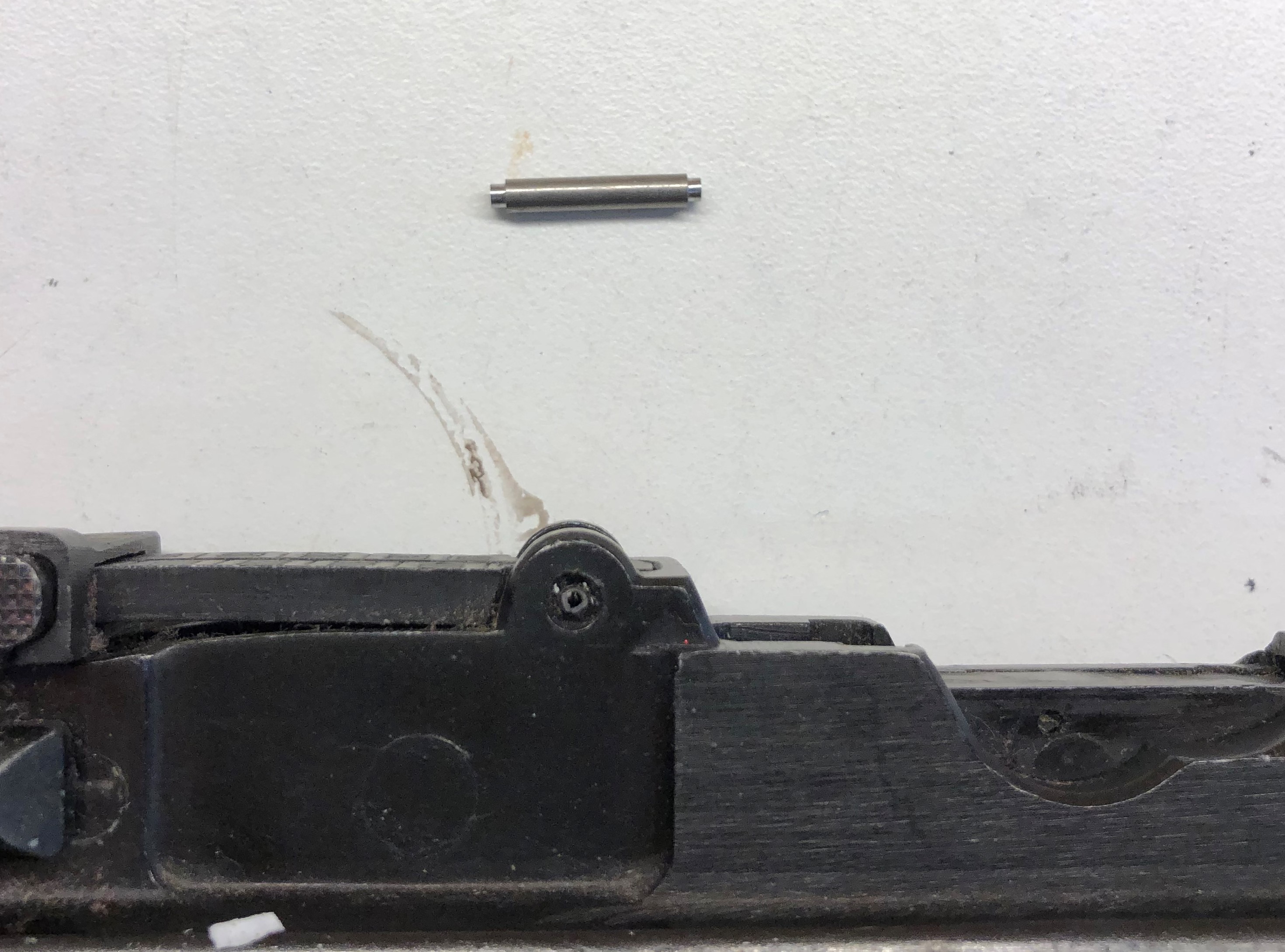

The upper received is done. Now on the small details on the sides of the sight hinge:
I start by using a sharp punch to make an indentation at the center of the brad:
Drill a very small hole (3/32") using a jewelers bit on both ends of the brad. Once completed, punch out the brad and then use a small counter sink on the sight hinge holes:
Then take the brad and machine both ends slightly, so they are the same diameter as the rolled pin in the MGC:
Because the holes and the brad from the Denix are larger than the ones on the MGC, it's easier to simply machine the brad. It is possible to fill in the holes with JBWeld and drill a smaller hole, but trying to tap in a rolled pin may not work, so this seems to be the best option.
The brad goes back and its done:

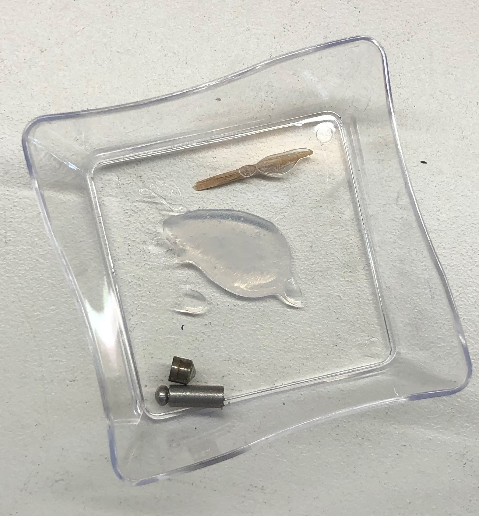

I've cleaned it inside and out with denatured alcohol. I decided to add one of FieldMarshall's clear resin light port bulbs:
The plastic light bulb or port is too large for the scope, so I just machine it down a bit in my lathe. The trick with plastic is just to use a good amount of water to keep the part from melting:
I use a 1/4" drill bit to modify the brass light port to get a good fit.
And viola, it fits like a charm:

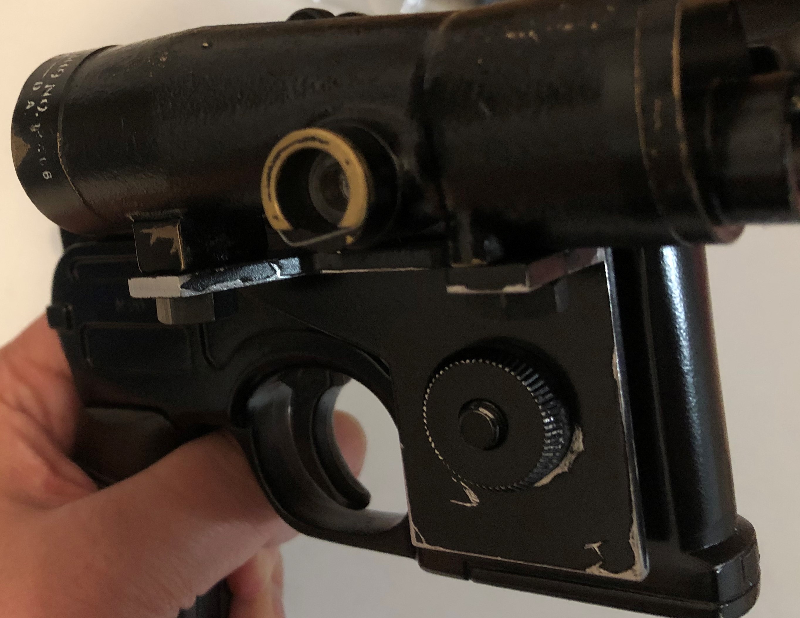

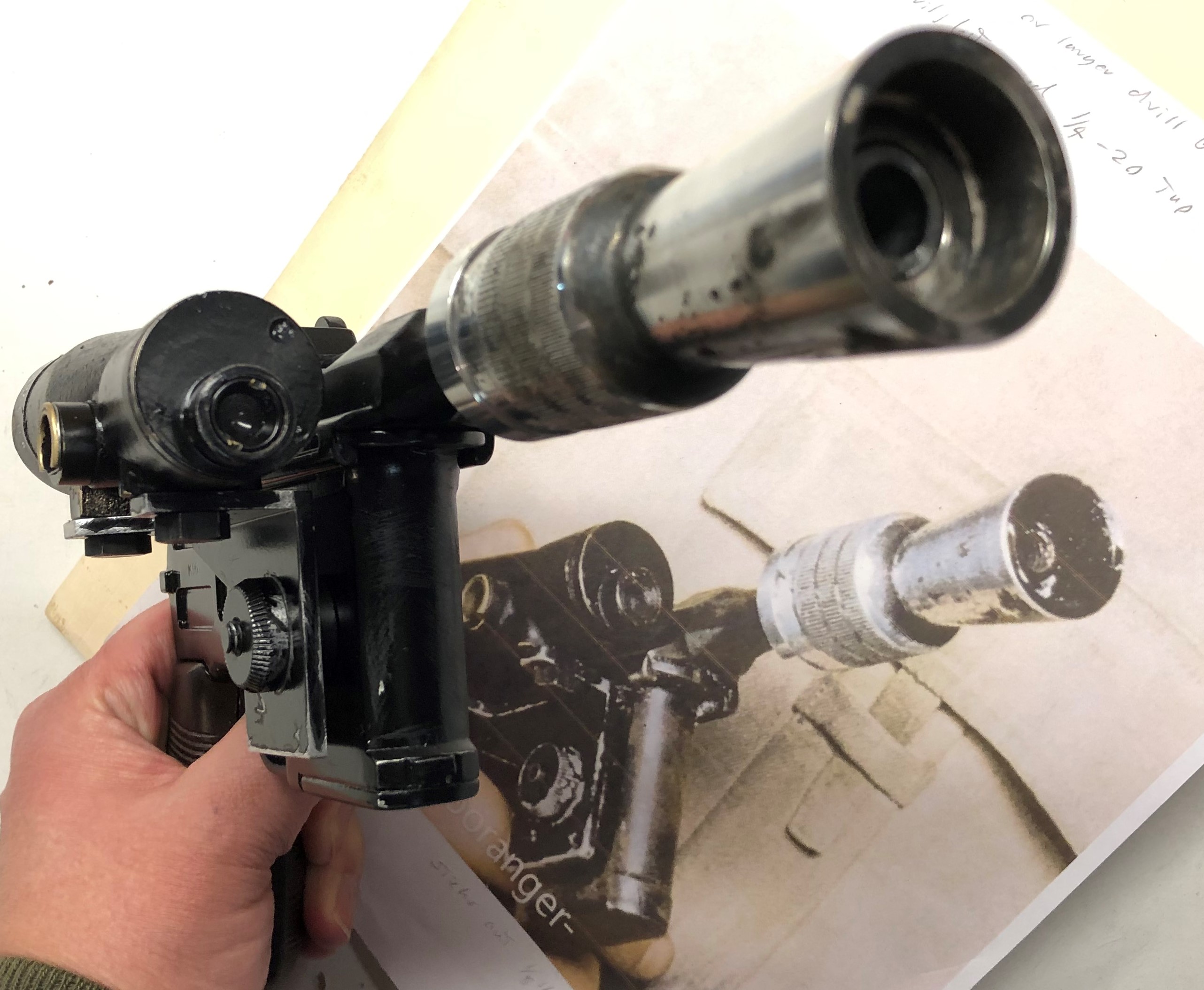

So one thing I noticed, looking at a recent photo of the Luke Bespin Blaster is that the back of the scope or scope "foot" is that it doesn't line up with the edge of the mount. It's about 1/16" away from it.
So I widened the upper holes in the mount by 1/16" to get the scope placed back 1/16" from where it was.
Here's an example photo of the placement before the change:
And after:
It's a very subtle difference and since the holes were simply widened, the scope can always be moved forward if necessary.

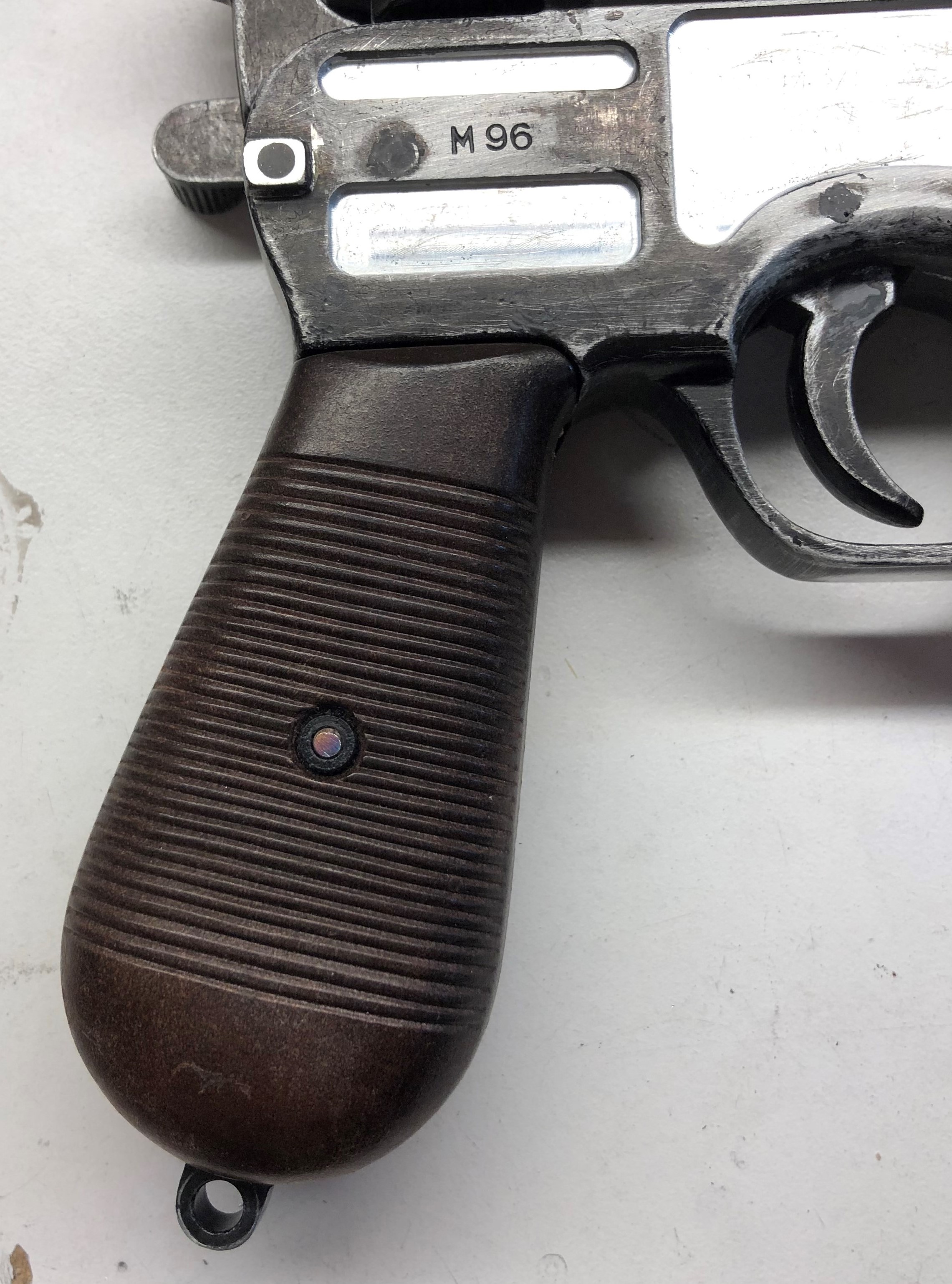

I'm using some actual grip hardware (stainless steel) which can't be blackened with aluminum black so I simply painted it flat and the satin black:
To get the hardware to fit, I use a 7/32" drill bit to expand the holes in the Denix grips. I place a thick spacer (Han Hoth blaster) under each grip to avoid damaging the grips:
To keep the little parts centered, I use a different bolt to hold them in place and then tap with a hammer. I also use a wide punch to slowly tap them in place.
I use the MGC as a reference to make sure the parts go on the correct grips. It's easy at this point to get the parts mix matched. We want to make sure we don't put ROTJ blaster grips on an ESB blaster. :p
Up next, detailing the grip hardware and installing the flash hider.
Like every thing else, it's always a good idea to "test fit" everything before applying those final coats of paint.
In this case, the grip bolt was too long, so I had to chop it down a bit. One difference I noticed between my bolt and the MGC bolt is that it is rounded off and mine is flat:
So using a belt sander, I rounded off the end of my bolt and bingo:
It's a similar look to the magazine pin. For whatever reason, those MGC engineers seemed to like rounded off bolts. :)
However, the other side of the bolt needed to be completely flat and the original Mauser grip bolt had a rounded edge, so I machined it down a bit:

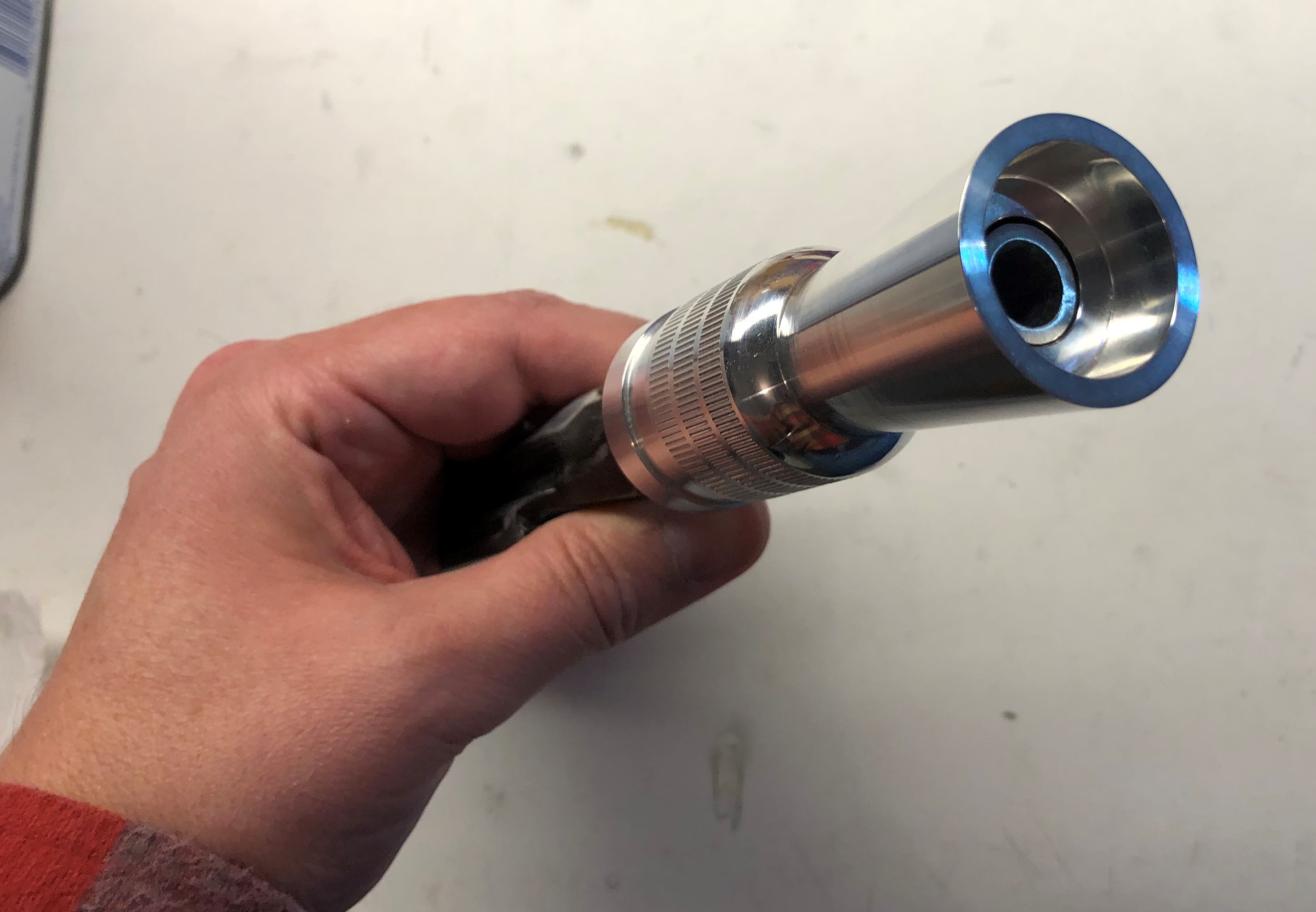

For the flash hider, I used Aluminum Black and plenty of cotton swab sticks:
The odor from the liquid is extremely strong, so I used a full filter mask while applying the Aluminum black:
I used every view of the muzzle I had at my disposal going through about 5 applications:
There were a couple of areas that didn't need blackening, so I used 400 grit sand paper to remove tiny sections:
The drawback to using the sandpaper is that it does leave some scratches, so to lessen that, I used 1200 grit to lighten these up a bit. I let the muzzle dry for several hours before using a lint free cloth to polish it and clean the entire blaster in case there is any residue left over from the sanding:
