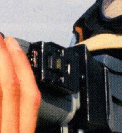

Looking at this image is really giving me a headache as to where how the transition box is fitted. It would appear it overhangs a bit?
I also think the wedge has a rectangular element to it and the triangular bit is not quite so acute. Imagine the tip cut off the current wedge - that look.
I don't understand what's giving you a headache about the image. Yeah, the TBox overhangs, a little, on the side.
On this picture you can see the overhang clearly
However, I think if its offset in this way it leaves a gap on the other side like so
Which is why I don't think the 'new' mystery bit is triangular in shape, if people have covered the gap, (and this is the same if the top of the Kalimar body is used) it would be in the wrong position.
Whatever is on the side certainly flares but I don't this the shape that's out there is correct - just my thoughts.

Yes it overhangs, yes there is a gap and yes the tringle box covers it.
and its definetly triangle and open on the front side.

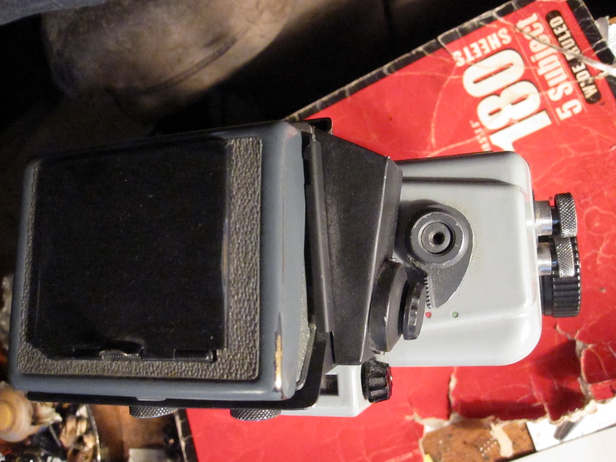

This is how i went with mine. Its slid up a tad in this pic though since it just sits over a flat piece of aluminum and is held with pressure from the trans box.and my transistion box curve section needs to be longer. Something i plan to remake.
Ya that's how I built mine, its not a perfect triangle, its flat on the small end, it may even by slanted on the small end which is what ill do when I remake my trans box. Im going to change mine in a few ways, hard to describe what I want to change though. I want the side the eumig knob is attached to to be recessed a tad.
I didnt take any pictures of that. There is a piece of aluminum glued or screwed ( i dont remember now) to the side of the trans box and the triangle sits on it. The aluminum part is the same size as the inside of the triangle. When the trans box is tightened down to the eumig face it pinches the lower triangle lip between the aluminum piece and the ledge that you were asking about. The ledge that shows because the trans box is offset. I was going to glue it in but the pressure was enough to keep it there.
