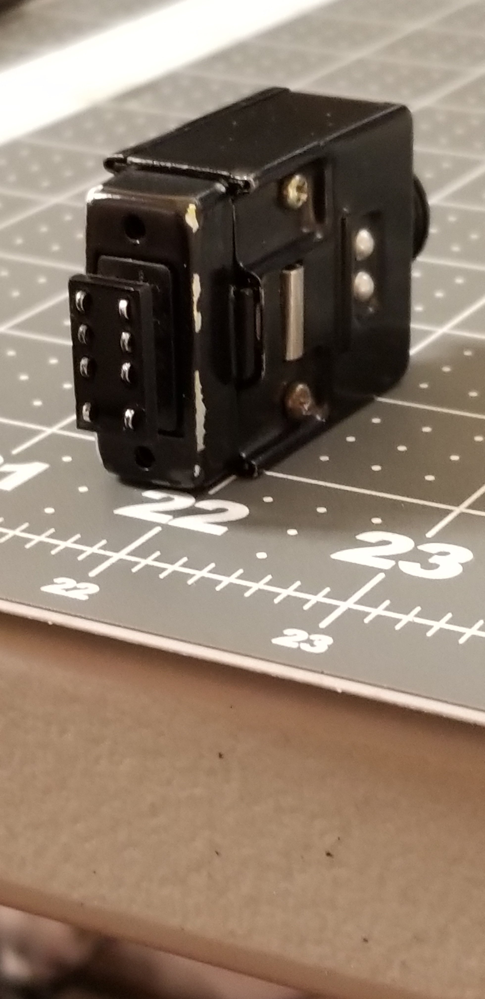

I mounted my mystery box setup using two M2.5mmx0.45mm machine screws. These were the closest I could find to the connector's stock faceplate screws. None of the big-box stores had anything close (as expected) but Ace had some of these in their "miniscrews" drawer. I almost missed them. They didn't have any locking nuts in that size, so I just used two nuts tightened against each other. The screws threaded into the plug surprisingly well, making a solid connection. This thing isn't going anywhere, and if I do ever get my hands on the accurate green-tab faceplate, it's an easy swap/re-mount:

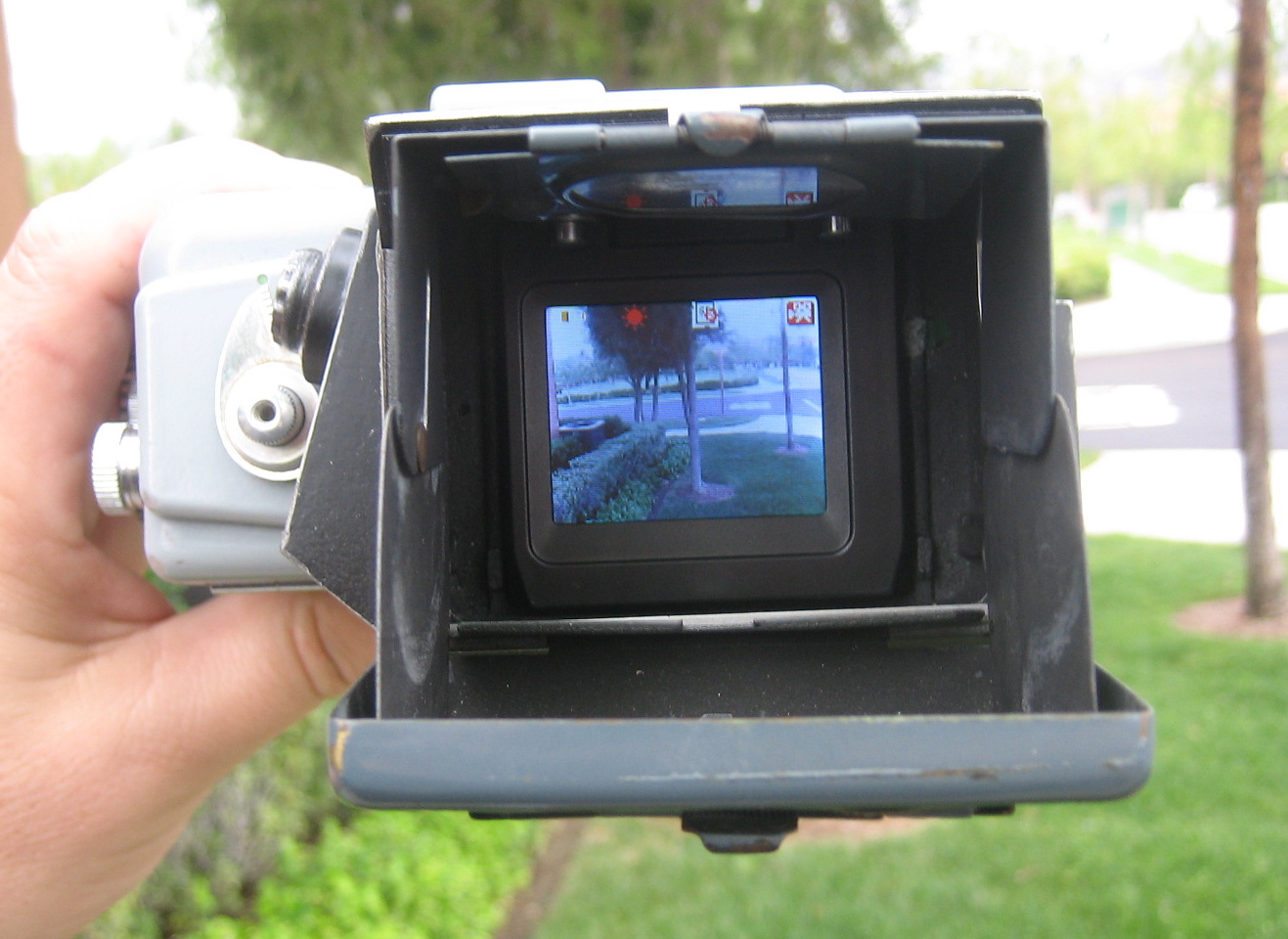

It´s a small car dashboard camera he´s modifying.
He got it all figured out to work with his own mystery box, but has to find a way to make it function with the EIAJ plug now :/

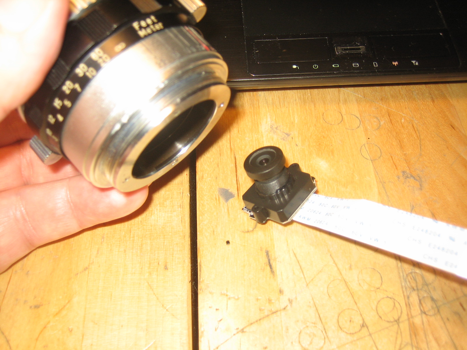

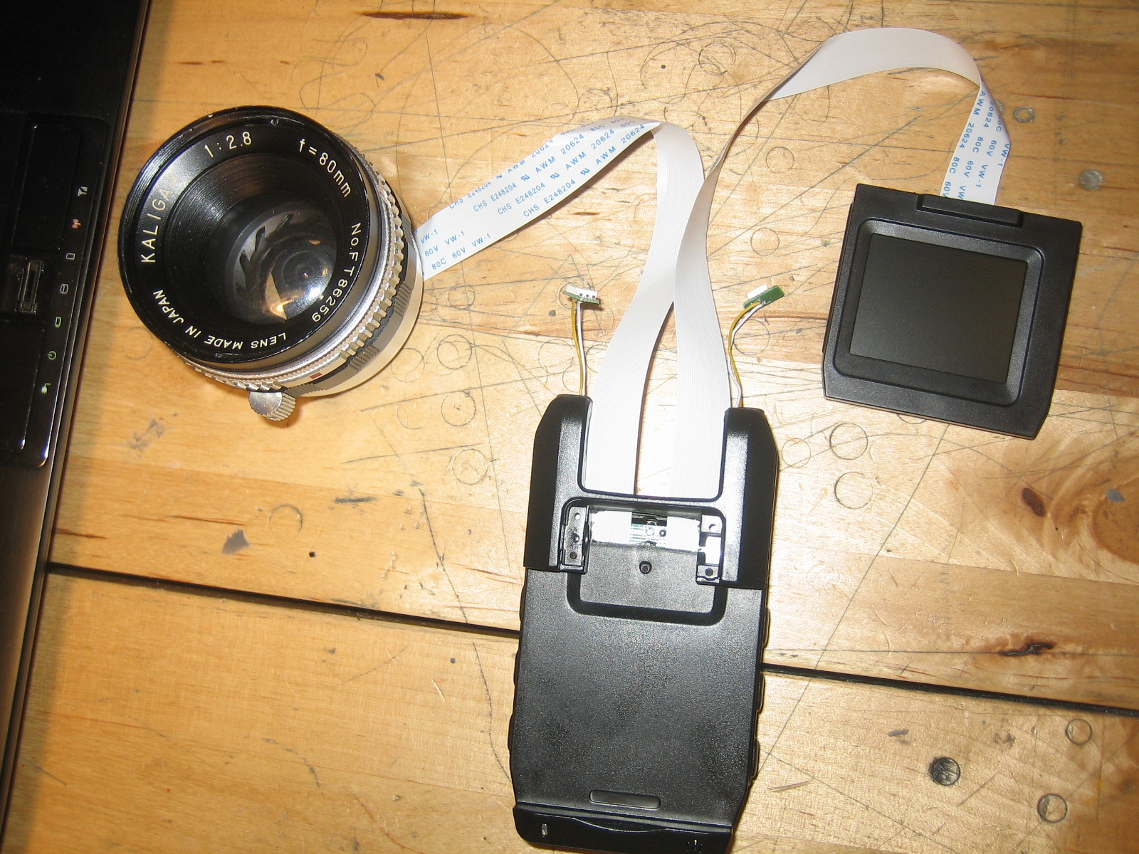

Ive used dash cams on all my earlier builds and commissions. The one I used is no longer made and its been a challenge finding a new one that allows for moving the camera sensor into the Kaligar lens housing. Im working with a member here on a project to use a Raspberry PI with custom software. We are in the beginning phase but it will be killer when we are finished. Imagine a touch screen that can the show camera view and multimedia on a screen located in the lens hood. I will be loading some SW clips and sounds as well. Old style-
ive done a few builds with the dash cams, you can see some on my youtube, gluejunky
the camera ive used is the f900 dvr
you need a camera that has a moving lens and screen, this is so you can add a longer system strap/cord to extend the leangth.
this new version of the build im doing for marcus, im not able to use my resin mystery box that i modify so i can used it as a 3 position rocker switch. the new one im using is a 5 way micro toggle switch that will be hidden int the tube on the newly found connector. im going to solder everything up tonight, last night i maped out the wires and did a quick test. the buttons use a common ground which is very useful :D
I know you need a moving camera and lens and the model show in my pic is exactly that. Thats what is used on my builds going back to 2011. I'll check out the F900.

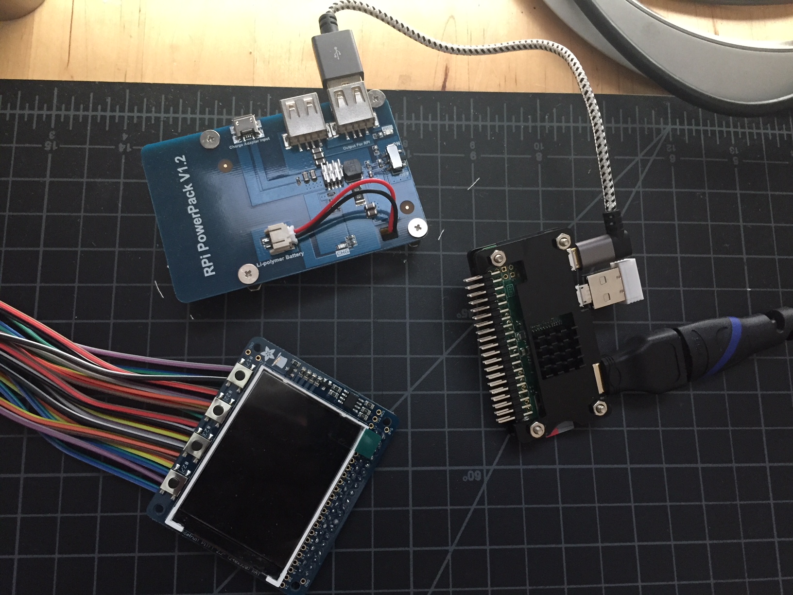

I m trying to do it with the little pi zero. It’s my first pi project, so I may go back to an arduino, but interested to see thes other options as well!
