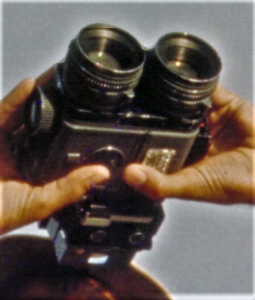

I too would love a larger version, Jerry. Somebody posted this image on this thread right before all the mystery box hype, but right after I decided to use the black band version of the seagull knob on my build (I hadn't seen this image before then). It's pretty undeniable that that is the knurled metal vetsion of the Seagull knob, but I always aim to make my props as close to possible as to what can be seen on screen, and in all the visible screengrabs from ANH, it seems to be the other version (at least from what I can see). I'm sure there were either two versions of the hero macros, or that the knobs were switched out at some point. Thanks for posting this one, Jerry! I know I'm in the minority here with the black band knob ...
You’re not the only one because I too was able to procure the silver knob with black band. Then this photo posted and I was on the fence about which knob to use.

It looks to me like the prop department simply painted the striped knob black, I don’t see the black band version in Jerry’s pic. Is it just me?
That's what I'm saying, it's obviously the knurled version in the photo Jerry posted above. What I'm saying though, is that from every high-res screengrab I've taken from ANH where the macros are visible, the only ones where you're able to actually see this knob in any kind of detail, it seems to me to be the black band version. Here's a screengrab I took from when you can see it best:

Again, I'll credit scottjua with this discovery, but I believe even he has changed his seagull knob back to the knurled version after seeing the photo Jerry posted.

I have been playing with this image to bring out the details. I can see the nut on the screw on the bottom of the connector.
any one else see this ?
I can email any one a larger image of this .....
also you guys who believe in the rubber band version of the seagull knob, take a gander :)
can you email me the larger version? That's cleaner than the one I have, I might be able to get a little bit more out of it.
Tim ... check the photo above and tell me what you think!
same... I've been wondering if that since they were just glued on, if a replacement was needed and BOTH were used...??

I'd say that given what we know about parts on sabers/blasters changing due to being tossed about/the general wear and tear of production, that this is VERY likely. Hence, why I'm leaving the black band version on my macros! Until we have better reference FROM THE FILM showing the knurled version, I'll keep it that way. There is no doubt in my mind that the knurled knob was used, though. Jerry's photo is a photo from set, and definitely not the stunts so it must be true.
I've never seen that black and white photo before, thanks Scott. Seems to be the same knob that they used in that scene, whatever it was.

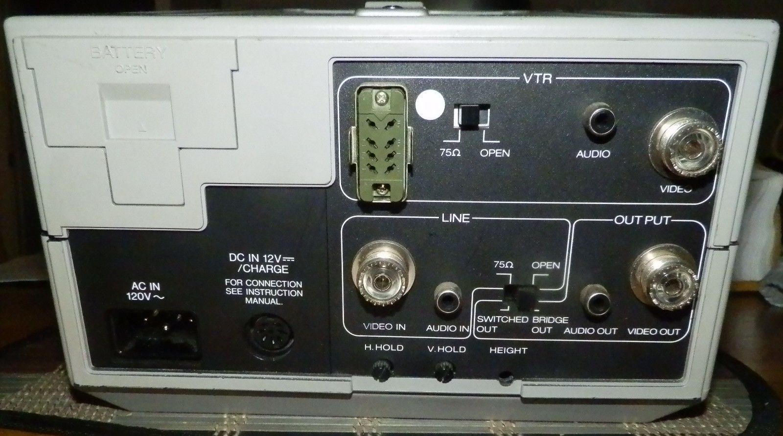

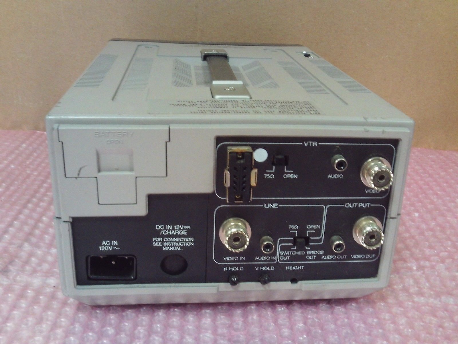

so has any one had any luck finding the female ends for reasonable price? I have found a component that I can get them around $50 shipped ? but that depends on your shipping costs
No luck for anything under that price.
well I don't think this is the worst option, but maybe the best yet if some one is looking for just the female parts?I followed the u-matic rout to see where it go for the components, I came across the jvc line. like sony they made some small tv monitors, just less money.ive been able to get a couple for around $40-$50 shipped.j
vc tm22u
jvc tm41eg
there are plenty of these out there. better deals could be made depending on your location. ive seen adds on CL in vanc. bc for 12 of them for $150.
it would be great if some one in that area could get them and offer them to the group.....just a thought
be carefull there are two different female metal casings being used on these, one is square while others are the more "correct" rounded corner version
wrong version
correct version

I'm in Vancouver, so I'd be happy to help here if I can. I can send a note to the person on CL and see if they are still available and if so, and if there is actual interest from people here, I could go pick them up!
vc tm22u
jvc tm41eg
wrong version
correct version
man that would be awsome ! im sure others would like these since POSW sold a bunch of connectors. be sure to chack how many actually have the correct female end.
OK, I spoke with the person and have organized to go check them out on Wednesday evening. If they have the correct part, I'll pick them up and then see about taking them all apart!
This is awesome, guys! Great teamwork. If this goes through, as long as everybody else who wants one gets one, I'd be in for one, as I'd like to compare it to the Ibanez piece.
I'm down for 1. I also volunteer to cast em up for folks at cost if i get one.
