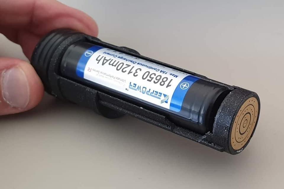

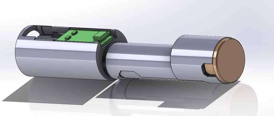

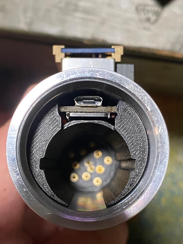

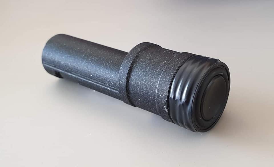

There was a guy on Facebook who made cartridge system chassis that allows for a removable battery setup. Here are some photos of his chassis. The designer of this chassis sells the STL files for €25 ($25 as of this time of writing).
Photos are from Facebook (not mine).

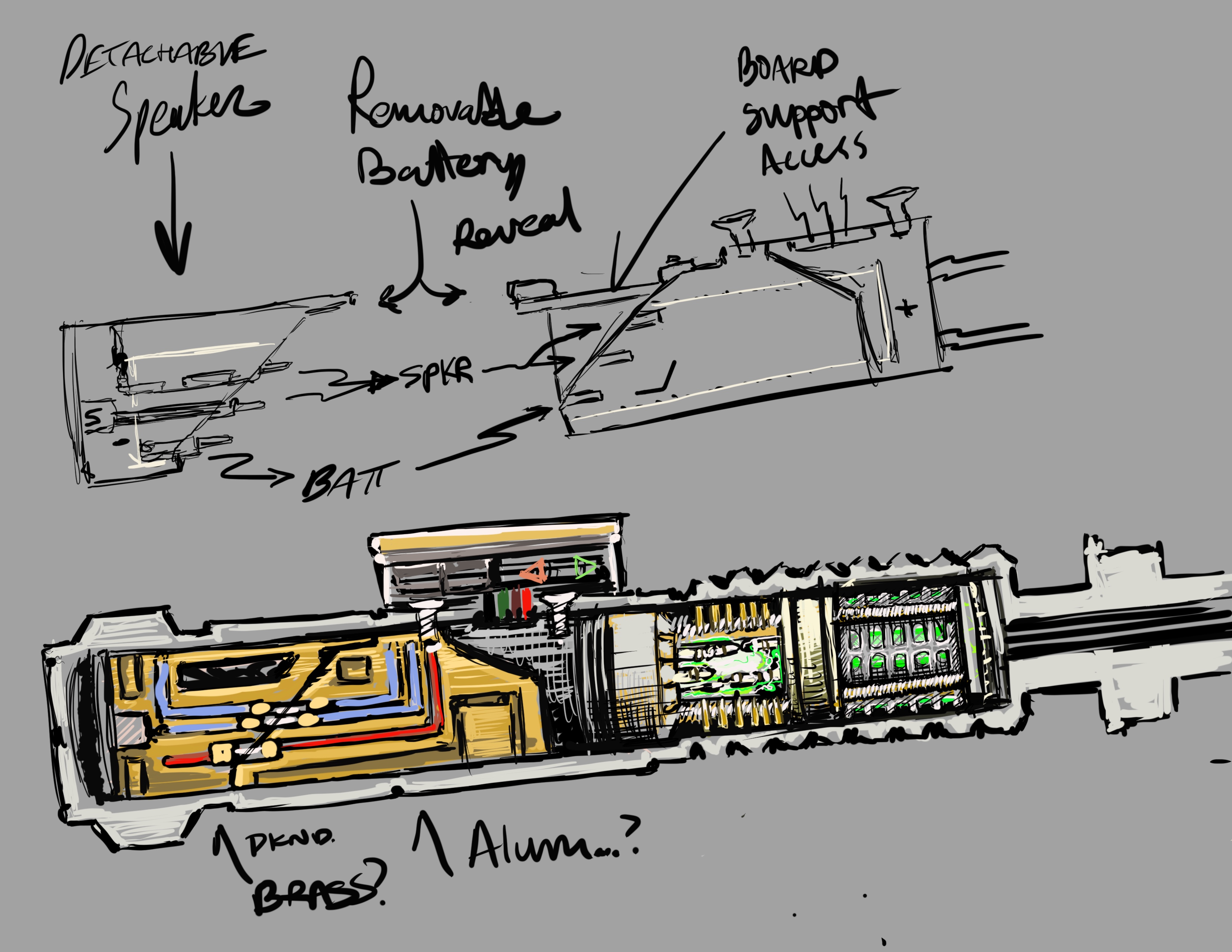

Thanks for posting this:
I do hope that with everything going on. Adam and I can still get to realizing my very original concept (seen below) Oct.2019
The chamber was worked through and (mostly) delivered … (with more to be made soon as I am told)
But in terms of the functional *idea*… yes that is exactly what I imagined for this hilt. A bit more 3D printed gold and detail maybe but… that captures the practical spirit of it.
The board and the control box are tied together, functioning kill key inside the control box to make the reveal board truly interactive. The chamber is merely an extension practically to the blade FX but beautiful to look at… and the speaker functions on a sled with an interchangeable battery that is easily plucked out. “Energy Core” so to speak.
I’m sad we’ve been too busy In our personal lives, health issues aside, and work, to deliver a lower chassis on par with the chamber… but I’ve told this author. I’m really glad someone “got it”. He’s got my blessing to glam it out if he wants… but perhaps that’s a solution for someone else!
*PS. Literally the first time I’d drawn something on IPad… that I got for my wife for our anniversary* don’t judge haha XD

That is a really neat system! I think I'd personally prefer having the larger battery capacity, but if you wanted to be able to easily swap them out that seems ideal. I recently finished my mk1 and I actually really like having a recharge port and kill key over a removable battery. I can definitely see the draw though.

Now something like this could actually sell me on removable chassis. That looks great.

That's also something to consider. We're all used to removable 18650 batteries in sabers, but having a larger battery in there is also pretty neat. In the end, having a removable battery can be very useful if you end up with a faulty battery some day. No need to disassemble the entire saber in that case :)
Those are the pros, there are some cons but for the sake of a functional product, the cons (mostly aesthetic) are negligible.

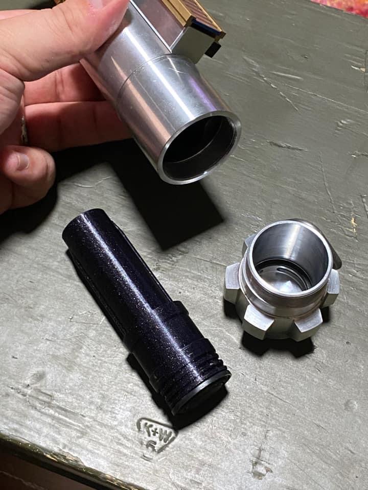

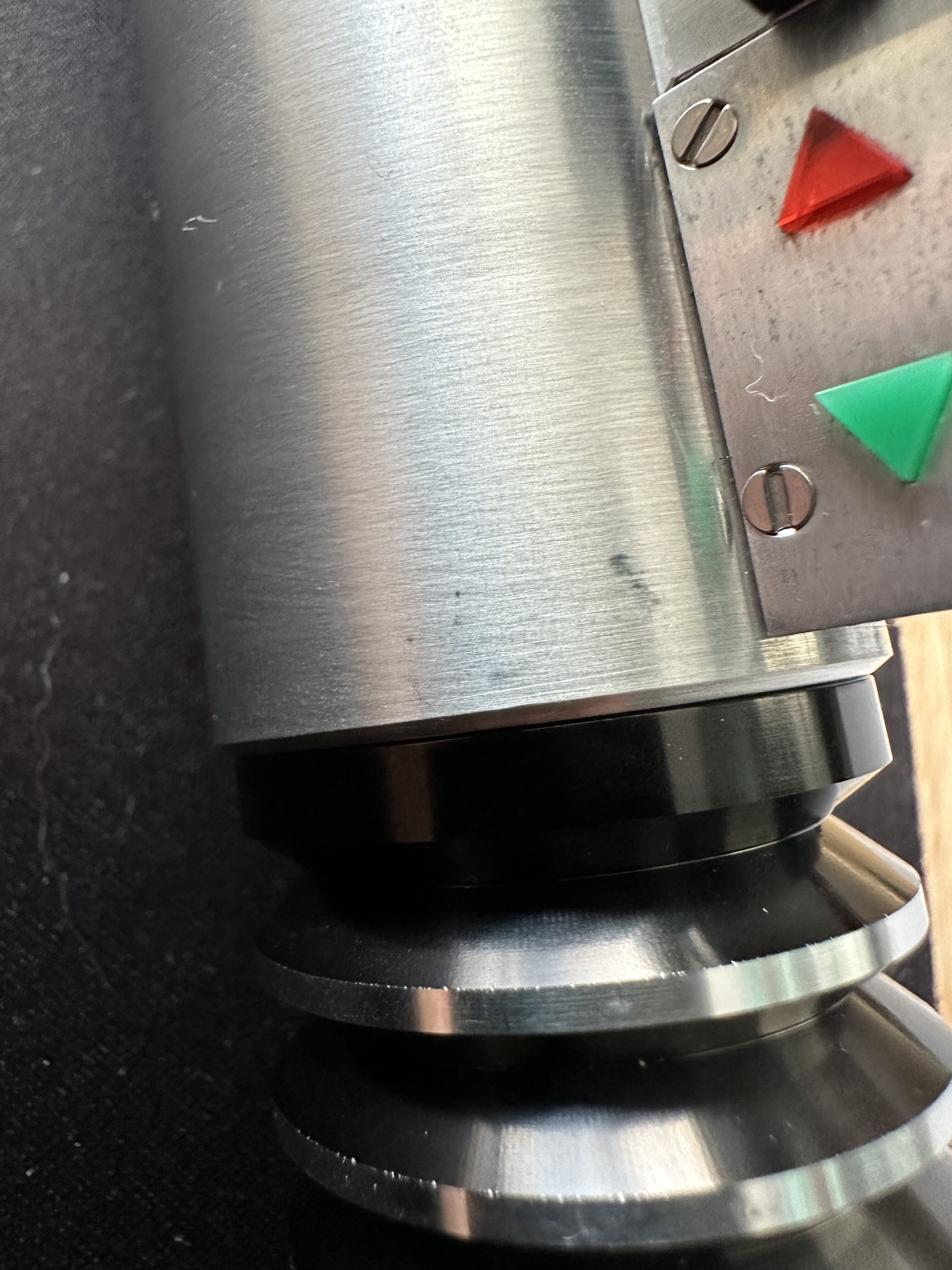

This might be a stupid question but my hilt pretty much hasn’t left the box since I’ve received it.
I pulled it out to take a gander at starting the reveal board while I wait for the 7C chamber to ship and noticed a blemish on the main part of the body. Was this intentional? If not, any tips on how to even this out to achieve a uniform finish? I know this isn’t a high end LE Collectable but I’d still like it to be pristine to fit the rest of my collection.
I pulled it out to take a gander at starting the reveal board while I wait for the 7C chamber to ship and noticed a blemish on the main part of the body. Was this intentional? If not, any tips on how to even this out to achieve a uniform finish? I know this isn’t a high end LE Collectable but I’d still like it to be pristine to fit the rest of my collection. View attachment 1652010
If you are referring to the darkening area that is oxidation. The downside to 7075 is that while it is stronger, it does oxidize. Light steel wool will remove that without marring the finish.
Yeah, just the little dark spot. Appreciate the response.
I think differently, the real prop is oxidized today, I would leave it like that
Interesting perspective. Maybe I’ll just leave it! There is some temptation to weather the bag out of it.
Honest to god, I wouldn’t change it if it were mine, in year or two it’s going to have the correct oxidized finish. And you got it “all natural”
