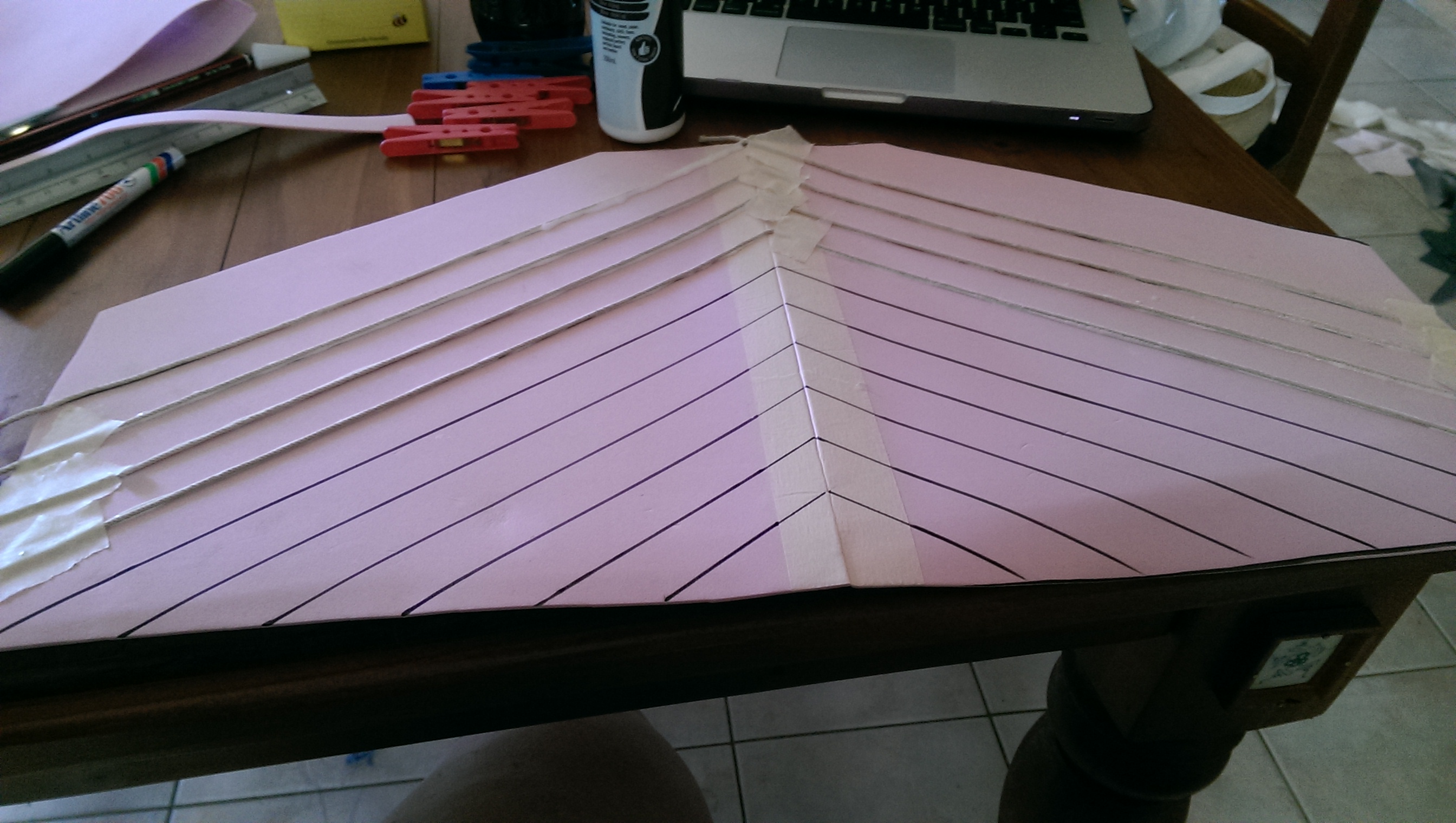

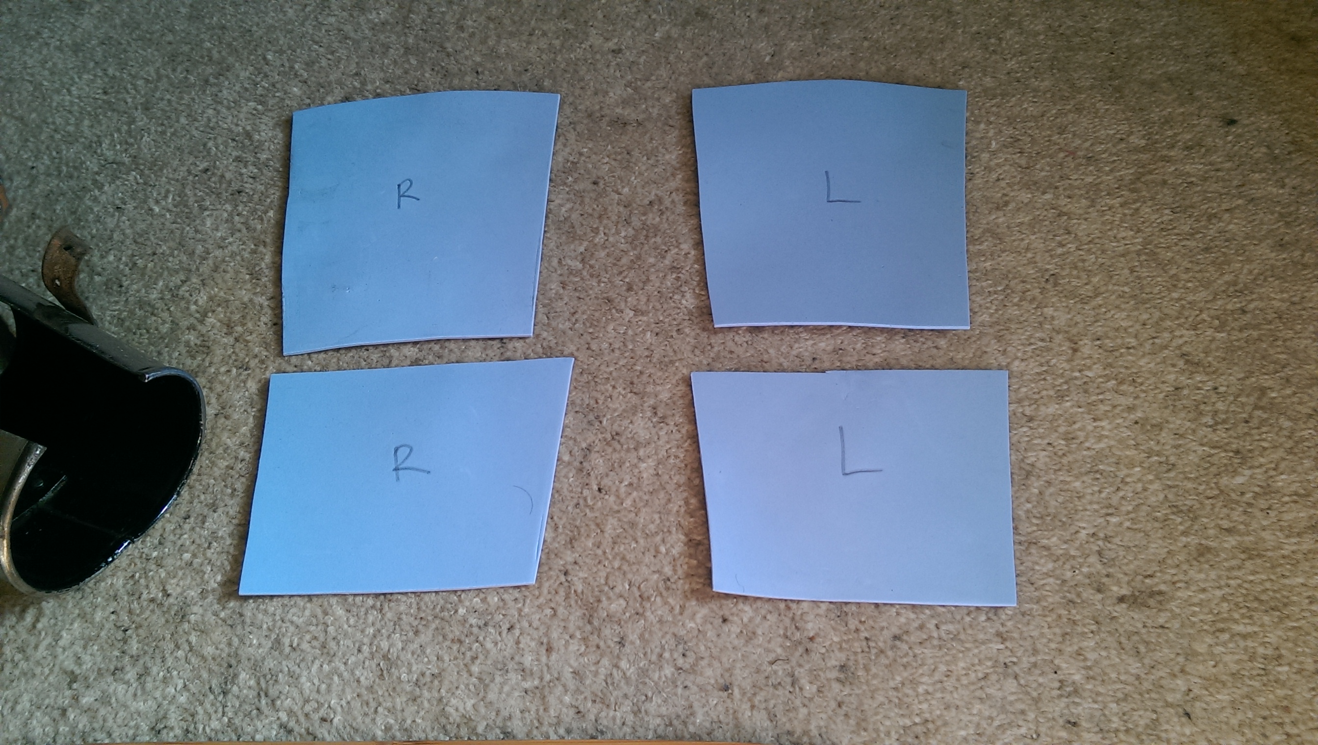

I patterned the forearm bracers today, making adjustments for the Brienne armour. My armour's inner forearm is scooped, Brienne's is straight.
Using the sandwich method, I made the inner and outer forearms and used the real deal to shape it.
Why don't I just wear the real deal? I think 8 hours in this gear and my arms will be dead. Craftiflex is beautifully light!

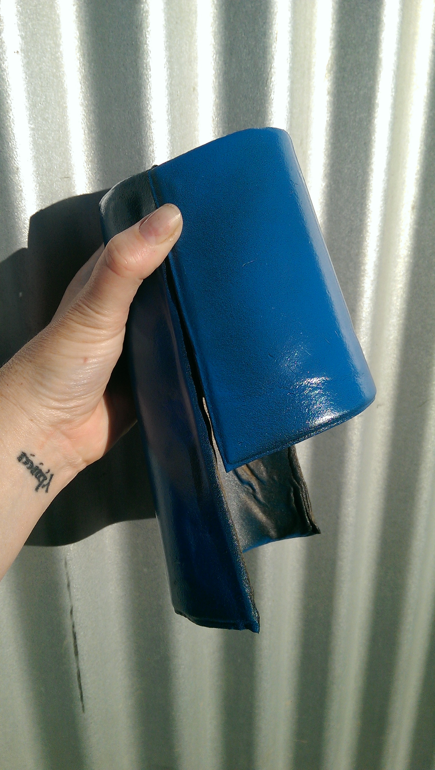

I am 3/4 through painting the bracers. The blue I have chosen is a little brighter than is visible in the show. My plan is to layer black over top and wet sand to get that gleaming blue/grey appearance.
IMAG0146.jpgIMAG0145.jpgFour layers of primer. Four of black undercoat. Three blue to that point.

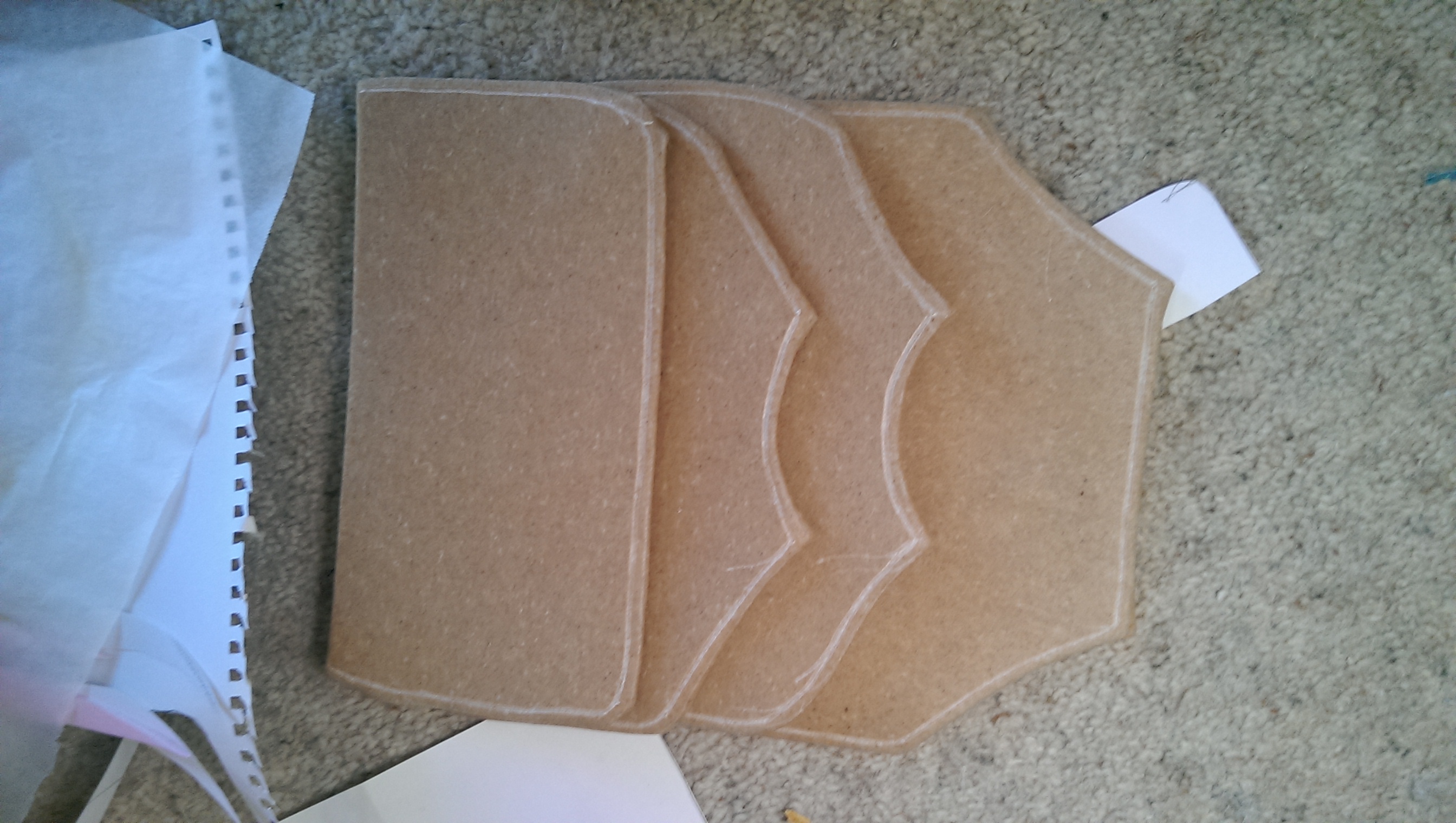

The lames of the pauldrons and rerebrace patterned, cut and covered with Craftiflex.
The edge was patterned with a leather working tool that carves a channel in leather. It makes a nice approximation of the edging that Brienne has on her armour.
Next I will shape each piece then paint in the same style as the vambraces.

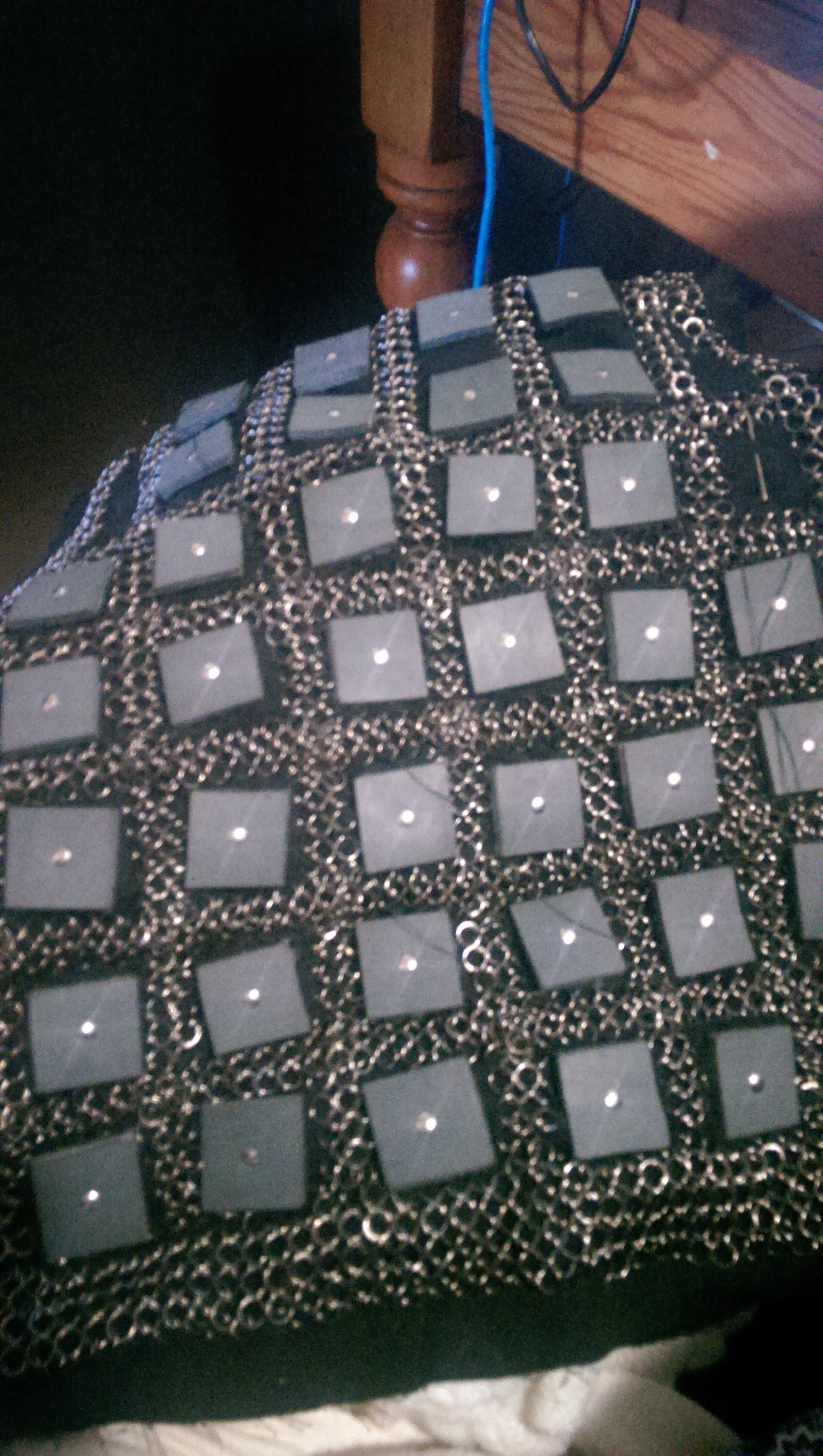

Wow, this build looks so cool. Can we see more pics of the chainmail and possibly an explanation of what's what? It's seems very different to normal chainmail. Are they stitched onto the backing?
2015-03-21 11.16.38.jpg2015-03-21 11.33.13.jpg2015-03-21 13.54.46.jpg2015-03-21 15.17.56.jpg
Next stage is the chest armour. I'm still working on sewing the chainmaille onto the gambeson. It's slow, frustrating work. But it's getting there. Will post pics when that stage is done. I still have to do a 'collar' section on the gorget.

First coat of Rustoleum Gloss Blue. It will need sanding because every little imperfection shows up with the gloss. Plus I don't want it quite so shiny in the finished product. I plan to layer up about 8 coats of this colour, get it nice and deep before lightly spraying a charcoal/black colour and wet sanding that.

Thanks :) Oh the blue is just the base coat. Needs a lot more work than that done to it to get it to the dark blue/black of the show. I just wanted a rich blue as the base colour to start with :)
Sorry! I missed this question. The chainmaille is a very simple four in one design. I created long strips of maille and I'm then sewing them onto the outside layer of the gambeson. I will have a thin cotton batting lining for the skirts and arms, just to supply some support. As you can imagine the chainmaille + leather is quite heavy, despite the robust fabric I'm using.

This is with two light coats of black, wet sanded to smudge it up.
Its in the process of getting light coats of varnish to seal it up and protect the paintjob. After being outside in varying Australian temperatures, several of the pieces have become misshapen. I will need to gently reheat and bend back into shape.

Needs a bit of a tidy up, but the skirts of the gambeson have all leather and chainmaille attached. I used split rivets on the skirts to attach the leather. The whole thing is quite heavy. I am in the process of sewing up the arms now. With only two weeks to go I'm panicking a little. This has been months of constant work! I didn't realise the insanity of the undertaking back then ;) But then I was determined to finish.
