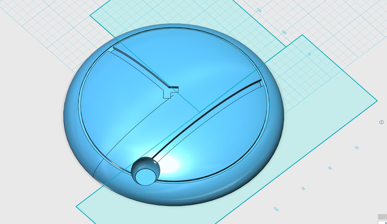

The first piece is going to be the disk as that's one of the most important parts of the gun IMO. I created the CAD for it in 123D and had to print it in 4 pieces since my print bed is too small. This disk is a bit flatter than the one I made previously because I'm following the concept art a bit closer and I don't want it too heavy on one side of the SMG

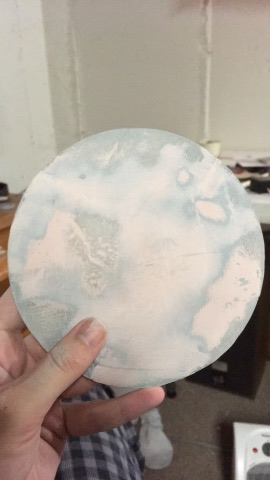

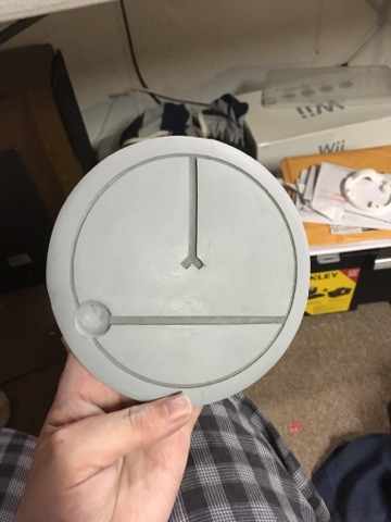

once it was printed I pieced it together using hot glue in the center and super glue on the ends. Then used a bit of bondo and filler primer on the gaps and sanded for hoooooours XD
The disk is nice and smooth and good to go. Next up I'll be making the ring of buttons and nobs that go under the disk and attach to the guns. Still working on the CAD for that so no pics yet. I'm also still deciding if I want to use LEDs on this project or if I wanna keep it simple.

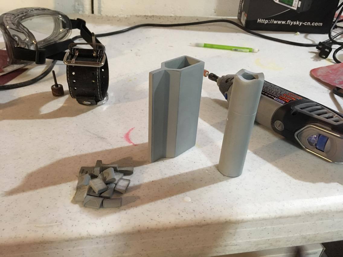

Slow progress thanks to fortnite early access XD. Did manage to print and finish the two barrels, the mounting ring under the disk, and the buttons that will be attached to the ring.

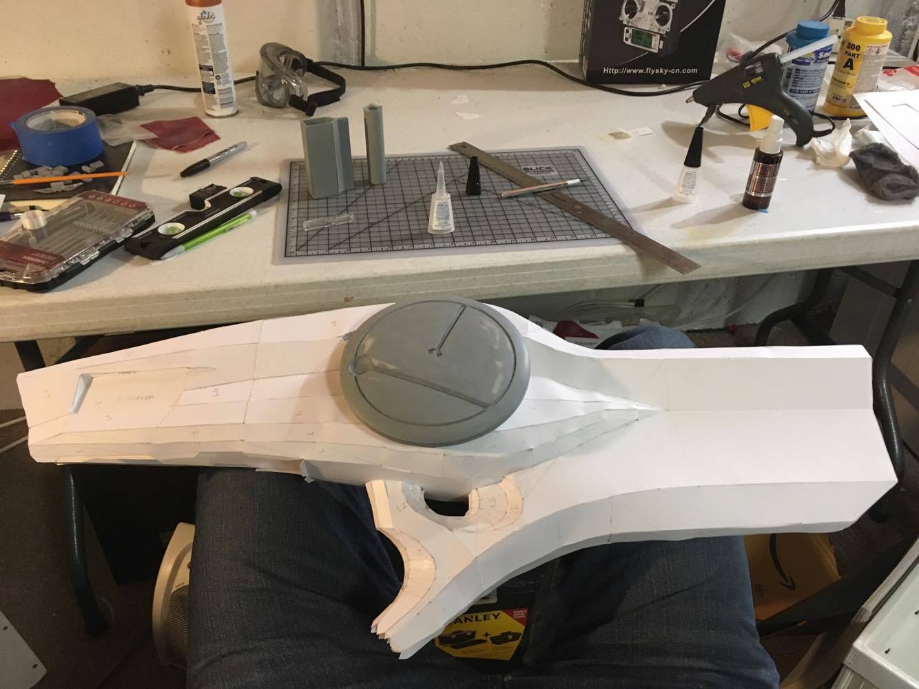

Small update but an important one. Plugged my old 3d model into Pepakura and had it printed out on 11x17 cardstock paper. Was only 4 bucks which is pretty freaking nice. Then proceeded to cut out all the pieces which took foreeeeeeeever. Still don't have the front hand grip but I can probably knock that out in a few hours. Will probably post the pep files somewhere for others to use as well as the stl files since I'm not planning on doing any kits for this project
Getting the body coated in fiberglass resin on the outside and am trying to push a few spots into place. Will then split it in half, give a layer of fiberglass cloth, seal it, and start coating it in bondo. I want the prop to feel like it's heavy like an actual gun so I'll probably be doing some liberal coats of bondo/resin XD. After that I'll be working on optics and the rail and deciding what sort of paint job I want to do (probably just go standard maliwan colors like my model).
