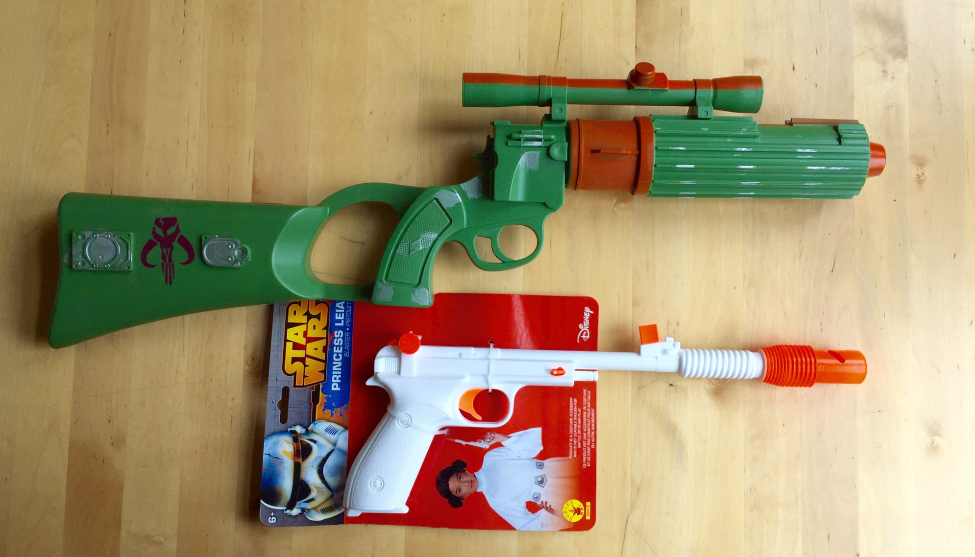

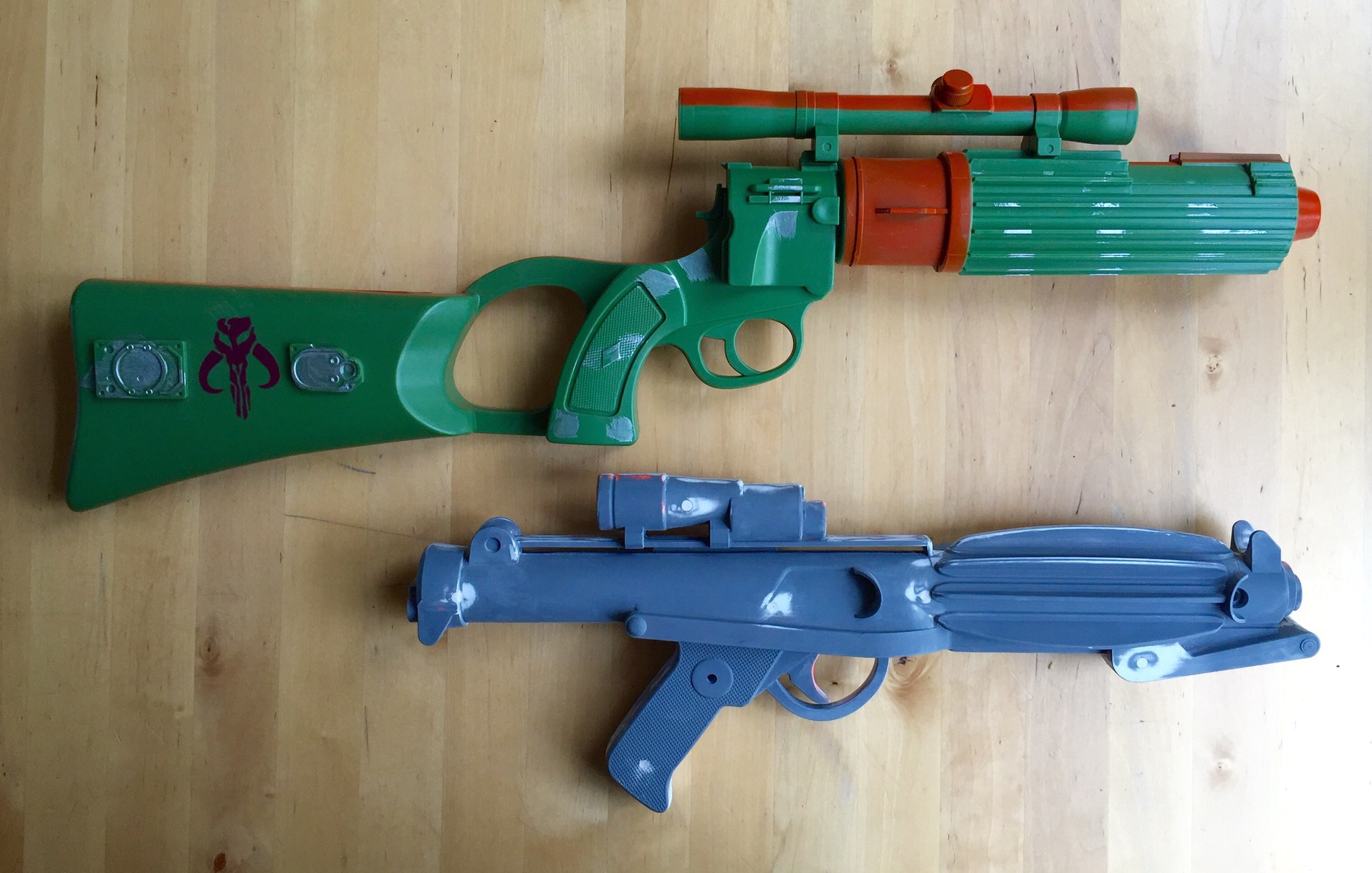

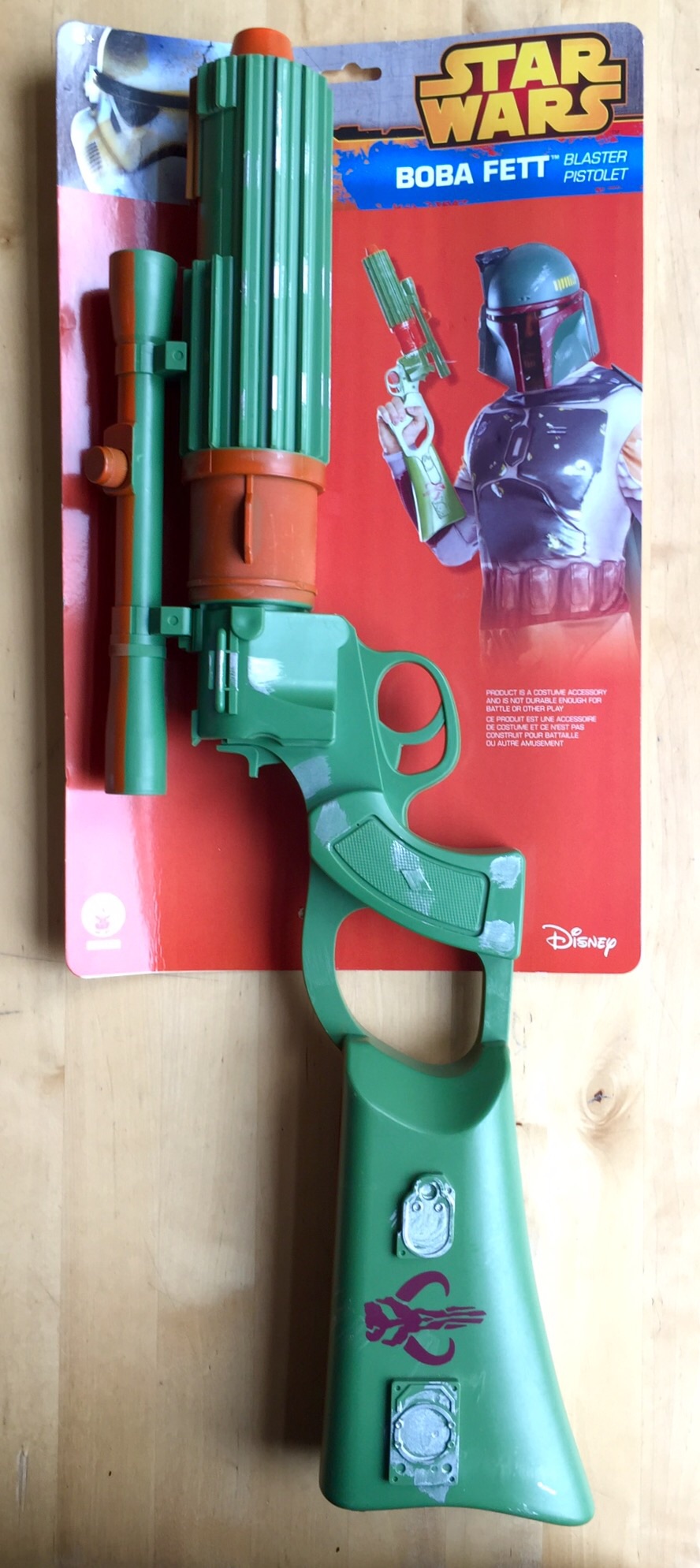

This arrived today - Rubies Boba Fett EE-3 :)
i know now it's far from perfect or accurate but I really like it, I really like this whole current crop of Rubies Blasters
for the price around £12 I'm not complaing it looks close enough for my needs, think I prefer to the look over the Hasbro
size wise it seems pretty good (little short either end) I'm sure if you were inclined you could lengthen it
I will be taking it apart (just to see how it goes together) thinking I'll glue & screw it back together then filler on the seams, screw holes etc
looking forward to painting it up
also got another Leia with it

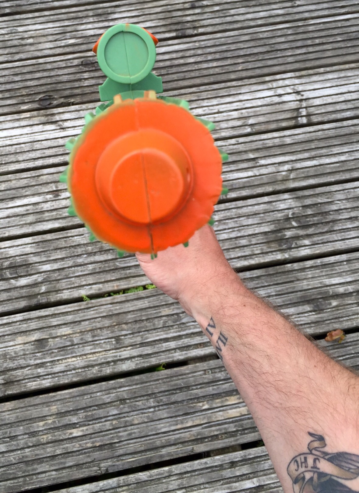

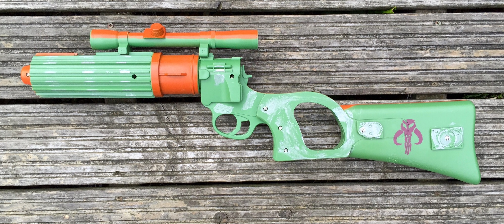

Took the Rubies Boba Fett to pieces :lol
mosty came apart easily enough, not too many screws
I like that the scope is a seperate part, my plan is to add a little weight inside & then glue the whole thing back together,
I find that it just makes it a lot more solid & easier to fill the seams than just the screws holding it together

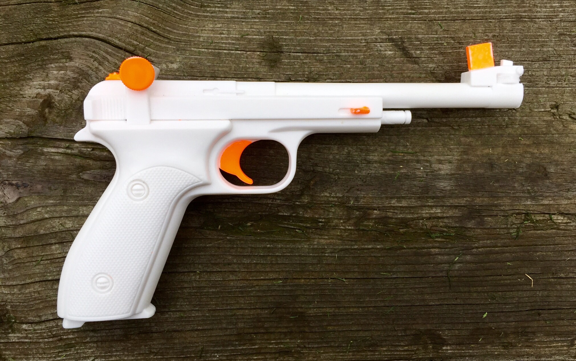

Decided to make a start on my ROTJ Leia
I really do think these Rubies Leia Blasters are great :)
it only took a minute or so with a Stanley knife to remove the coiled section,
I then cut off the front sight & the little rod thing under the barrel
looks like I'll need to cut the barrel through either at the front sight or back where it joins the body to be able to slide the Tomtit parts on
Shapeways had free shipping for new customers so I ordered a couple of the ROTJ flash hiders/muzzles that E Williams put on thingverse (thanks for making these available)

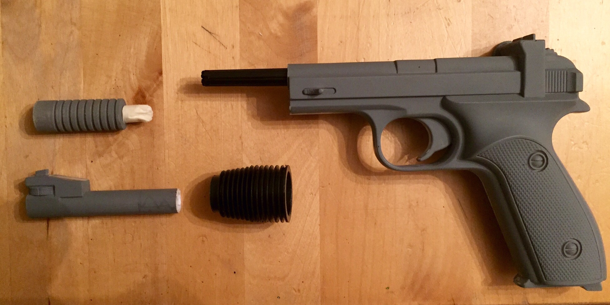

My E Williams muzzles arrived from Shapeways today :)
I got both styles but I think I like the squared off version
think it'll do nicely for my build

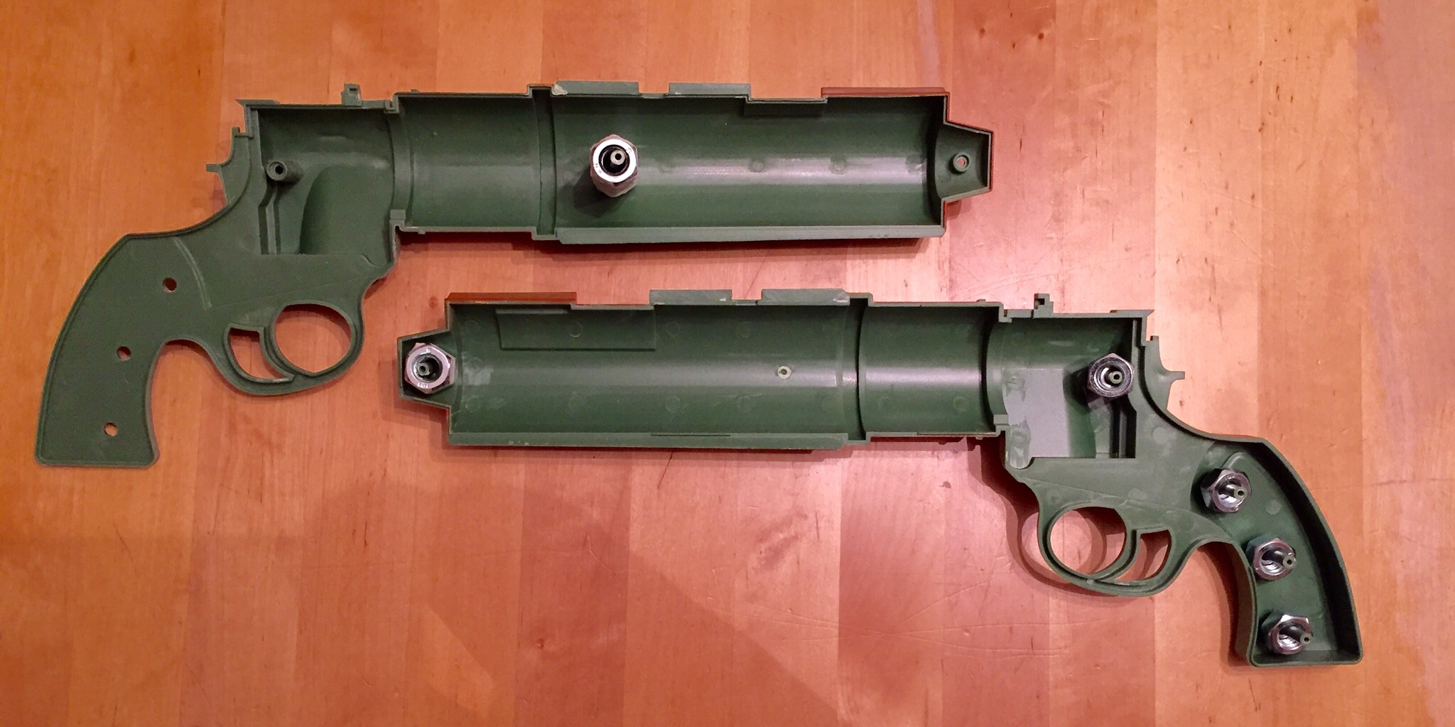

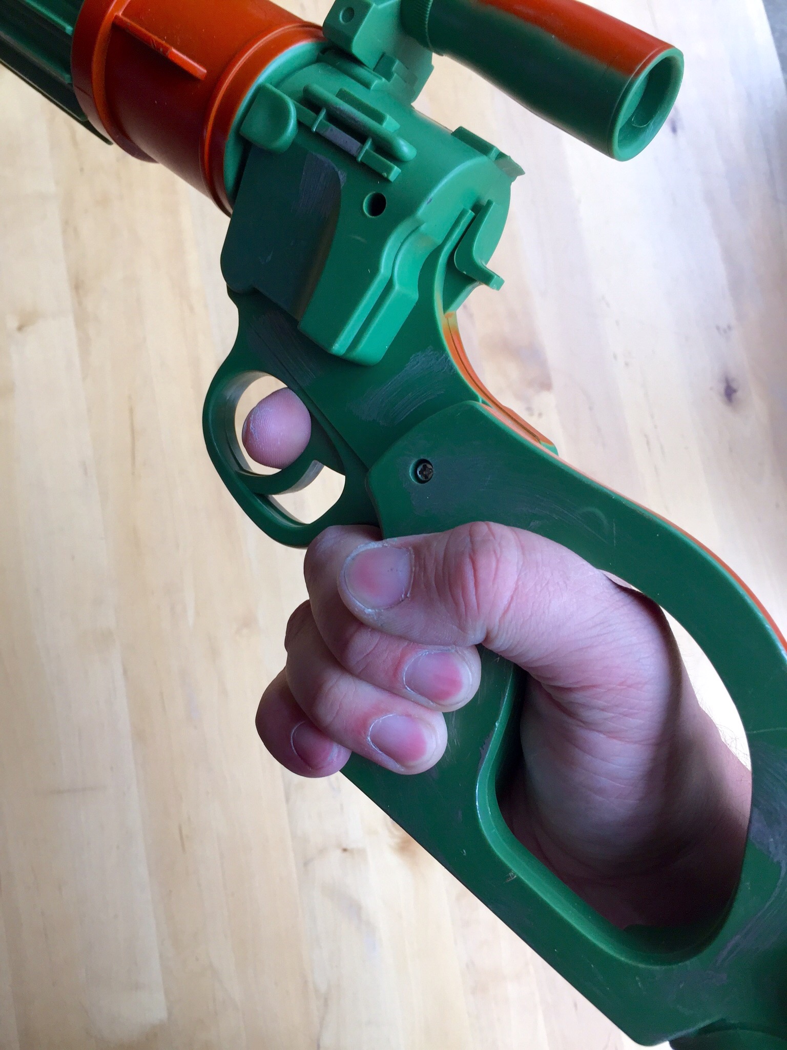

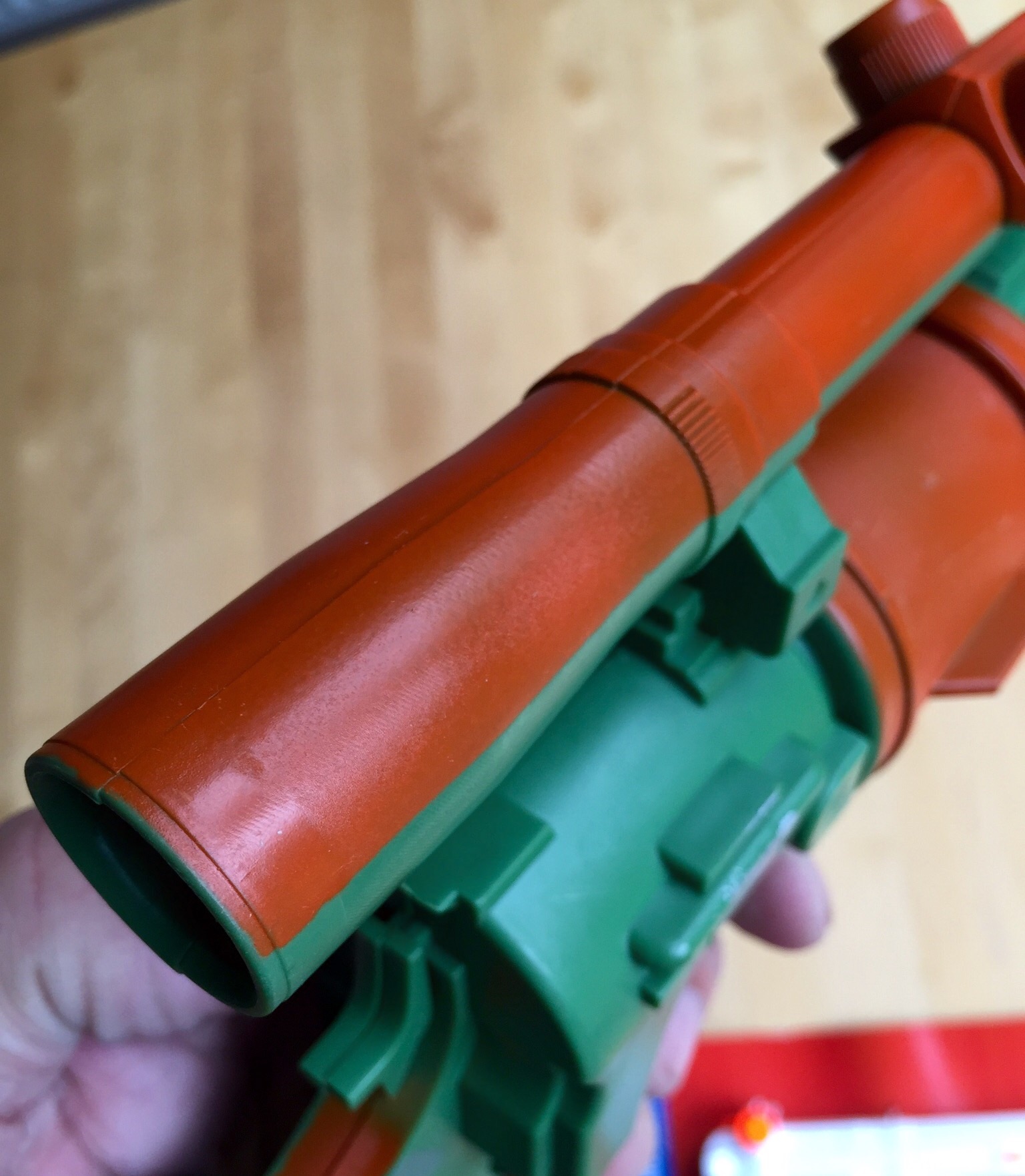

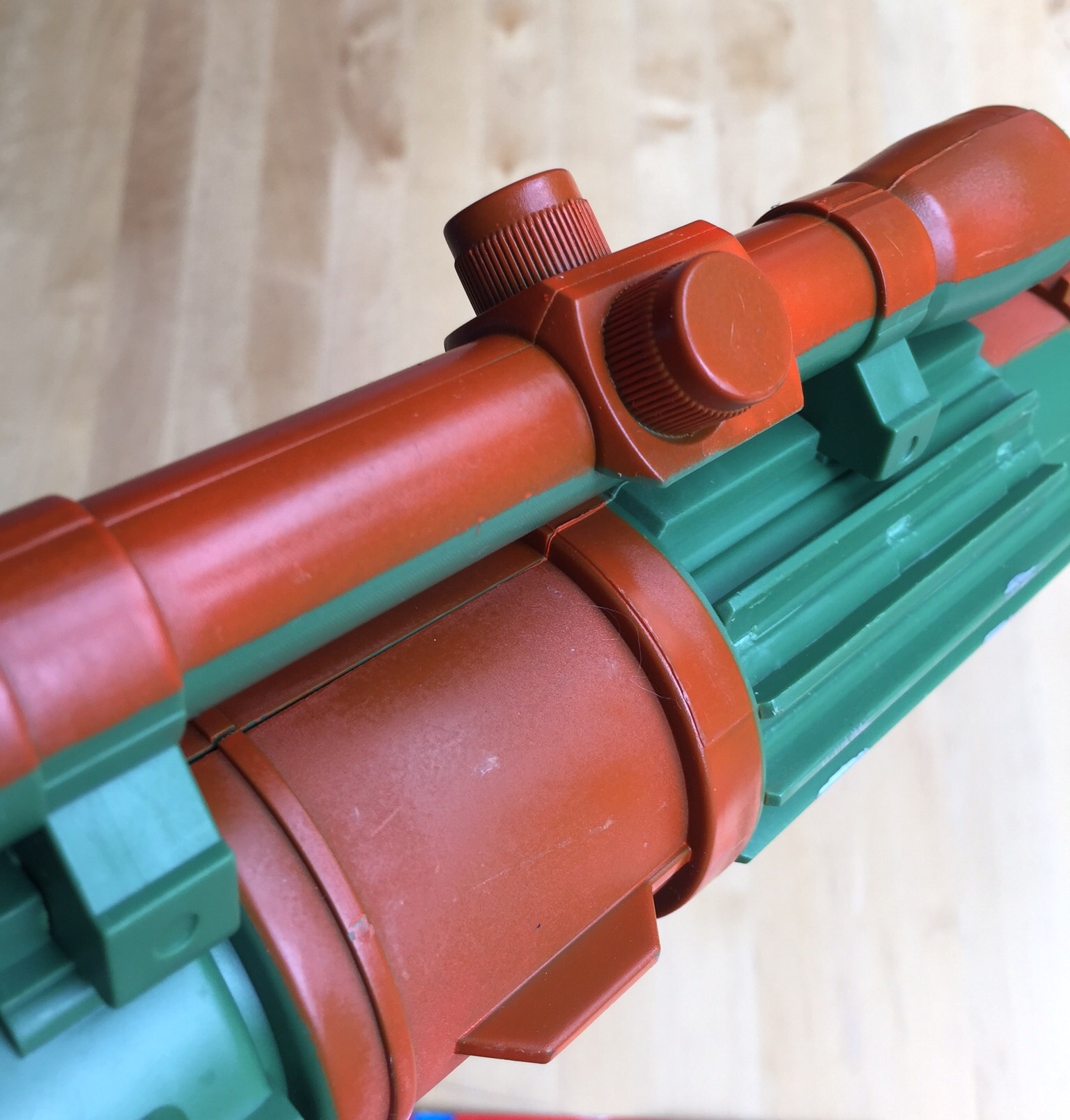

Did a little bit of work on my Rubies EE-3,
I never worried about adding weight to Toy conversions before but these Rubies Blasters are very light as they have no electronics etc, I added some weight to my Rubies E-11 & liked the result so have done the same thing here
i bought some bags of mixed nuts from a pound store & have used the big ones over the screw posts, actually added about 200g of weight :lol
i glued them in place & then I've epoxied the 2 halves of the blaster, scope & stock together, feel much sturdier than just the screws
started filling the seams etc.

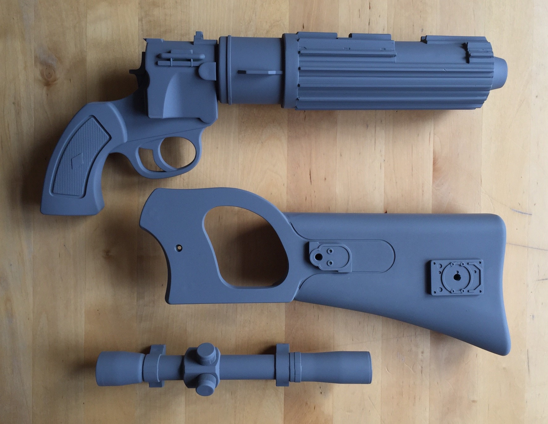

Re: Blaster builds Leia, Greedo's, Jabba's Palace, DH-17, Biker Scout, Kylo Ren ...

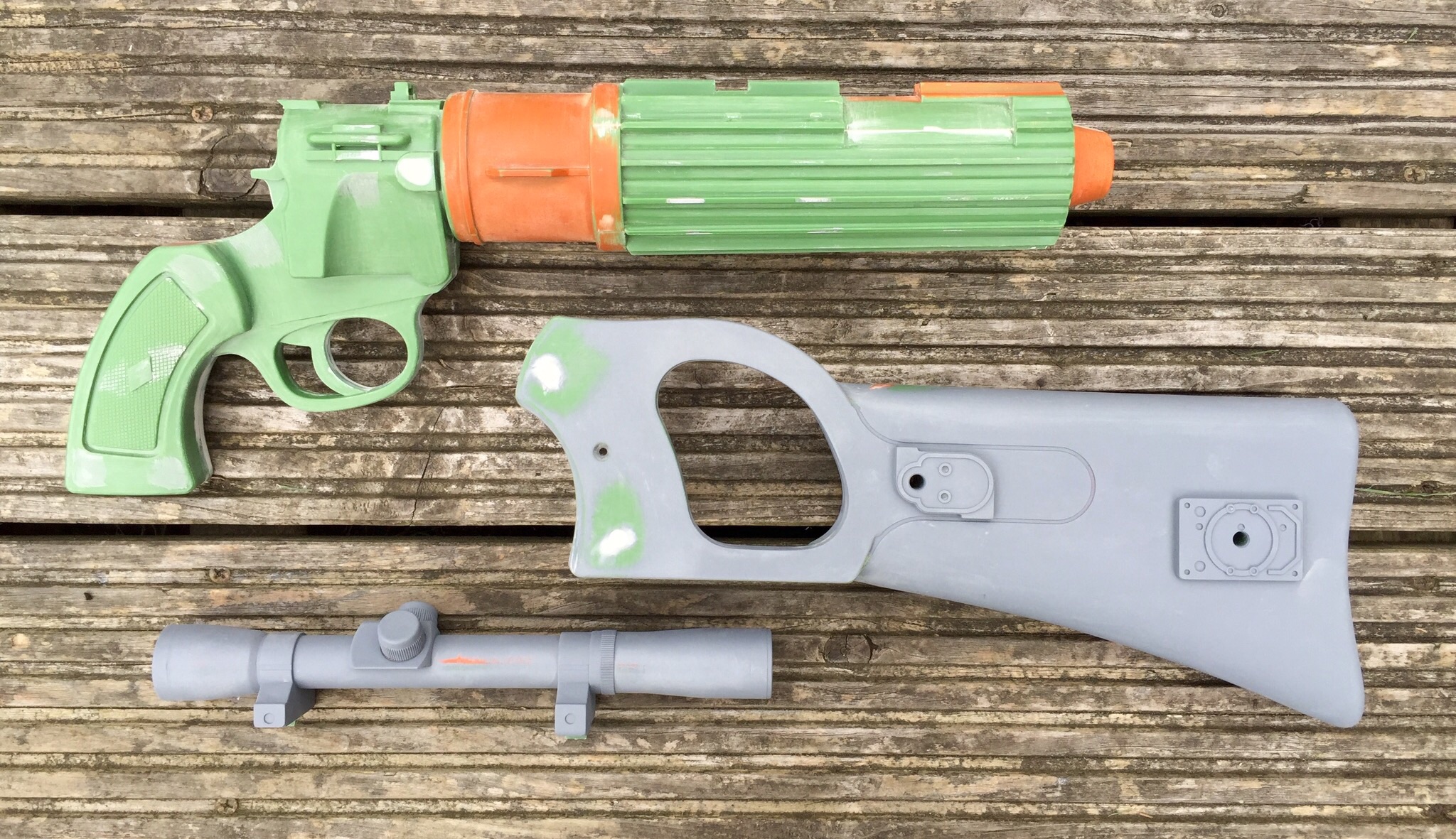

Finished up filling & sanding the Rubies EE-3 & gave it a coat of primer,
it's a cheap plastic toy & I don't think I'd ever get it perfect but it's ok
filled in 2 of the 3 screw holes in the stock side of the grip, I've not drilled out the barrel as there is a screw right behind it
For paint I'm gonna do an undercoat of silver then satin black with heavy weathering, from what I can tell the actual prop is a grey colour but I can't find the right shade
pit always looked black on screen to me so I think I'll go that way

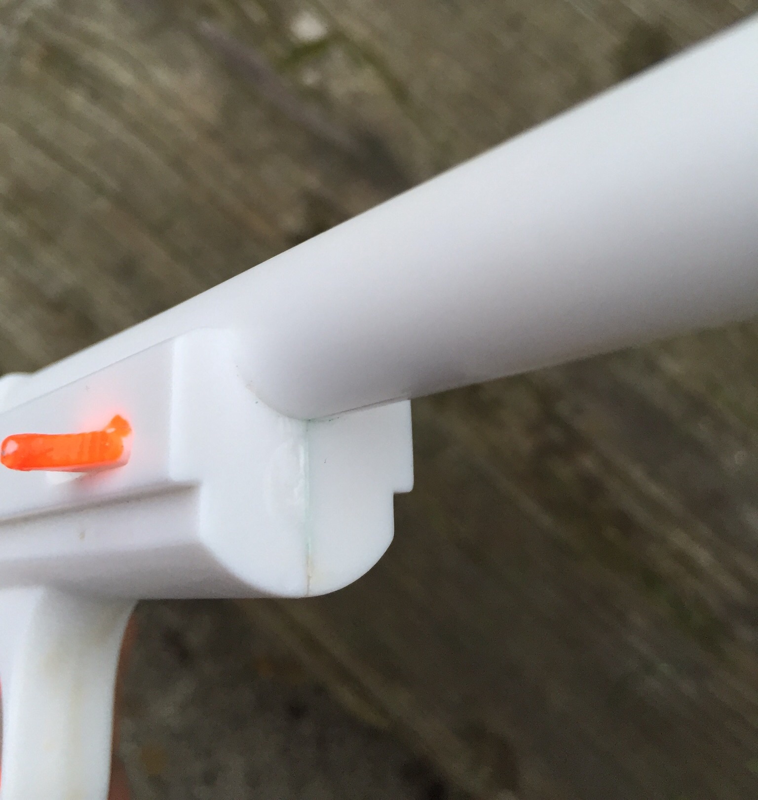

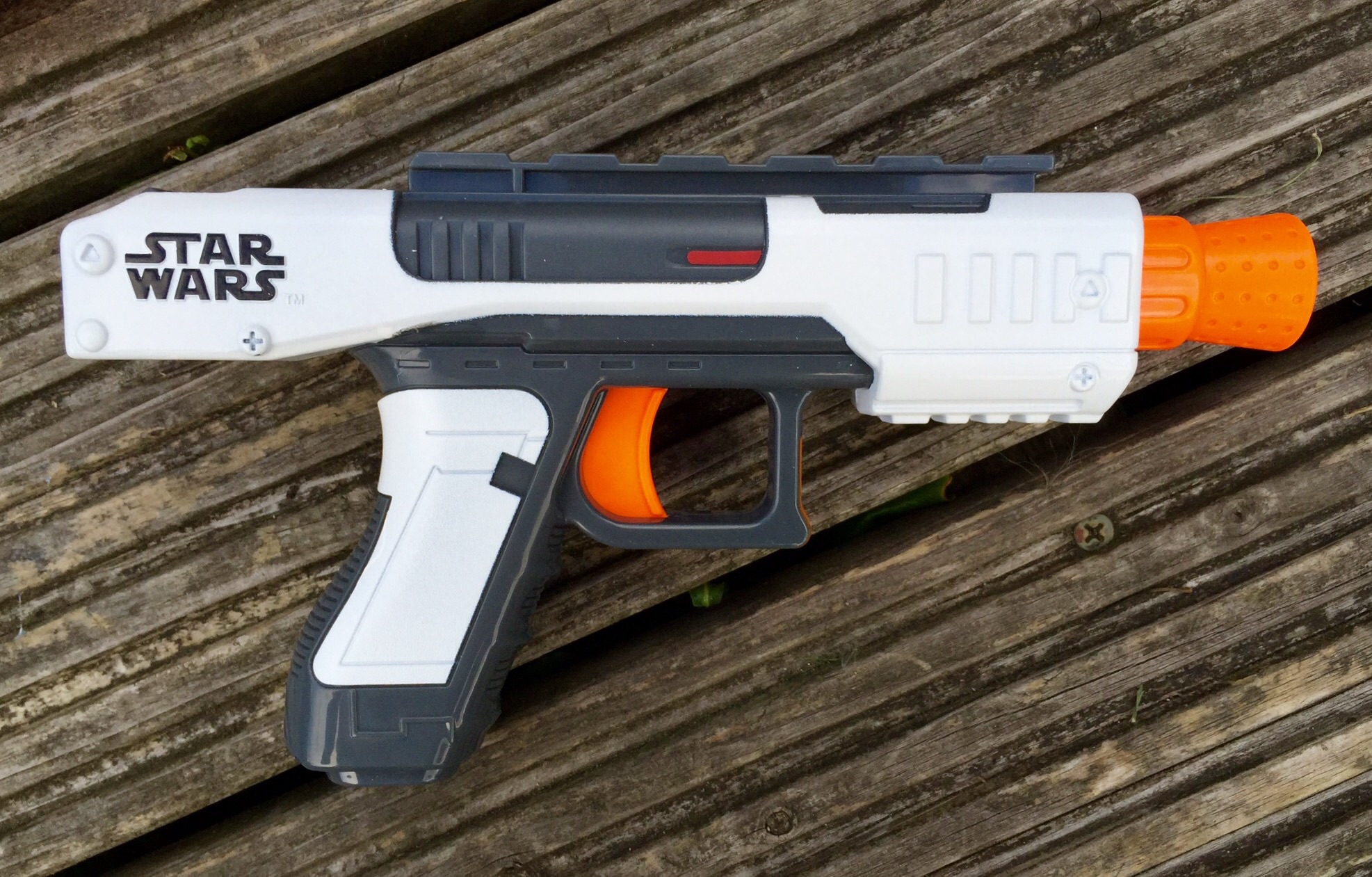

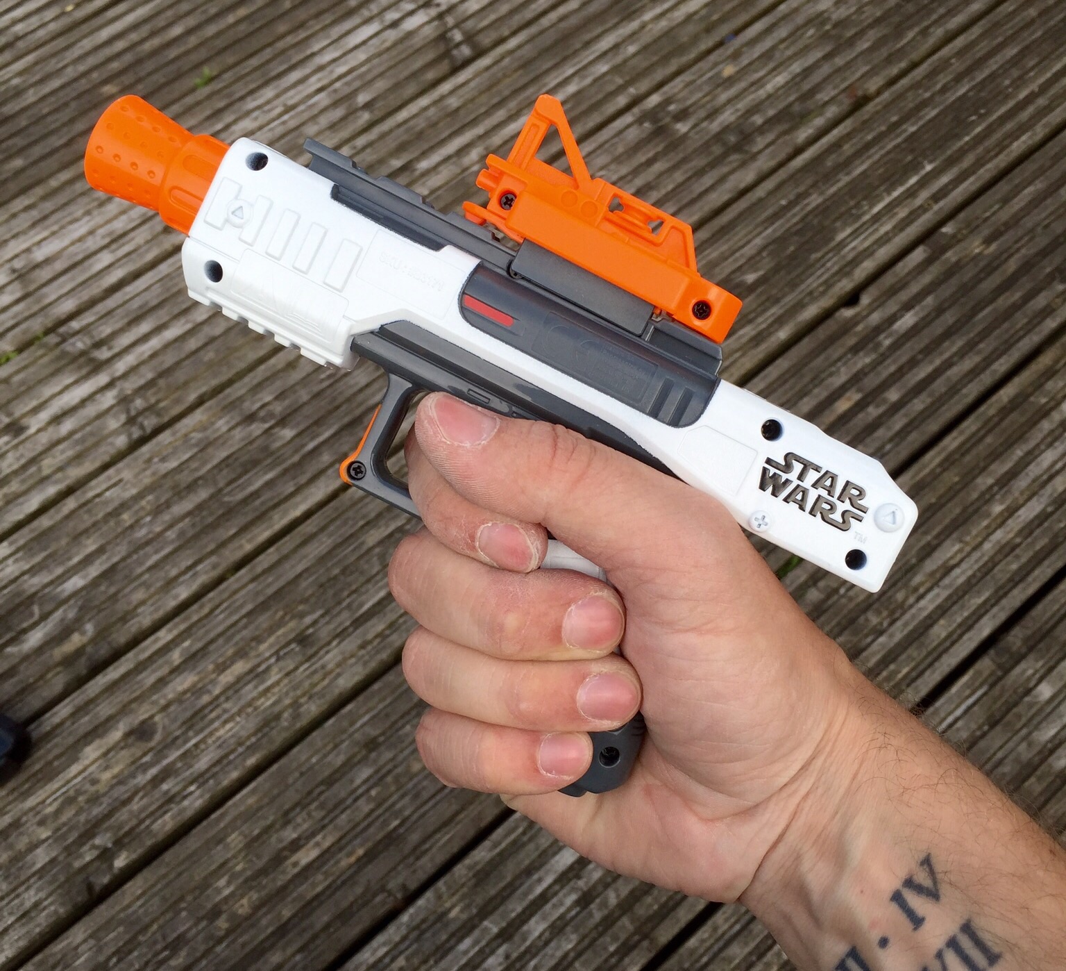

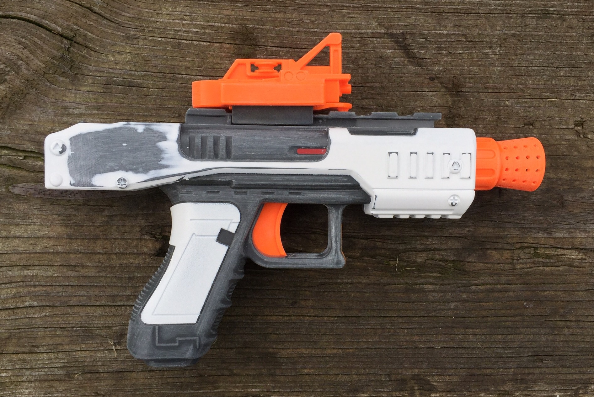

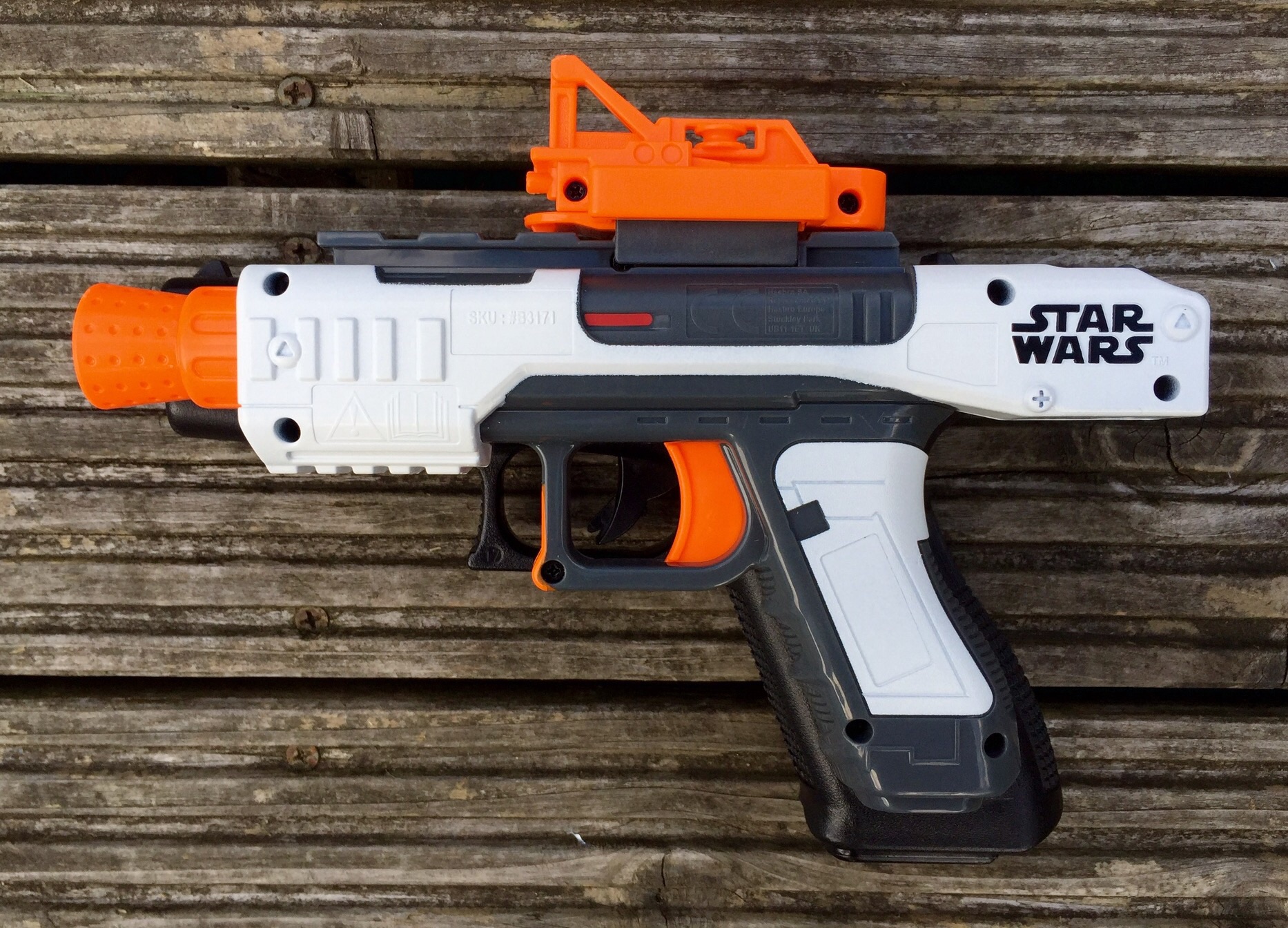

Picked up one of the Nerf First Order blaster pistols today, any other Nerf guns I've ever held always feel big but this is annoyingly undersized
I'm told the blaster is based off a Glock pistol in some kind of carbine kit but this is a lot smaller than my old airsoft Glock
still I don't hate it & figured it's worth trying a repaint

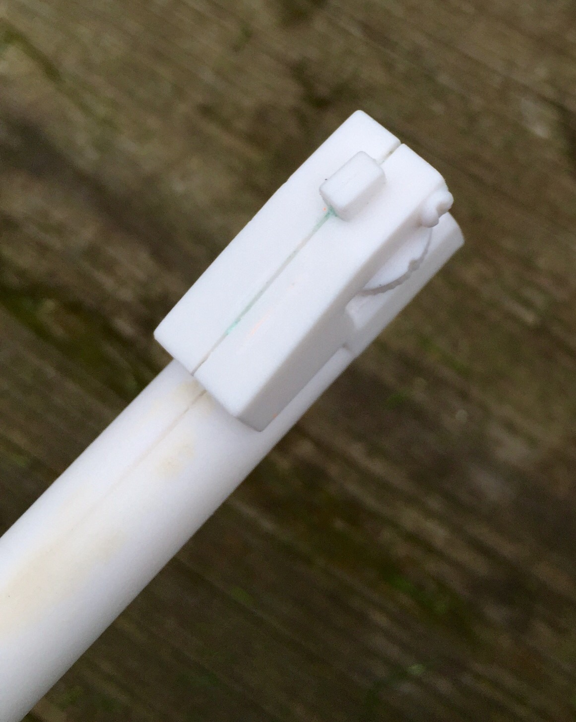

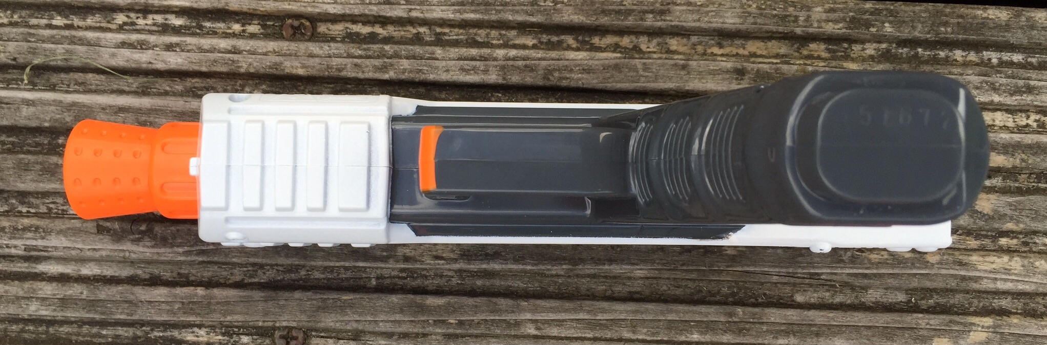

I've drilled out the holes in the Flash Hider, filed off the various bits of writing & filled in the screw holes
I'm gonna undercoat in silver then do a lot of masking off to paint the black & white areas
I'm not sure how Star Warsy this blaster feels but at least the Flash hider is a nod in the right direction :lol
would love over someone to built a proper 1-1 Glock Conversion kit for this blaster once we have some better reference

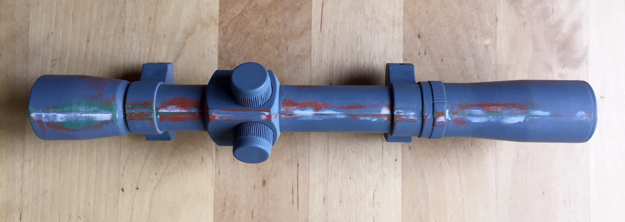

Re: Blaster builds First Order Pistol, Boba Fett, Leia, Greedo, Jabba, DH-17, Kylo Re
Got the Boba Fett Blaster painted satin black time to start on the weathering
just been adding some drybrushed Browns for for the dirt/rust effect (I remember why I stopped weathering this way very slow going) & then I'm going to take off some of the black for the silver undercoat to show through in spots.

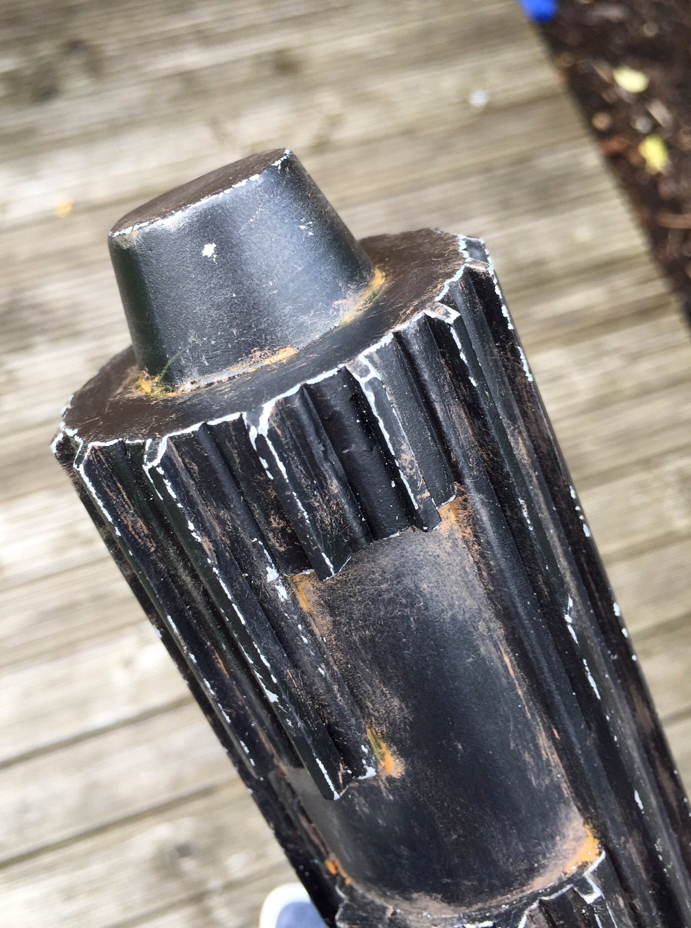

think I'm done weathering the Boba Fett, not gone for screen accurate just really Haggard
had a mini disaster when I went to put it together & my carefully filled seams started splitting, if I do another one of these then I won't be adding the extra weight it, think it puts too much strain on the glue :facepalm
need to fix it up & get it back together

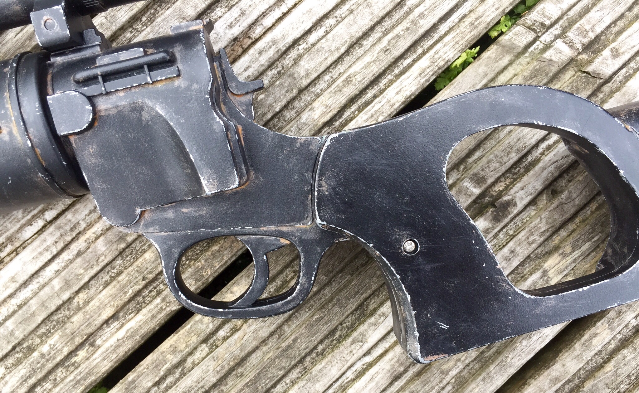

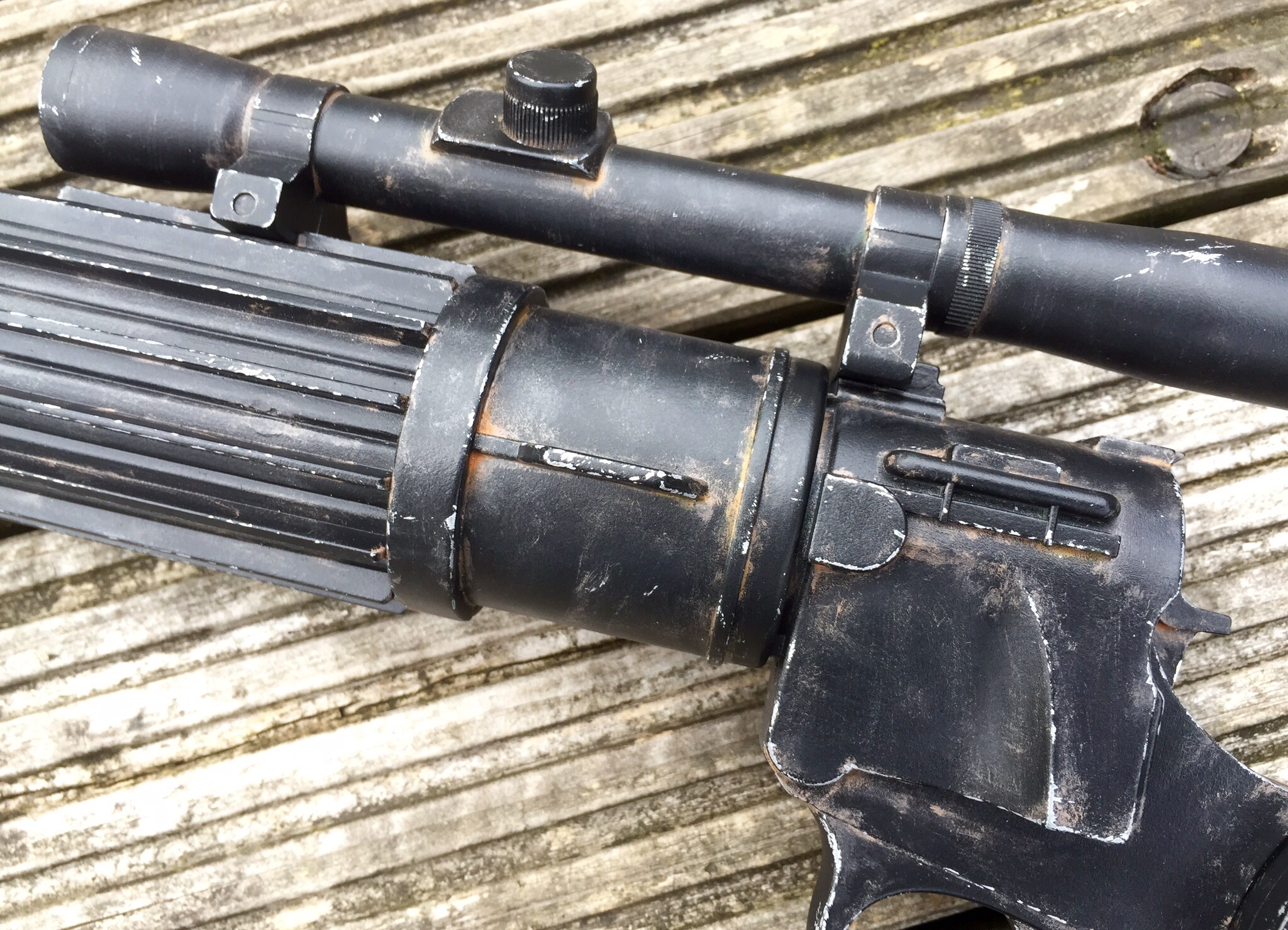

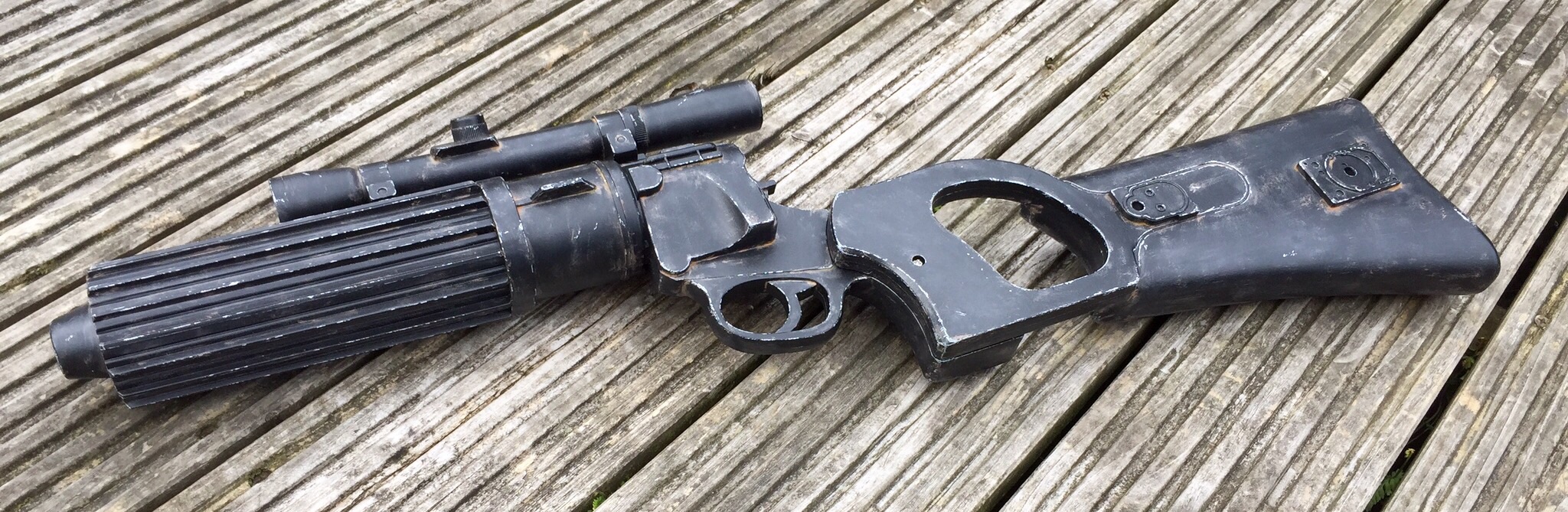

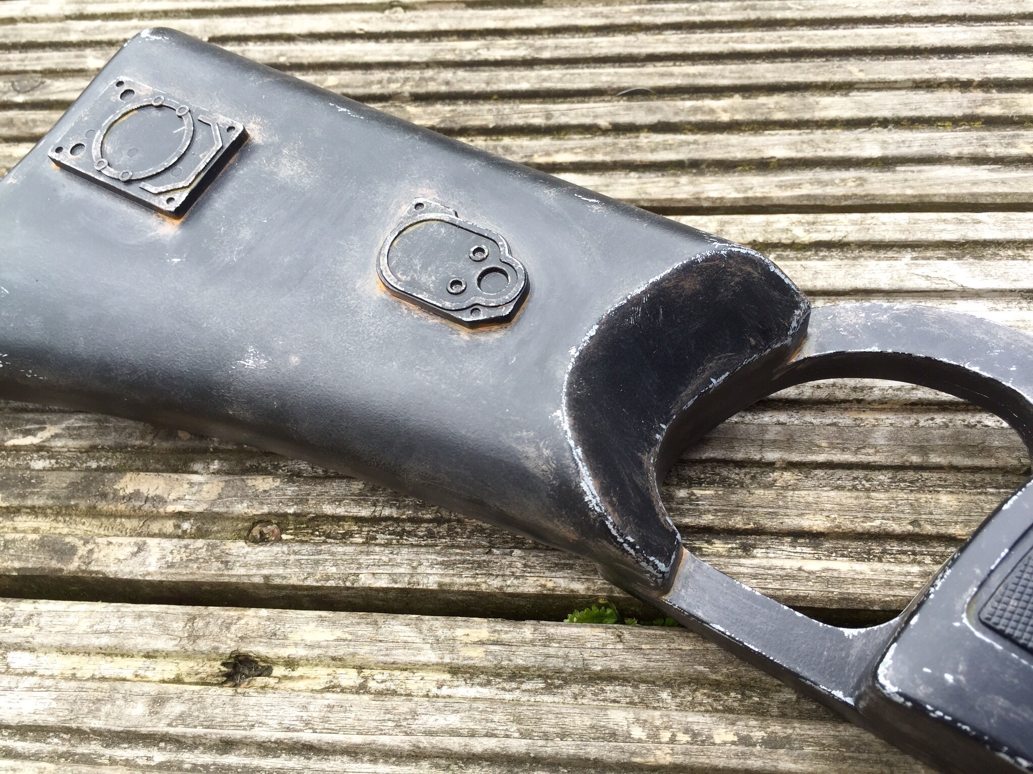

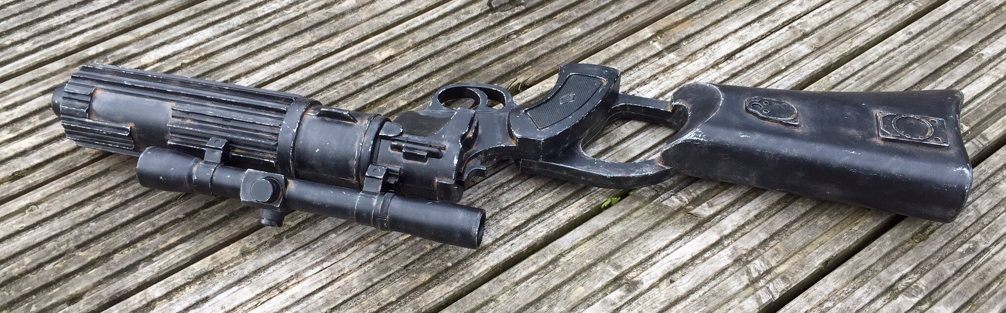

Got the Rubies Boba Fett Blaster put back together & I'm gonna call it finished
still kicking myself about splitting the seams but figure the blaster is weathered enough that it doesn't matter too much
Paint job isn't perfect but I'm pretty happy with how it turned out, I just went to town making it look battered
I know it's not accurate but I'm pretty pleased with how it turned out for a very cheap toy it paints up ok :lol
it'll fill the EE3 gap in my blaster collection for now
