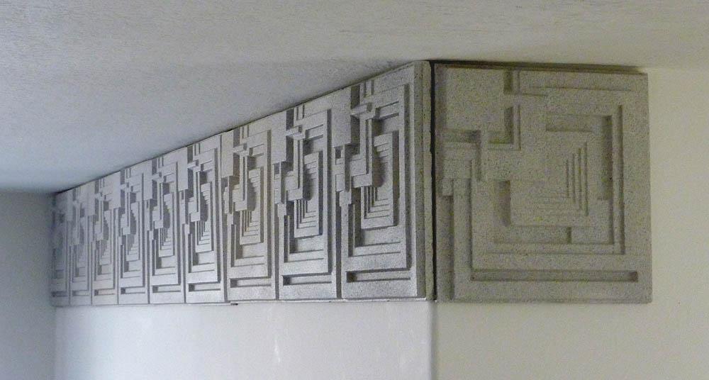

Excellent work on your interpretation of the plans! I've never seen those before, so I bought a 16" tile from the FLW foundation and pulled a silicone mold off of it. Neither were cheap, but now I can cast hollow, fabric reinforced plaster shells on demand! The finished shells weigh a bit less than 3 pounds each, I back them with illustration board and then just hang them like pictures!
This is the way for sure if you want them in mass. Great work!
