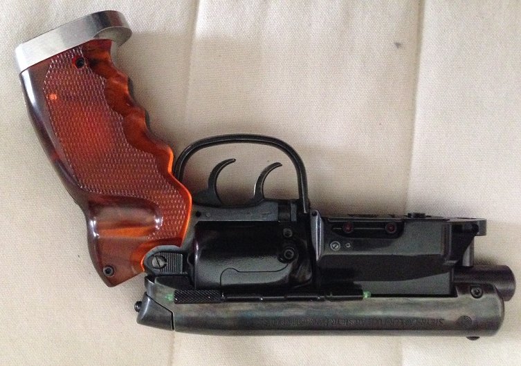

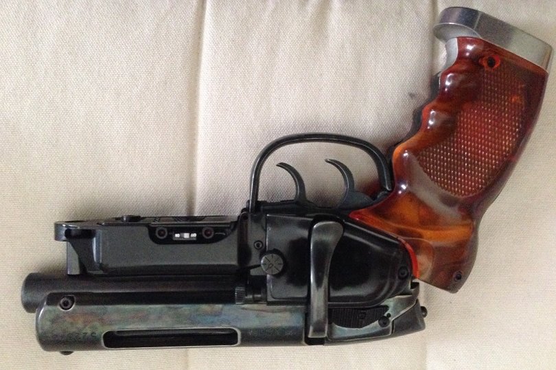

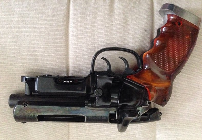

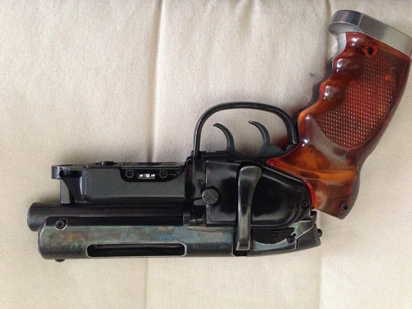

At long last! I have finished the initial build of my Tomenosuke Pro Blaster. I say initial because I do plan to weather it eventually, but for now I want to enjoy it in all its nearly pristine glory. The flash pictures I took really show all the gory details. In normal light the bluing on all the parts looks much more even. It took me a while to work out the technique, but I think it came out really well.
Many thanks to DaveG for his awesome barrel and display stand. And thanks as well to all the members of this forum who provided so much help.

VFX your blaster looks great. Can you describe your technique for blueing? Did you dilute? What blue did you use? Thanks
Carl
Thanks, Darth. I'll write up what I did and post here. I didn't take photos while in progress, but I did take good notes.
kpax and Clutch: thanks for the compliments! Means a lot coming from you two.
Darth, I'm traveling but will post how I did the bluing as soon as I can. Might be a couple of days. I can start with the fact that I used Perma Blue and did begin with it heavily diluted.

Awesome. I had suspected you diluted it from how it looks so consistent in color and not blotchy. Looking forward to it to the write up. Thanks again.

Hi VFX. I received your PM. Thank you so much for that. Just wow. Im testing both the perma and the aluminum black on some small pieces. Once I finished and hit it with the polish.... OMG. Beautiful. I never thought I could get such a finish. Now to pick up some more aluminum black and try the receiver. I will post pics soon. Thanks again VFX

Yes for those of you who are wanting to blue it up this is a great guide by VFX. Its a great procedure for bluing zinc. BTW VFX I ended up using perma blue lol and it went excellent. :) I like a little discoloration. to me it mimics heat from rounds fired.
