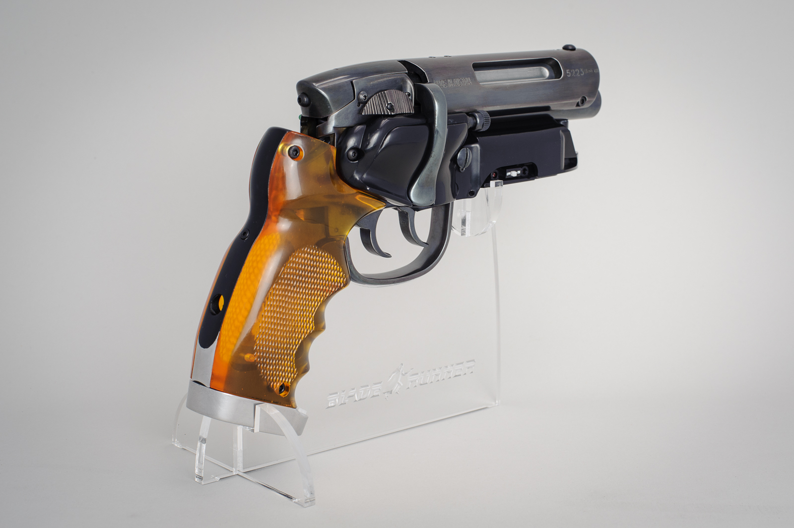

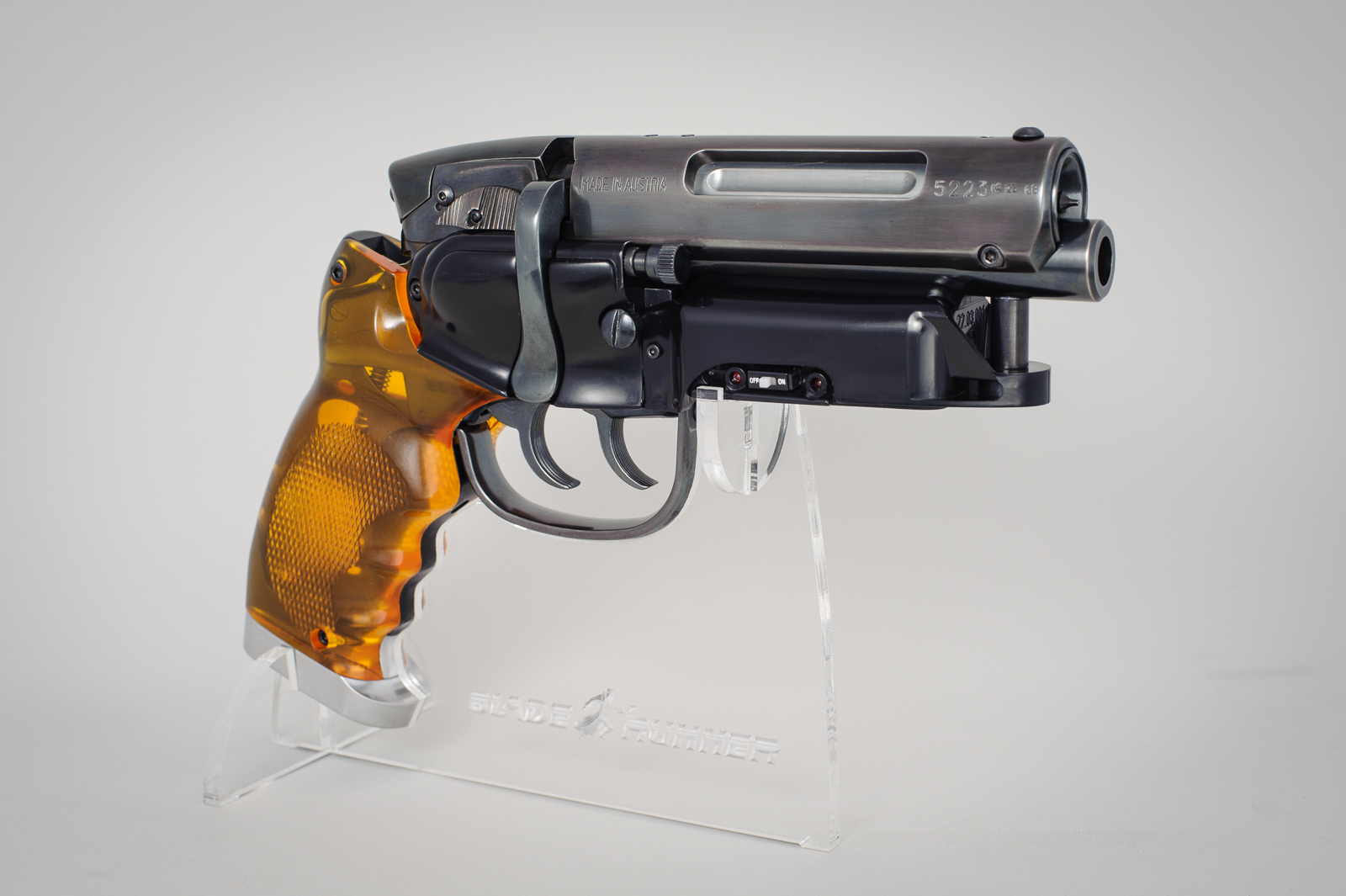

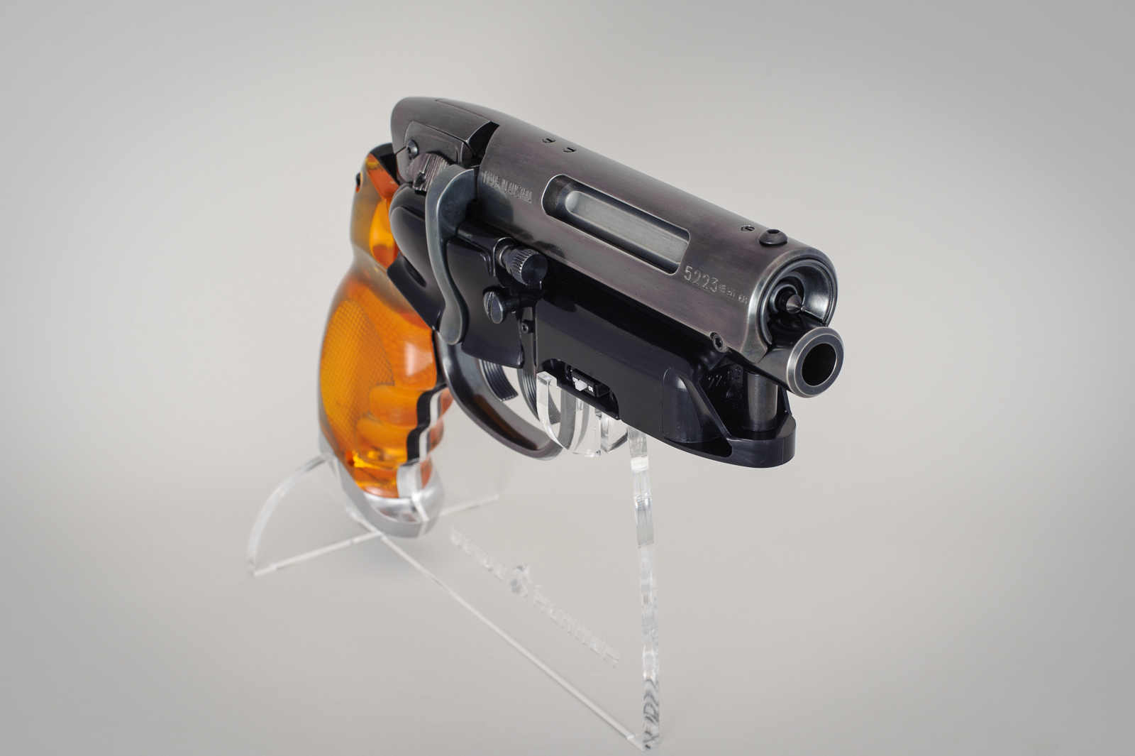

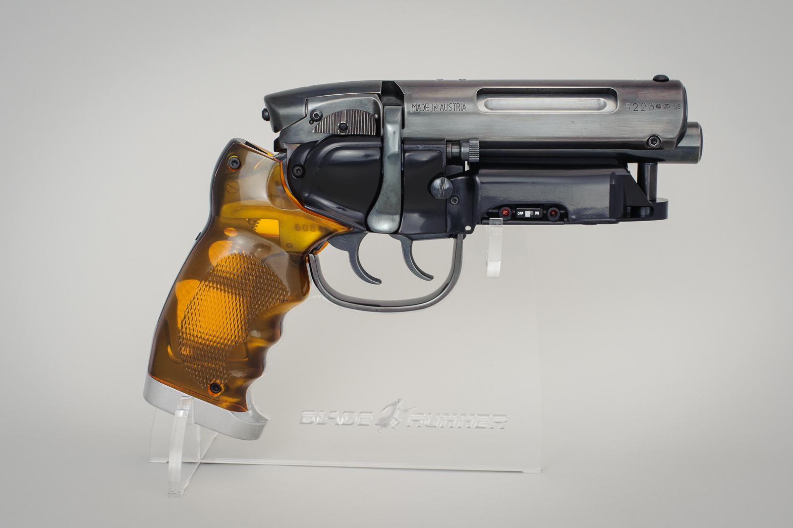

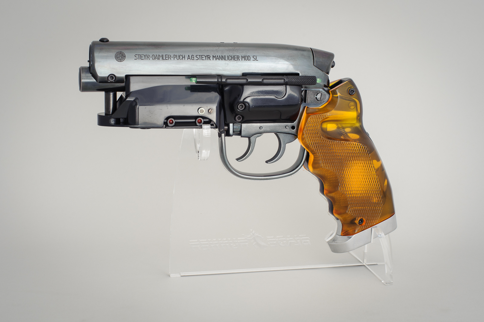

At long last! I have finished the initial build of my Tomenosuke Pro Blaster. I say initial because I do plan to weather it eventually, but for now I want to enjoy it in all its nearly pristine glory. The flash pictures I took really show all the gory details. In normal light the bluing on all the parts looks much more even. It took me a while to work out the technique, but I think it came out really well.
Many thanks to DaveG for his awesome barrel and display stand. And thanks as well to all the members of this forum who provided so much help.
Finished PKD-48.jpgFinished PKD-42.jpgFinished PKD-23.jpgFinished PKD-22.jpgFinished PKD-51.jpg
View attachment 244127View attachment 244128View attachment 244129View attachment 244130View attachment 244126
Great Looking - I have been busy for a bit and glad to pop back on and see this !
