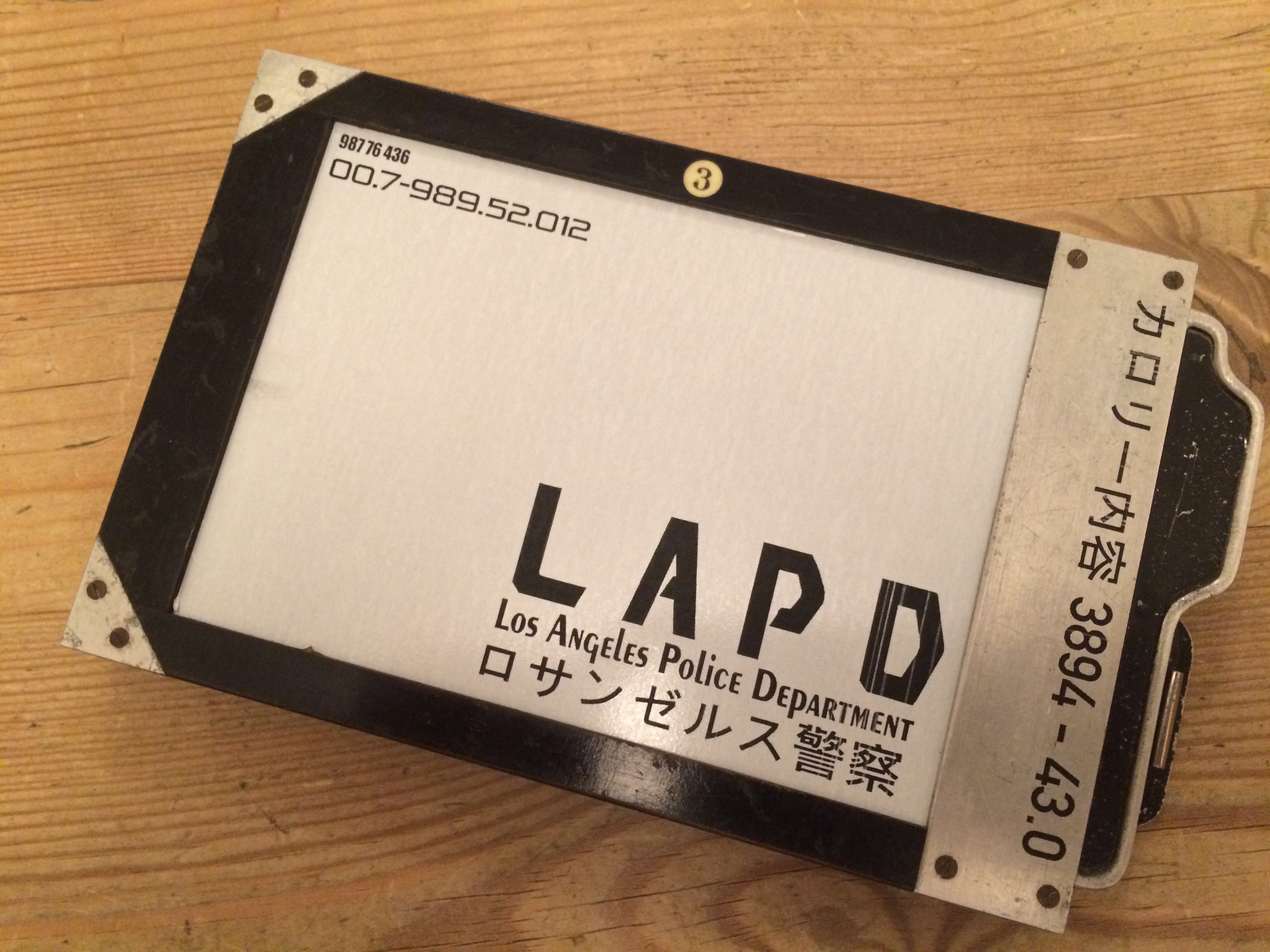

Interesting how the manufacturer (if it's just one) mixes and matches the grip style...
How would you describe the metal of the dark slide - is it steel? Aluminum? Brushed? Painted? Satin? Polished?
Are the circled numbers inlays? Can you tell what they're made of?
The triangular corner plates and cross bar - are they steel or aluminum? What material are the grips?
Final question: please remove the dark slide so we can see the interior. :)

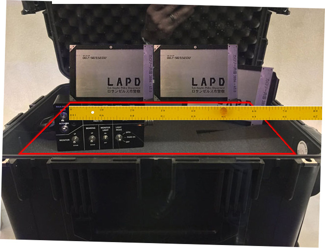

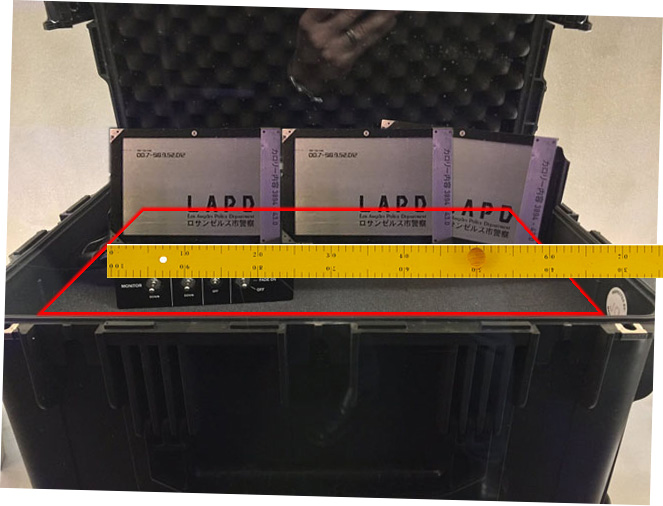

Birdie - check out eethan’s latest reply to the BR2049 props thread on PropSummit - he used Photoshop (at my request) to verify your conclusion on the correct size of the plate holder. Could you step in and confirm?
Hey, Unforgiven asked me to post here too. here is my photoshop, I'm not super sure this is conclusive as it's really approximative.
first picture is with the plates at the same size at the back of the box, you get 55cm for two plates:
now, this isn't really precise, I didn't change the size of the plate, but since it's not sitting at the back of the case, if you do what I did again but not totally at the back, you get 47cm for 2:
don't know if that helps :?

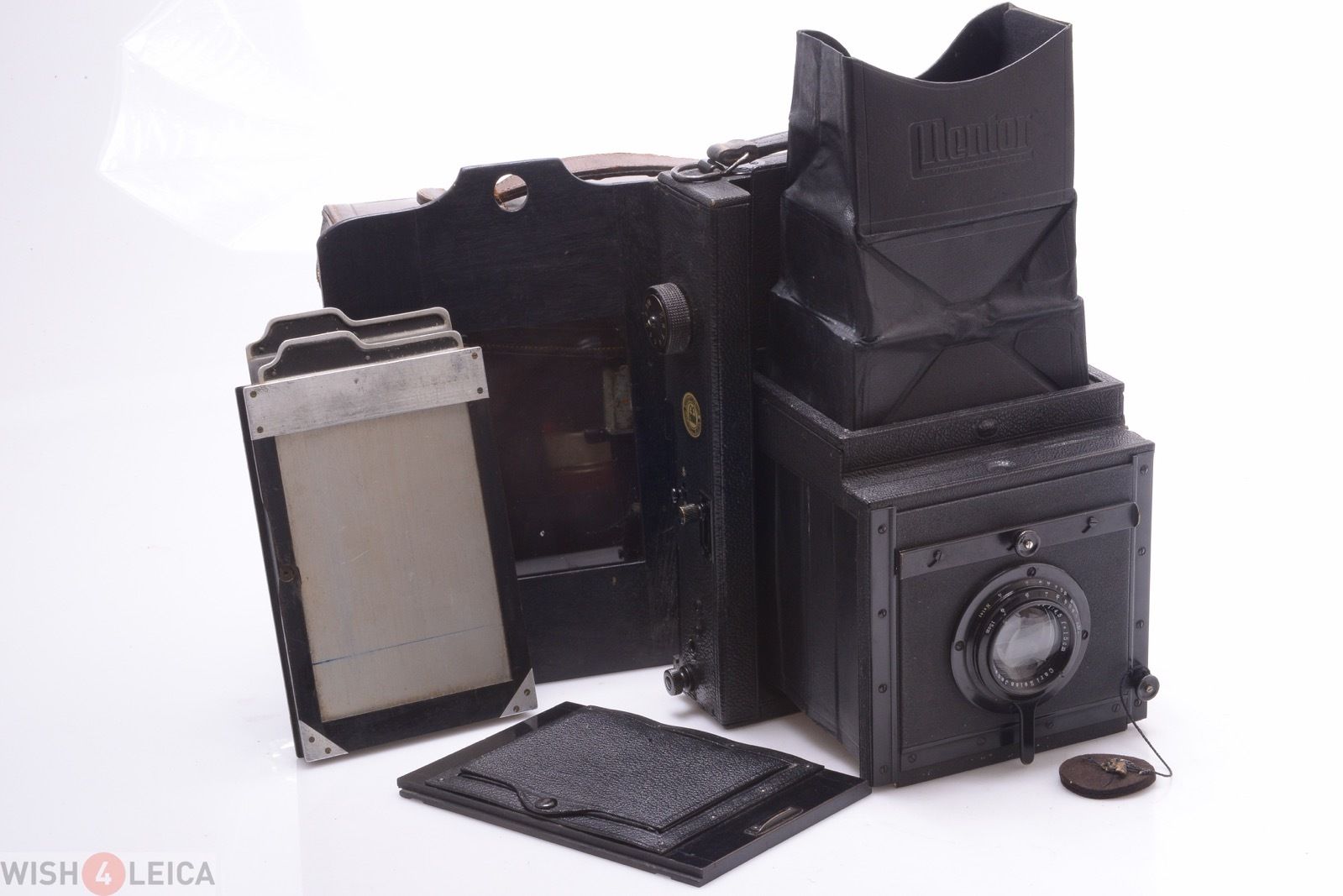

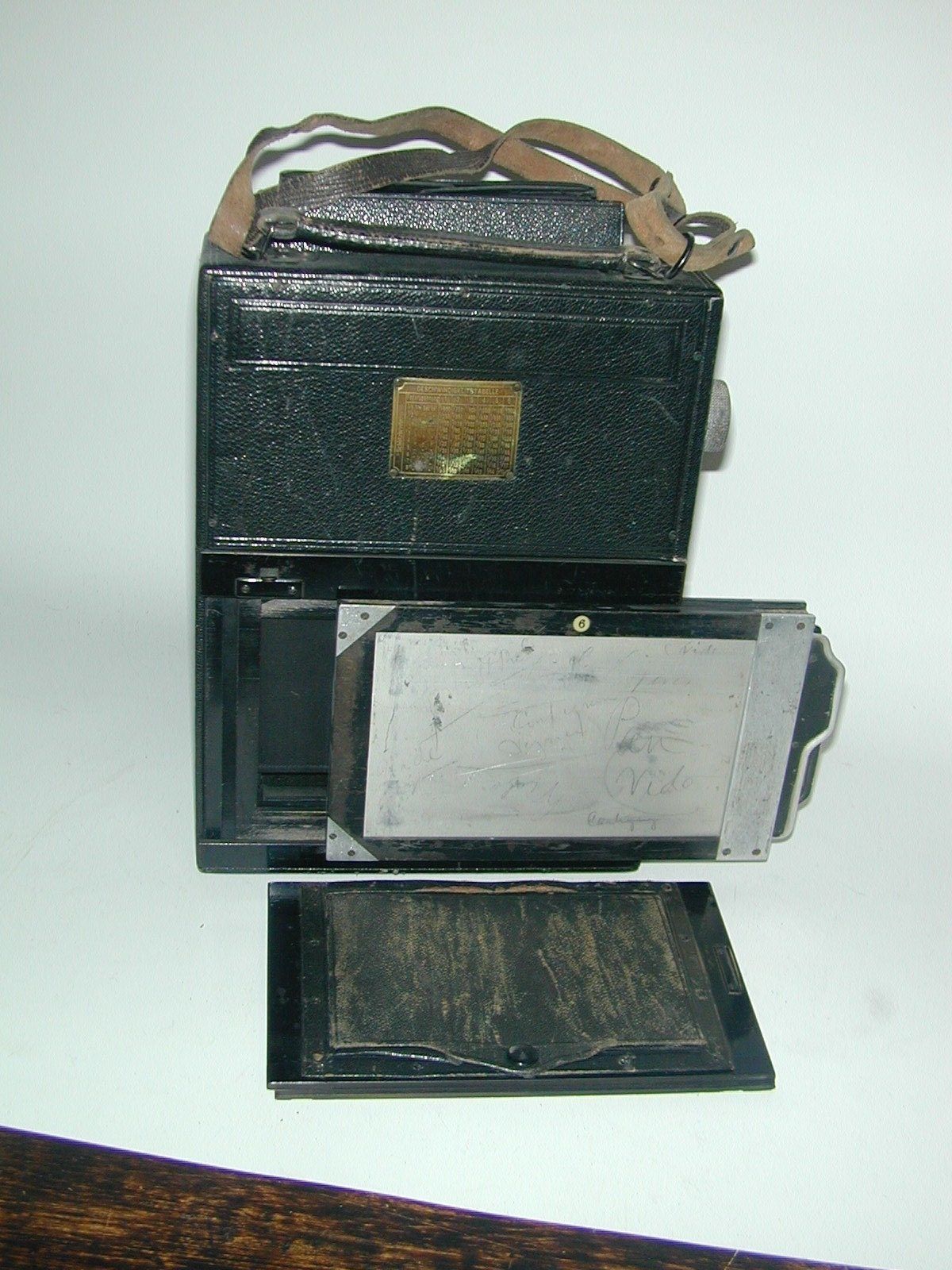

A bit more digging has revealed the make. The plate holder is from a Goltz & Breutmann 'Mentor' Reflex camera, dating from the early 1900s to late 1920s. They were made in 6.5x9, 9x12, 10x15, and 13x18cm formats. They also made portable folding (Klapp0 verisons of the Mentor.
Here's a 9x12 Klapp version (the 9x12 models are far more common than the other formats, relatively speaking).
Here's some more 9x12 plate holders like the ones @Franatix has:
One auctioneer listed the plate holders as being made of ebony and aluminium. Some plate holders do not have the aluminium corner reinforcement plates, so the design was changed over time (I'm betting they lost the corner plates later on as an economy measure, as G&B went bankrupt in 1929). There appear to be very early or late versions that were all wood, like these 13x18 ones:

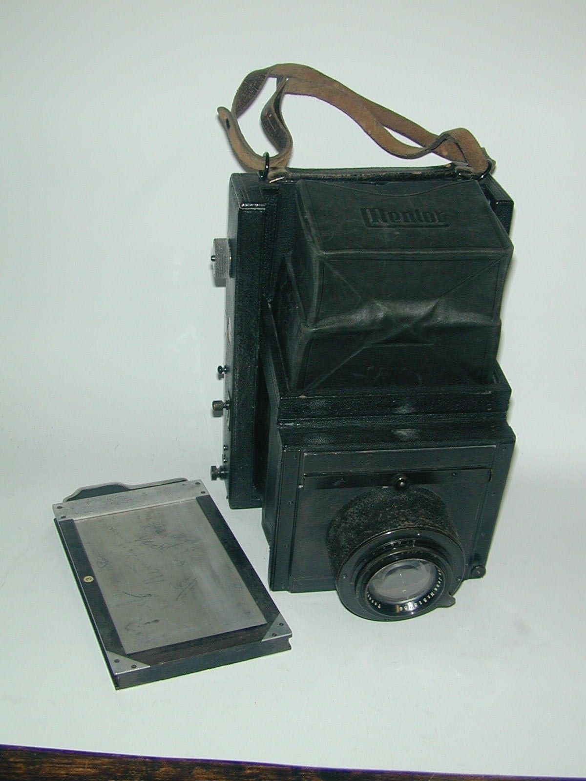

Here's a 10x15 format Klapp Reflex:
The plates with aluminium strengthening parts seem to be mostly seen with the Klapp models, so they may be 'lightweight' plate holders intended to be used on the more portable folding models.
The company were operating at the same time and in the same city (Dresden) as ICA, so it's probably not a coincidence the plate holders look similar. However, the exterior dimensions and fit are unique to Mentor's cameras, so they are quite sought after by collectors as the cameras are practically useless without them. The company was taken over by one of the former workers during WWII, but the factory was flattened in the Dresden raid in 1945. After the war the company continued to make large format cameras (though with more standard Lindhof-style plate holders) under the Mentor name in the DDR, and eventually merged with Pentacon (the company that made Praktica cameras) in 1980.

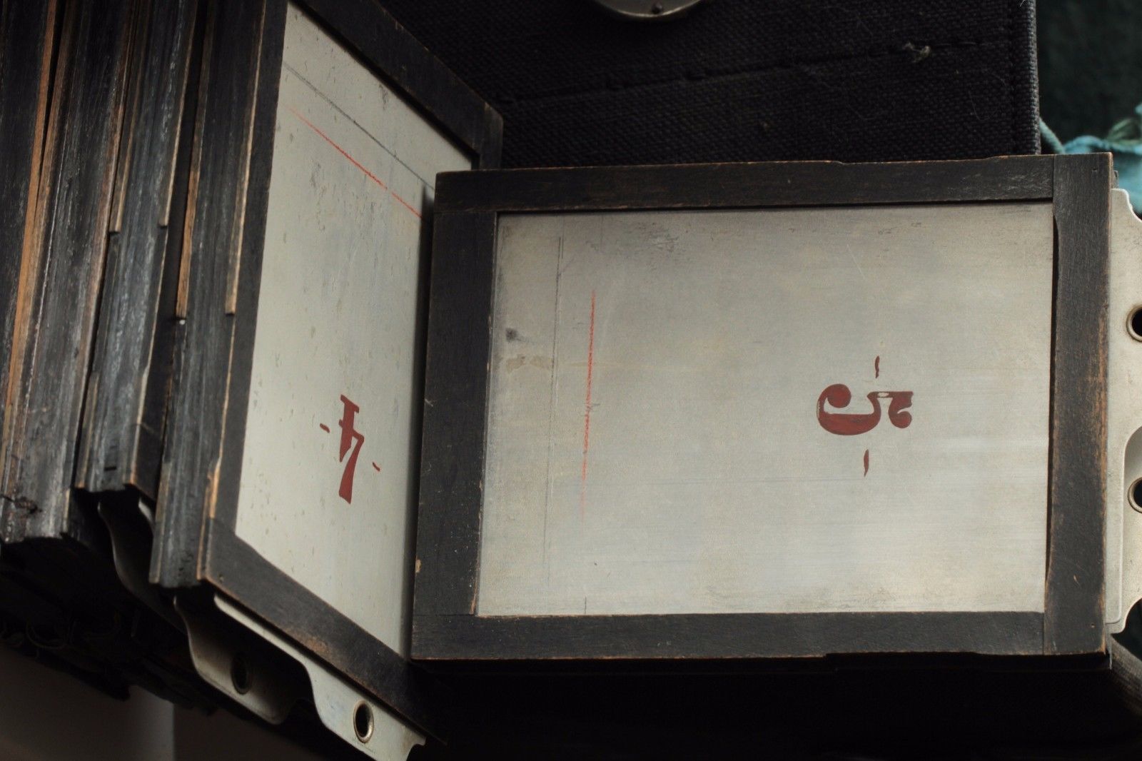

You wanted to see what's inside one of the plate holders - I think I can make a good guess. Originally they were made to hold glass plates negatives. The plate slides in from the side underneath the dark slide. To push the plate to the front of the holder and keep it in place there is a leaf spring in the centre of the backplate. As celluloid film became available there was no way to hold a sheet of thin film in place in the plate holder, so sheet film adapters were made by various companies for glass plate holders. These are metal plates with either small clips at the sides or folded return edges that the film slots into that hold the film flat, and then the adapter slides into the plate holder in place of a glass plate.
I suspect the paper on the prop is clipped or tucked into a sheet film adapter that probably came with the plate holder when they bought it.

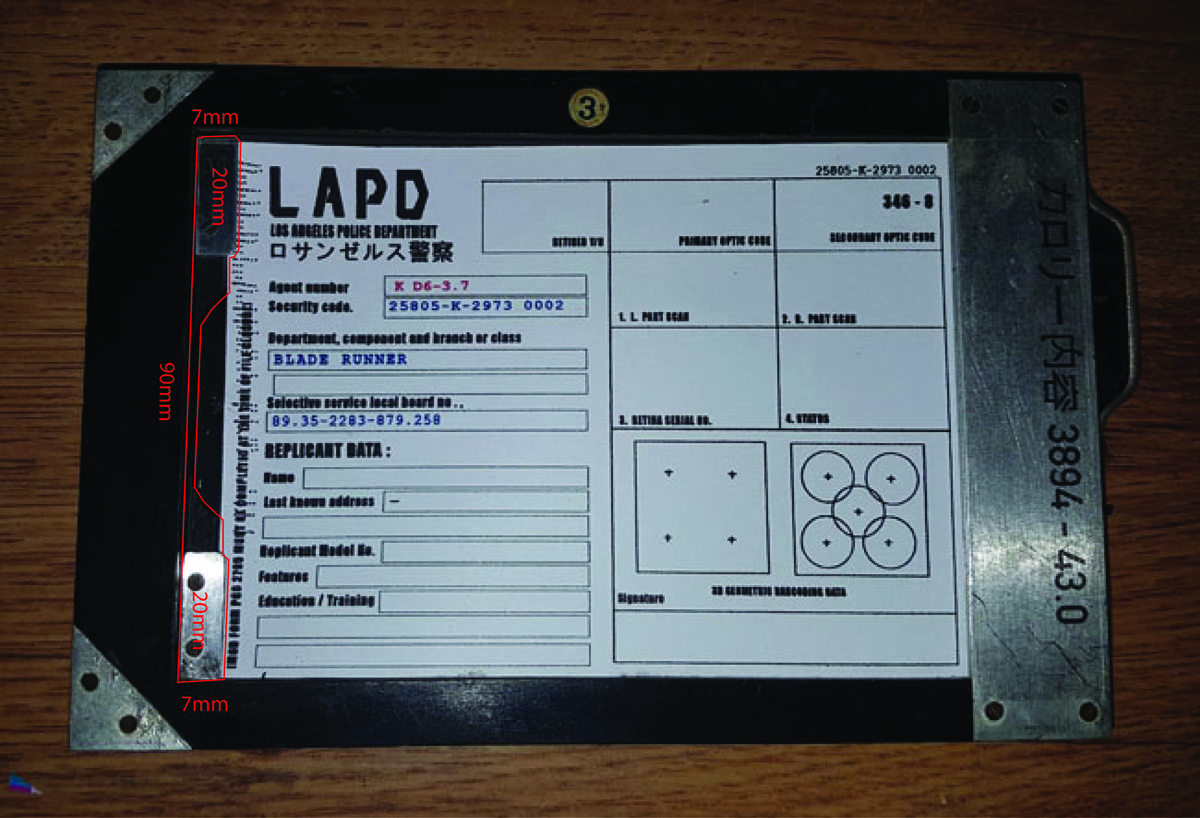

Further confirmation that the correct format is 13x18 (and not 18x24, as I originally concluded): using the KoohINoor pencil, I verified that the width of the inner fame matches the 14.5 cm written on the Mini Post It Note on the Mentor plate holder photo Buzby posted. I believe that the 13x18 format is actually a further reduced inner border behind the dark slide. This would make 14.5x21 cm the dimensions the seller measured of the inside frame, not the outer frame. 18 mm strikes me as the correct thickness of the plate holder.
Feedback welcome!
The 9x12 and 13x18 measurements refer to the size of the glass plates (and later, film sheets) the holders were made to take, i.e. the interior dimension of the 'box' behind the outer frame and dark slide (the photographic plates came in standard sizes, 13x18cm being the metric equivalent of 5"x7"). The inner dimensions of the aperture of the frame need to be smaller than the size of the plate, or it would fall out of the front under the pressure of the leaf spring that sits behind it.
I am pretty sure the 14.5cm x 21cm measurement is the outer dimensions of the frame where it fits into the camera (there is a slight lip on the top and bottom edges of the frame where it slides into the retaining channel of the cassette holder on the back of the camera).
The seller who listed the 13x18 holder and gave the outer dimensions as 14.5x21cm also had 9x12cm holders that he gave the outer dimensions as being 10.4x14cm - does this measurement line up with your example, @Birdie?
Not really....:lol
Outer dims on mine (not including the lip) are 16.6x11cm. Inner 12.8x9cm.
