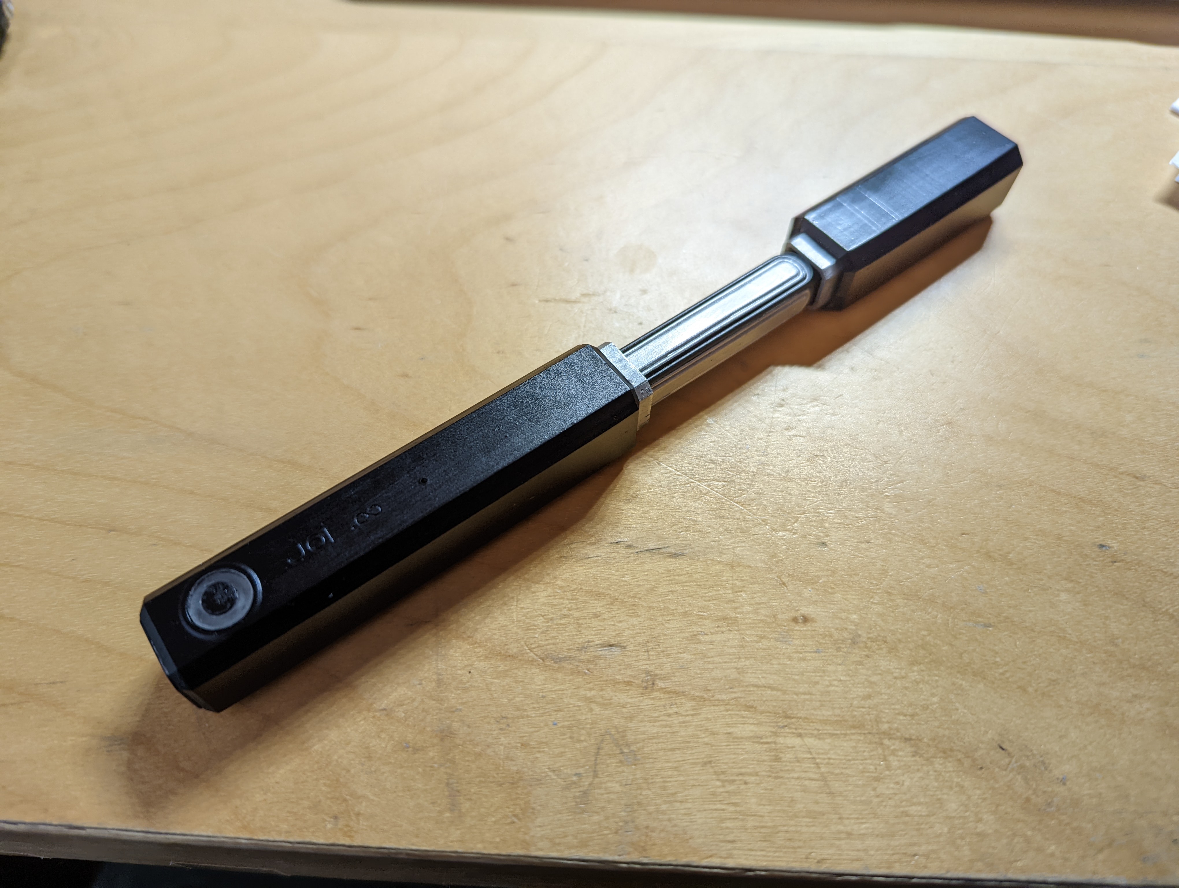

Guiderail came in and WOW that thing is small, yet sturdy.
I think this might be the most expensive thing per mass unit i own...
Physical build done. Decided against an Instructable for now as theres really not that much to it for now. Just print, paint and assemble.
Will do an Instructable for the "expensive version" with the metal rail and the electronics.

Electronics prototype is working. Only problem left now is that the DFPlayer is just the tiniest bit too wide... might have to shave down the sides a bit but we'll have to see if its still working afterwards. Luckily theyre pretty cheap so I'm fine with breaking one in the name of science.

It's with a heavy heart that I have decided to kill the sound feature. I just cant fit all the electronics in the unit without compromising screen accuracy. If anyone knows about a sound-module that is smaller than the DFPlayer I might work that in at some later time, but at this point I've been working on this on and off for like 9 months so I really just want to get it done. Also powering the sound-module off the 1025 cells ive been planning on does not seem to work.
I'm gonna finish the emanator with only the LED in the next few weeks and then set up a project run for the kits. This is the first time I'm doing anything like this so forgive me if there are any hiccups along the way.

Damn... turns out cables have actual volume. Who would've guessed. For the extending part i will be using a ribbon cable.
